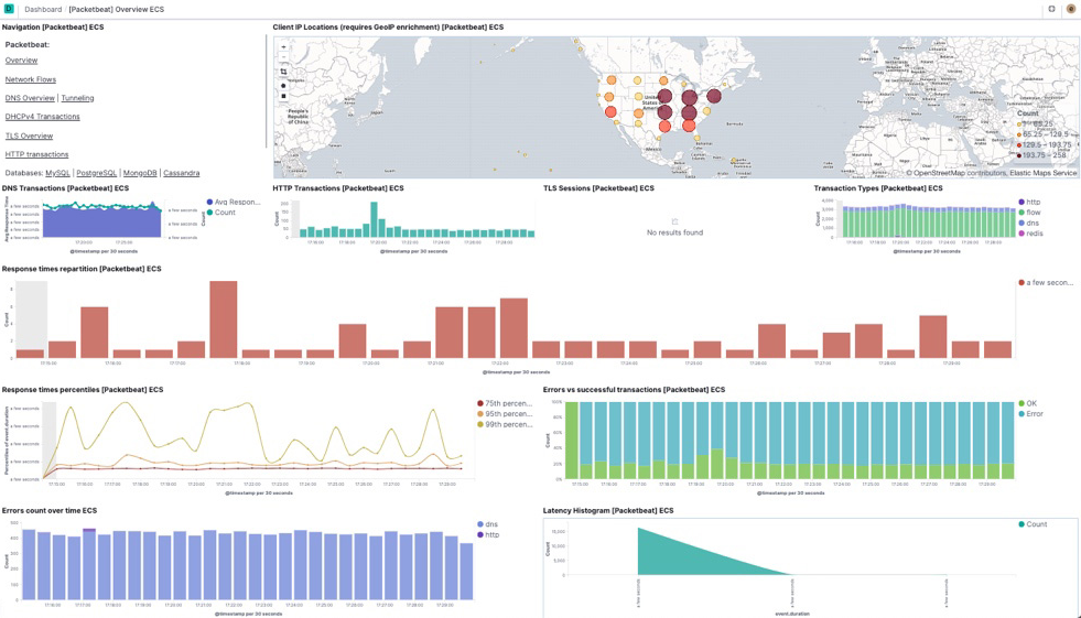

Packetbeat Overview dashboard

Packetbeat comes with pre-built Kibana dashboards and UIs for visualizing log data. You loaded the dashboards earlier when you ran the setup command.
To open the dashboards:
  1. Launch Kibana:
    <div class="tabs" data-tab-group="host"> <div role="tablist" aria-label="Open Kibana"> <button role="tab" aria-selected="true" aria-controls="cloud-tab-open-kibana" id="cloud-open-kibana"> Elasticsearch Service </button> <button role="tab" aria-selected="false" aria-controls="self-managed-tab-open-kibana" id="self-managed-open-kibana" tabindex="-1"> Self-managed </button> </div> <div tabindex="0" role="tabpanel" id="cloud-tab-open-kibana" aria-labelledby="cloud-open-kibana">
    1. Log in to your Elastic Cloud account.
    2. Navigate to the Kibana endpoint in your deployment.
    </div> <div tabindex="0" role="tabpanel" id="self-managed-tab-open-kibana" aria-labelledby="self-managed-open-kibana" hidden=""> Point your browser to http://localhost:5601, replacing localhost with the name of the Kibana host.
    </div> </div>
  2. In the side navigation, click Discover. To see Packetbeat data, make sure the predefined packetbeat-* data view is selected.
    Tip
    If you don’t see data in Kibana, try changing the time filter to a larger range. By default, Kibana shows the last 15 minutes.
  3. In the side navigation, click Dashboard, then select the dashboard that you want to open.
Tip
To populate the client locations map in the overview dashboard, follow the steps described in Enrich events with geoIP information.
