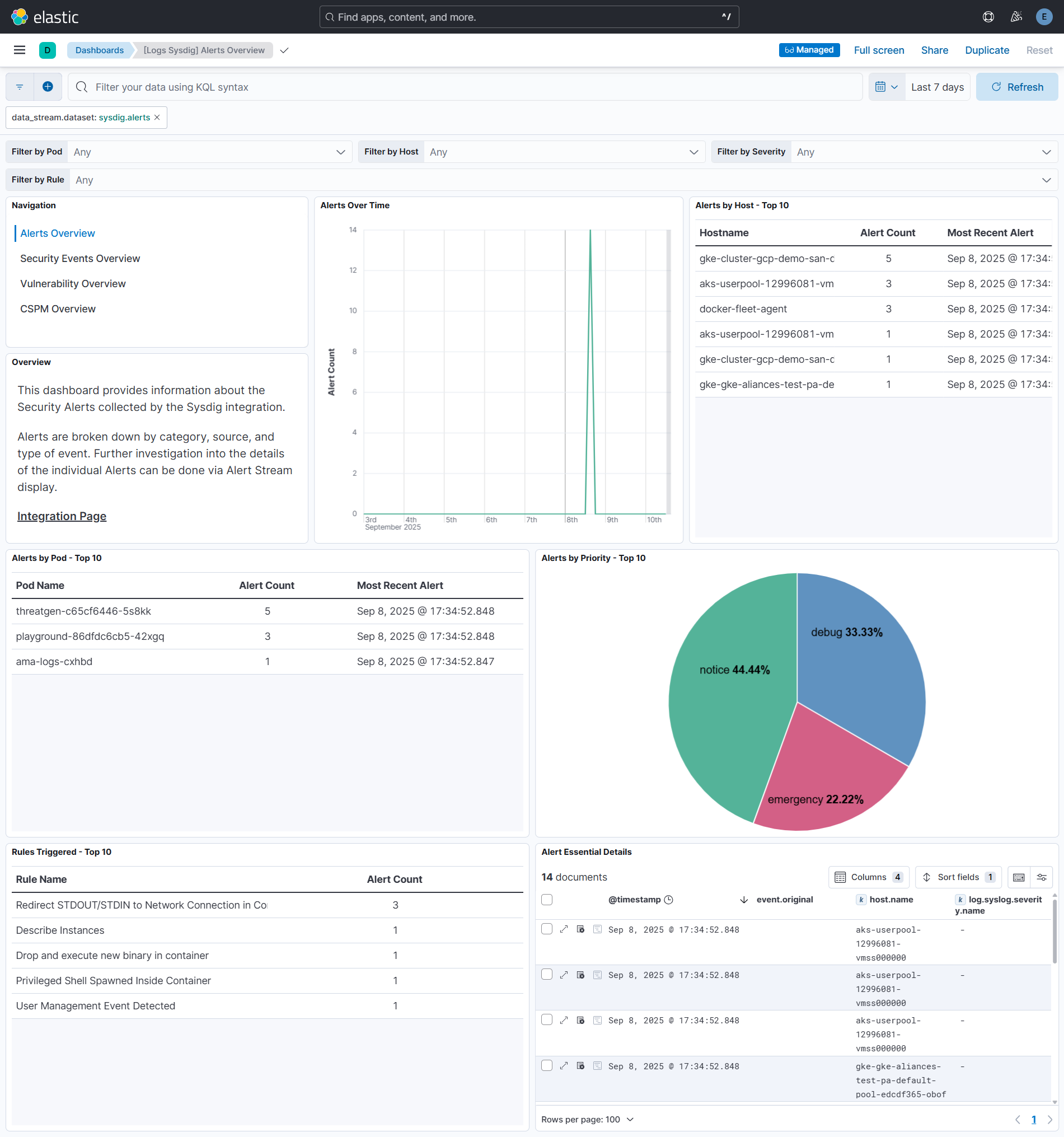

Alerts The Alerts data stream collected by the Sysdig integration is comprised of Sysdig Alerts. See more details about Sysdig Alerts in Sysdig's Alerts Documentation. A complete list of potential fields used by this integration can be found in the Logs reference

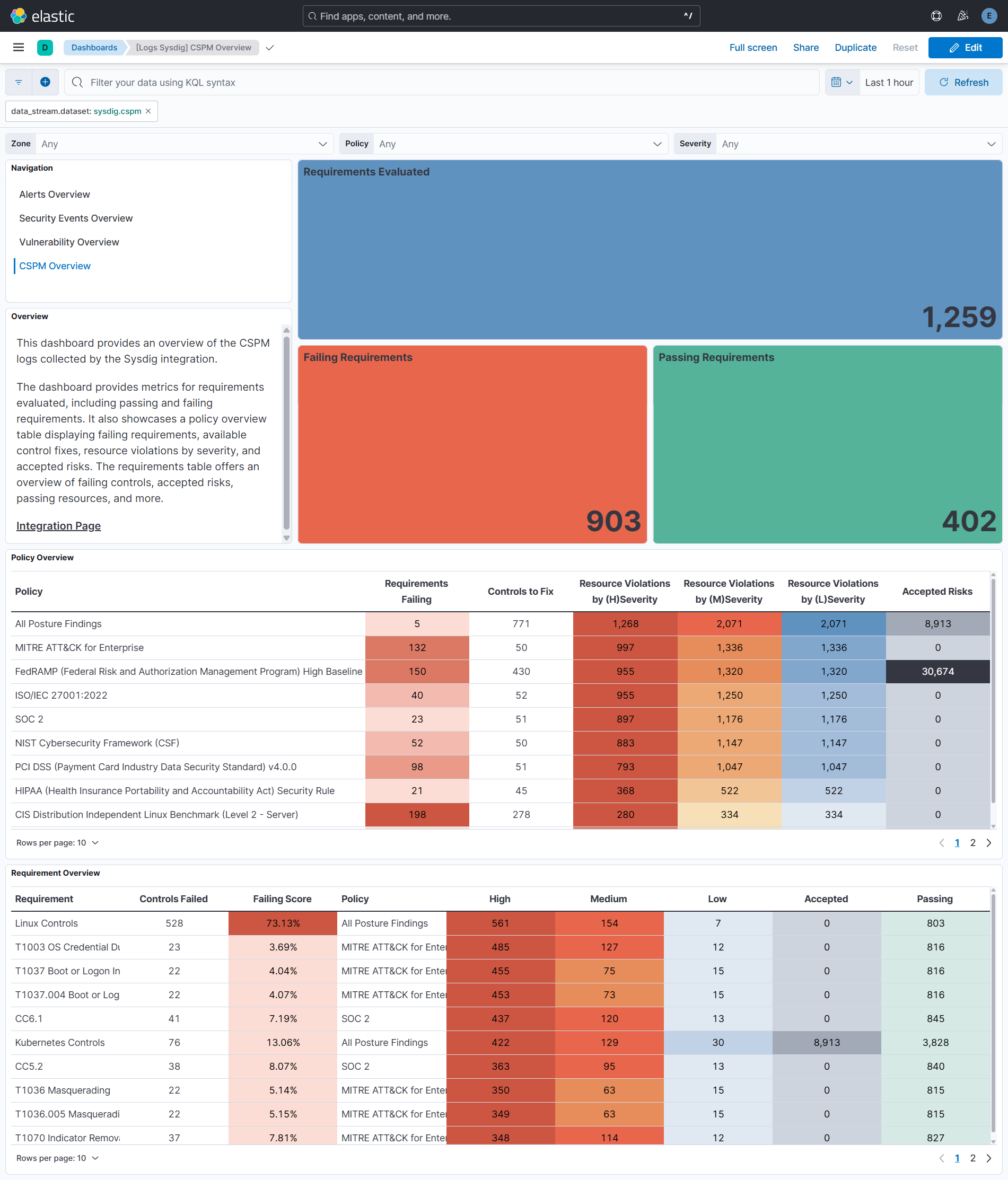

CSPM The CSPM data stream collected through the Sysdig integration consists of Sysdig compliance results. See more details about compliance results in Sysdig's Compliance documentation. It uses Sysdig's Current API (non-standardised). You can access your regional documentation through the links here.

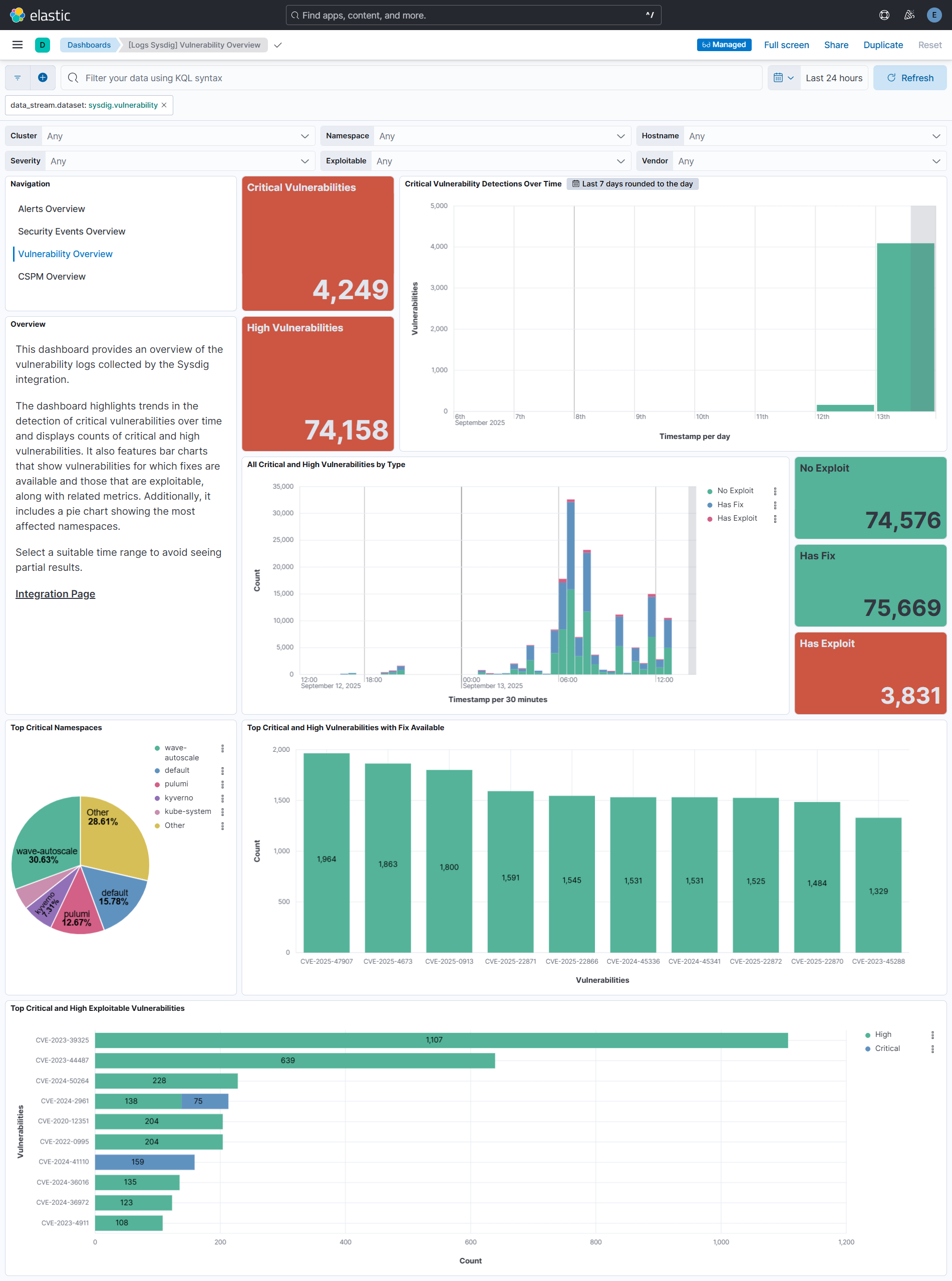

Vulnerability The vulnerability data stream collected through the Sysdig integration consists of Sysdig vulnerability scan results. See more details about vulnerabilities in Sysdig's Vulnerability Management documentation. It uses Sysdig's Next Gen API (standardized). You can access your regional documentation through the links here.
For vulnerability data, Each interval fetches all available scan results from the configured stage. Currently, only one stage can be configured at a time. Users wishing to collect scan results from different stages must configure additional integrations for each desired stage.
Scan results are broken down into separate events for each package-vulnerability pair. If no vulnerability is found for a package, then only the package details will be included in the published event. If the scans contain no package information, then only the scan details will be included in the published event.
In detail, a package is included in one layer, which can be built upon several base images. Furthermore, a package can have multiple vulnerabilities, each of which can have multiple risk accepts.
