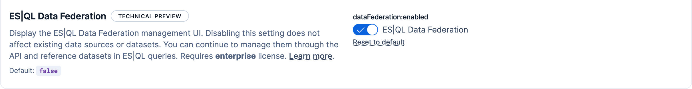

ES|QL Data Federation is not enabled by default. To use it, enable the feature in Elasticsearch and enable the UI in Kibana.
Elasticsearch
Add the following to your Elasticsearch configuration:
esql.federation.enabled: true
Kibana
Add the following to your Kibana configuration:
xpack.dataFederation.enabled: true
