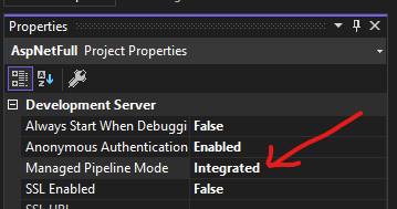

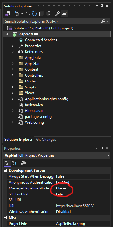

When debugging applications using Visual Studio and IISExpress, the same requirement to use the Integrated managed pipeline mode exists. Select your web application project in the solution explorer and press F4 to load the properties window. If the managed pipeline mode is set to classic, the ElasticApmModule will not load.
For example:
Classic Managed Pipeline Mode in Properties
Should be changed to:
Integrated Managed Pipeline Mode in Properties
You may need to restart Visual Studio for these changes to fully apply.
