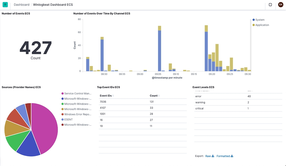

Winlogbeat dashboard

Winlogbeat comes with pre-built Kibana dashboards and UIs for visualizing log data. You loaded the dashboards earlier when you ran the setup command.
To open the dashboards:
  1. Launch Kibana:
    1. Log in to your Elastic Cloud account.
    2. Navigate to the Kibana endpoint in your deployment.
    Point your browser to http://localhost:5601, replacing localhost with the name of the Kibana host.
  2. In the side navigation, click Discover. To see Winlogbeat data, make sure the predefined winlogbeat-* data view is selected.
    Tip
    If you don’t see data in Kibana, try changing the time filter to a larger range. By default, Kibana shows the last 15 minutes.
  3. In the side navigation, click Dashboard, then select the dashboard that you want to open.
