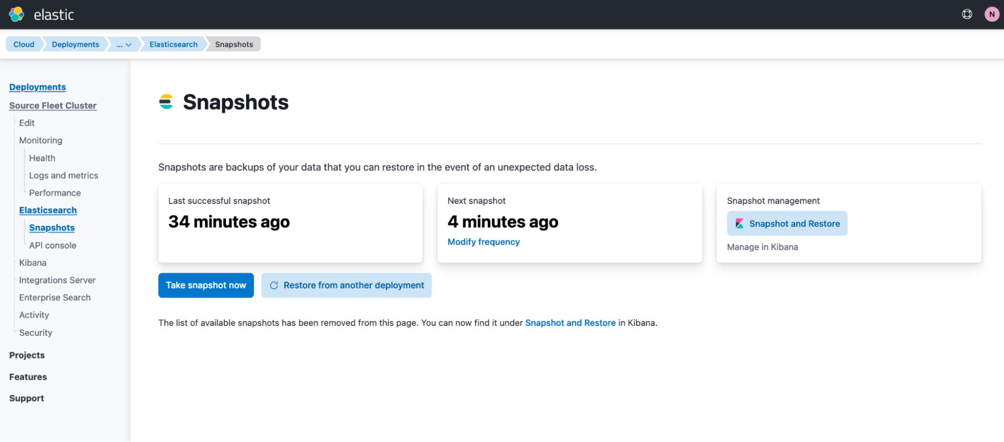

Refer to the full Snapshot and restore documentation for full details. In short, to create a new snapshot in an Elastic Cloud deployment:
  1. In Kibana, open the main menu, then click Manage this deployment.
  2. In the deployment menu, select Snapshots.
  3. Click Take snapshot now.
    Deployments Snapshots page

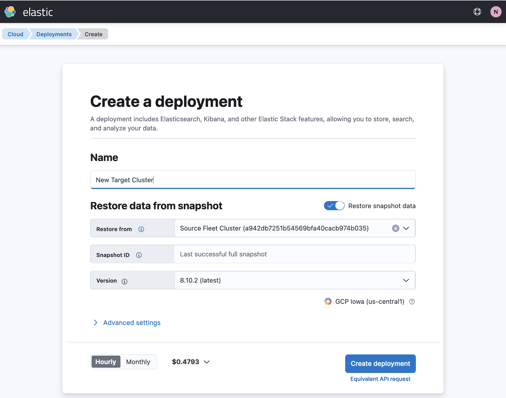

You can create a new cluster based on the snapshot taken in the previous step, and then migrate your Elastic Agents and Fleet to the new cluster. For best results, it’s recommended that the new target cluster be at the same version as the cluster that the agents are migrating from.
  1. Open the Elastic Cloud console and select Create deployment.
  2. Select Restore snapshot data.
  3. In the Restore from field, select your source deployment.
  4. Choose your deployment settings, and, optimally, choose the same Elastic Stack version as the source cluster.
  5. Click Create deployment.
    Create a deployment page

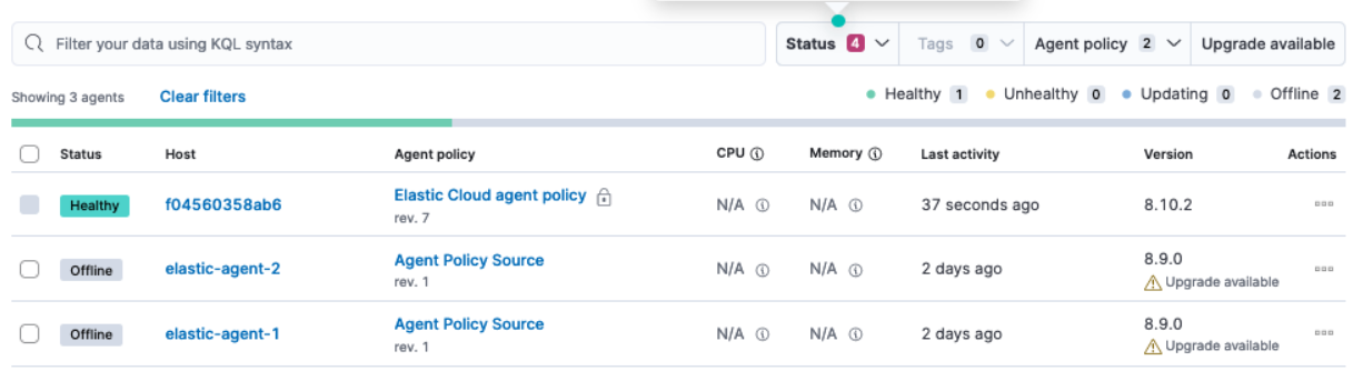

When the target cluster is available you’ll need to adjust a few settings. Take some time to examine the Fleet setup in the new cluster.
  1. Open the Kibana menu and select Fleet.
  2. On the Agents tab, your agents should visible, however they’ll appear as Offline. This is because these agents have not yet enrolled in the new, target cluster, and are still enrolled in the original, source cluster.
    Agents tab in Fleet showing offline agents

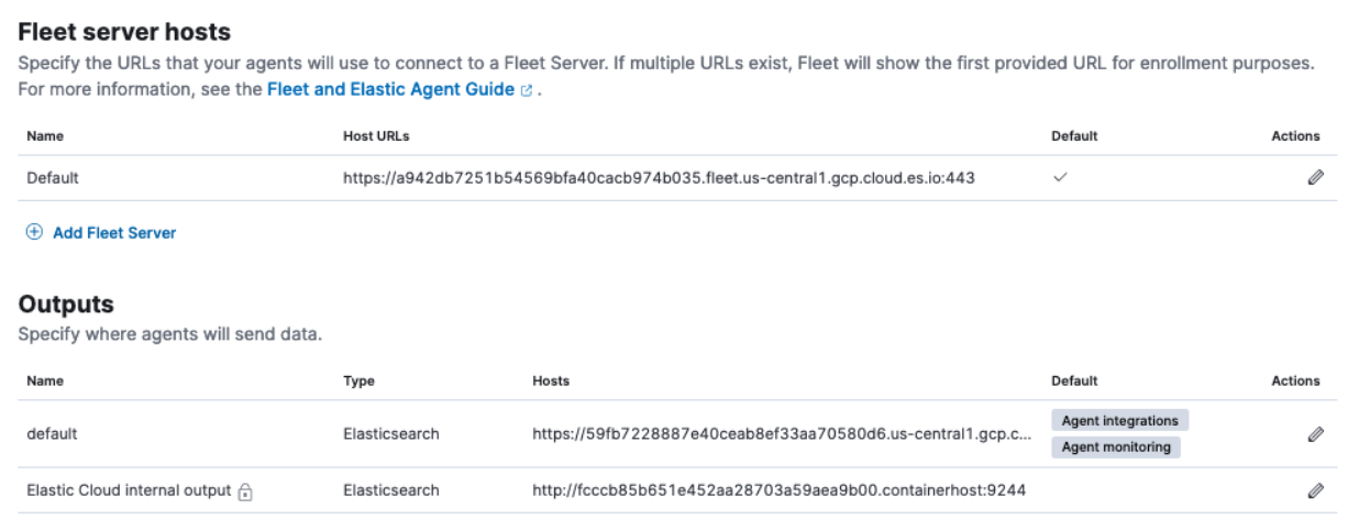

  3. Open the Fleet Settings tab.
  4. Examine the configurations captured there for Fleet. These settings are copied from the snapshot of the source cluster and may not have a meaning in the target cluster, so they need to be modified accordingly.
    In the following example, both the Fleet server hosts and the Outputs settings are copied over from the source cluster:
    Settings tab in Fleet showing source deployment host and output settings

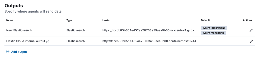

  1. In the new target cluster on Elastic Cloud, in the Outputs section, on the Fleet Settings tab, you will find an internal output named Elastic Cloud internal output. The host address is in the form:
    https://<cluster-id-target>.containerhost:9244
    Record this <cluster-id-target> from the target cluster. In the example shown, the ID is fcccb85b651e452aa28703a59aea9b00.
  2. Also in the Outputs section, notice that the default Elasticsearch output (that was copied over from the source cluster) is also in the form:
    https://<cluster-id-source>.<cloud endpoint address>:443.
    Modify the Elasticsearch output so that the cluster ID is the same as that for Elastic Cloud internal output. In this example we also rename the output to New Elasticsearch.
    Outputs section showing the new Elasticsearch host setting
    In this example, the New Elasticsearch output and the Elastic Cloud internal output now have the same cluster ID, namely fcccb85b651e452aa28703a59aea9b00.

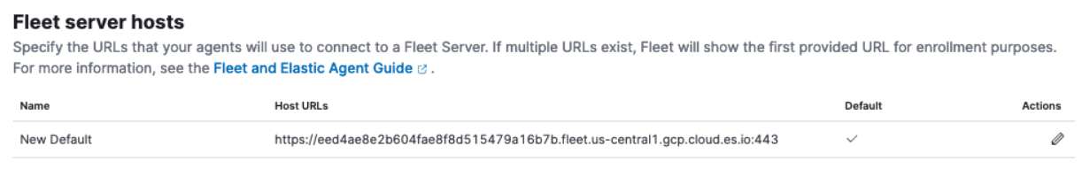

Like the Elasticsearch host, the Fleet Server host has also changed with the new target cluster. If you're deploying Fleet Server on premise, the host has probably not changed address and this setting does not need to be modified. We still recommend that you ensure the agents are able to reach the the on-premise Fleet Server host (which they should be able to as they were able to connect to it prior to the migration).
The Elastic Cloud Fleet Server host has a similar format to the Elasticsearch output:
https://<deployment-id>.fleet.<domain>.io

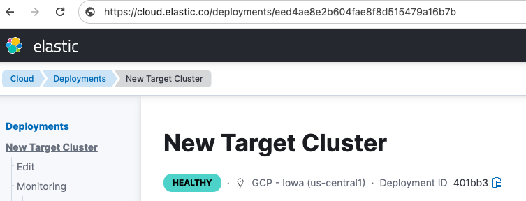

To configure the correct Elastic Cloud Fleet Server host you will need to find the target cluster’s full deployment-id, and use it to replace the original deployment-id that was copied over from the source cluster.
The easiest way to find the deployment-id is from the deployment URL:
  1. From the Kibana menu select Manage this deployment.
  2. Copy the deployment ID from the URL in your browser’s address bar.
    Deployment management page
    In this example, the new deployment ID is eed4ae8e2b604fae8f8d515479a16b7b.
    Using that value for deployment-id, the new Fleet Server host URL is:
    https://eed4ae8e2b604fae8f8d515479a16b7b.fleet.us-central1.gcp.cloud.es.io:443
  3. In the target cluster, under Fleet server hosts, replace the original host URL with the new value.
    Fleet server hosts showing the new host URL

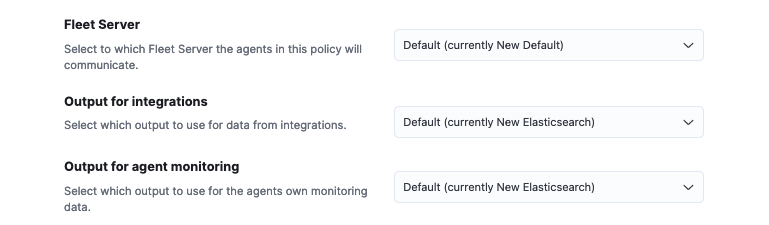

Now that the Fleet settings are correctly set up, it pays to ensure that the Elastic Agent policy is also correctly pointing to the correct entities.
  1. In the target cluster, go to Fleet → Agent policies.
  2. Select a policy to verify.
  3. Open the Settings tab.
  4. Ensure that Fleet Server, Output for integrations, and Output for agent monitoring are all set to the newly created entities.
    An agent policy's settings showing the newly created entities
Note
If you modified the Fleet Server and the output in place these would have been updated accordingly. However if new entities are created, then ensure that the correct ones are referenced here.

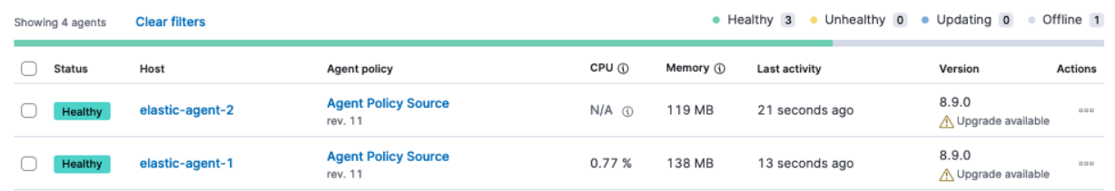

By creating the new target cluster from a snapshot, all of your policies should have been created along with all of the agents. These agents will be offline due to the fact that the actual agents are not checking in with the new, target cluster (yet) and are still communicating with the source cluster.
The agents can now be re-enrolled into these policies and migrated over to the new, target cluster.

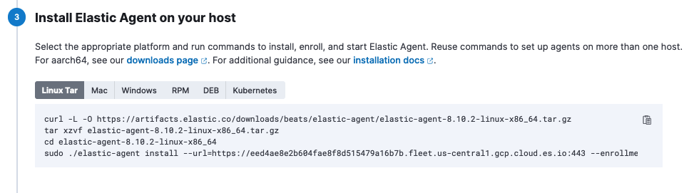

This is best performed one policy at a time. For a given policy, you need to capture the enrollment token and the URL for the agent to connect to. You can find these by running the in-product steps to add a new agent.
  1. On the target cluster, open Fleet and select Add agent.
  2. Select your newly created policy.
  3. In the section Install Elastic Agent on your host, find the sample install command. This contains the details you’ll need to enroll the agents, namely the enrollment token and the Fleet Server URL.
  4. Copy the portion of the install command containing these values. That is, –url=<path> –enrollment-token=<token for the new policy>.

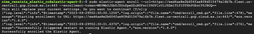

    Run the enroll command on each individual host:
    1. On the host machines where the current agents are installed, enroll the agents again using the URL and enrollment token you obtained from the target cluster:
      sudo elastic-agent enroll --url=<fleet server url> --enrollment-token=<token for the new policy>
      The command output should resemble this:
    1. The agent on each host will now check into the new Fleet Server and appear in the new target cluster. In the source cluster, the agents will go offline as they won’t be sending any check-ins.
