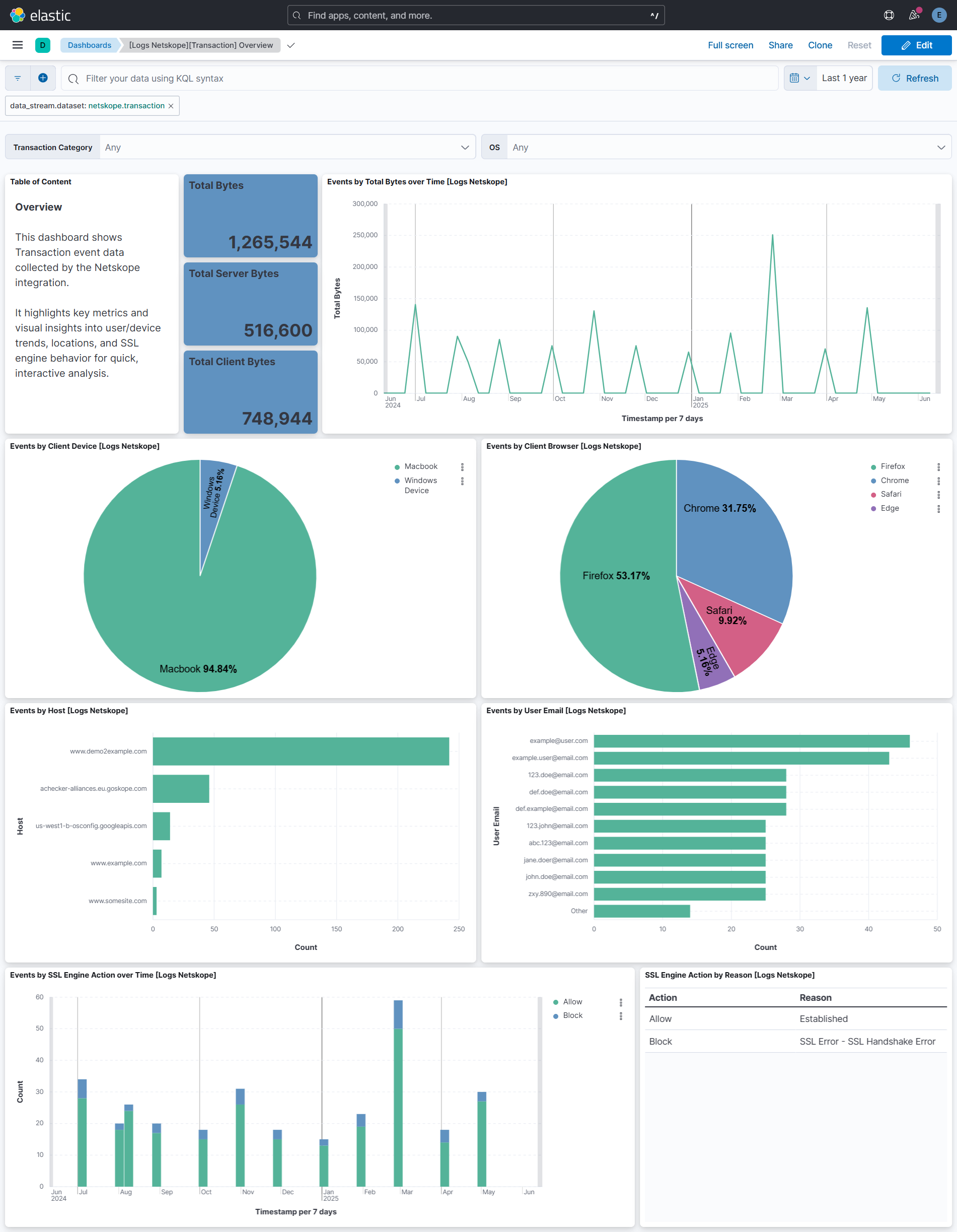

"input": {
"type": "gcs"
"log": {
"file": {
"path": "gs://testbucket/trxn.csv.gz"
"offset": 0
"netskope": {
"transaction": {
"bytes": 18,
"cs_host": "us-west1-b-osconfig.googleapis.com",
"cs_uri": "*",
"date": "2024-08-05T00:00:00.000Z",
"time": "16:24:19",
"x_c_latitude": 45.6056,
"x_c_longitude": 23.5943,
"x_category": "Technology",
"x_category_id": "564",
"x_cs_access_method": "Client",
"x_cs_page_id": "0",
"x_cs_session_id": "0",
"x_cs_src_ip_egress": "34.82.190.203",
"x_cs_ssl_engine_action": "Allow",
"x_cs_ssl_engine_action_reason": "Established",
"x_cs_ssl_fronting_error": "No",
"x_cs_ssl_handshake_error": "No",
"x_cs_userip": "10.70.0.19",
"x_error": "http-malformed",
"x_other_category": "Cloud Storage",
"x_other_category_id": "7",
"x_request_id": "0",
"x_s_custom_signing_ca_error": "No",
"x_s_dp_name": "US-SEA2",
"x_sr_ssl_engine_action": "None",
"x_sr_ssl_engine_action_reason": "NotEstablished",
"x_ssl_bypass": "No",
"x_ssl_policy_action": "Decrypt",
"x_ssl_policy_categories": [
"Technology",
" Cloud Storage"
"x_ssl_policy_dst_host": "us-west1-b-osconfig.googleapis.com",
"x_ssl_policy_dst_host_source": "Sni",
"x_ssl_policy_dst_ip": "142.250.99.95",
"x_ssl_policy_src_ip": "10.70.0.19",
"x_type": "http_transaction"
"related": {
"hosts": [
"ip": [
"10.70.0.19",
"142.250.99.95",
"34.82.190.203"
"user": [
"john.doe@gmail.com"
"source": {
"bytes": 18,
"geo": {
"city_name": "The Dalles",
"country_name": "US",
"location": {
"lat": 45.6056,
"lon": 23.5943
"postal_code": "97058",
"region_name": "Oregon"
"ip": "10.70.0.19",
"port": 32951
"tags": [
"forwarded",
"netskope-transaction"
"tls": {
"cipher": "TLS_AES_256_GCM_SHA384",
"client": {
"ja3": "7a15285d4efc355608b304698cd7f9ab",
"server_name": "us-west1-b-osconfig.googleapis.com"
"version": "1.3",
"version_protocol": "tls"
"url": {
"port": 443
"user": {
"email": "john.doe@gmail.com"
