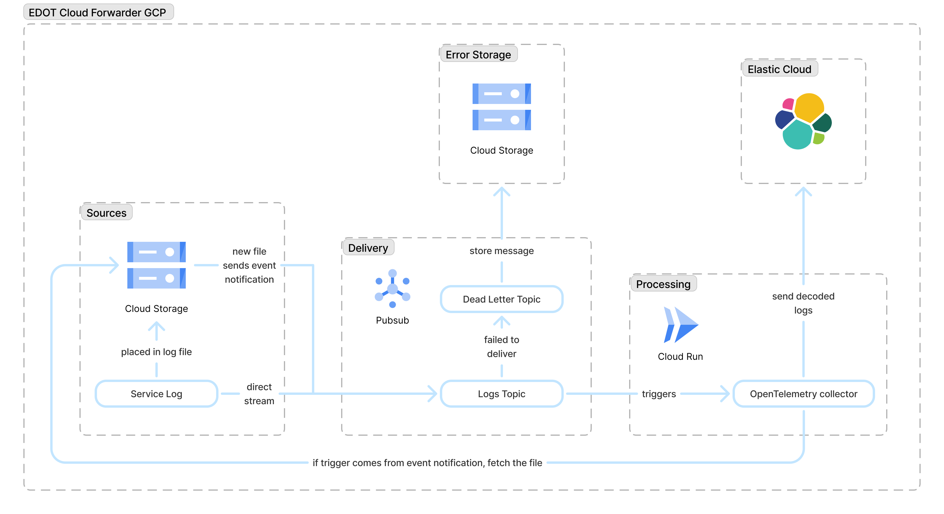

EDOT Cloud Forwarder (ECF) for GCP is a managed data pipeline that sends your Google Cloud logs to Elastic Observability. It uses Google Cloud Run and Pub/Sub under the hood to receive log events, process them with an OpenTelemetry Collector, and forward them to the Elastic Cloud Managed OTLP Endpoint.
The architecture for the EDOT Cloud Forwarder GCP is as follows:
EDOT Cloud Forwarder GCP overview
At a high level, the deployment consists of:
  • A Pub/Sub topic and push subscription that receive log events from GCP services or GCS notifications.
  • A Cloud Run service running the OpenTelemetry Collector, which transforms and forwards logs.
  • An optional GCS bucket used as a landing zone for batch log files (for example, VPC Flow Logs).
  • A dead-letter Pub/Sub topic and failure bucket that capture messages that could not be processed after retries.
  • An Elastic Observability endpoint (Elastic Cloud Managed OTLP Endpoint) where all processed logs are finally stored and analyzed.
Data flows in the following way:
  1. Ingestion: Logs are sent to a Pub/Sub topic (either directly or using a GCS bucket notification).
  2. Processing: A push subscription triggers the Cloud Run service, where the OpenTelemetry Collector is running.
  3. Forwarding: The service processes the data and exports it to Elastic Cloud using the Elastic Cloud Managed OTLP Endpoint.
  4. Failure handling: If processing or forwarding still fails after retries, the failed messages are routed to a dead-letter topic and archived in a GCS bucket for future analysis.
