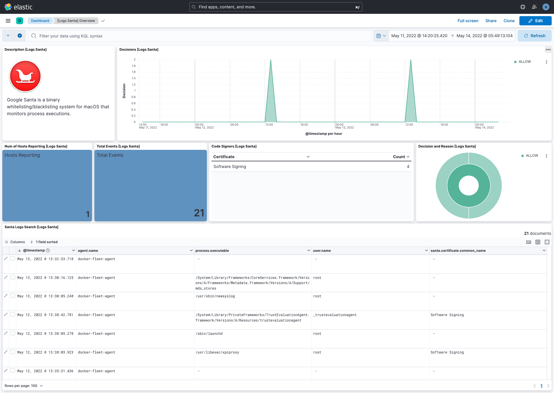

The Google Santa integration collects and parses logs from Google Santa, a security tool for macOS that monitors process executions and can blacklist/whitelist binaries.
The Google Santa integration was tested with logs from Santa 2022.4.
Google Santa is available for MacOS only.
The integration is by default configured to read logs from /var/db/santa/santa.log.
This is the Google Santa log dataset.
