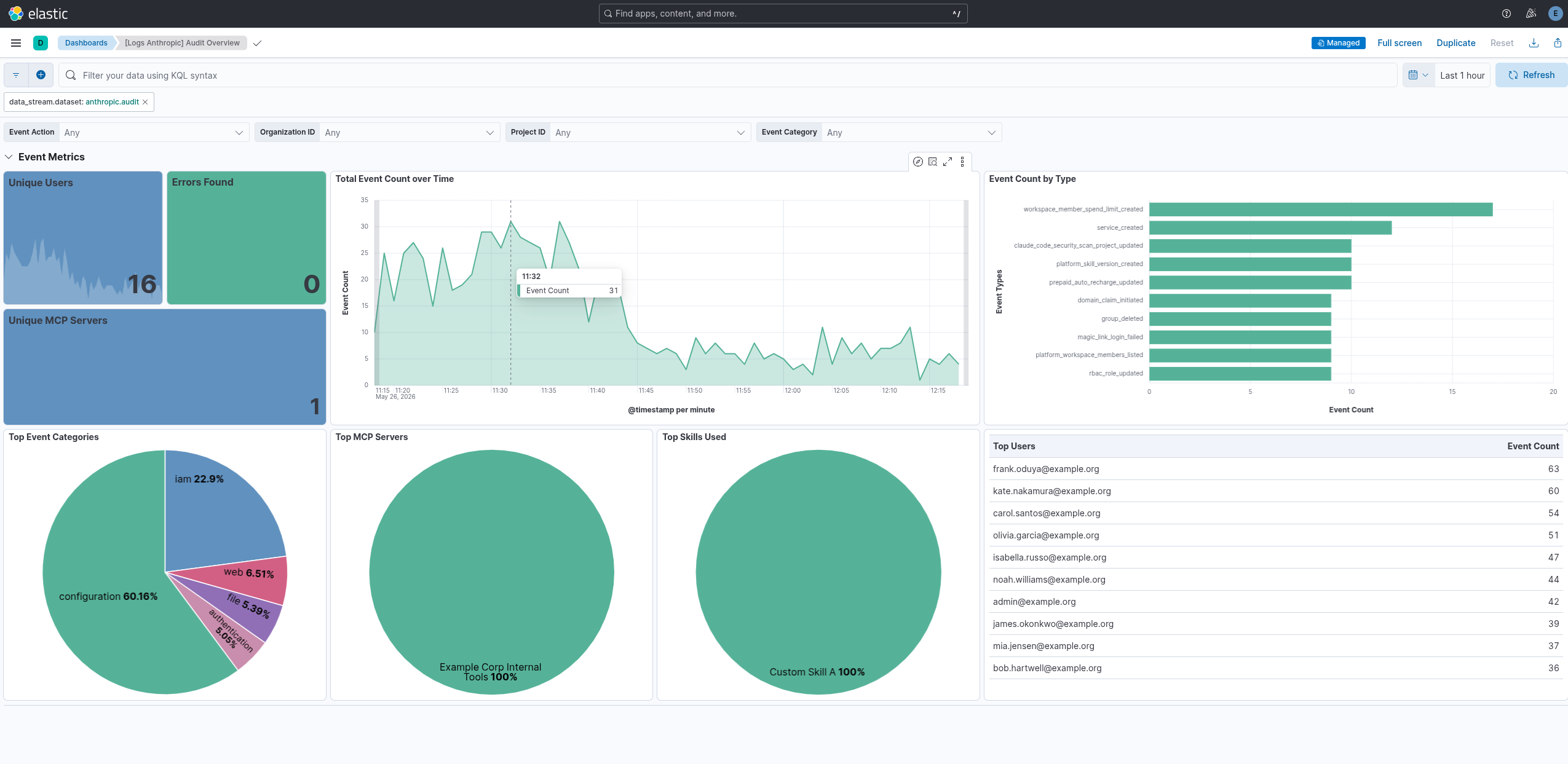

- In Kibana, navigate to Management → Integrations and search for Anthropic.
- Click Add Anthropic and enter the Compliance Access Key or Admin API Key you created.
- Configure the polling interval (default: 5 minutes). The default initial lookback is 24 hours.
- Optionally filter collection by activity type, actor ID, or organization ID to scope events to specific users, event types, or child organizations.
- Save the integration policy and assign it to the Elastic Agent policy that should collect Anthropic data.

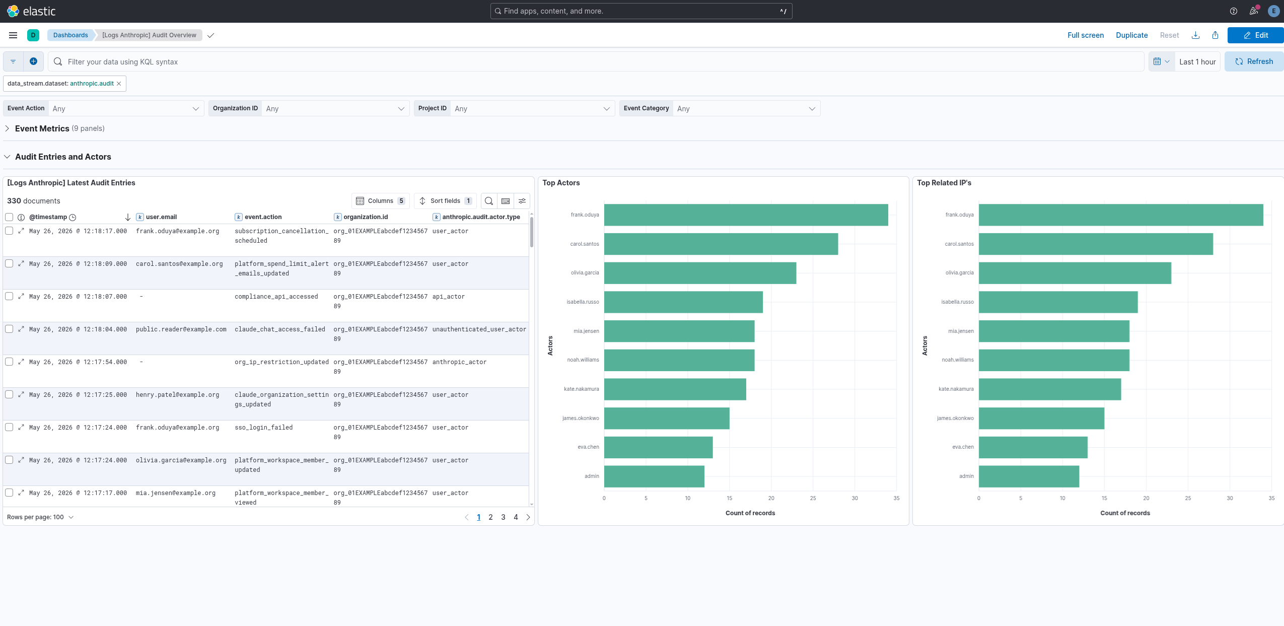

After deploying the integration:
- Wait one polling interval (default 5 minutes).
- In Kibana, open Discover and filter for
data_stream.dataset: "anthropic.audit". - Verify that events are being ingested with populated
@timestamp,event.action, and actor fields. - Generate an Anthropic admin action (for example, sign in to the console or create an API key) and confirm a corresponding event appears within roughly one polling interval.
