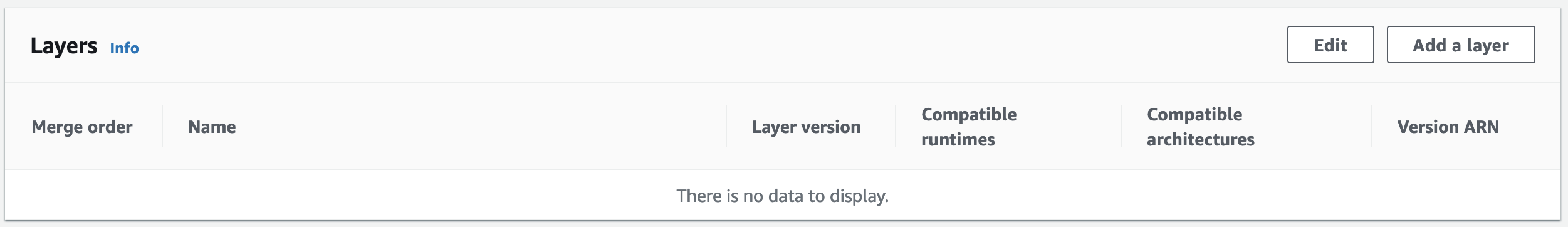

  1. Navigate to your function in the AWS Management Console
  2. Scroll to the Layers section and click the Add a layer button image of layer configuration section in AWS Console

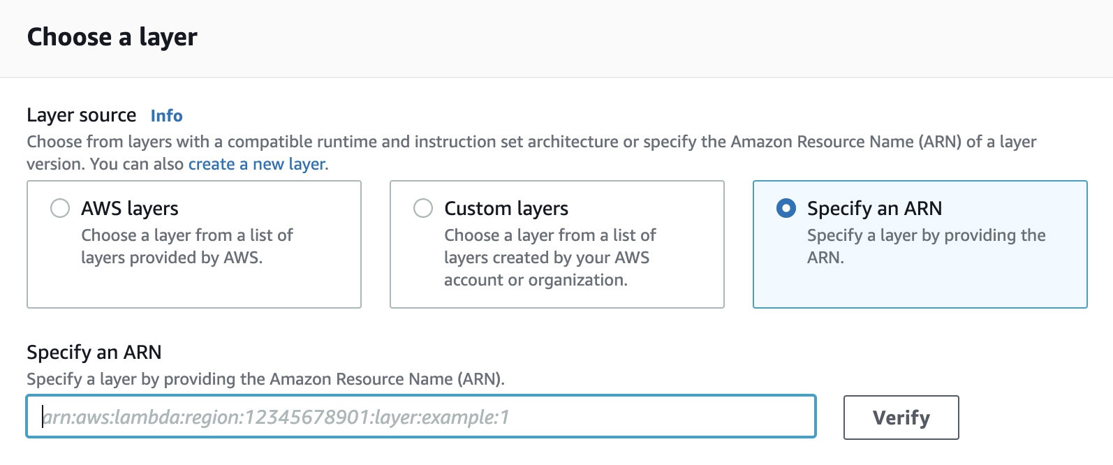

  3. Choose the Specify an ARN radio button
  4. Copy and paste the following ARNs of the Elastic APM AWS Lambda extension layer and the APM agent layer in the Specify an ARN text input:
    • APM Extension layer:
      arn:aws:lambda:{AWS_REGION}:267093732750:layer:elastic-apm-extension-ver-1-6-0-{ARCHITECTURE}:1
      1. Replace {AWS_REGION} with the AWS region of your Lambda function and {ARCHITECTURE} with its architecture.
    • APM agent layer:
      arn:aws:lambda:{AWS_REGION}:267093732750:layer:elastic-apm-python-ver-6-25-0:1
      1. Replace {AWS_REGION} with the AWS region of your Lambda function.
    image of choosing a layer in AWS Console
  5. Click the Add button

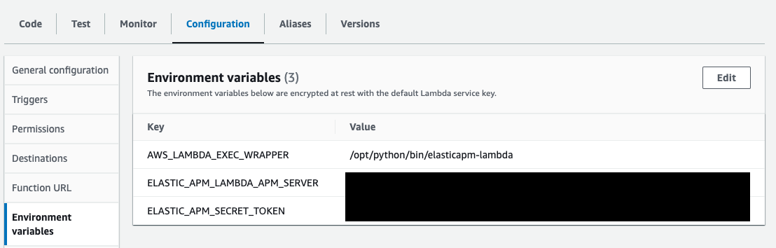

To configure APM through the AWS Management Console:
  2. Click on the Configuration tab
  3. Click on Environment variables
  4. Add the following required variables:
AWS_LAMBDA_EXEC_WRAPPER       = /opt/python/bin/elasticapm-lambda
ELASTIC_APM_LAMBDA_APM_SERVER = <YOUR-APM-SERVER-URL>
ELASTIC_APM_SECRET_TOKEN      = <YOUR-APM-SECRET-TOKEN>
ELASTIC_APM_SEND_STRATEGY     = background
  1. Use this exact fixed value.
  2. This is your APM Server URL.
  3. This is your APM secret token.
  4. The ELASTIC_APM_SEND_STRATEGY defines when APM data is sent to your Elastic APM backend. To reduce the execution time of your lambda functions, we recommend to use the background strategy in production environments with steady load scenarios.
Python environment variables configuration section in AWS Console
