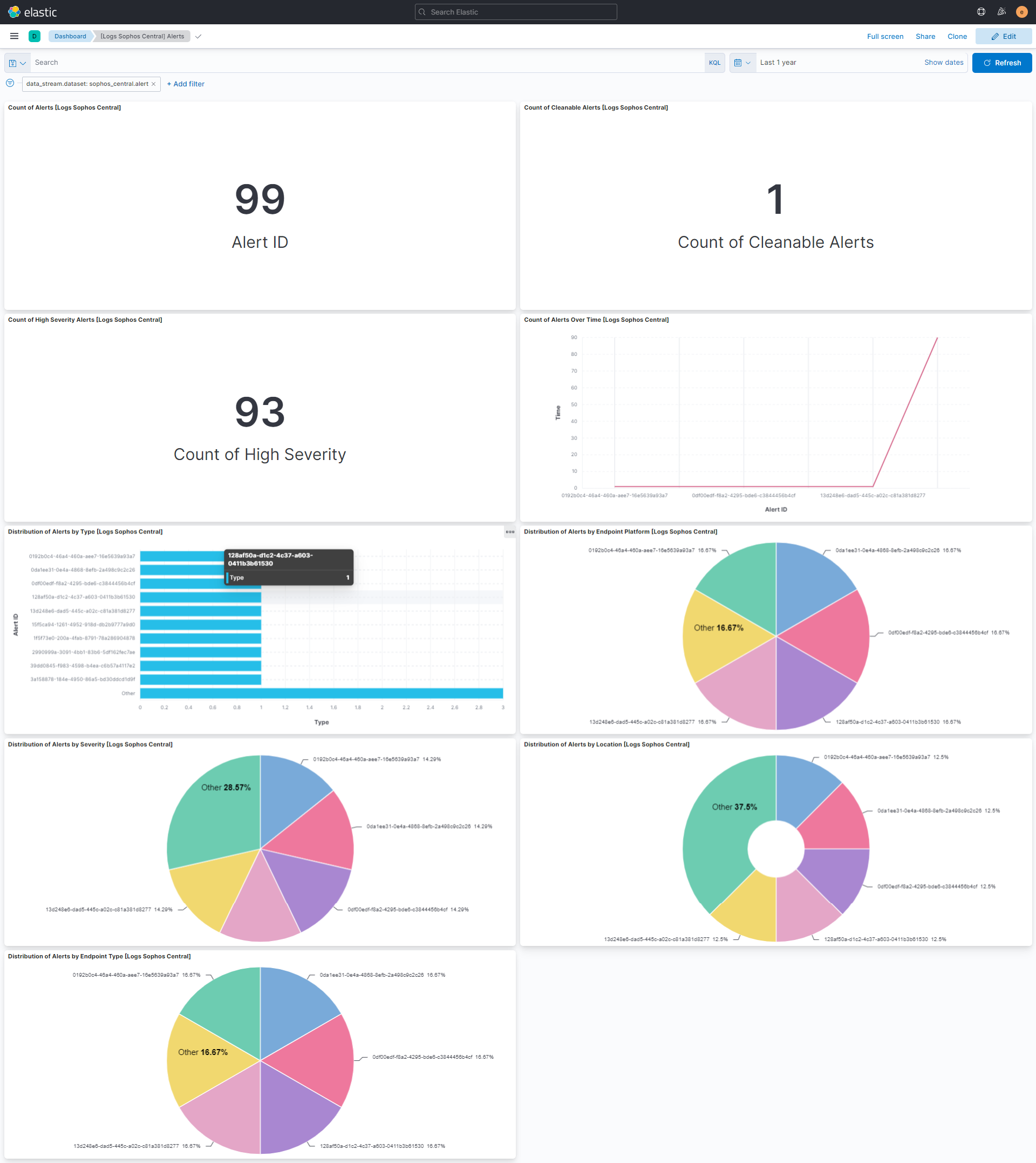

| sophos_central.alert.data.ips_threat.raw_data.sha_256 | sha 256 code of raw data. | keyword |
| sophos_central.alert.data.ips_threat.raw_data.signer | signer raw data of IPS threat. | keyword |
| sophos_central.alert.data.ips_threat.raw_data.version | Version raw data of IPS threat. | keyword |
| sophos_central.alert.data.ips_threat.remote.ip | Remote ip from which ips threat occured. | ip |
| sophos_central.alert.data.ips_threat.remote.port | Remote port of ips threat. | long |
| sophos_central.alert.data.ips_threat.tech_support_id | IPS tech support id. | keyword |
| sophos_central.alert.data.make_actionable_at | Action make date. | date |
| sophos_central.alert.data.policy_type | Alert policy type. | long |
| sophos_central.alert.data.source_app_id | Source App id. | keyword |
| sophos_central.alert.data.source_info_ip | This shows the IPv4 address of an endpoint. If there are multiple IP addresses, this will show the first ip reported. | ip |
| sophos_central.alert.data.threat_id.counter | Counter of threat. | long |
| sophos_central.alert.data.threat_id.date | Date of threat. | date |
| sophos_central.alert.data.threat_id.machine_identifier | Machine identifier of threat. | long |
| sophos_central.alert.data.threat_id.process_identifier | Process identifier of threat. | long |
| sophos_central.alert.data.threat_id.time | Time of threat. | date |
| sophos_central.alert.data.threat_id.time_sec | Second at which threat occured. | date |
| sophos_central.alert.data.threat_id.timestamp | Time at which threat id of data was created. | date |
| sophos_central.alert.data.threat_status | Status of threat. | keyword |
| sophos_central.alert.data.user_match_id.counter | Counter of user. | long |
| sophos_central.alert.data.user_match_id.date | Date of user match. | date |
| sophos_central.alert.data.user_match_id.machine_identifier | Machine identifier of user. | long |
| sophos_central.alert.data.user_match_id.process_identifier | Process identifier of user. | long |
| sophos_central.alert.data.user_match_id.time | Time of user match. | date |
| sophos_central.alert.data.user_match_id.time_sec | Second at which user matched. | date |
| sophos_central.alert.data.user_match_id.timestamp | Time at which user match id of data was created. | date |
| sophos_central.alert.data.user_match_uuid.data | UUID of user matched data. | keyword |
| sophos_central.alert.data.user_match_uuid.type | UUID of user matched type. | long |
| sophos_central.alert.description | The description of the alert that was generated. | keyword |
| sophos_central.alert.event_service_event_id | Unique identifier of the event. | keyword |
| sophos_central.alert.id | Unique identifier of the event. | keyword |
| sophos_central.alert.location | Location of alert. | keyword |
| sophos_central.alert.severity | The severity of the threat reported by the event; possible values are: None, Low, Medium, High, Critical. | keyword |
| sophos_central.alert.source.domain.name | Domain name of source. | keyword |
| sophos_central.alert.source.original | Describes the source from alert was generated. | keyword |
| sophos_central.alert.source.user.name | Username of source. | keyword |
| sophos_central.alert.threat.cleanable | Indicate if the threat can be cleaned automatically: True or False. | boolean |
| sophos_central.alert.threat.value | Name of the threat (as identified by threat_id). | keyword |
| sophos_central.alert.type | Event type. | keyword |
| sophos_central.alert.when | The date at which the alert was created. | date |

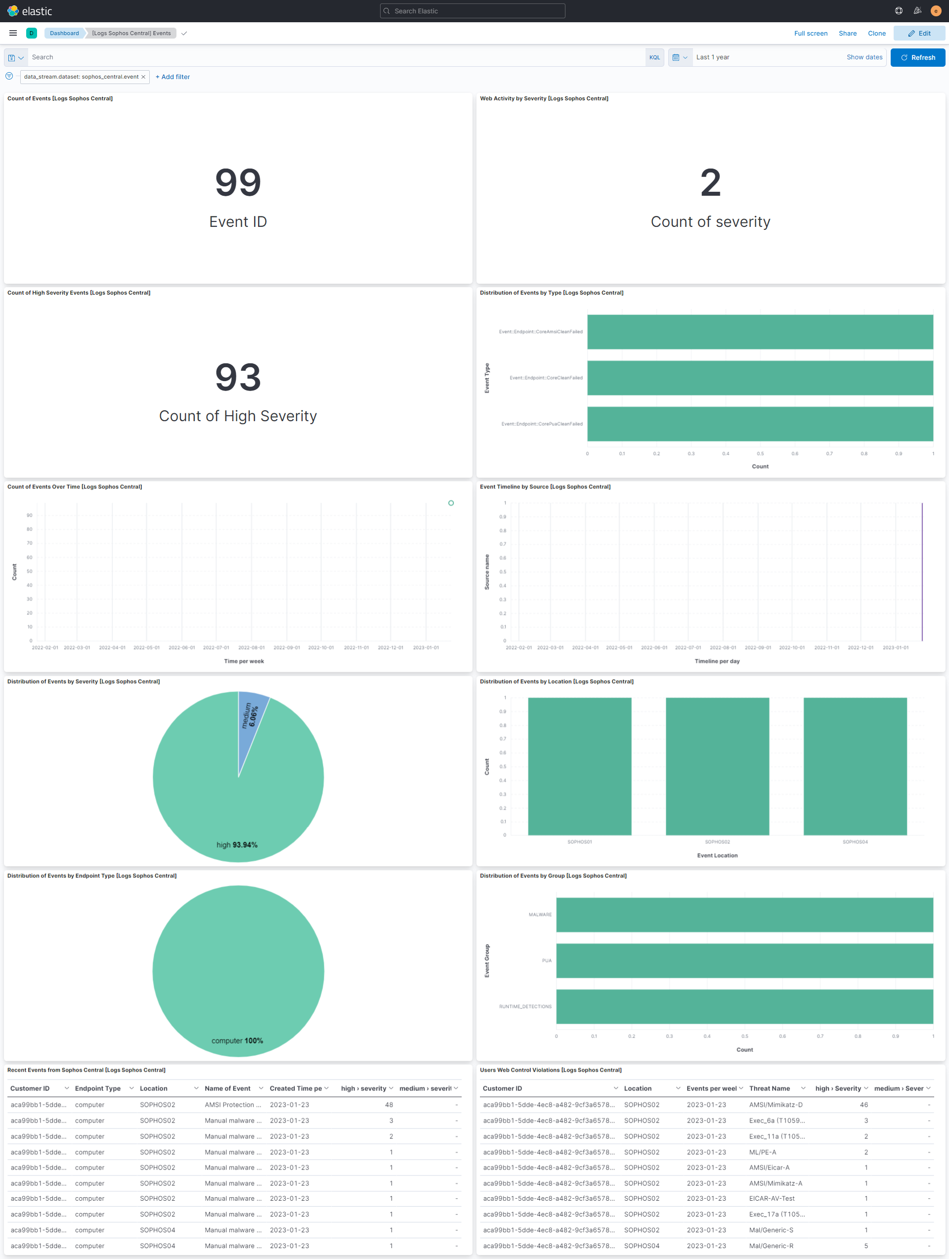

This is the events dataset.
Example
"@timestamp": "2022-12-06T12:27:28.094Z",
"agent": {
"ephemeral_id": "627751c7-a370-49b2-9b0b-a9d951b82a77",
"id": "60d39df7-b116-44e1-af54-276cb7941633",
"name": "elastic-agent-54968",
"type": "filebeat",
"version": "8.19.4"
"data_stream": {
"dataset": "sophos_central.event",
"namespace": "23181",
"type": "logs"
"destination": {
"ip": "81.2.69.192",
"port": 789
"ecs": {
"version": "8.11.0"
"elastic_agent": {
"snapshot": false,
"version": "8.19.4"
"event": {
"action": "Malicious inbound network traffic blocked from remote computer at 192.168.0.2 (Technical Support reference: 2019052901.77863414.5)",
"category": [
"host"
"created": "2022-12-06T12:27:31.310Z",
"id": "3dab71db-32c9-426a-8616-1e0fd5c9aab9",
"ingested": "2025-10-06T13:21:28Z",
"kind": [
"event"
"original": "{\"created_at\":\"2022-12-06T12:27:31.310Z\",\"customer_id\":\"d1271b33-4e24-4cc3-951a-badc38976ca3\",\"endpoint_id\":\"fb11564b-2882-44ea-ac64-d1bfb041ab49\",\"endpoint_type\":\"computer\",\"group\":\"RUNTIME_DETECTIONS\",\"id\":\"3dab71db-32c9-426a-8616-1e0fd5c9aab9\",\"ips_threat_data\":{\"detectionType\":0,\"executableName\":\"\",\"localPort\":\"123\",\"rawData\":\"Message OS-WINDOWS Microsoft Windows SMB remote code execution attempt\\nReference CVE-2017-0146\\nPacket type TCP\\nLocal IP: 81.2.69.192\\nLocal Port: 123\\nLocal MAC: 00:50:56:81:62:41\\nRemote IP: 81.2.69.192\\nRemote Port: 789\\nRemote MAC: 00:1C:B3:09:85:15\",\"remoteIp\":\"81.2.69.192\",\"remotePort\":\"789\",\"techSupportId\":\"2019052901.77863414.5\"},\"location\":\"Lightning-4naq56bx4j\",\"name\":\"Malicious inbound network traffic blocked from remote computer at 192.168.0.2 (Technical Support reference: 2019052901.77863414.5)\",\"severity\":\"low\",\"source\":\"Lightning-a3i691l7cv\\\\Lightning\",\"source_info\":{\"ip\":\"81.2.69.192\"},\"threat\":\"IPS/Inbound/7777001\",\"type\":\"Event::Endpoint::Threat::IpsInboundDetection\",\"user_id\":\"638f34e1e5d0a20f3d40cf93\",\"when\":\"2022-12-06T12:27:28.094Z\"}",
"type": [
"info"
"input": {
"type": "httpjson"
"organization": {
"id": "d1271b33-4e24-4cc3-951a-badc38976ca3"
"related": {
"ip": [
"81.2.69.192"
"sophos_central": {
"event": {
"created_at": "2022-12-06T12:27:31.310Z",
"customer_id": "d1271b33-4e24-4cc3-951a-badc38976ca3",
"endpoint": {
"id": "fb11564b-2882-44ea-ac64-d1bfb041ab49",
"type": "computer"
"group": "RUNTIME_DETECTIONS",
"ips_threat_data": {
"detection_type": 0,
"local_port": 123,
"raw_data": {
"local": {
"mac": "00-50-56-81-62-41",
"port": 123
"message": "OS-WINDOWS Microsoft Windows SMB remote code execution attempt",
"original": "Message OS-WINDOWS Microsoft Windows SMB remote code execution attempt\nReference CVE-2017-0146\nPacket type TCP\nLocal IP: 81.2.69.192\nLocal Port: 123\nLocal MAC: 00:50:56:81:62:41\nRemote IP: 81.2.69.192\nRemote Port: 789\nRemote MAC: 00:1C:B3:09:85:15",
"packet_type": "TCP",
"reference": "CVE-2017-0146",
"remote": {
"mac": "00-1C-B3-09-85-15",
"port": 789
"remote": {
"port": 789
"tech_support_id": "2019052901.77863414.5"
"location": "Lightning-4naq56bx4j",
"name": "Malicious inbound network traffic blocked from remote computer at 192.168.0.2 (Technical Support reference: 2019052901.77863414.5)",
"severity": "low",
"source": {
"domain": {
"name": "Lightning-a3i691l7cv"
"original": "Lightning-a3i691l7cv\\Lightning",
"user": {
"name": "Lightning"
"source_info": {
"ip": "81.2.69.192"
"threat": "IPS/Inbound/7777001",
"type": "Event::Endpoint::Threat::IpsInboundDetection",
"user_id": "638f34e1e5d0a20f3d40cf93",
"when": "2022-12-06T12:27:28.094Z"
"source": {
"port": 123
"tags": [
"preserve_original_event",
"preserve_duplicate_custom_fields",
"forwarded",
"sophos_central-event"
"threat": {
"feed": {
"name": "IPS/Inbound/7777001"
"user": {
"domain": "Lightning-a3i691l7cv",
"id": "638f34e1e5d0a20f3d40cf93",
"name": "Lightning"
Exported fields
| event.dataset | Event dataset. | constant_keyword |
| event.module | Event module. | constant_keyword |
| input.type | Type of Filebeat input. | keyword |
| log.offset | Log offset. | long |
| log.source.address | Source address from which the log event was read / sent from. | keyword |
| sophos_central.event.amsi_threat_data.parent_process.id | Parent process id of amsi_threat_data. | keyword |
| sophos_central.event.amsi_threat_data.parent_process.path | Parent process path of amsi_threat_data. | keyword |
| sophos_central.event.amsi_threat_data.process.id | Process ID of amsi_threat_data. | keyword |
| sophos_central.event.amsi_threat_data.process.name | Process name of amsi_threat_data. | keyword |
| sophos_central.event.amsi_threat_data.process.path | Process path of amsi_threat_data. | keyword |
| sophos_central.event.app_certs.signer | Certificate info of the singer with the threat, if available. | keyword |
| sophos_central.event.app_certs.thumbprint | Certificate info of the thumbprint with the threat, if available. | keyword |
| sophos_central.event.app_sha256 | SHA 256 hash of the application associated with the threat, if available. | keyword |
| sophos_central.event.core_remedy.items.descriptor | Descriptor of Core remedy items. | keyword |
| sophos_central.event.core_remedy.items.process_path | Process path of core remedy items. | keyword |
| sophos_central.event.core_remedy.items.result | The following values are allowed NOT_APPLICABLE, SUCCESS, NOT_FOUND, DELETED, FAILED_TO_DELETE, WHITELISTED, OTHER_ERROR, FAILED_TO_DELETE_SYSTEM_PROTECTED. | keyword |
| sophos_central.event.core_remedy.items.sophos_pid | Sophos process ID. | keyword |
| sophos_central.event.core_remedy.items.suspend_result | Suspend result of core remedy items. | keyword |
| sophos_central.event.core_remedy.items.type | Type of Core remedy items. | keyword |
| sophos_central.event.core_remedy.total_items | Total items of core remedy. | long |
| sophos_central.event.created_at | The date at which the event was created. | date |
| sophos_central.event.customer_id | The identifier of the customer for which record is created. | keyword |
| sophos_central.event.endpoint.id | The corresponding endpoint id associated with the record. | keyword |
| sophos_central.event.endpoint.type | The corresponding endpoint type associated with the record. | keyword |
| sophos_central.event.group | The group associated with the group. | keyword |
| sophos_central.event.id | The Identifier for the event. | keyword |
| sophos_central.event.ips_threat_data.detection_type | Detection type of IPS threat. | long |
| sophos_central.event.ips_threat_data.executable.name | Name of executable ips threat. | keyword |
| sophos_central.event.ips_threat_data.executable.path | Path of executable ips threat. | keyword |
| sophos_central.event.ips_threat_data.executable.pid | Process id of executable ips threat. | long |
| sophos_central.event.ips_threat_data.executable.version | Version of executable ips threat. | keyword |
| sophos_central.event.ips_threat_data.local_port | Local port of IPS threat. | long |
| sophos_central.event.ips_threat_data.raw_data.executable | Executable raw data of IPS threat. | keyword |
| sophos_central.event.ips_threat_data.raw_data.local.ip | Local ip in raw data of IPS threat. | ip |
| sophos_central.event.ips_threat_data.raw_data.local.mac | Local mac in raw data of IPS threat. | keyword |
| sophos_central.event.ips_threat_data.raw_data.local.port | Local port in raw data of IPS threat. | long |
| sophos_central.event.ips_threat_data.raw_data.message | Original raw data of IPS threat. | keyword |
| sophos_central.event.ips_threat_data.raw_data.original | Original raw data of IPS threat. | keyword |
| sophos_central.event.ips_threat_data.raw_data.packet_type | Packet type in raw data of IPS threat. | keyword |
| sophos_central.event.ips_threat_data.raw_data.pid | PID raw data of IPS threat. | keyword |
| sophos_central.event.ips_threat_data.raw_data.reference | Original raw data of IPS threat. | keyword |
| sophos_central.event.ips_threat_data.raw_data.remote.ip | Remote IP in raw data of IPS threat. | ip |
| sophos_central.event.ips_threat_data.raw_data.remote.mac | Remote mac in raw data of IPS threat. | keyword |
| sophos_central.event.ips_threat_data.raw_data.remote.port | Remote port in raw data of IPS threat. | long |
| sophos_central.event.ips_threat_data.raw_data.sha_256 | SHA 256 code of raw data. | keyword |
| sophos_central.event.ips_threat_data.raw_data.signer | Signer raw data of IPS threat. | keyword |
| sophos_central.event.ips_threat_data.raw_data.version | Version raw data of IPS threat. | keyword |
| sophos_central.event.ips_threat_data.remote.ip | Remote IP of IPS threat. | ip |
| sophos_central.event.ips_threat_data.remote.port | Remote Port of IPS threat. | long |
| sophos_central.event.ips_threat_data.tech_support_id | Tech support ID of IPS threat. | keyword |
| sophos_central.event.location | The location captured for this record. | keyword |
| sophos_central.event.name | The name of the record created. | keyword |
| sophos_central.event.origin | Originating component of a detection. | keyword |
| sophos_central.event.severity | The severity of the threat reported by the event; possible values are None (0), Low (1), Medium (2), High (3), Critical (4). | keyword |
| sophos_central.event.source.domain.name | Domain name of source. | keyword |
| sophos_central.event.source.original | Describes the source from alert was generated. | keyword |
| sophos_central.event.source.user.name | Username of source. | keyword |
| sophos_central.event.source_info.ip | Detailed source information for IP. | ip |
| sophos_central.event.threat | The threat associated with the record. | keyword |
| sophos_central.event.type | The type of this record. | keyword |
| sophos_central.event.user_id | The identifier of the user for which record is created. | keyword |
| sophos_central.event.when | The date at which the event was created. | date |
