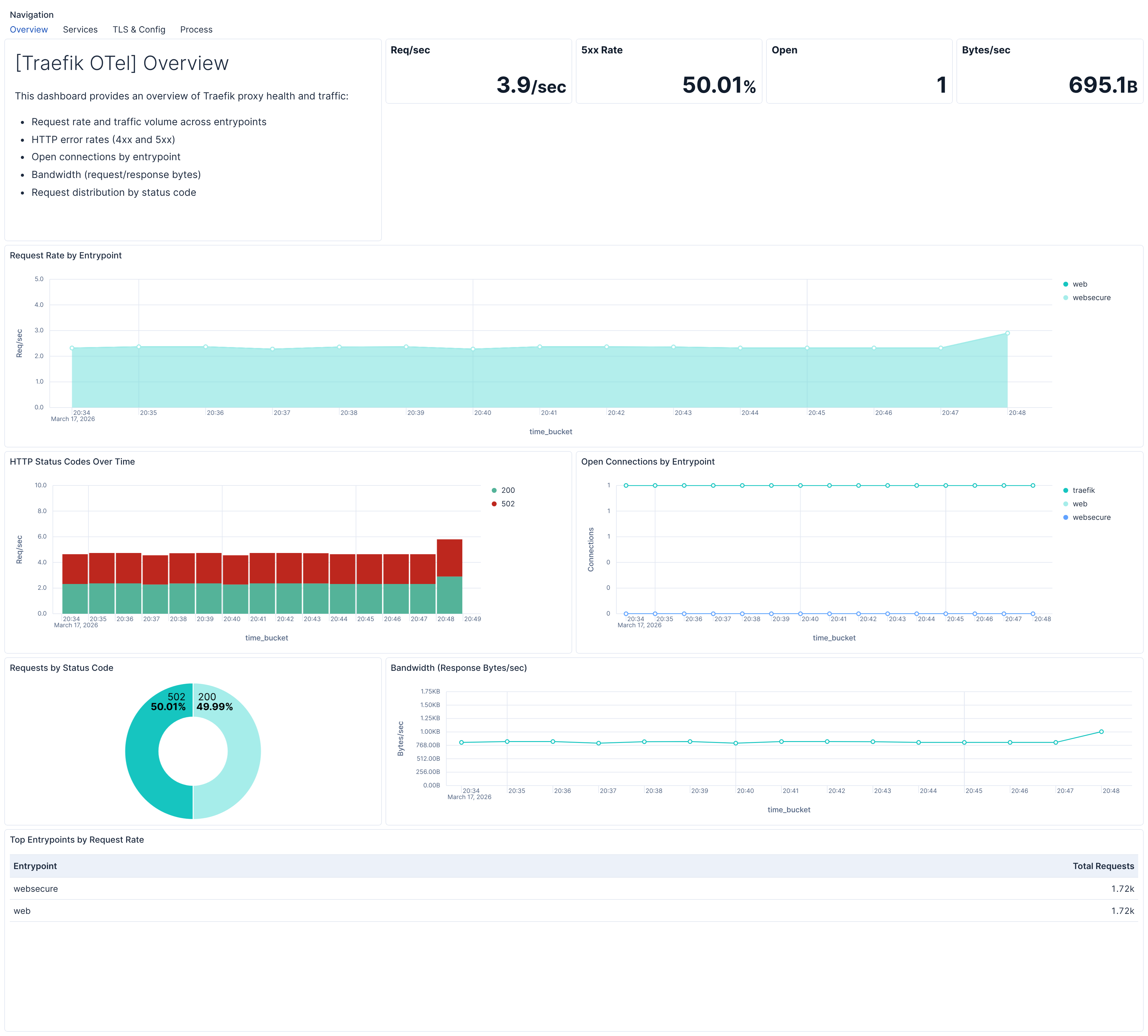

| [Traefik OTel] Overview | High-level Traefik proxy health and traffic flow: request rates, error rates, open connections, and bandwidth. |

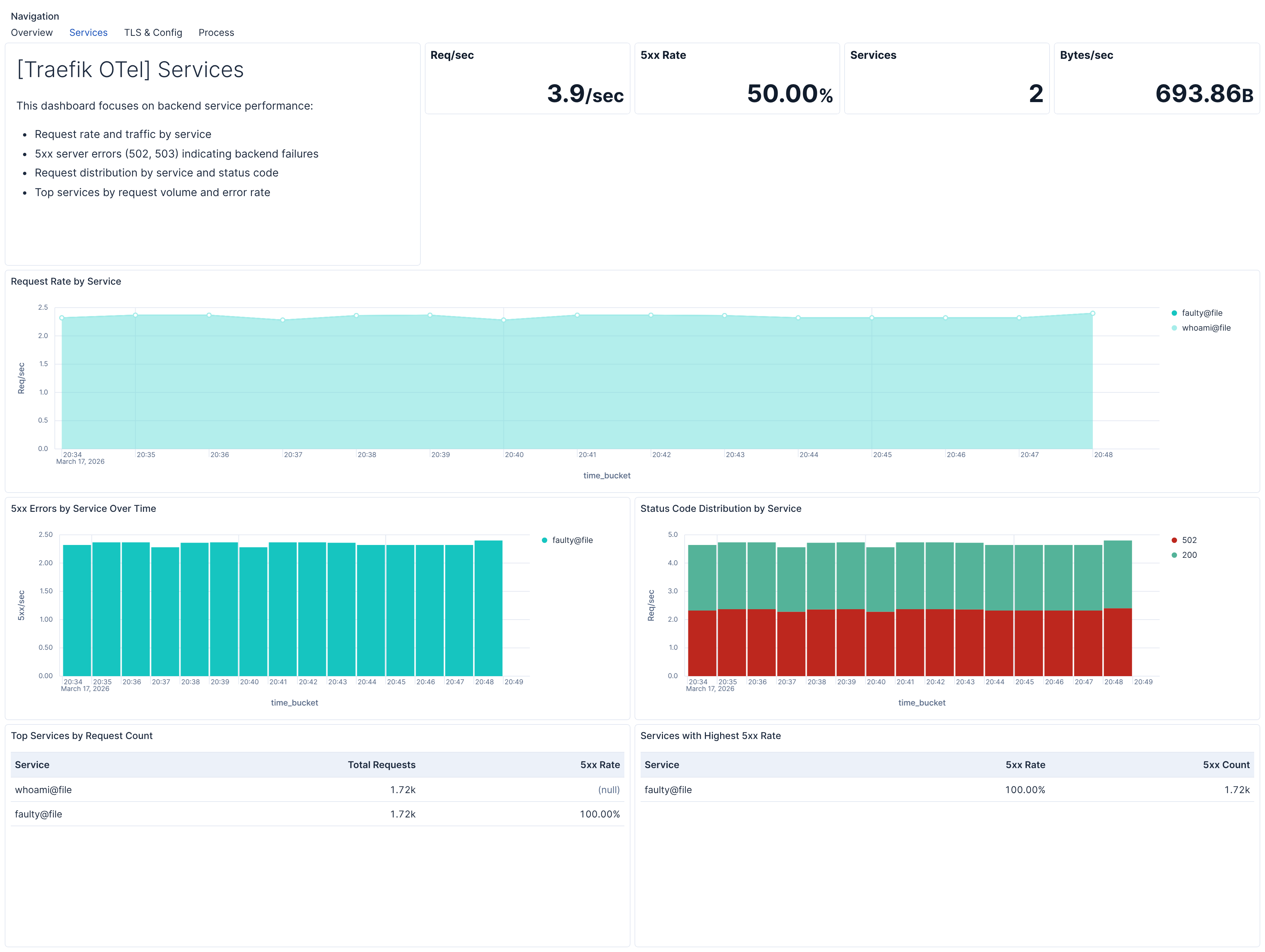

| [Traefik OTel] Services | Backend service traffic, error rates, and performance for identifying failing backends. |

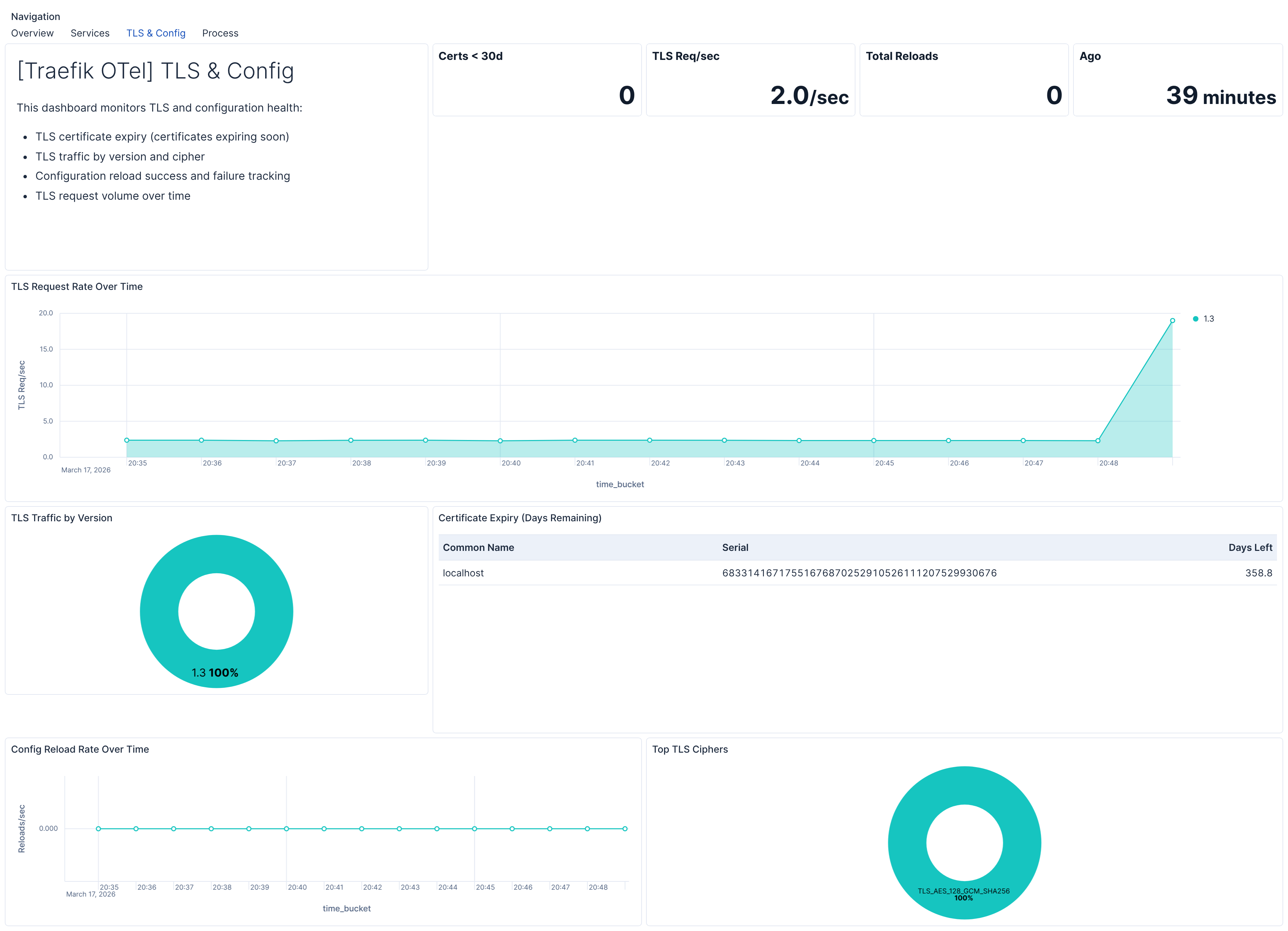

| [Traefik OTel] TLS & Config | TLS certificate expiry, TLS traffic distribution, and configuration reload health. |

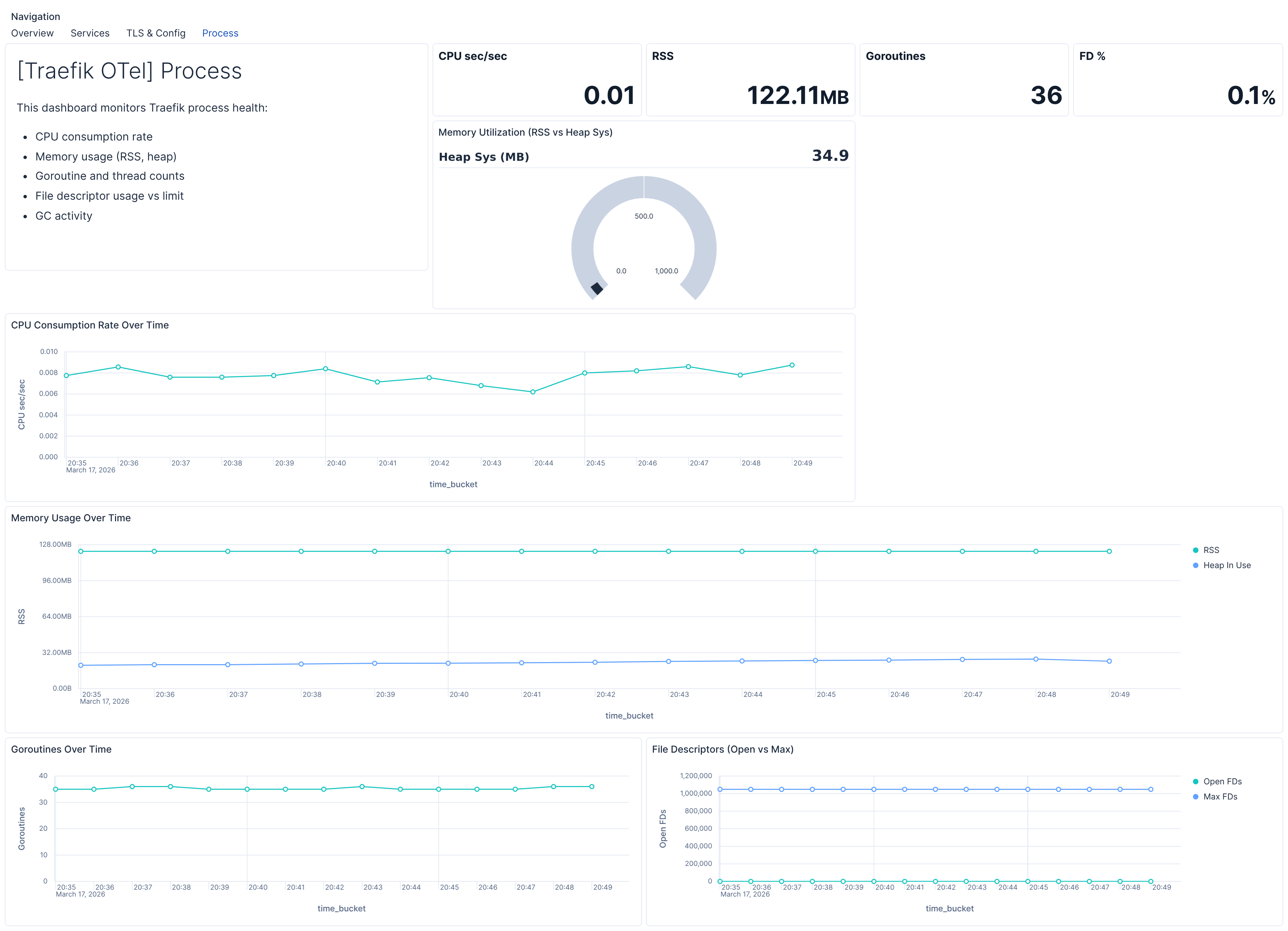

| [Traefik OTel] Process | Traefik process health: CPU, memory, goroutines, and file descriptor usage. |
