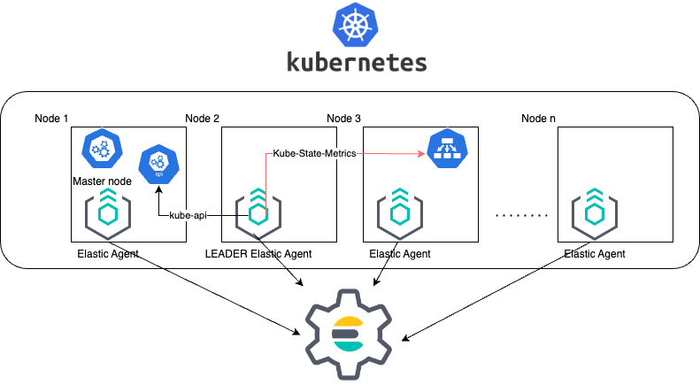

The default manifest provided deploys Elastic Agent as DaemonSet which results in an Elastic Agent being deployed on every node of the Kubernetes cluster.
Additionally, by default one agent is elected as leader (for more information visit Kubernetes LeaderElection Provider). The Elastic Agent Pod which holds the leadership lock is responsible for collecting the cluster-wide metrics in addition to its node’s metrics.
Elastic Agent as daemonset
The above schema explains how Elastic Agent collects and sends metrics to Elasticsearch. Because of Leader Agent being responsible to also collecting cluster-lever metrics, this means that it requires additional resources.
The DaemonSet deployment approach with leader election simplifies the installation of the Elastic Agent because we define less Kubernetes Resources in our manifest and we only need one single Agent policy for our Agents. Hence it is the default supported method for Managed Elastic Agent installation

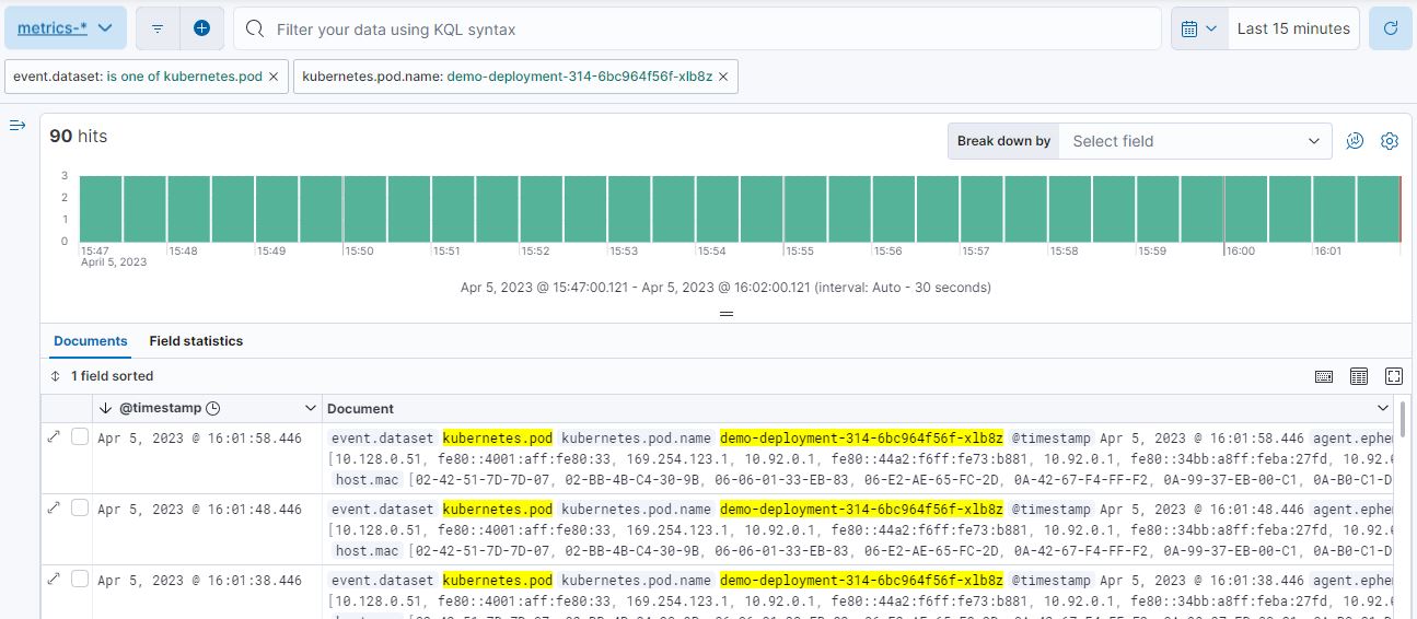

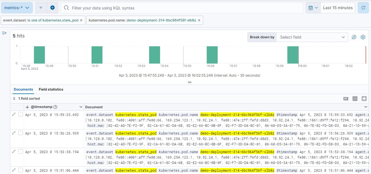

Kibana Discovery can be used to identify frequency of your metrics being ingested.
Filter for Pod dataset:
Kubernetes Pod Metricset
Filter for State_Pod dataset
Kubernetes State Pod Metricset
Identify how many events have been sent to Elasticsearch:
kubectl logs -n kube-system elastic-agent-h24hh -f | grep -i state_pod
[output truncated ...]
"state_pod":{"events":2936,"success":2936}
The number of events denotes the number of documents that should be depicted inside Kibana Discovery page.
For example, in a cluster with 798 pods, then 798 docs should be depicted in block of ingestion inside Kibana.
