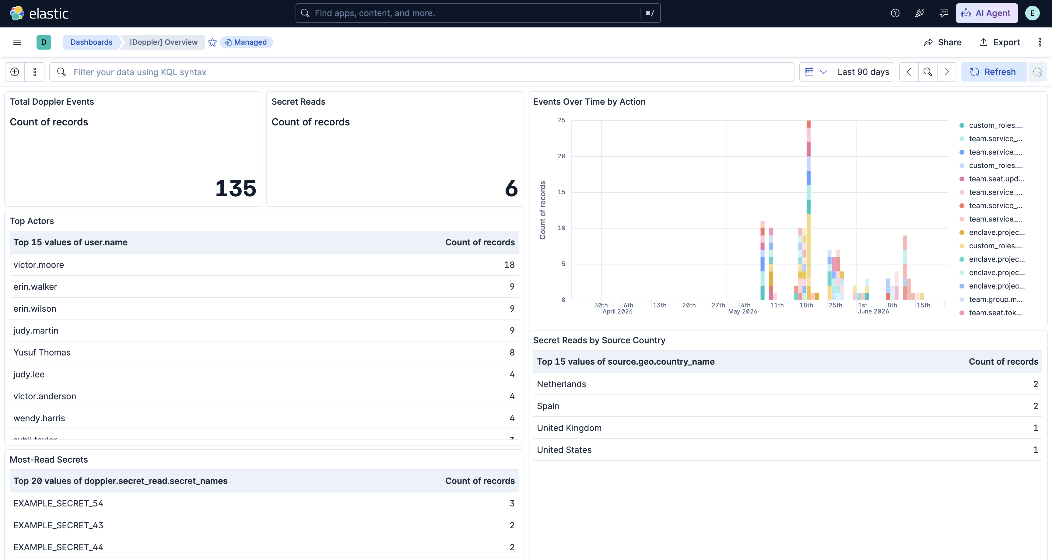

The integration ships a Doppler Overview dashboard that summarizes activity and secret-access events — event volume over time, top actors and actions, and a breakdown of secret reads by method and geography. It is tagged Security Solution, so it also appears in the Security app, and can be found in Kibana under Dashboards after installing the integration.
