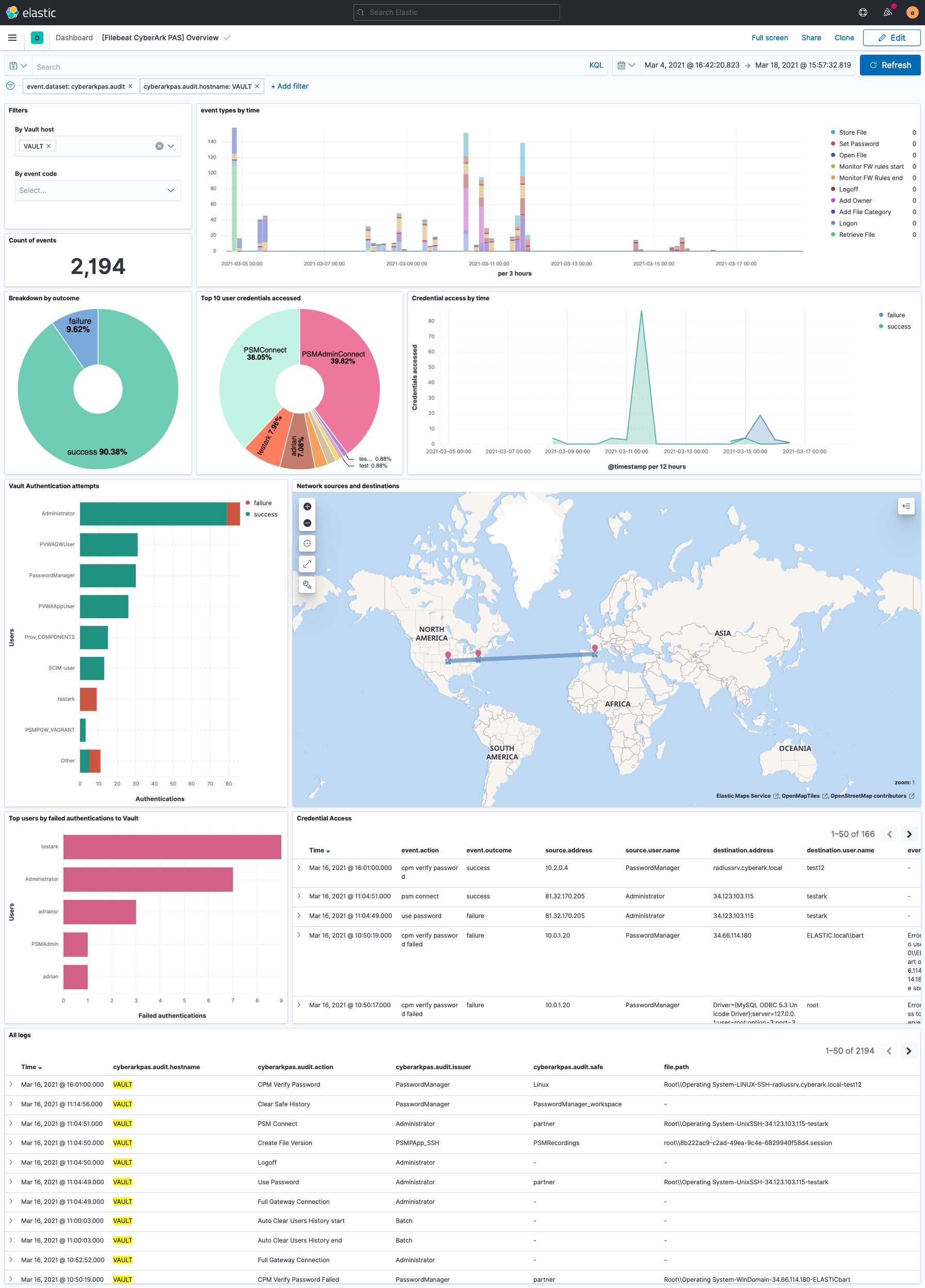

The CyberArk Privileged Access Security integration collects audit logs and monitoring data from CyberArk's Vault server.
The audit data stream receives Vault Audit logs for User and Safe activities over the syslog protocol.
It will also receive monitoring data from the server and route it to the monitor data stream (e.g. logs-cyberarkpas.monitor-default).
Follow the steps under Security Information and Event Management (SIEM) Applications documentation to setup the integration:
Copy the elastic-json-v1.0.xsl XSL Translator file to the
Server\Syslogfolder.Sample syslog configuration for
DBPARM.ini:
[SYSLOG]
UseLegacySyslogFormat=no
SyslogTranslatorFile=Syslog\elastic-json-v1.0.xsl
SyslogServerIP=<INSERT FILEBEAT IP HERE>
SyslogServerPort=<INSERT FILEBEAT PORT HERE>
SyslogServerProtocol=TCP
SendMonitoringMessage=yes
For proper timestamping of events, it's recommended to use the newer RFC5424 Syslog format
(UseLegacySyslogFormat=No). To avoid event loss, use TCP or TLS protocols instead of UDP.
The sample configuration above will include monitoring data. For more information about monitoring, see Monitor the Vault in SIEM Applications Using Syslog.
Example
"@timestamp": "2021-03-04T17:27:14.000Z",
"agent": {
"ephemeral_id": "2e1e0d3f-9ac4-4f6a-816b-2b2b7400148a",
"id": "5607d6f4-6e45-4c33-a087-2e07de5f0082",
"name": "docker-fleet-agent",
"type": "filebeat",
"version": "8.9.1"
"cyberarkpas": {
"audit": {
"action": "Logon",
"desc": "Logon",
"iso_timestamp": "2021-03-04T17:27:14Z",
"issuer": "PVWAGWUser",
"message": "Logon",
"rfc5424": true,
"severity": "Info",
"station": "10.0.1.20",
"timestamp": "Mar 04 09:27:14"
"data_stream": {
"dataset": "cyberarkpas.audit",
"namespace": "ep",
"type": "logs"
"ecs": {
"version": "8.11.0"
"elastic_agent": {
"snapshot": false,
"version": "8.9.1"
"event": {
"action": "authentication_success",
"category": [
"authentication",
"session"
"code": "7",
"ingested": "2023-08-29T14:16:49Z",
"kind": "event",
"outcome": "success",
"severity": 2,
"timezone": "+00:00",
"type": [
"start"
"host": {
"name": "VAULT"
"input": {
"type": "tcp"
"log": {
"source": {
"address": "172.21.0.4:38370"
"syslog": {
"priority": 5
"observer": {
"hostname": "VAULT",
"product": "Vault",
"vendor": "Cyber-Ark",
"version": "11.7.0000"
"related": {
"ip": [
"10.0.1.20"
"user": [
"PVWAGWUser"
"source": {
"address": "10.0.1.20",
"ip": "10.0.1.20"
"tags": [
"cyberarkpas-audit",
"forwarded"
"user": {
"name": "PVWAGWUser"
Exported fields
| cyberarkpas.audit.action | A description of the audit record. | keyword |
| cyberarkpas.audit.ca_properties.address | keyword | |
| cyberarkpas.audit.ca_properties.cpm_disabled | keyword | |
| cyberarkpas.audit.ca_properties.cpm_error_details | keyword | |
| cyberarkpas.audit.ca_properties.cpm_status | keyword | |
| cyberarkpas.audit.ca_properties.creation_method | keyword | |
| cyberarkpas.audit.ca_properties.customer | keyword | |
| cyberarkpas.audit.ca_properties.database | keyword | |
| cyberarkpas.audit.ca_properties.device_type | keyword | |
| cyberarkpas.audit.ca_properties.dual_account_status | keyword | |
| cyberarkpas.audit.ca_properties.group_name | keyword | |
| cyberarkpas.audit.ca_properties.in_process | keyword | |
| cyberarkpas.audit.ca_properties.index | keyword | |
| cyberarkpas.audit.ca_properties.last_fail_date | keyword | |
| cyberarkpas.audit.ca_properties.last_success_change | keyword | |
| cyberarkpas.audit.ca_properties.last_success_reconciliation | keyword | |
| cyberarkpas.audit.ca_properties.last_success_verification | keyword | |
| cyberarkpas.audit.ca_properties.last_task | keyword | |
| cyberarkpas.audit.ca_properties.logon_domain | keyword | |
| cyberarkpas.audit.ca_properties.other | flattened | |
| cyberarkpas.audit.ca_properties.policy_id | keyword | |
| cyberarkpas.audit.ca_properties.port | keyword | |
| cyberarkpas.audit.ca_properties.privcloud | keyword | |
| cyberarkpas.audit.ca_properties.reset_immediately | keyword | |
| cyberarkpas.audit.ca_properties.retries_count | keyword | |
| cyberarkpas.audit.ca_properties.sequence_id | keyword | |
| cyberarkpas.audit.ca_properties.tags | keyword | |
| cyberarkpas.audit.ca_properties.user_dn | keyword | |
| cyberarkpas.audit.ca_properties.user_name | keyword | |
| cyberarkpas.audit.ca_properties.virtual_username | keyword | |
| cyberarkpas.audit.category | The category name (for category-related operations). | keyword |
| cyberarkpas.audit.desc | A static value that displays a description of the audit codes. | keyword |
| cyberarkpas.audit.extra_details.ad_process_id | keyword | |
| cyberarkpas.audit.extra_details.ad_process_name | keyword | |
| cyberarkpas.audit.extra_details.application_type | keyword | |
| cyberarkpas.audit.extra_details.command | keyword | |
| cyberarkpas.audit.extra_details.connection_component_id | keyword | |
| cyberarkpas.audit.extra_details.dst_host | keyword | |
| cyberarkpas.audit.extra_details.logon_account | keyword | |
| cyberarkpas.audit.extra_details.managed_account | keyword | |
| cyberarkpas.audit.extra_details.other | flattened | |
| cyberarkpas.audit.extra_details.process_id | keyword | |
| cyberarkpas.audit.extra_details.process_name | keyword | |
| cyberarkpas.audit.extra_details.protocol | keyword | |
| cyberarkpas.audit.extra_details.psmid | keyword | |
| cyberarkpas.audit.extra_details.session_duration | keyword | |
| cyberarkpas.audit.extra_details.session_id | keyword | |
| cyberarkpas.audit.extra_details.src_host | keyword | |
| cyberarkpas.audit.extra_details.username | keyword | |
| cyberarkpas.audit.file | The name of the target file. | keyword |
| cyberarkpas.audit.gateway_station | The IP of the web application machine (PVWA). | ip |
| cyberarkpas.audit.hostname | The hostname, in upper case. | keyword |
| cyberarkpas.audit.iso_timestamp | The timestamp, in ISO Timestamp format (RFC 3339). | date |
| cyberarkpas.audit.issuer | The Vault user who wrote the audit. This is usually the user who performed the operation. | keyword |
| cyberarkpas.audit.location | The target Location (for Location operations). | keyword |
| cyberarkpas.audit.message | A description of the audit records (same information as in the Desc field). | keyword |
| cyberarkpas.audit.message_id | The code ID of the audit records. | keyword |
| cyberarkpas.audit.product | A static value that represents the product. | keyword |
| cyberarkpas.audit.pvwa_details | Specific details of the PVWA audit records. | flattened |
| cyberarkpas.audit.raw | Raw XML for the original audit record. Only present when XSLT file has debugging enabled. | keyword |
| cyberarkpas.audit.reason | The reason entered by the user. | text |
| cyberarkpas.audit.rfc5424 | Whether the syslog format complies with RFC5424. | boolean |
| cyberarkpas.audit.safe | The name of the target Safe. | keyword |
| cyberarkpas.audit.severity | The severity of the audit records. | keyword |
| cyberarkpas.audit.source_user | The name of the Vault user who performed the operation. | keyword |
| cyberarkpas.audit.station | The IP from where the operation was performed. For PVWA sessions, this will be the real client machine IP. | ip |
| cyberarkpas.audit.target_user | The name of the Vault user on which the operation was performed. | keyword |
| cyberarkpas.audit.timestamp | The timestamp, in MMM DD HH:MM:SS format. | keyword |
| cyberarkpas.audit.vendor | A static value that represents the vendor. | keyword |
| cyberarkpas.audit.version | A static value that represents the version of the Vault. | keyword |
| event.dataset | Event dataset | constant_keyword |
| event.module | Name of the module this data is coming from. | constant_keyword |
| input.type | Type of Filebeat input. | keyword |
| log.flags | Flags for the log file. | keyword |
| log.offset | Offset of the entry in the log file. | long |
| log.source.address | Source address from which the log event was read / sent from. | keyword |

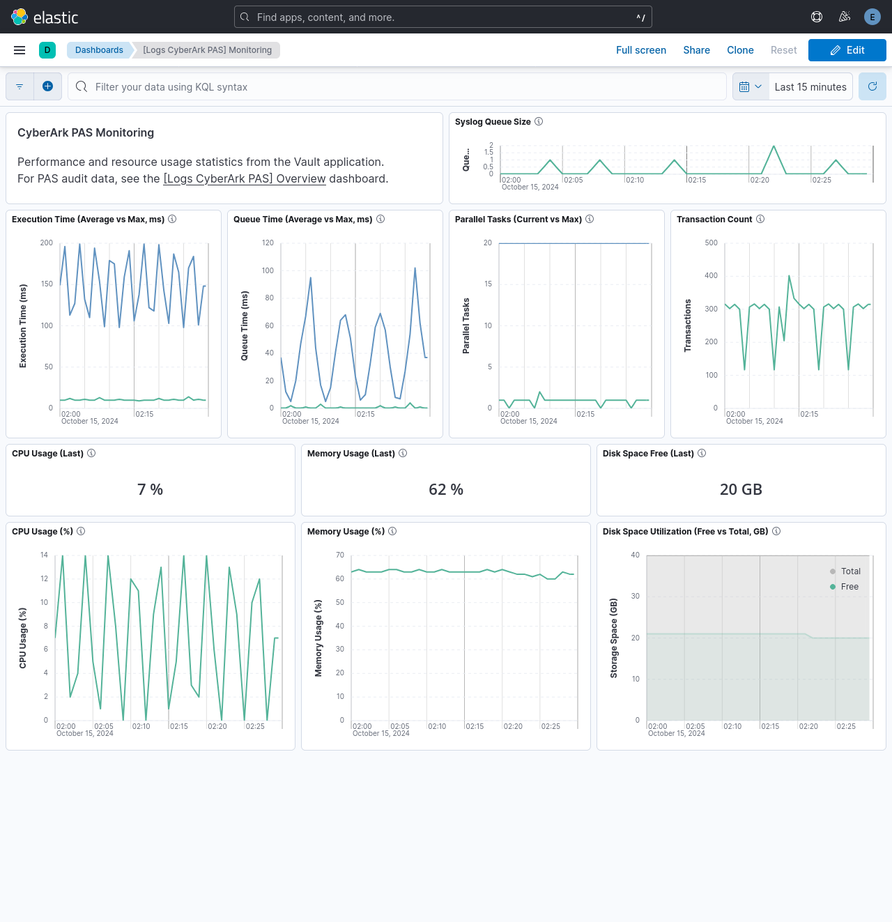

Example
"@timestamp": "2024-10-15T00:29:00.000Z",
"agent": {
"name": "elastic-agent-85013",
"id": "0a6fa575-a3ed-463b-b47f-9c3e3a07e56f",
"ephemeral_id": "c2d94886-0c83-475b-b25b-7e136a32240d",
"type": "filebeat",
"version": "8.14.3"
"cyberarkpas": {
"monitor": {
"syslog_queue_size": 0,
"iso_timestamp": "2024-10-15T00:29:00Z",
"drive_free_space_in_gb": 20,
"drive_total_space_in_gb": 40,
"max_parallel_tasks": 20,
"transaction_count": 315,
"memory_usage": 62,
"average_queue_time": 0,
"max_execution_time": 148,
"version": "11.7.0029",
"average_execution_time": 10,
"max_queue_time": 37,
"number_of_parallel_tasks": 1,
"cpu_usage": 7,
"timestamp": "Oct 15 00:29:00"
"data_stream": {
"namespace": "22830",
"type": "logs",
"dataset": "cyberarkpas.monitor"
"ecs": {
"version": "8.11.0"
"elastic_agent": {
"version": "8.14.3",
"snapshot": false
"event": {
"ingested": "2024-10-21T07:32:45Z",
"kind": "metric",
"host": {
"name": "VAULT",
"cpu": {
"usage": 0.07
"input": {
"type": "log"
"log": {
"file": {
"path": "/tmp/service_logs/monitor.log"
"offset": 15547
"observer": {
"product": "VaultMonitor",
"related": {
"hosts": [
"VAULT"
"tags": [
"forwarded",
"cyberarkpas-monitor"
Exported fields
| cyberarkpas.monitor.average_execution_time | The average time it has taken the Vault to complete the execution of a transaction in the last minute, in milliseconds. | integer |
| cyberarkpas.monitor.average_queue_time | The average time that a transaction waited in the Vault's queue for execution in the last minute, in milliseconds. | integer |
| cyberarkpas.monitor.cpu_usage | Percent of CPU usage on the Vault machine. | integer |
| cyberarkpas.monitor.drive_free_space_in_gb | Number of GB available on the drive of the Vault installation folder. | integer |
| cyberarkpas.monitor.drive_total_space_in_gb | Total number of GB on the drive of the Vault installation folder. | integer |
| cyberarkpas.monitor.iso_timestamp | The timestamp, in ISO timestamp format (RFC 3339). | date |
| cyberarkpas.monitor.max_execution_time | The maximum time it has taken the Vault to complete the execution of a transaction, in the last minute, in milliseconds. | integer |
| cyberarkpas.monitor.max_parallel_tasks | The maximum number of Vault transactions that can run concurrently, based on the TasksCount parameter in DBParm.ini. | integer |
| cyberarkpas.monitor.max_queue_time | The maximum time that a transaction waited in the Vault's queue for execution in the last minute, in millisecond. | integer |
| cyberarkpas.monitor.memory_usage | Percent of used physical memory on the Vault machine. | integer |
| cyberarkpas.monitor.number_of_parallel_tasks | Number of Vault transactions that are currently running. | integer |
