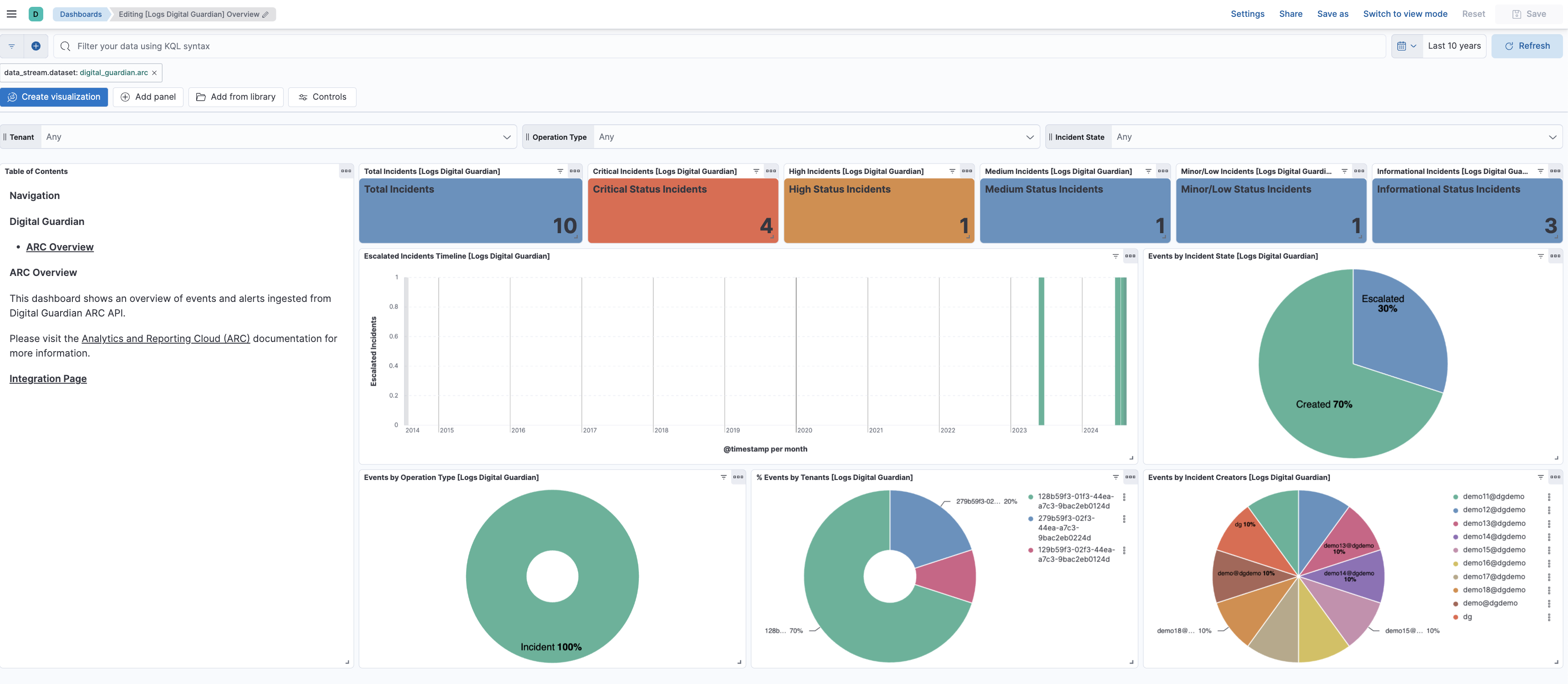

This integration is for ingesting events and alerts from Fortra's Digital Guardian. Fortra’s Digital Guardian helps organizations protect data, performing across the corporate network, traditional endpoints, and cloud applications. Digital Guardian's data loss prevention, available as a software-as-a-service or managed service, helps to see that data, support compliance initiatives, and protect against serious risk.
The integration allows collection of events and alerts from Digital Guardian Analytics & Reporting Cloud (ARC) via the REST API.
