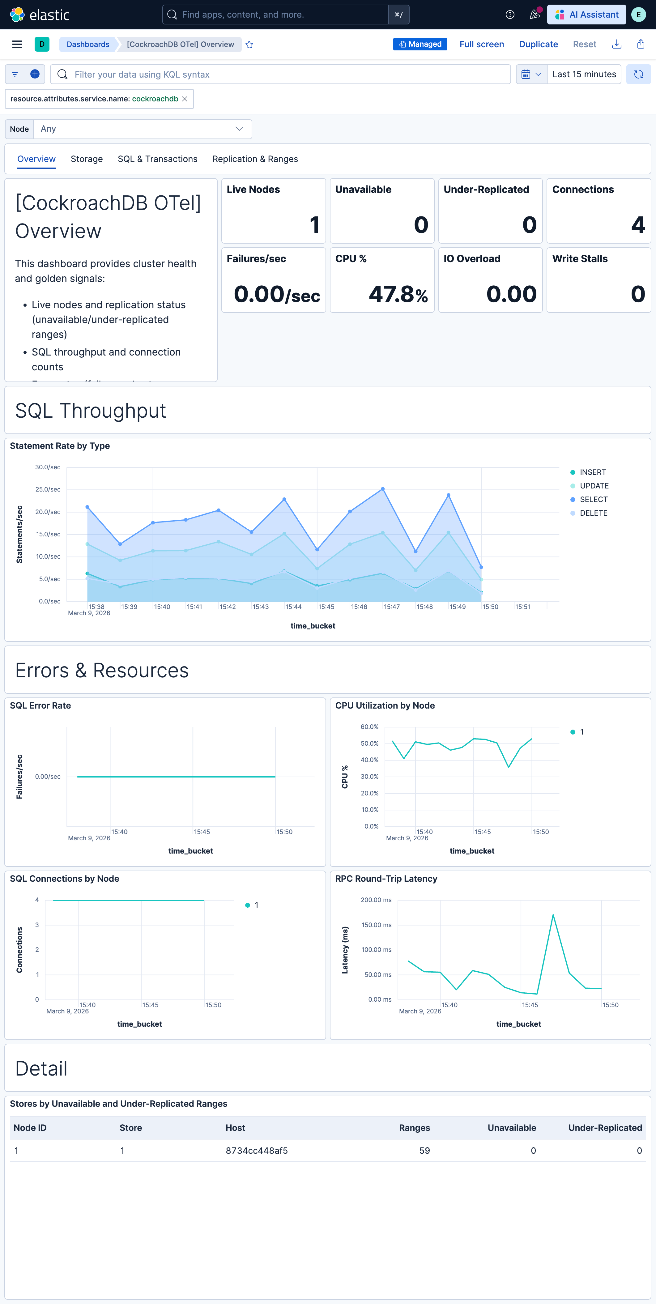

| [CockroachDB OTel] Overview | Cluster health, availability, and golden signals for CockroachDB. Covers live nodes, replication status, SQL throughput, errors, CPU, and storage. |

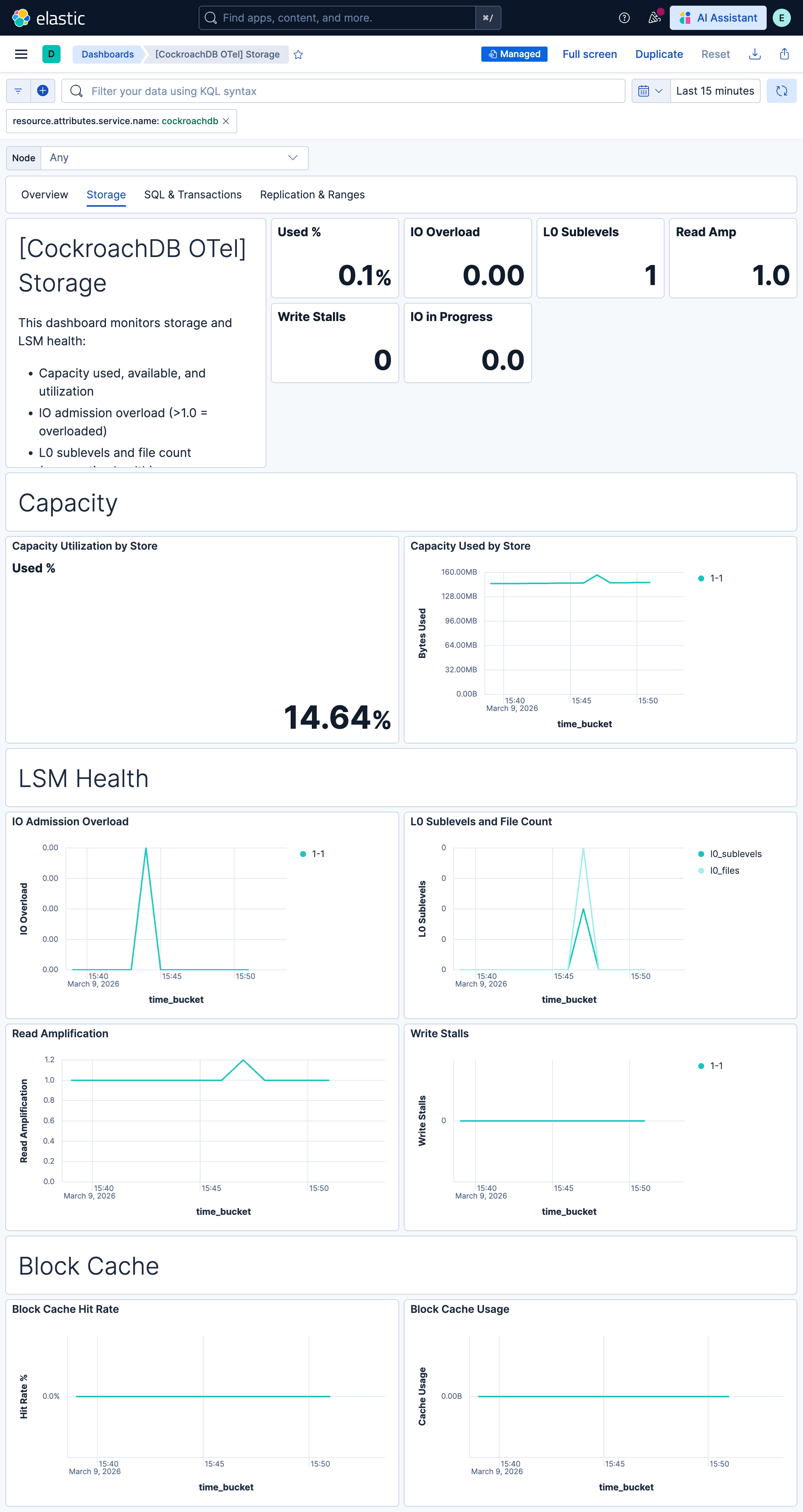

| [CockroachDB OTel] Storage | Storage capacity, LSM tree health, and disk I/O metrics. Monitor capacity usage, admission IO overload, L0 sublevels, read amplification, and write stalls. |

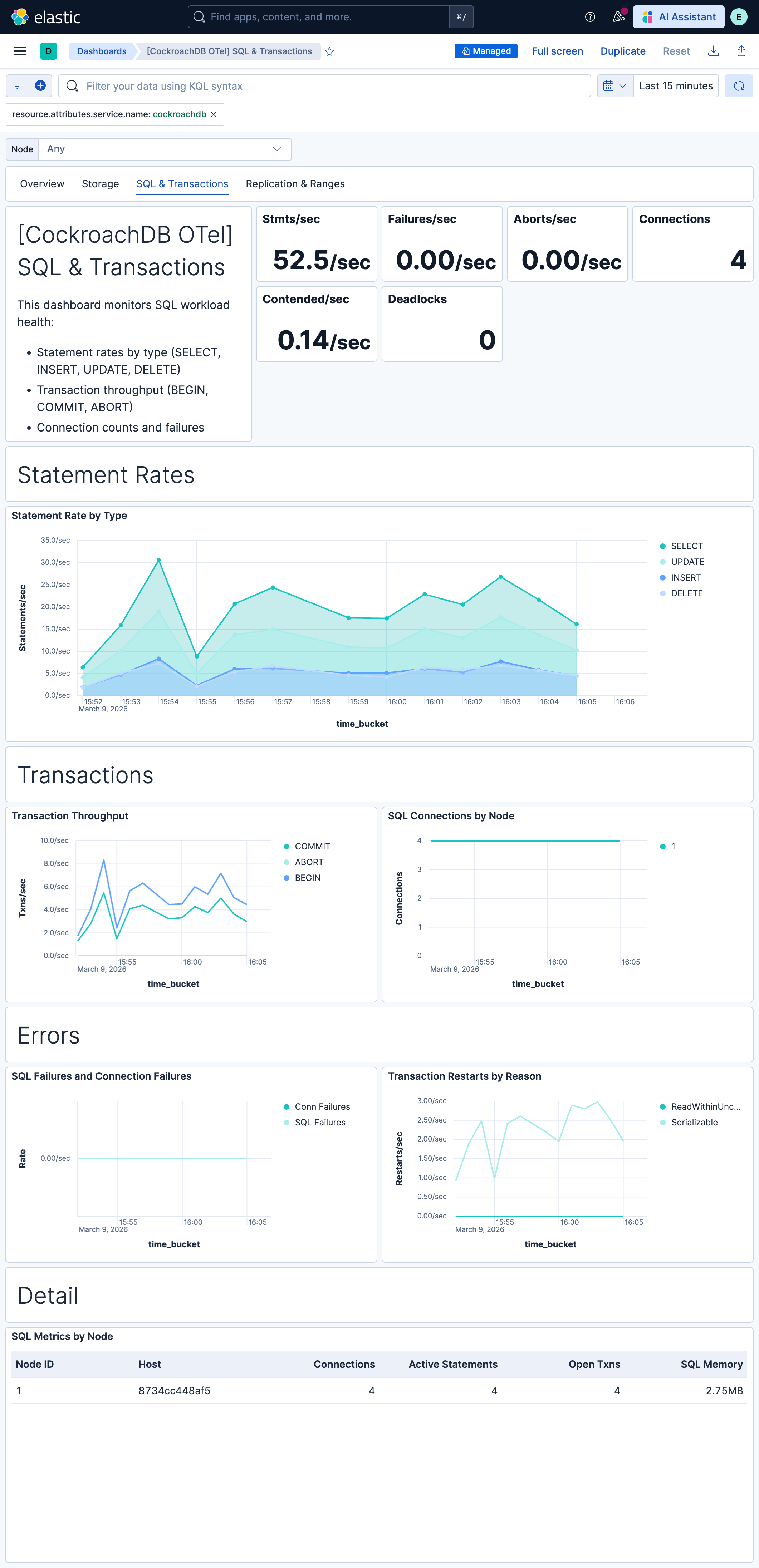

| [CockroachDB OTel] SQL & Transactions | SQL statement rates, transaction throughput, errors, and contention. Monitor SELECT/INSERT/UPDATE/DELETE rates, connection counts, failures, aborts, and deadlocks. |

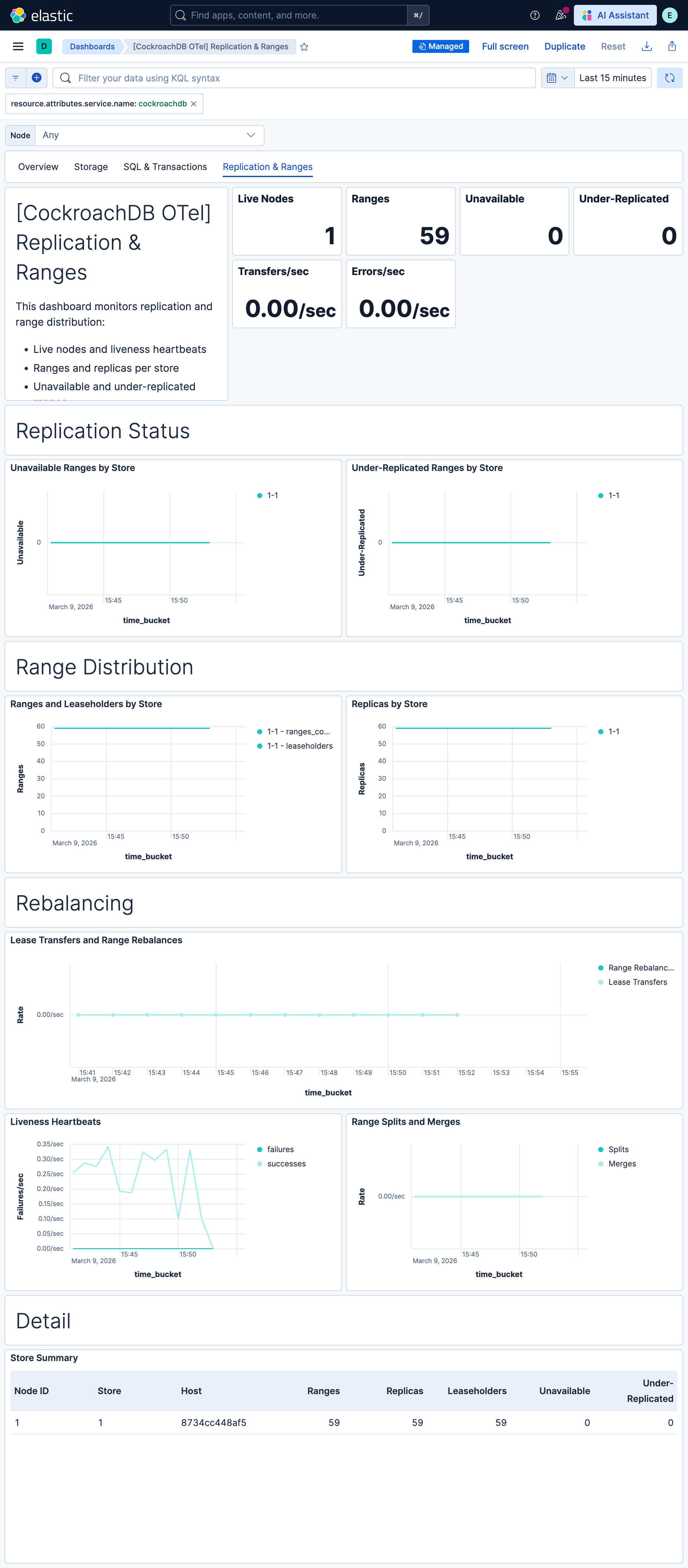

| [CockroachDB OTel] Replication & Ranges | Range distribution, replication health, and rebalancing activity. Monitor ranges per store, unavailable/under-replicated ranges, lease transfers, and rebalancing. |
