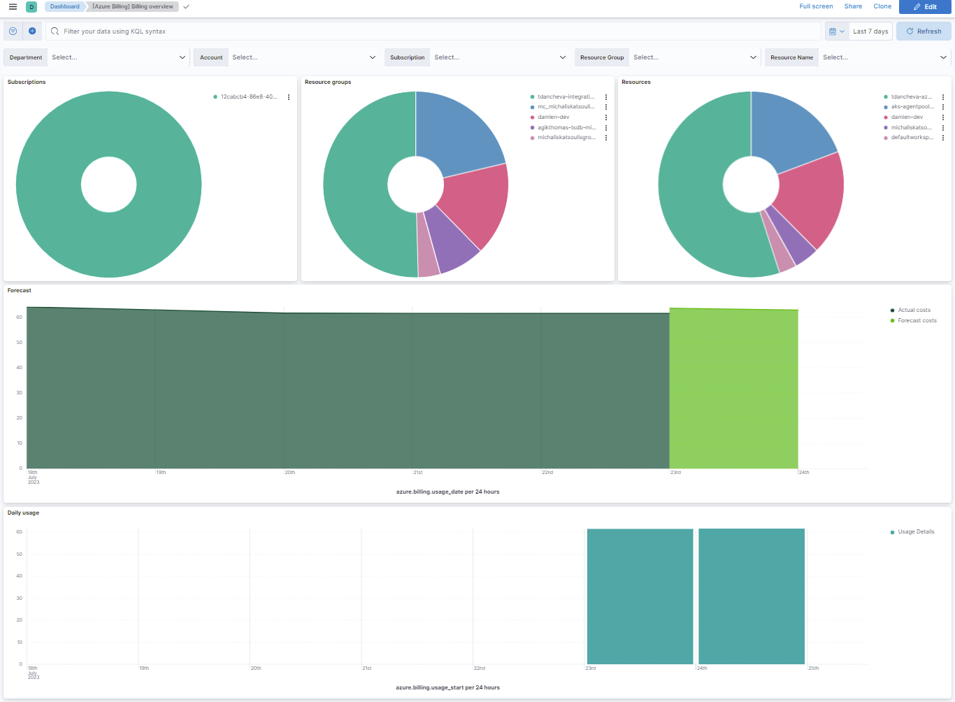

The Azure Billing Metrics data stream provides events from Consumption and Cost Management APIs of the following types: usage details and forecast.
Example
