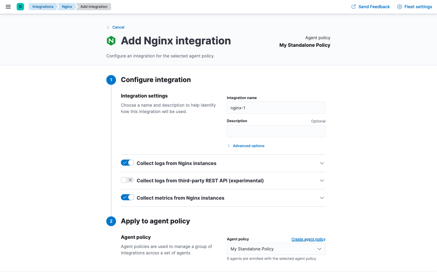

  1. From the main menu in Kibana, click Add integrations, and search for the Elastic Agent integration you want to use. Read the description to make sure the integration works with Elastic Agent.
  2. Click the integration to see more details about it, then click Add <Integration>.
    Add Nginx integration screen with agent policy selected
    Note
    If you’re adding your first integration and no Elastic Agents are installed, Kibana may display a page that walks you through configuring the integration and installing Elastic Agent. If you see this page, click Install Elastic Agent, then click the standalone mode link. Follow the in-product instructions instead of the steps described here.
  3. Under Configure integration, enter a name and description for the integration.
  4. Click the down arrow next to enabled streams and make sure the settings are correct for your host.
  5. Under Apply to agent policy, select an existing policy, or click Create agent policy and create a new one.
  6. When you’re done, save and continue.

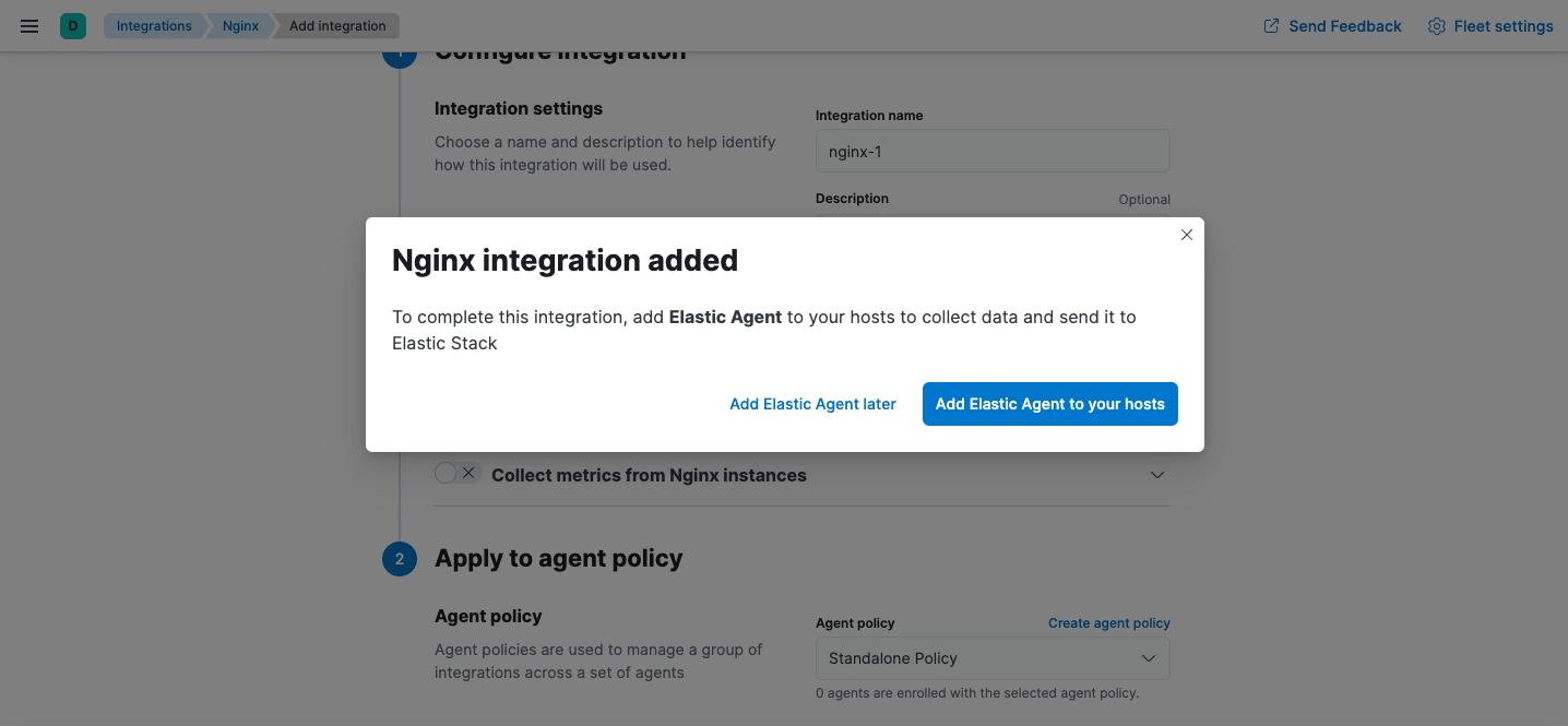

    A popup window gives you the option to add Elastic Agent to your hosts.
    Popup window showing the option to add {{agent}} to your hosts
  7. (Optional) To add more integrations to the agent policy, click Add Elastic Agent later and go back to the Integrations page. Repeat the previous steps for each integration.
  8. When you’re done adding integrations, in the popup window, click Add Elastic Agent to your hosts to open the Add agent flyout.

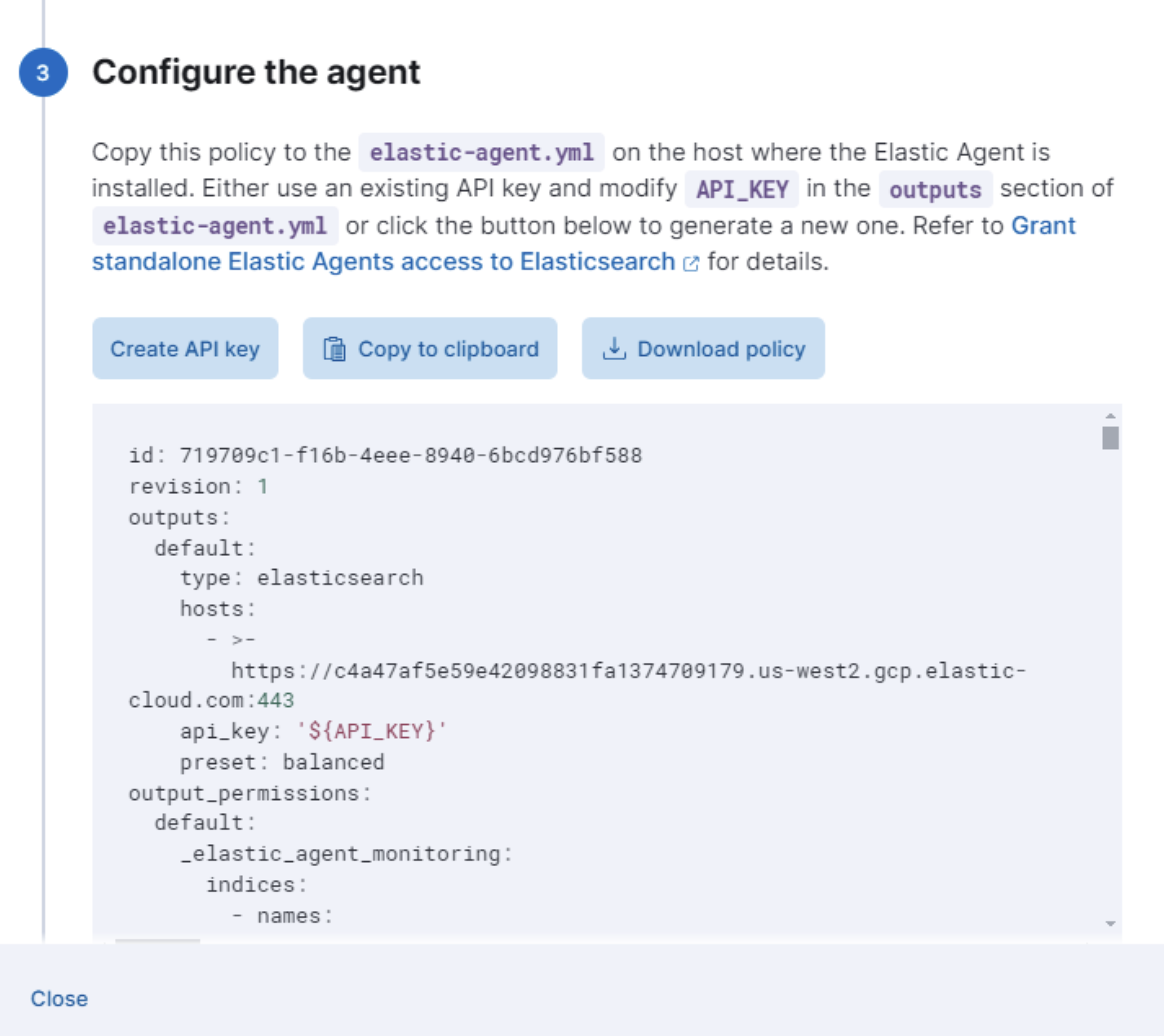

  9. Click Run standalone and follow the in-product instructions to download Elastic Agent (if you haven’t already).
  10. Click Download Policy to download the policy file.
    Add data screen with option to download the default agent policy
The downloaded policy already contains a default Elasticsearch address and port for your setup. You may need to change them if you use a proxy or load balancer. Modify the policy, as required, making sure that you provide credentials for connecting to Elasticsearch
