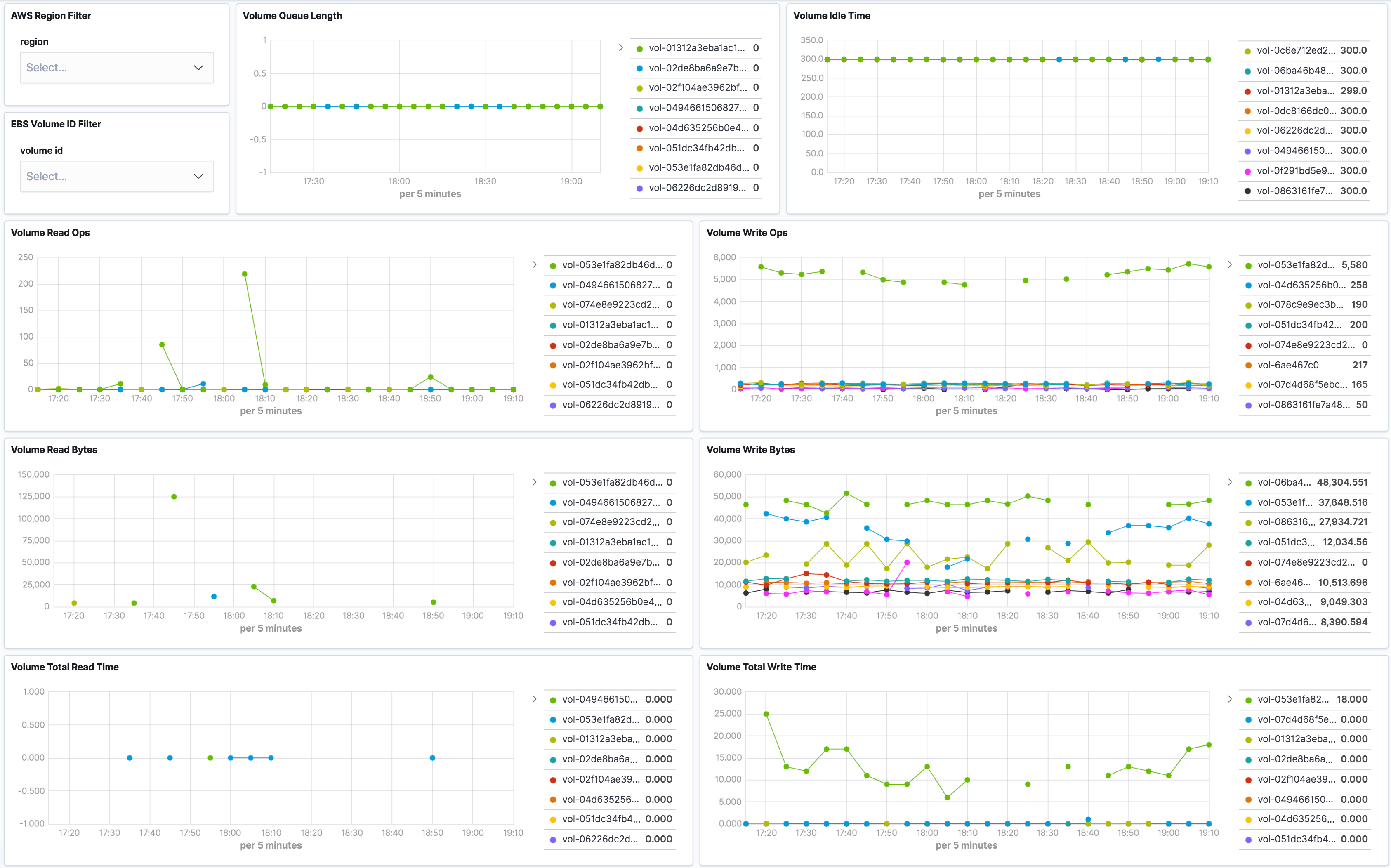

The Amazon EBS integration allows you to monitor Amazon Elastic Block Store (EBS)—a block-storage service designed for Amazon EC2.
Use the Amazon EBS integration to collect metrics related to your Amazon EBS storage. Then visualize that data in Kibana, create alerts to notify you if something goes wrong, and reference metrics when troubleshooting an issue.
For example, you could use this integration to collect five-minute metrics on read operations, read bytes, and total read time. Then you can send an email alert if the volume of operations, bytes, or read time exceeds a predefined threshold.
Extra AWS charges on API requests will be generated by this integration. Check API Requests for more details.
The Amazon EBS integration collects one type of data: metrics.

The ebs data stream collects EBS metrics from AWS.
