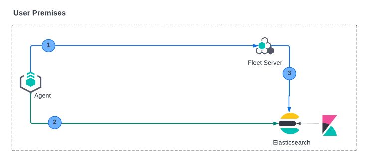

ECE Self-Managed
Diagram of mutual TLS on premise deployment model
Refer to the steps in Configure SSL/TLS for self-managed Fleet Servers. To configure mutual TLS, include the following additional parameters when you install Elastic Agent and Fleet Server.
During Elastic Agent installation on premise use the following options:
--certificate-authorities List of CA certificates that are trusted when Fleet Server connects to Elastic Agent
--elastic-agent-cert Elastic Agent certificate to present to Fleet Server during authentication
--elastic-agent-cert-key Elastic Agent certificate key to present to Fleet Server
--elastic-agent-cert-key-passphrase The path to the file that contains the passphrase for the mutual TLS private key that Elastic Agent will use to connect to Fleet Server
During Fleet Server installation on-premise Fleet Server authenticates with Elasticsearch and Elastic Agents. You can use the following CLI options to facilitate these secure connections:
--fleet-server-es-ca CA to use for the Elasticsearch connection
--fleet-server-es-cert Fleet Server certificate to present to Elasticsearch
--fleet-server-es-cert-key Fleet Server certificate key to present to Elasticsearch
--certificate-authorities List of CA certificates that are trusted when Elastic Agent connects to Fleet Server and when Fleet Server validates the Elastic Agent identity.
--fleet-server-cert Fleet Server certificate to present to Elastic Agents during authentication
--fleet-server-cert-key Fleet Server's private certificate key used to decrypt the certificate

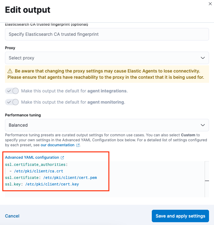

In Kibana, navigate to Fleet, open the Settings tab, and choose the Output that you’d like to configure. In the Advanced YAML configuration, add the following settings:
ssl.certificate_authorities List of CA certificates that are trusted when Fleet Server connects to Elastic Agent
ssl.certificate This certificate will be passed down to all the agents that have this output configured in their policy. This certificate is used by the agent when establishing mTLS to the output.
You may either apply the full certificate, in which case all the agents get the same certificate OR alternatively point to a local directory on the agent where the certificate resides, if the certificates are to be unique per agent.
ssl.key This certificate key will be passed down to all the agents that have this output configured in their policy. The certificate key is used to decrypt the SSL certificate.
Important
Note the following when you specify these SSL settings:
  • The certificate authority, certificate, and certificate key need to be specified as a path to a local file. You cannot specify a directory.
  • You can define multiple CAs or paths to CAs.
  • Only one certificate and certificate key can be defined.
In the Advanced YAML configuration these settings should be added in the following format:
ssl.certificate_authorities:
  - /path/to/ca
ssl.certificate: /path/to/cert
ssl.key: /path/to/cert_key
OR
  - /path/to/ca
Screen capture of output advanced yaml settings

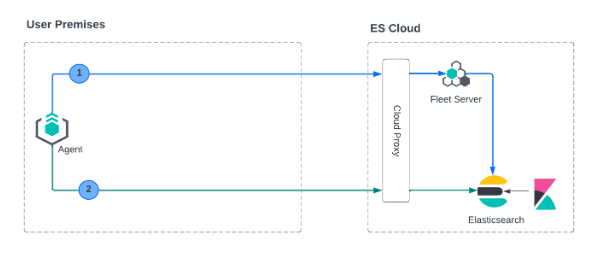

In this deployment model, all traffic ingress into Elastic Cloud has its TLS connection terminated at the Elastic Cloud boundary. Since this termination is not handled on a per-tenant basis, a client-specific certificate can NOT be used at this point.
Diagram of mutual TLS on cloud deployment model
We currently don’t support mTLS in this deployment model. An alternate deployment model is shown below where you can deploy your own secure proxy where TLS connections are terminated.

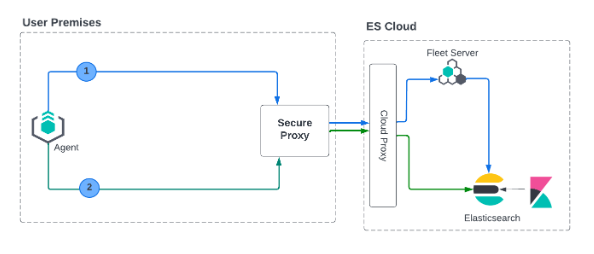

Serverless ECH
In this scenario, where you have access to the proxy, you can configure mTLS between the agent and your proxy.
Diagram of mutual TLS on cloud deployment model with a proxy
--certificate-authorities List of CA certificates that are trusted when Elastic Agent connects to Fleet Server or to the proxy between Elastic Agent and Fleet Server
--elastic-agent-cert Elastic Agent certificate to present during authentication to Fleet Server or to the proxy between Elastic Agent and Fleet Server
--elastic-agent-cert-key Elastic Agent's private certificate key used to decrypt the certificate

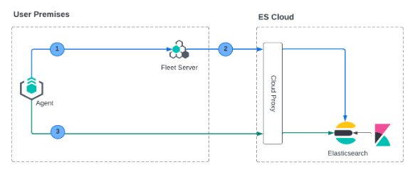

However, as with the Fleet Server on Elastic Cloud use case, the data plane TLS connections terminate at the Elastic Cloud boundary. Elastic Cloud is not a multi-tenanted service and therefore can’t provide per-user certificates.
Diagram of mutual TLS with Fleet Server on premise and Elastic Cloud Hosted deployment model
Similar to the Fleet Server on Elastic Cloud use case, a secure proxy can be placed in such an environment to terminate the TLS connections and satisfy the mTLS requirements.
Diagram of mutual TLS with Fleet Server on premise and Elastic Cloud Hosted deployment model with a proxy
