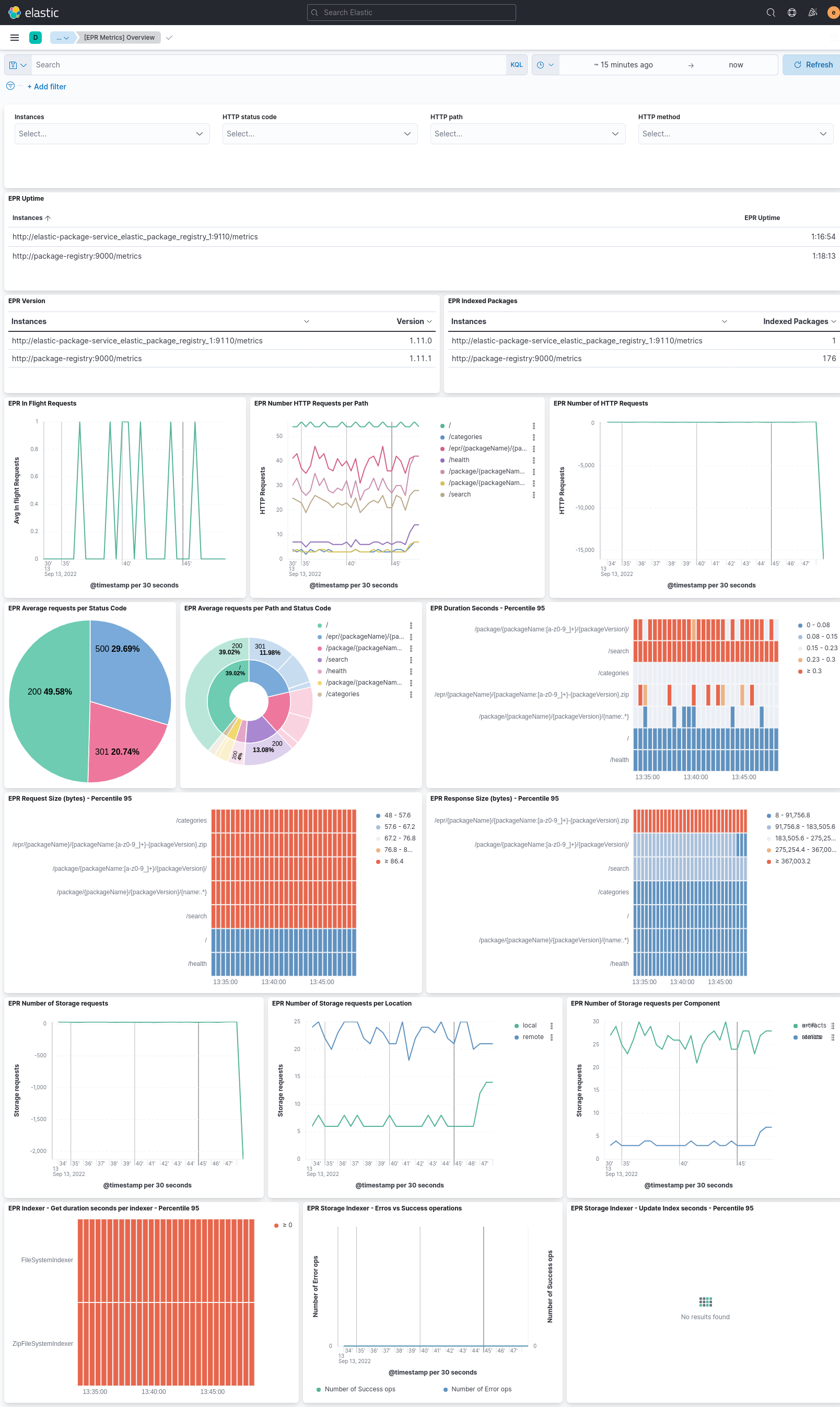

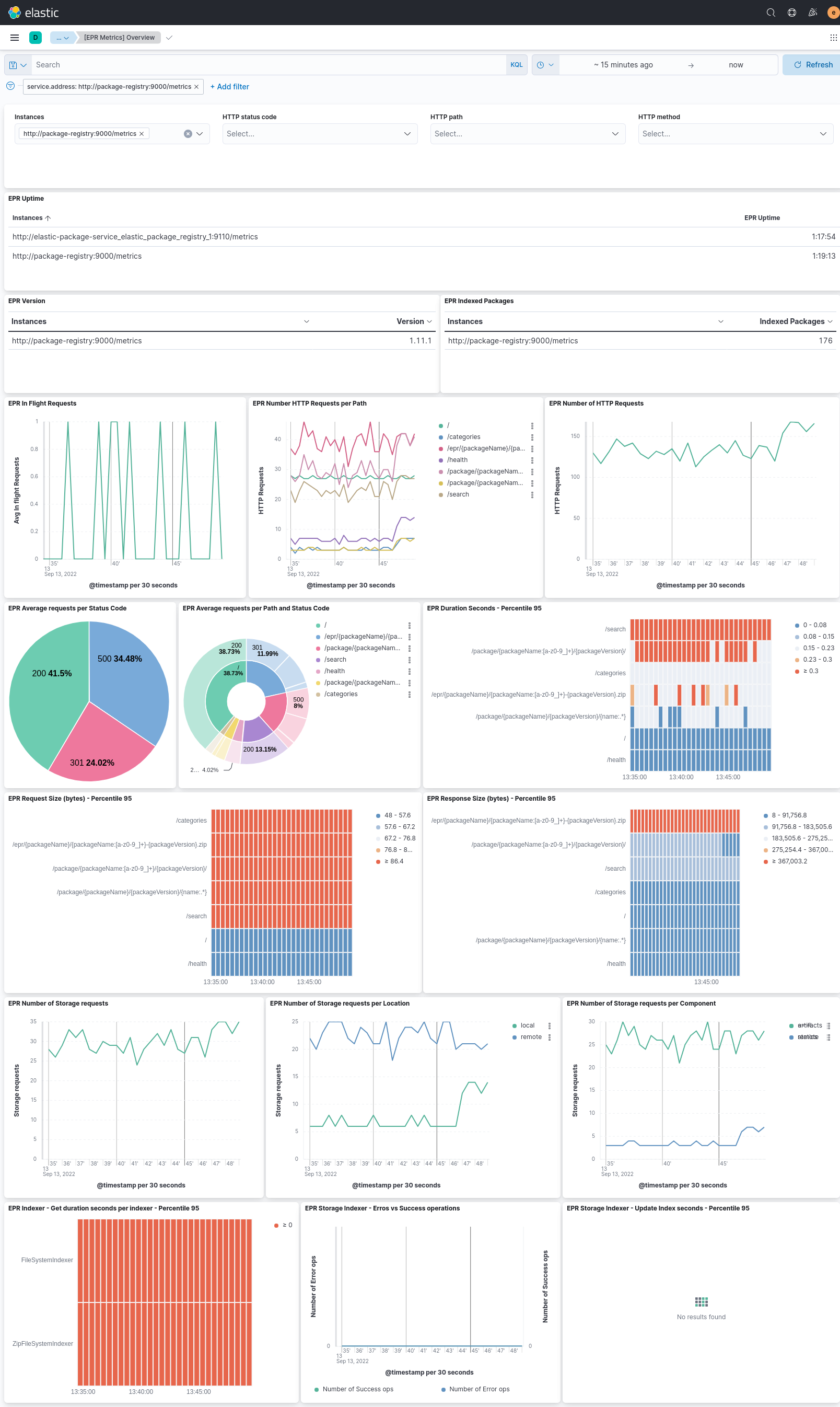

The Elastic Package Registry integration collects metrics from your Elastic Package Registry service.
Use the data from this integration to monitor the status of your services — for example, how many packages are indexed, which versions your services are running, or whether there are too many requests with 404 or 500 status codes.
This integration is compatible with Elastic Package Registry version 1.10.0 and later.
The integration uses the Prometheus input to collect metrics from the /metrics endpoint exposed by the Elastic Package Registry service.
