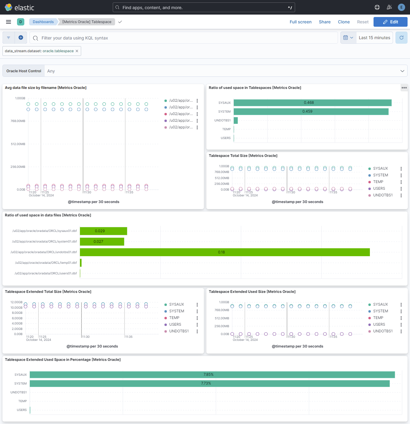

Tablespace metrics describes the tablespace usage metrics of all types of tablespaces in the oracle database.
Tablespace metrics also describes extended space of all type of tablepaces.
To collect the Tablespace metrics, Oracle integration relies on a specific set of views. Make sure that the user configured within the Oracle DSN configuration has READ access permissions to the following views:
  • SYS.DBA_DATA_FILES
  • SYS.DBA_TEMP_FILES
  • DBA_FREE_SPACE
  • DBA_TABLESPACE_USAGE_METRICS
  • DBA_TABLESPACES
  • DBA_TEMP_FREE_SPACE
ECS Field Reference

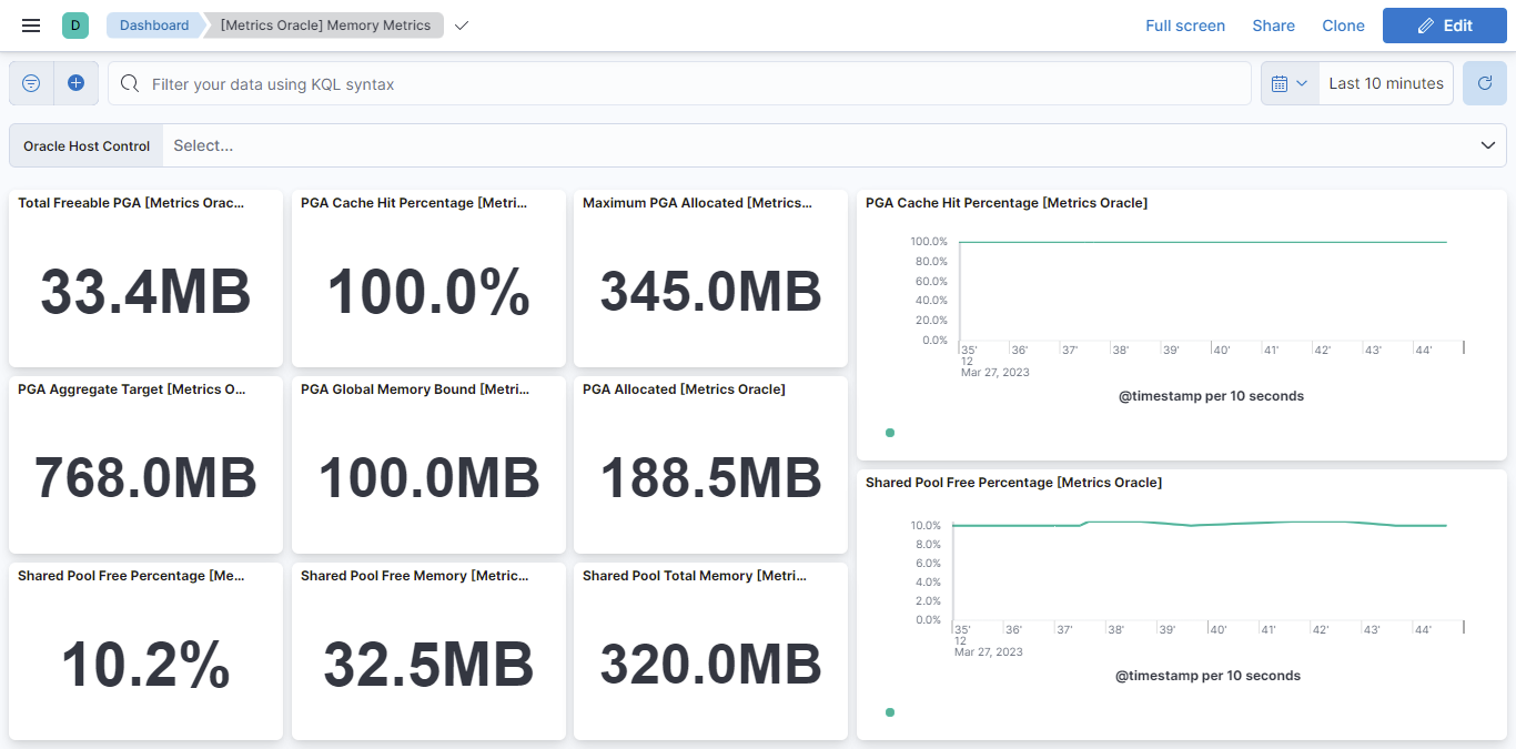

A Program Global Area (PGA) is a memory region that contains data and control information for a server process. It is nonshared memory created by Oracle Database when a server process is started. Access to the PGA is exclusive to the server process. Metrics concerning Program Global Area (PGA) memory are mentioned below.
To collect the Memory metrics, Oracle integration relies on a specific set of views. Make sure that the user configured within the Oracle DSN configuration has READ access permissions to the following views:
  • V$SGASTAT
  • V$PGASTAT
ECS Field Reference
