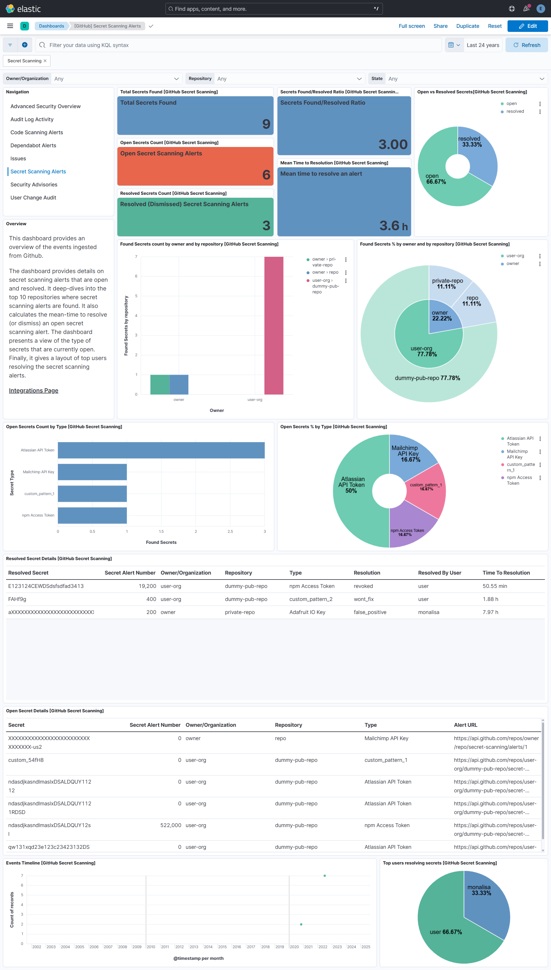

"event": {
"created": "2022-06-30T18:07:27Z",
"dataset": "github.secret_scanning",
"ingested": "2026-03-31T09:14:05Z",
"kind": "alert",
"original": "{\"created_at\":\"2022-06-30T18:07:27Z\",\"html_url\":\"https://github.com/sample_owner/sample_repo/security/secret-scanning/3\",\"number\":3,\"push_protection_bypassed\":true,\"push_protection_bypassed_by\":{\"html_url\":\"https://github.com/sample_owner\",\"login\":\"sample_owner\",\"type\":\"User\",\"url\":\"https://api.github.com/users/sample_owner\"},\"resolution\":\"revoked\",\"resolved_by\":{\"login\":\"sample_owner\",\"type\":\"User\",\"url\":\"https://api.github.com/users/sample_owner\"},\"secret\":\"npm_2vYJ3QzGXoGbEgMYduYS1k2M4D0wDu2opJbl\",\"secret_type\":\"npm_access_token\",\"secret_type_display_name\":\"npm Access Token\",\"state\":\"open\",\"url\":\"https://api.github.com/repos/sample_owner/sample_repo/secret-scanning/alerts/3\"}",
"type": [
"creation"
"github": {
"repository": {
"html_url": "https://github.com/sample_owner/sample_repo",
"name": "sample_repo",
"owner": {
"login": "sample_owner"
"url": "https://api.github.com/repos/sample_owner/sample_repo"
"secret_scanning": {
"created_at": "2022-06-30T18:07:27Z",
"html_url": "https://github.com/sample_owner/sample_repo/security/secret-scanning/3",
"number": 3,
"push_protection_bypassed": true,
"push_protection_bypassed_by": {
"html_url": "https://github.com/sample_owner",
"login": "sample_owner",
"type": "User",
"url": "https://api.github.com/users/sample_owner"
"resolution": "revoked",
"resolved_by": {
"type": "User",
"secret": "npXXXXXXXXXXXXXXXXXXXXXXXXXXXXXXXXXXXXbl",
"secret_type": "npm_access_token",
"secret_type_display_name": "npm Access Token",
"state": "open",
"url": "https://api.github.com/repos/sample_owner/sample_repo/secret-scanning/alerts/3"
"input": {
"type": "httpjson"
"tags": [
"forwarded",
"github-secret-scanning",
"preserve_original_event",
"hide_secret"

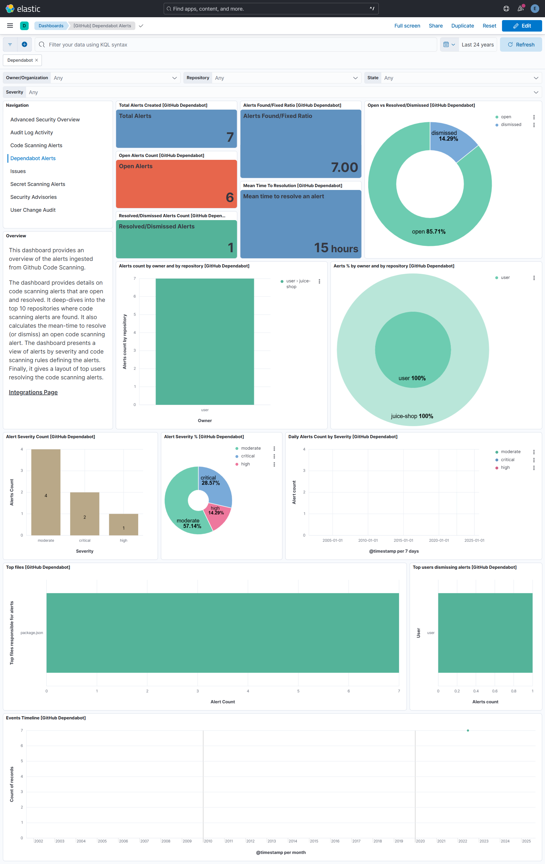

The GitHub Dependabot lets you retrieve known vulnerabilites in dependencies from a repository setup using GitHub Advanced Security Dependabot feature. Check About Dependabot for more details.
To use this integration, you must be an administrator for the repository or for the organization that owns the repository, and you must use a personal access token with the repo scope or security_events scope. For public repositories, you may instead use the public_repo scope. Check Authenticating with GraphQL and Token Issue

"@timestamp": "2022-07-11T11:39:07.000Z",
"agent": {
"ephemeral_id": "5214cf35-8a66-4be7-96da-1dc6661e0593",
"id": "366a1ed3-6bef-438c-8e7c-703c36a6fda8",
"name": "elastic-agent-60939",
"type": "filebeat",
"version": "8.19.10"
"data_stream": {
"dataset": "github.dependabot",
"namespace": "95927",
"type": "logs"
"ecs": {
"version": "8.11.0"
"elastic_agent": {
"snapshot": false,
"event": {
"created": "2022-07-11T11:39:07.000Z",
"ingested": "2026-03-31T09:11:17Z",
"kind": "alert",
"original": "{\"createdAt\":\"2022-07-11T11:39:07Z\",\"dependabotUpdate\":{\"error\":{\"body\":\"The currently installed version can't be determined.\\n\\nTo resolve the issue add a supported lockfile (package-lock.json or yarn.lock).\",\"errorType\":\"dependency_file_not_supported\",\"title\":\"Dependabot can't update vulnerable dependencies without a lockfile\"},\"pullRequest\":null},\"dependencyScope\":\"RUNTIME\",\"dismissReason\":null,\"dismissedAt\":null,\"dismisser\":null,\"fixedAt\":null,\"number\":1,\"repository\":{\"description\":\"OWASP Juice Shop: Probably the most modern and sophisticated insecure web application\",\"isInOrganization\":false,\"isPrivate\":false,\"name\":\"sample_repo\",\"owner\":{\"login\":\"sample_owner\",\"url\":\"https://github.com/sample_owner\"},\"url\":\"https://github.com/sample_owner/sample_repo\"},\"securityAdvisory\":{\"classification\":\"GENERAL\",\"cvss\":{\"score\":0,\"vectorString\":null},\"cwes\":{\"nodes\":[{\"cweId\":\"CWE-20\",\"description\":\"The product receives input or data, but it does not validate or incorrectly validates that the input has the properties that are required to process the data safely and correctly.\",\"name\":\"Improper Input Validation\"}]},\"description\":\"Versions 4.2.1 and earlier of `jsonwebtoken` are affected by a verification bypass vulnerability. This is a result of weak validation of the JWT algorithm type, occuring when an attacker is allowed to arbitrarily specify the JWT algorithm.\\n\\n\\n\\n\\n## Recommendation\\n\\nUpdate to version 4.2.2 or later.\",\"ghsaId\":\"GHSA-c7hr-j4mj-j2w6\",\"identifiers\":[{\"type\":\"GHSA\",\"value\":\"GHSA-c7hr-j4mj-j2w6\"},{\"type\":\"CVE\",\"value\":\"CVE-2015-9235\"}],\"origin\":\"UNSPECIFIED\",\"permalink\":\"https://github.com/advisories/GHSA-c7hr-j4mj-j2w6\",\"publishedAt\":\"2018-10-09T00:38:30Z\",\"references\":[{\"url\":\"https://nvd.nist.gov/vuln/detail/CVE-2015-9235\"},{\"url\":\"https://github.com/auth0/node-jsonwebtoken/commit/1bb584bc382295eeb7ee8c4452a673a77a68b687\"},{\"url\":\"https://auth0.com/blog/2015/03/31/critical-vulnerabilities-in-json-web-token-libraries/\"},{\"url\":\"https://github.com/advisories/GHSA-c7hr-j4mj-j2w6\"},{\"url\":\"https://www.npmjs.com/advisories/17\"},{\"url\":\"https://www.timmclean.net/2015/02/25/jwt-alg-none.html\"},{\"url\":\"https://nodesecurity.io/advisories/17\"}],\"severity\":\"CRITICAL\",\"summary\":\"Verification Bypass in jsonwebtoken\",\"updatedAt\":\"2021-01-08T19:00:39Z\",\"withdrawnAt\":null},\"securityVulnerability\":{\"firstPatchedVersion\":{\"identifier\":\"4.2.2\"},\"package\":{\"ecosystem\":\"NPM\",\"name\":\"jsonwebtoken\"},\"severity\":\"CRITICAL\",\"updatedAt\":\"2018-11-30T19:54:28Z\",\"vulnerableVersionRange\":\"\\u003c 4.2.2\"},\"state\":\"OPEN\",\"vulnerableManifestFilename\":\"package.json\",\"vulnerableManifestPath\":\"package.json\",\"vulnerableRequirements\":\"= 0.4.0\"}",
"start": "2022-07-11T11:39:07Z",
"type": [
"creation"
"github": {
"dependabot": {
"created_at": "2022-07-11T11:39:07Z",
"dependabot_update": {
"error": {
"body": "The currently installed version can't be determined.\n\nTo resolve the issue add a supported lockfile (package-lock.json or yarn.lock).",
"error_type": "dependency_file_not_supported",
"title": "Dependabot can't update vulnerable dependencies without a lockfile"
"dependency_scope": "RUNTIME",
"number": 1,
"security_advisory": {
"classification": "GENERAL",
"cwes": [
"cwe_id": "CWE-20",
"description": "The product receives input or data, but it does not validate or incorrectly validates that the input has the properties that are required to process the data safely and correctly.",
"name": "Improper Input Validation"
"ghsa_id": "GHSA-c7hr-j4mj-j2w6",
"identifiers": [
"type": "GHSA",
"value": "GHSA-c7hr-j4mj-j2w6"
"type": "CVE",
"value": "CVE-2015-9235"
"origin": "UNSPECIFIED",
"permalink": "https://github.com/advisories/GHSA-c7hr-j4mj-j2w6",
"published_at": "2018-10-09T00:38:30Z",
"severity": "CRITICAL",
"summary": "Verification Bypass in jsonwebtoken",
"updated_at": "2021-01-08T19:00:39Z"
"security_vulnerability": {
"first_patched_version": {
"identifier": "4.2.2"
"package": {
"ecosystem": "NPM",
"name": "jsonwebtoken"
"updated_at": "2018-11-30T19:54:28Z",
"vulnerable_version_range": "< 4.2.2"
"state": "open",
"vulnerable_manifest_filename": "package.json",
"vulnerable_manifest_path": "package.json",
"vulnerable_requirements": "= 0.4.0"
"repository": {
"description": "OWASP Juice Shop: Probably the most modern and sophisticated insecure web application",
"is_in_organization": false,
"owner": {
"url": "https://github.com/sample_owner"
"private": false,
"url": "https://github.com/sample_owner/sample_repo"
"input": {
"type": "httpjson"
"tags": [
"forwarded",
"github-dependabot",
"vulnerability": {
"classification": "CVSS",
"description": "Versions 4.2.1 and earlier of `jsonwebtoken` are affected by a verification bypass vulnerability. This is a result of weak validation of the JWT algorithm type, occuring when an attacker is allowed to arbitrarily specify the JWT algorithm.\n\n\n\n\n## Recommendation\n\nUpdate to version 4.2.2 or later.",
"enumeration": "CVE",
"id": "CVE-2015-9235",
"reference": [
"https://nvd.nist.gov/vuln/detail/CVE-2015-9235",
"https://github.com/auth0/node-jsonwebtoken/commit/1bb584bc382295eeb7ee8c4452a673a77a68b687",
"https://auth0.com/blog/2015/03/31/critical-vulnerabilities-in-json-web-token-libraries/",
"https://www.npmjs.com/advisories/17",
"https://www.timmclean.net/2015/02/25/jwt-alg-none.html",
"https://nodesecurity.io/advisories/17"
"scanner": {
"vendor": "Github"
"score": {
"base": 0
"severity": "critical"

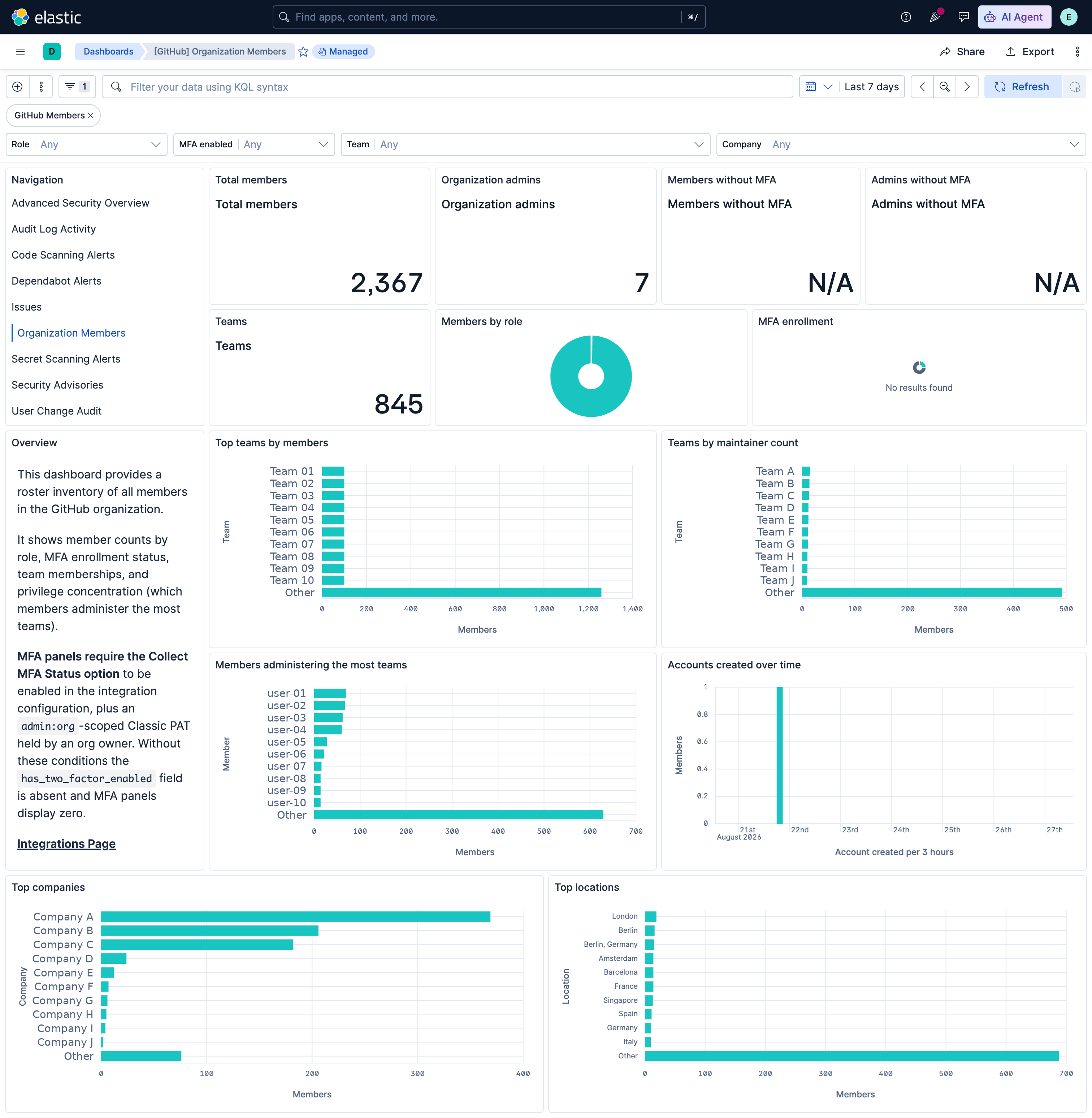

The GitHub Members data stream collects a snapshot of all organization members and their security-relevant attributes using the GitHub GraphQL API. Each collection cycle produces one document per member, making this an entity inventory stream suited for identity analytics, entity risk scoring, and SIEM identity graphs.
Data collected per member includes: organization role (MEMBER or ADMIN), two-factor authentication enrollment status (optional, see below), full profile attributes (name, email, company, location, bio), and team memberships including the member's role within each team (MAINTAINER or MEMBER).
The data stream issues two GraphQL queries per collection cycle against POST https://api.github.com/graphql:
organization.membersWithRole— paginated list of all org members with their role and 2FA status.organization.teams(with nestedteam.members) — paginated list of all teams and their members, used to populate team membership. For each team where the member is aMAINTAINER, the pipeline setsuser.entity.relationships.administers.entity.idto that team's GitHub node id. The same id isentity.idon the teams data stream.
Authentication: This data stream requires a Classic Personal Access Token (PAT). Fine-grained PATs do not support the admin:org scope or the membersWithRole GraphQL query reliably and cannot be used.
The required scopes depend on which fields you want to collect:
| Scope | Required? | Data unlocked |
read:org |
Required | Member roster (role, member list) and team memberships |
read:user |
Required | Profile fields: name, email, company, location, bio, pronouns, avatarUrl, websiteUrl, twitterUsername, createdAt, updatedAt, and boolean flags (isSiteAdmin, isEmployee, isHireable, etc.) |
admin:org |
Optional | hasTwoFactorEnabled MFA status. The token holder must also be an organization owner. Without this scope the field is omitted rather than set to false. Enable the Collect MFA Status option in the integration config alongside this scope. |
To generate a Classic PAT: navigate to GitHub → Settings → Developer settings → Personal access tokens → Tokens (classic), select the scopes above, then paste the generated token into the Personal Access Token field of the integration.
SAML SSO organizations: If the organization enforces SAML single sign-on, the token must be explicitly authorized for the organization after creation. On the token list page, click Configure SSO next to the token, then click Authorize next to the organization name. Without this step the API returns a SAML enforcement error regardless of which scopes are selected.
Refer to Creating a personal access token (classic) and Scopes for OAuth apps for more details.
GitHub App bot accounts (login ending in [bot]) are excluded by default. Enable the Include Bot Accounts option to include them.
The billing_manager organization role is only available via the REST API (GET /orgs/{org}/memberships/{username}) and is not returned by the GraphQL membersWithRole query. Members with this role appear with role MEMBER in this data stream.
For GitHub Enterprise Server, override the API URL setting to point to your GHES instance (e.g. https://github.example.com/api). This data stream appends /graphql to the API URL, and GHES serves GraphQL at <HOSTNAME>/api/graphql — the /api/v3 prefix used by the REST-based data streams does not apply here.

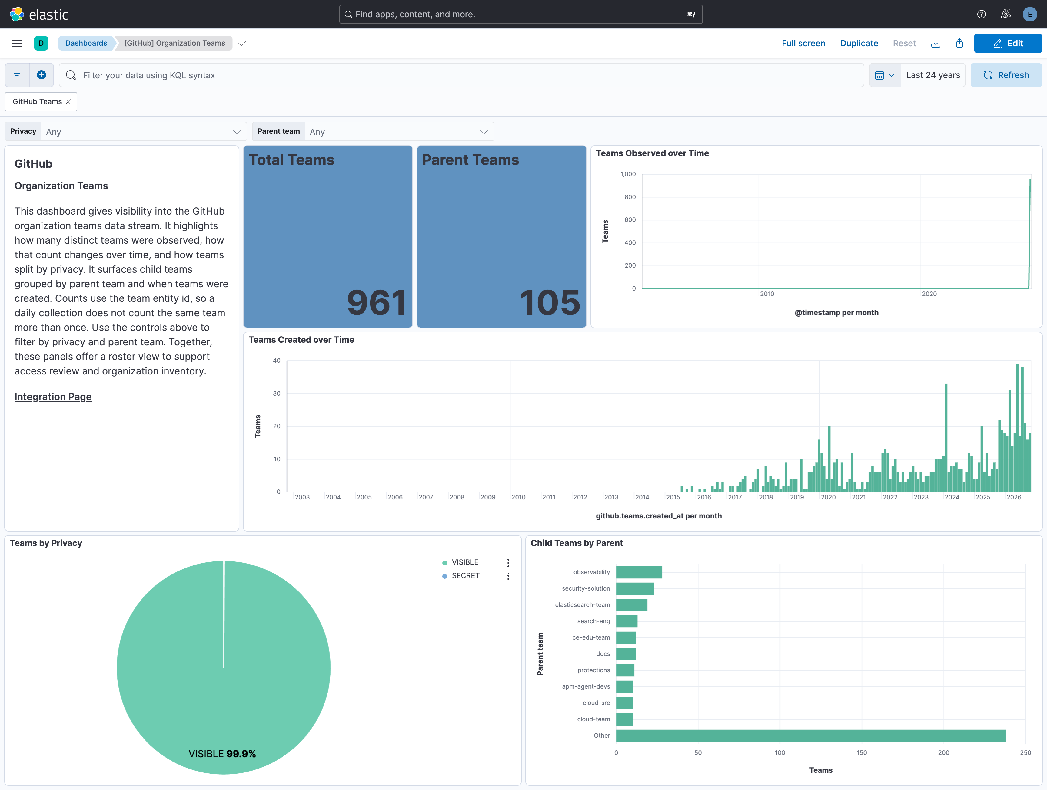

The GitHub Teams data stream collects one document per organization team using the GitHub GraphQL API organization.teams query. Each document is a generic entity (event.kind: asset). It does not set user.* fields, so team documents do not create user entities.
entity.id is the team's GitHub node id (for example T_kgDOAABBCC). That value is the same id written to user.entity.relationships.administers.entity.id on the member document of each maintainer of the team. github.teams.combined_slug keeps the org/team-slug value, which can change on rename.
Authentication: Classic personal access token with the read:org scope. Fine-grained PATs are not supported. For GitHub Enterprise Server, set API URL to the instance API root (for example https://github.example.com/api). This data stream calls <API URL>/graphql.
