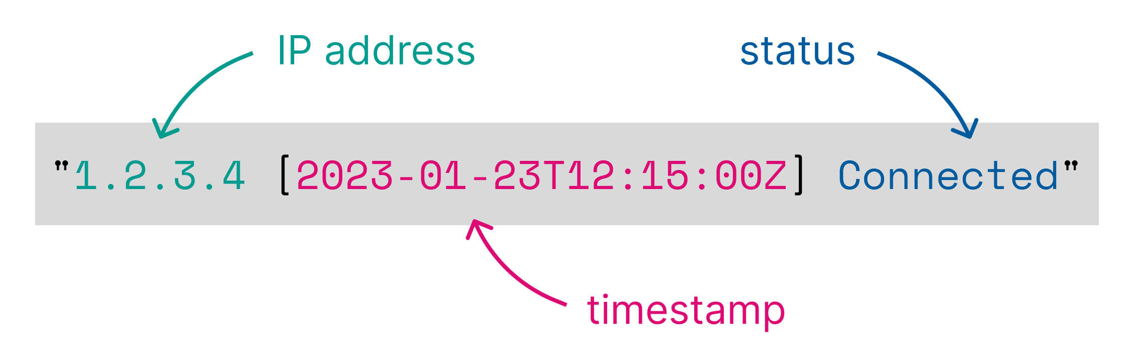

Your data may contain unstructured strings that you want to structure. This makes it easier to analyze the data. For example, log messages may contain IP addresses that you want to extract so you can find the most active IP addresses.
unstructured data
Elasticsearch can structure your data at index time or query time. At index time, you can use the Dissect and Grok ingest processors, or the Logstash Dissect and Grok filters. At query time, you can use the ES|QL DISSECT and GROK commands.
DISSECT works by breaking up a string using a delimiter-based pattern. GROK works similarly, but uses regular expressions. This makes GROK more powerful, but generally also slower. DISSECT works well when data is reliably repeated. GROK is a better choice when you really need the power of regular expressions, for example when the structure of your text varies from row to row.
You can use both DISSECT and GROK for hybrid use cases. For example when a section of the line is reliably repeated, but the entire line is not. DISSECT can deconstruct the section of the line that is repeated. GROK can process the remaining field values using regular expressions.

The GROK processing command matches a string against a pattern based on regular expressions, and extracts the specified keys as columns.
For example, the following pattern:
%{IP:ip} \[%{TIMESTAMP_ISO8601:@timestamp}\] %{GREEDYDATA:status}
matches a log line of this format:
1.2.3.4 [2023-01-23T12:15:00.000Z] Connected
