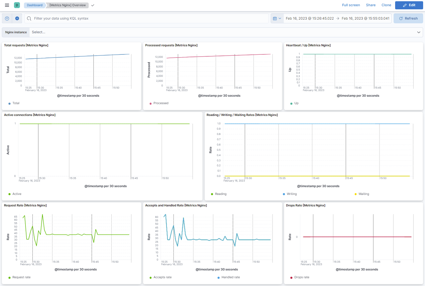

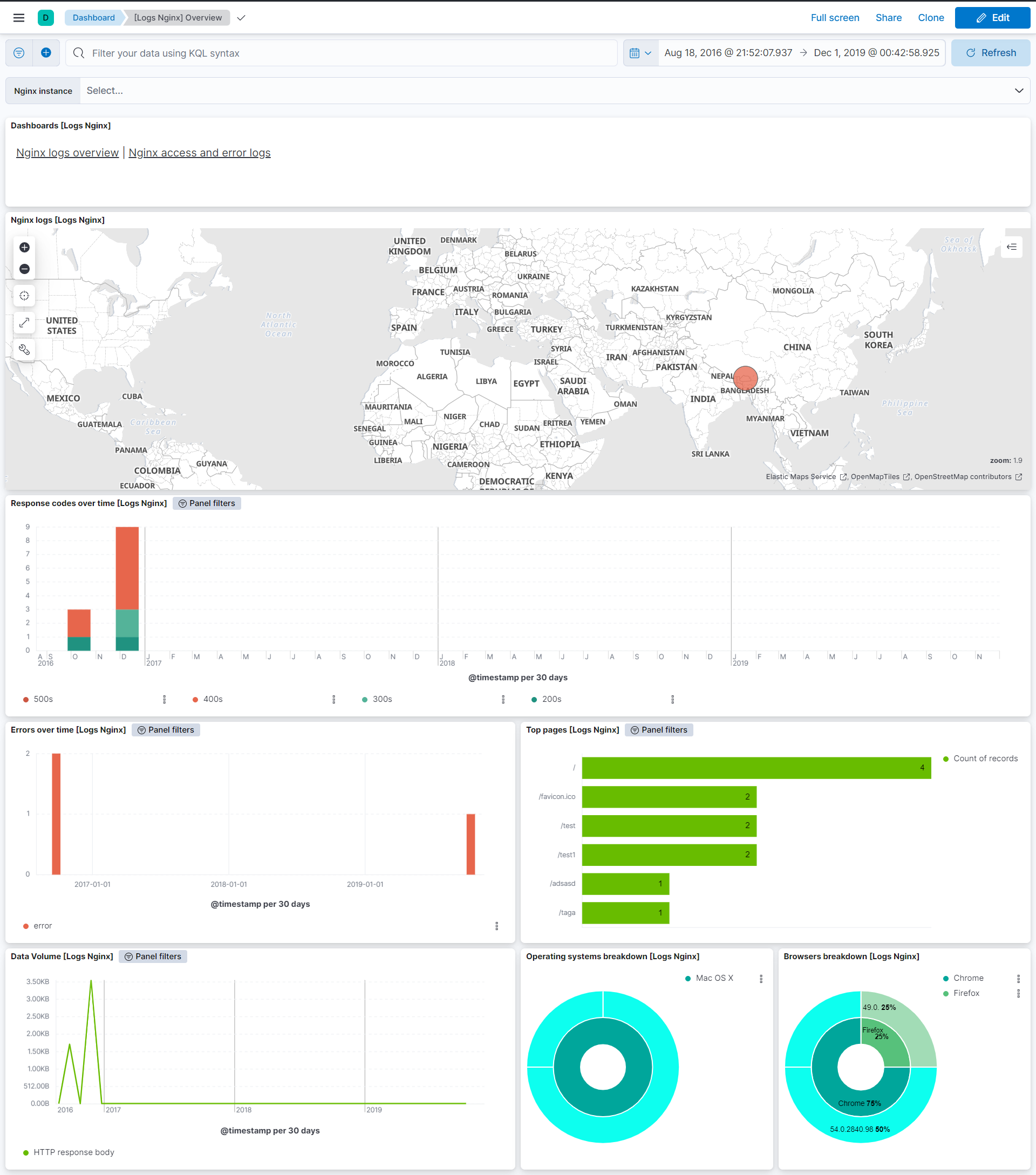

The Nginx integration collects two types of data: logs and metrics.
Logs help you keep a record of events that happen in your Nginx servers. This includes when a client request or error occurs.
Metrics give you insight into the state of your Nginx servers. This includes information like the total number of active client connections by status, the total number of client requests, and more.

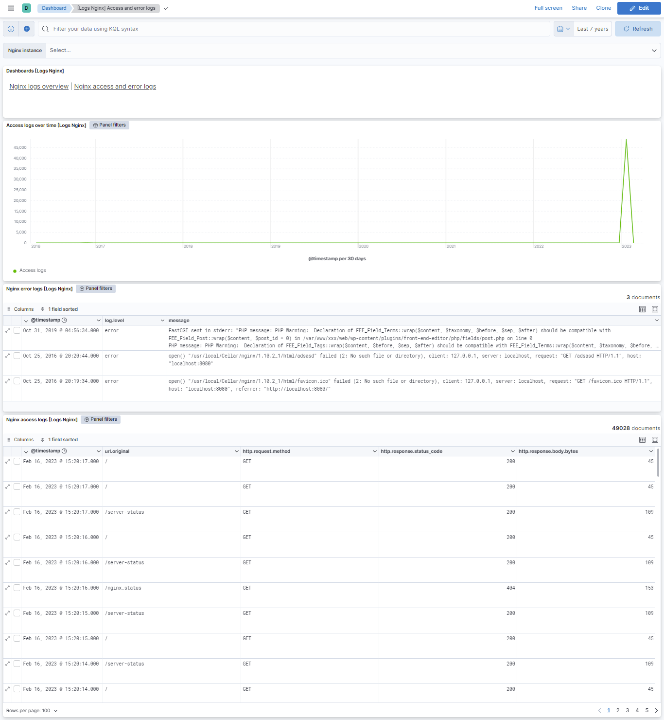

Access logs collects the Nginx access logs.
The Nginx access logs stream was tested with Nginx 1.19.5 and 1.28.2.
