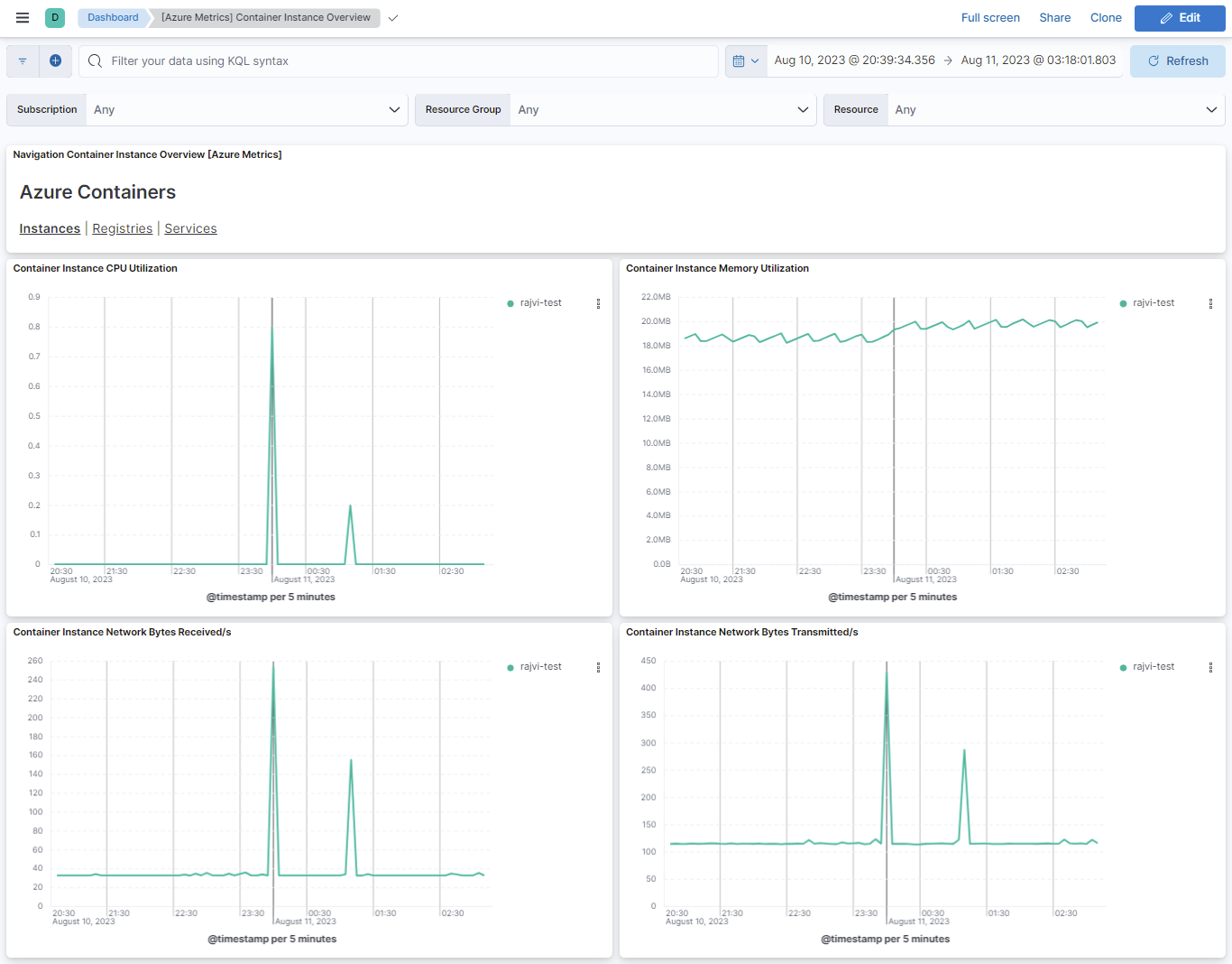

The Azure Container Instance data stream collects and aggregates container instance related metrics from Azure Container instance type resources where it can be used for analysis, visualization, and alerting. The Azure Container Instance will periodically retrieve the Azure Monitor metrics using the Azure REST APIs as MetricList. Additional Azure API calls will be executed to retrieve information regarding the resources targeted by the user.
Before you start, check the Authentication and costs section.
Follow these step-by-step instructions on how to set up an Azure metrics integration.
Period:: (string) Reporting interval. Metrics will have a timegrain of 5 minutes, so the Period configuration option for container_instance should have a value of 300s or multiple of 300sfor relevant results.
Resource IDs:: ([]string) The fully qualified ID's of the resource, including the resource name and resource type. Has the format /subscriptions/{guid}/resourceGroups/{resource-group-name}/providers/{resource-provider-namespace}/{resource-type}/{resource-name}.
Should return a list of resources.
Resource Groups:: ([]string) This option will return all container instances inside the resource group.
If no resource filter is specified, then all container instances inside the entire subscription will be considered.
The primary aggregation value will be retrieved for all the metrics contained in the namespaces. The aggregation options are avg, sum, min, max, total, count.

| azure.container_instance.cpu_usage.avg | CPU usage on all cores in millicores. | float | gauge | |
| azure.container_instance.memory_usage.avg | Total memory usage in byte. | float | byte | gauge |
| azure.container_instance.network_bytes_received_per_second.avg | The network bytes received per second. | float | byte | gauge |
| azure.container_instance.network_bytes_transmitted_per_second.avg | The network bytes transmitted per second. | float | byte | gauge |
| azure.dimensions.container_name | The container name | keyword | ||
| azure.metrics.cpu_usage.avg | alias | |||
| azure.metrics.memory_usage.avg | alias | |||
| azure.metrics.network_bytes_received_per_second.avg | alias | |||
| azure.metrics.network_bytes_transmitted_per_second.avg | alias | |||
