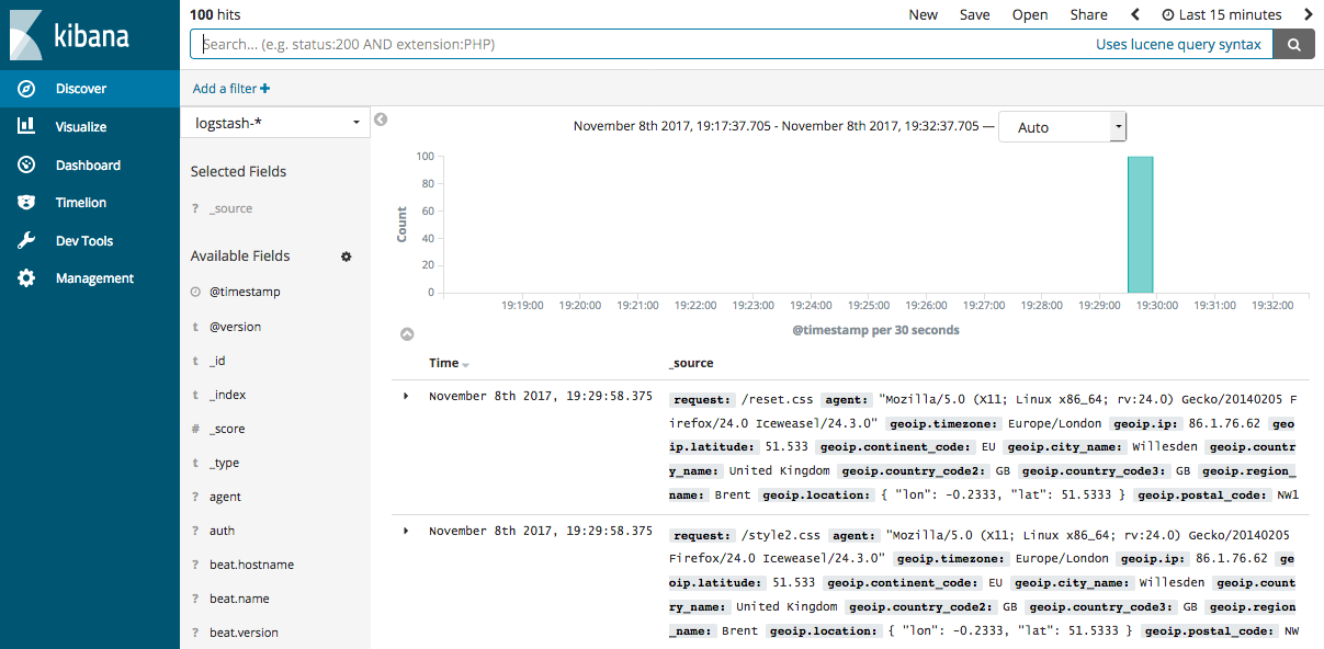

Now that the Logstash pipeline is configured to index the data into an Elasticsearch cluster, you can query Elasticsearch.
Try a test query to Elasticsearch based on the fields created by the grok filter plugin. Replace $DATE with the current date, in YYYY.MM.DD format:
curl -XGET 'localhost:9200/logstash-$DATE/_search?pretty&q=response=200'
Note
The date used in the index name is based on UTC, not the timezone where Logstash is running. If the query returns index_not_found_exception, make sure that logstash-$DATE reflects the actual name of the index. To see a list of available indexes, use this query: curl 'localhost:9200/_cat/indices?v'.
You should get multiple hits back. For example:

If you are using Kibana to visualize your data, you can also explore the Filebeat data in Kibana:
Discovering Filebeat data in Kibana
See the Filebeat quick start docs for info about loading the Kibana index pattern for Filebeat.
You’ve successfully created a pipeline that uses Filebeat to take Apache web logs as input, parses those logs to create specific, named fields from the logs, and writes the parsed data to an Elasticsearch cluster. Next, you learn how to create a pipeline that uses multiple input and output plugins.
