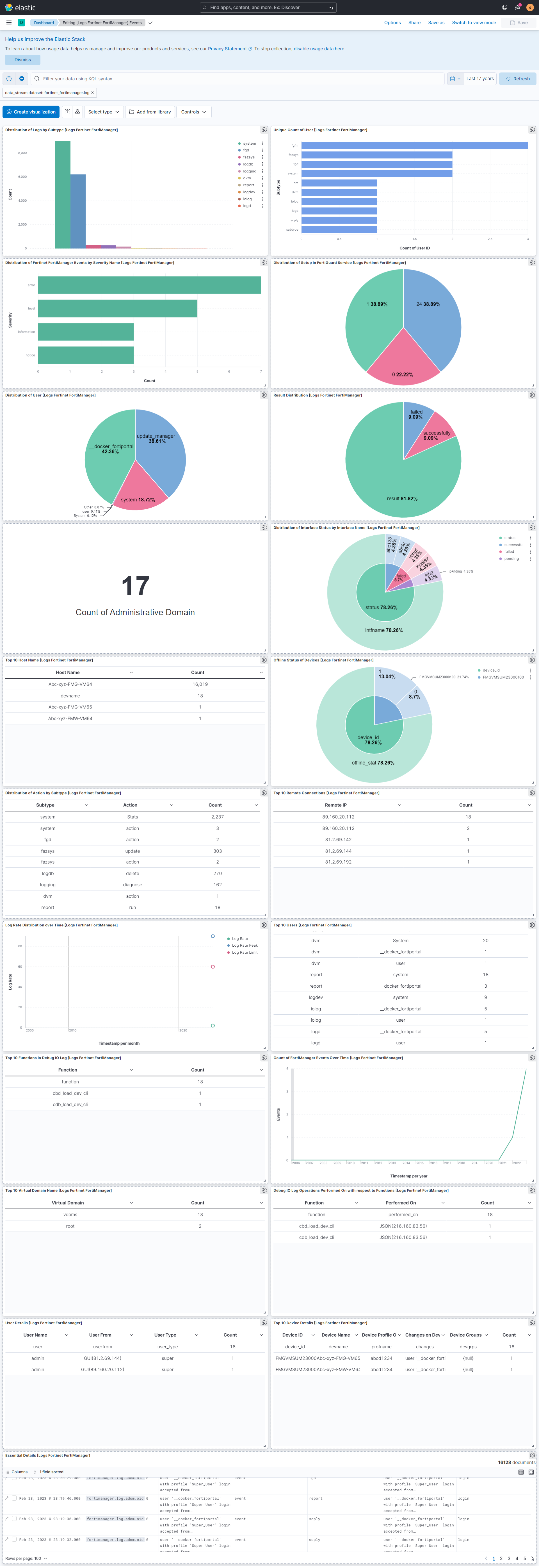

  6. Navigate to Analytics > Dashboards and search for "Fortinet FortiManager" to view the pre-built dashboards.
