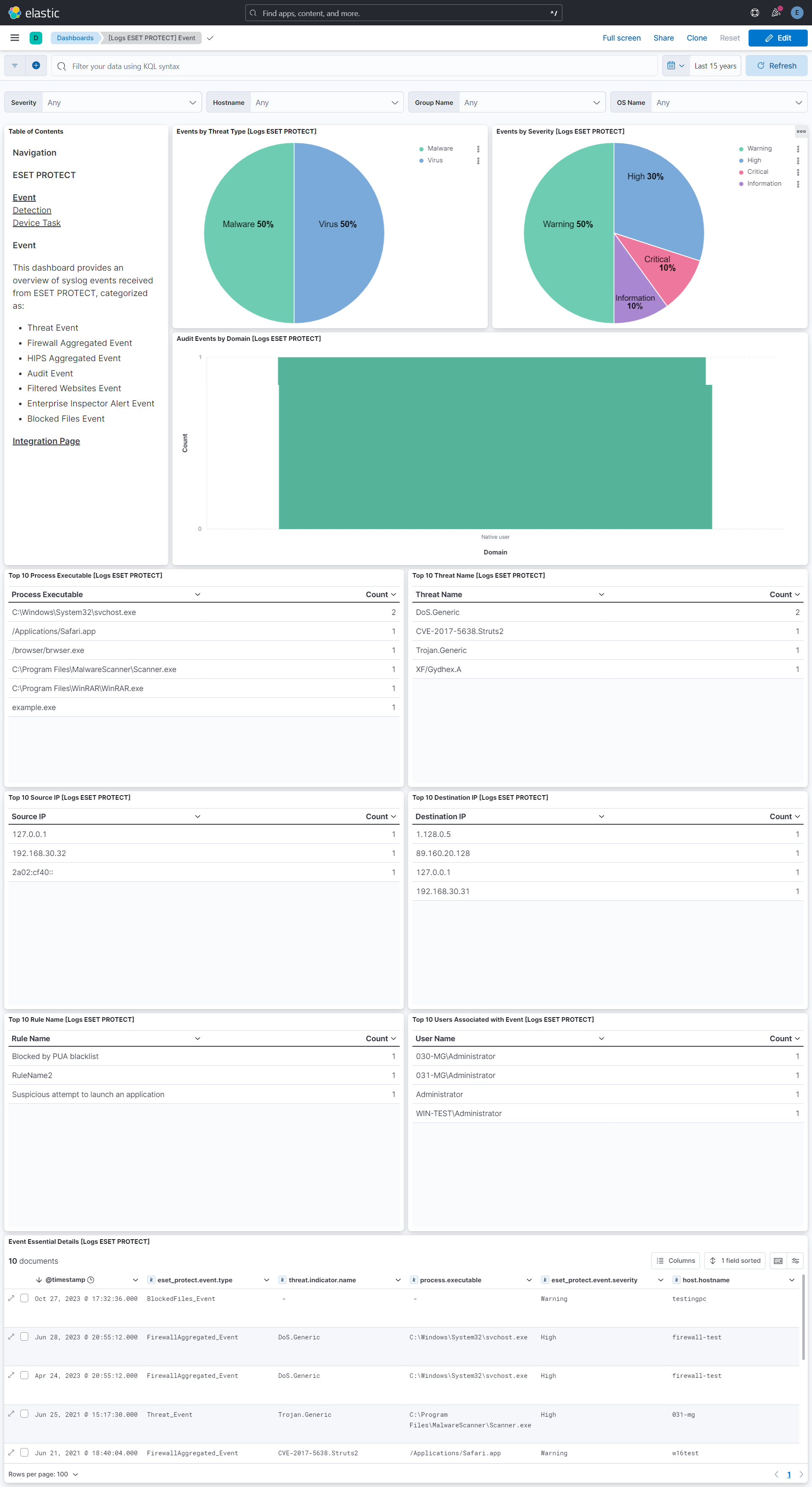

The ESET PROTECT integration collects three types of logs: Detection, Device Task and Event.

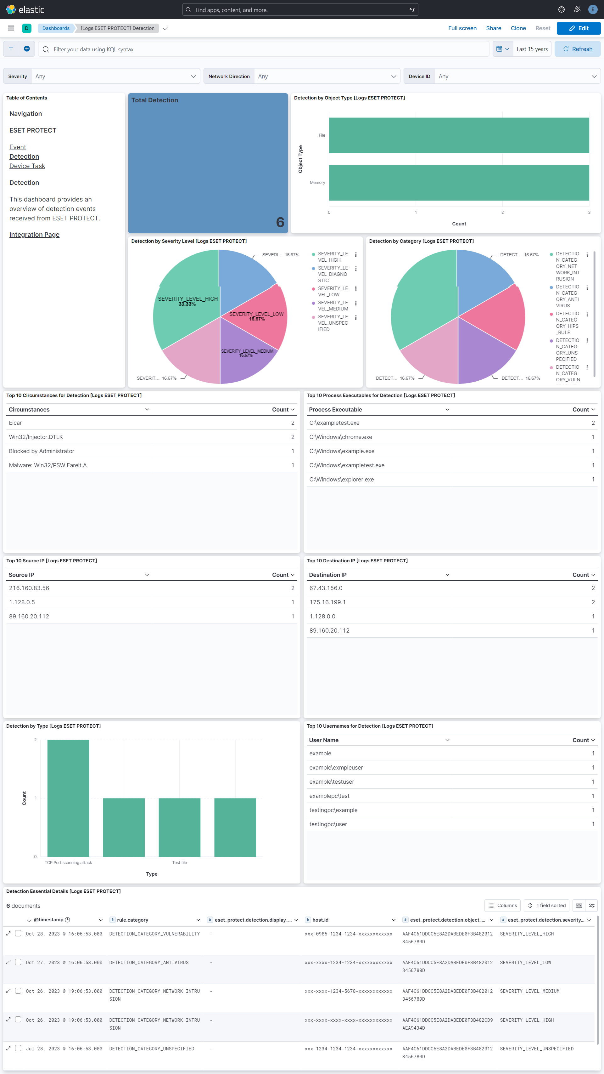

Detection is used to retrieve detections via the Incident Management - List detections v1 endpoint.

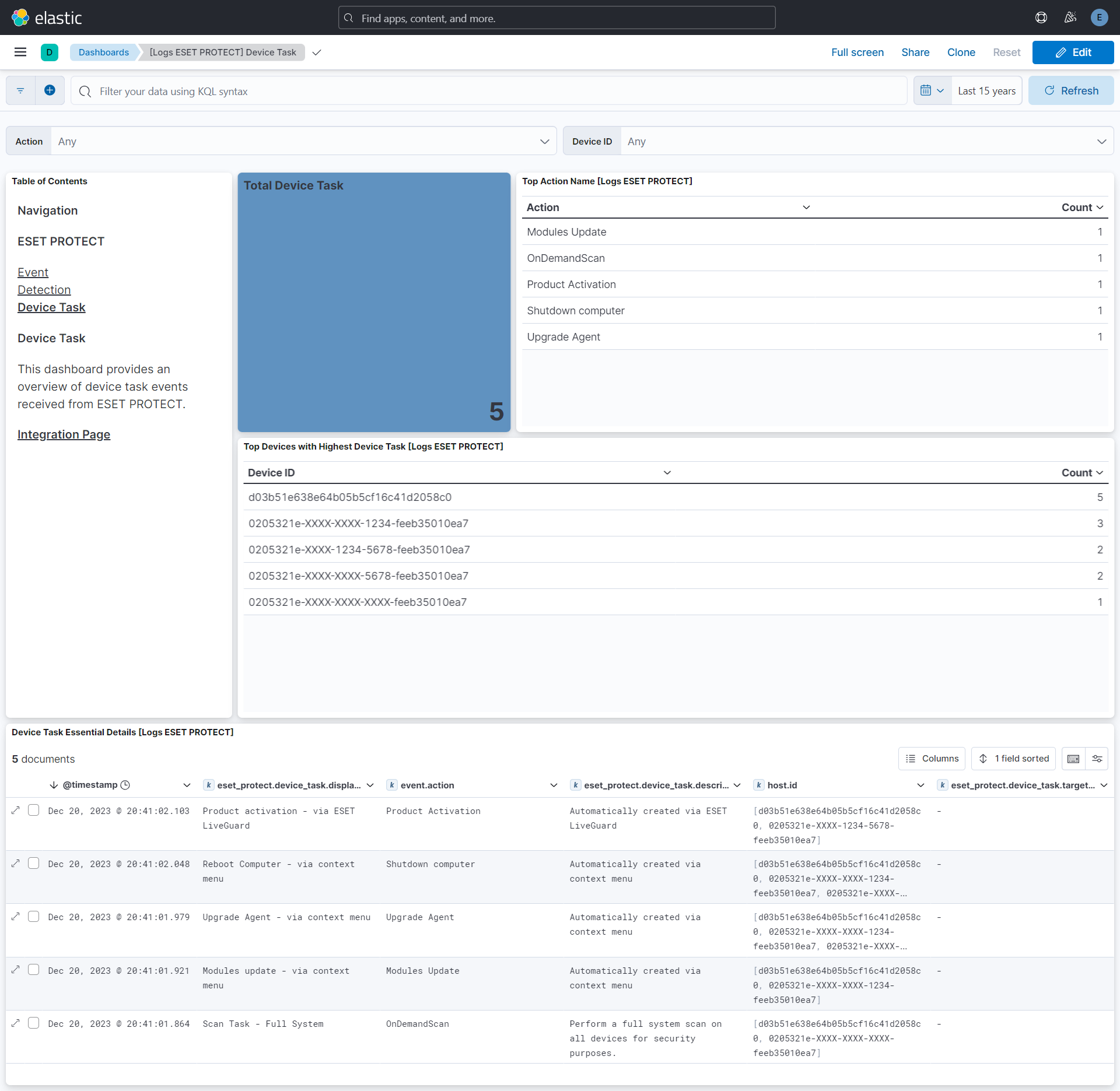

Device Task is used to retrieve device tasks via the Automation - List tasks endpoint.
Event is used to retrieve Detection, Firewall, HIPS, Audit, and ESET Inspect logs using the Syslog Server. ESET notifications are also retrieved but in plain text.

This is the Detection dataset.
Example
"@timestamp": "2023-10-26T13:36:53.000Z",
"agent": {
"ephemeral_id": "3166280a-d109-4e1a-a949-eae156770c1e",
"id": "fbb34d12-6a92-4b08-8435-1076804a69a2",
"name": "elastic-agent-11274",
"type": "filebeat",
"version": "8.16.0"
"data_stream": {
"dataset": "eset_protect.detection",
"namespace": "36613",
"type": "logs"
"destination": {
"as": {
"number": 29518,
"organization": {
"name": "Bredband2 AB"
"geo": {
"city_name": "Linköping",
"continent_name": "Europe",
"country_iso_code": "SE",
"country_name": "Sweden",
"location": {
"lat": 58.4167,
"lon": 15.6167
"region_iso_code": "SE-E",
"region_name": "Östergötland County"
"ip": "89.160.20.112",
"port": 443
"ecs": {
"version": "8.11.0"
"elastic_agent": {
"snapshot": false,
"version": "8.16.0"
"eset_protect": {
"detection": {
"category": "DETECTION_CATEGORY_NETWORK_INTRUSION",
"context": {
"circumstances": "Eicar",
"device_uuid": "xxx-xxxx-1234-5678-xxxxxxxxxxxx",
"process": {
"path": "C:\\Windows\\chrome.exe"
"user_name": "testingpc\\example"
"network_communication": {
"protocol_name": "0",
"remote": {
"ip_address": "89.160.20.112",
"port": 443
"object_hash_sha1": "AAF4C61DDCC5E8A2DABEDE0F3B4820123456789D",
"object_type_name": "File",
"object_url": "C:\\Temp\\06516f11-xxxx-xxxx-xxxx-37da66b5de99_ccf7464ba6e2e12e984514f694bfb10d03de77358d8a3afd7a2ffed150ec1df8.zip.e99\\ccf7464ba6e2e12e984514f694bfb10d03de77358d8a3afd7a2ffed150ec1df8",
"occur_time": "2023-10-26T13:36:53.000Z",
"severity_level": "SEVERITY_LEVEL_MEDIUM",
"type_name": "TCP Port scanning attack",
"uuid": "xxx-xxxx-xxxx-1234-xxxxxxxxxxxx"
"event": {
"category": [
"intrusion_detection"
"id": "xxx-xxxx-xxxx-1234-xxxxxxxxxxxx",
"ingested": "2026-04-01T06:55:33Z",
"kind": "alert",
"original": "{\"category\":\"DETECTION_CATEGORY_NETWORK_INTRUSION\",\"context\":{\"circumstances\":\"Eicar\",\"deviceUuid\":\"xxx-xxxx-1234-5678-xxxxxxxxxxxx\",\"process\":{\"path\":\"C:\\\\Windows\\\\chrome.exe\"},\"userName\":\"testingpc\\\\example\"},\"networkCommunication\":{\"protocolName\":\"0\",\"remoteIpAddress\":\"89.160.20.112\",\"remotePort\":443},\"objectHashSha1\":\"AAF4C61DDCC5E8A2DABEDE0F3B4820123456789D\",\"objectTypeName\":\"File\",\"objectUrl\":\"C:\\\\Temp\\\\06516f11-xxxx-xxxx-xxxx-37da66b5de99_ccf7464ba6e2e12e984514f694bfb10d03de77358d8a3afd7a2ffed150ec1df8.zip.e99\\\\ccf7464ba6e2e12e984514f694bfb10d03de77358d8a3afd7a2ffed150ec1df8\",\"occurTime\":\"2023-10-26T13:36:53Z\",\"responses\":[{}],\"severityLevel\":\"SEVERITY_LEVEL_MEDIUM\",\"typeName\":\"TCP Port scanning attack\",\"uuid\":\"xxx-xxxx-xxxx-1234-xxxxxxxxxxxx\"}",
"reason": "Eicar",
"type": [
"info"
"file": {
"hash": {
"sha1": "aaf4c61ddcc5e8a2dabede0f3b4820123456789d"
"host": {
"id": "xxx-xxxx-1234-5678-xxxxxxxxxxxx"
"input": {
"type": "cel"
"message": "Eicar",
"observer": {
"product": "ESET PROTECT",
"type": "ids",
"vendor": "ESET"
"process": {
"executable": "C:\\Windows\\chrome.exe",
"name": "chrome.exe"
"related": {
"hash": [
"hosts": [
"ip": [
"89.160.20.112"
"user": [
"example"
"rule": {
"tags": [
"preserve_original_event",
"preserve_duplicate_custom_fields",
"forwarded",
"eset_protect-detection"
"threat": {
"technique": {
"name": [
"user": {
"domain": "testingpc",
"name": "example"
Exported fields
| eset_protect.detection.category | Category of detection. | keyword |
| eset_protect.detection.context.circumstances | Human-friendly description of [detection]'s circumstances. | keyword |
| eset_protect.detection.context.device_uuid | Reference to [device]. | keyword |
| eset_protect.detection.context.process.path | Disk path to the executable. | keyword |
| eset_protect.detection.context.user_name | User name in whose context detection occurred. | keyword |
| eset_protect.detection.display_name | Human-friendly name of the detection. This value can be used to look up details at http://www.virusradar.com/en/threat_encyclopedia. | keyword |
| eset_protect.detection.network_communication.direction | Direction of network communication. | keyword |
| eset_protect.detection.network_communication.local.ip_address | IPv4 or IPv6 address of the device (i.e. the device where detection occurred). | ip |
| eset_protect.detection.network_communication.local.port | TCP or UDP port on the device (i.e. the device where detection occurred). | long |
| eset_protect.detection.network_communication.protocol_name | Human readable name of the protocol used to communicate between local and remote hosts. | keyword |
| eset_protect.detection.network_communication.remote.ip_address | IPv4 or IPv6 address of the remote host (i.e. not the device where detection occurred). | ip |
| eset_protect.detection.network_communication.remote.port | TCP or UDP port on the remote host (i.e. not the device where detection occurred). | long |
| eset_protect.detection.object_hash_sha1 | SHA1 hash of content of scanned object. | keyword |
| eset_protect.detection.object_name | Name/path of scanned object. | keyword |
| eset_protect.detection.object_type_name | Human-friendly type name of scanned object. | keyword |
| eset_protect.detection.object_url | URL (uniform resource locator) of scanned object. | keyword |
| eset_protect.detection.occur_time | Timestamp of detection occurrence. | date |
| eset_protect.detection.responses.description | Human-readable description of the response. | keyword |
| eset_protect.detection.responses.device_restart_required | Response needs restart of the device to be completed. | boolean |
| eset_protect.detection.responses.display_name | Human-friendly name of the response. | keyword |
| eset_protect.detection.responses.protection_name | Human-readable name of the protection that performed the response. | keyword |
| eset_protect.detection.severity_level | Severity levels abstracted to cover all the possible GUIs. Vocabulary is leaving interpretation of severity level completely to API client. | keyword |
| eset_protect.detection.type_name | Human-friendly type of detection. | keyword |
| eset_protect.detection.uuid | Universally Unique Identifier of detection. | keyword |
| event.dataset | Event dataset. | constant_keyword |
| event.module | Event module. | constant_keyword |
| host.ip | Host ip addresses. | ip |
| host.name | Name of the host. It can contain what hostname returns on Unix systems, the fully qualified domain name (FQDN), or a name specified by the user. The recommended value is the lowercase FQDN of the host. | keyword |
| host.os.family | OS family (such as redhat, debian, freebsd, windows). | keyword |
| host.os.full | Operating system name, including the version or code name. | keyword |
| host.os.full.text | Multi-field of host.os.full. |
match_only_text |
| host.os.name | Operating system name, without the version. | keyword |
| host.os.name.text | Multi-field of host.os.name. |
match_only_text |
| host.os.platform | Operating system platform (such centos, ubuntu, windows). | keyword |
| host.os.type | Use the os.type field to categorize the operating system into one of the broad commercial families. If the OS you're dealing with is not listed as an expected value, the field should not be populated. Please let us know by opening an issue with ECS, to propose its addition. |
keyword |
| host.os.version | Operating system version as a raw string. | keyword |
| input.type | Type of Filebeat input. | keyword |
| log.offset | Log offset. | long |
| observer.product | The product name of the observer. | keyword |
| observer.type | The type of the observer the data is coming from. There is no predefined list of observer types. Some examples are forwarder, firewall, ids, ips, proxy, poller, sensor, APM server. |
keyword |
| observer.vendor | Vendor name of the observer. | keyword |
| related.ip | All of the IPs seen on your event. | ip |
This is the Device Task dataset.
Example
"@timestamp": "2025-11-10T06:07:33.442Z",
"agent": {
"ephemeral_id": "2de42df7-1a70-45c2-bdb4-f36db2841c08",
"id": "3d09e751-a7b0-418a-ba1c-07154b8f5558",
"name": "elastic-agent-81384",
"type": "filebeat",
"version": "8.16.0"
"data_stream": {
"dataset": "eset_protect.device_task",
"namespace": "78597",
"type": "logs"
"ecs": {
"version": "8.11.0"
"elastic_agent": {
"snapshot": false,
"version": "8.16.0"
"eset_protect": {
"device_task": {
"action": {
"name": "Shutdown computer",
"params": {
"@type": "type.googleapis.com/Era.Common.DataDefinition.Task.ESS.OnDemandScan",
"cleaning_enabled": true,
"custom_profile_name": "DefaultProfile",
"scan_profile": "InDepth",
"scan_targets": [
"eset://AllTargets"
"description": "Automatically created via context menu",
"display_name": "Reboot Computer - via context menu",
"targets": {
"devices_uuids": [
"0205321e-XXXX-XXXX-1234-feeb35010ea7",
"0205321e-XXXX-XXXX-5678-feeb35010ea7",
"0205321e-XXXX-1234-5678-feeb35010ea7"
"triggers": [
"manual": {
"expire_time": "2023-12-01T01:30:00.000Z"
"uuid": "c93070e0-XXXX-1234-5678-c48f0e5e0b7e",
"version_id": "1511"
"event": {
"action": "Shutdown computer",
"ingested": "2025-11-10T06:07:36Z",
"kind": "event",
"original": "{\"action\":{\"name\":\"Shutdown computer\",\"params\":{\"@type\":\"type.googleapis.com/Era.Common.DataDefinition.Task.ESS.OnDemandScan\",\"cleaningEnabled\":true,\"customProfileName\":\"DefaultProfile\",\"scanProfile\":\"InDepth\",\"scanTargets\":[\"eset://AllTargets\"]}},\"description\":\"Automatically created via context menu\",\"displayName\":\"Reboot Computer - via context menu\",\"targets\":{\"devicesUuids\":[\"0205321e-XXXX-XXXX-1234-feeb35010ea7\",\"0205321e-XXXX-XXXX-5678-feeb35010ea7\",\"0205321e-XXXX-1234-5678-feeb35010ea7\"]},\"triggers\":[{\"manual\":{\"expireTime\":\"2023-12-01T01:30:00Z\"}}],\"uuid\":\"c93070e0-XXXX-1234-5678-c48f0e5e0b7e\",\"versionId\":\"1511\"}",
"type": [
"info"
"host": {
"id": [
"input": {
"type": "cel"
"related": {
"hosts": [
"tags": [
"forwarded",
"eset_protect-device_task"
Exported fields
| eset_protect.device_task.action.name | Name of the function to execute. | keyword |
| eset_protect.device_task.action.params.@type | A URL/resource name that uniquely identifies the type of the serialized protocol buffer message. | keyword |
| eset_protect.device_task.action.params.actions.cancel_action | boolean | |
| eset_protect.device_task.action.params.actions.postpone | keyword | |
