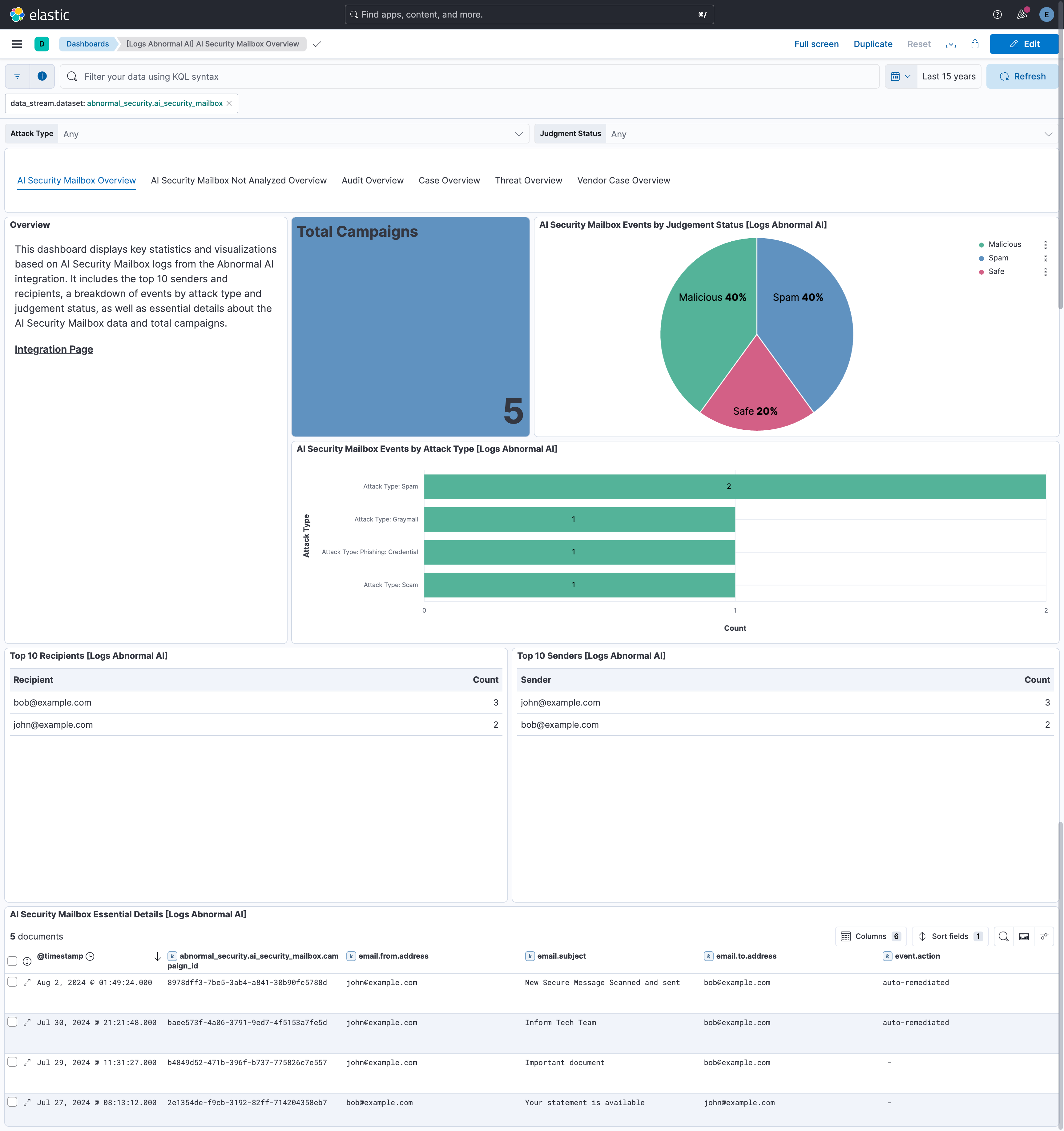

This is the ai_security_mailbox dataset.

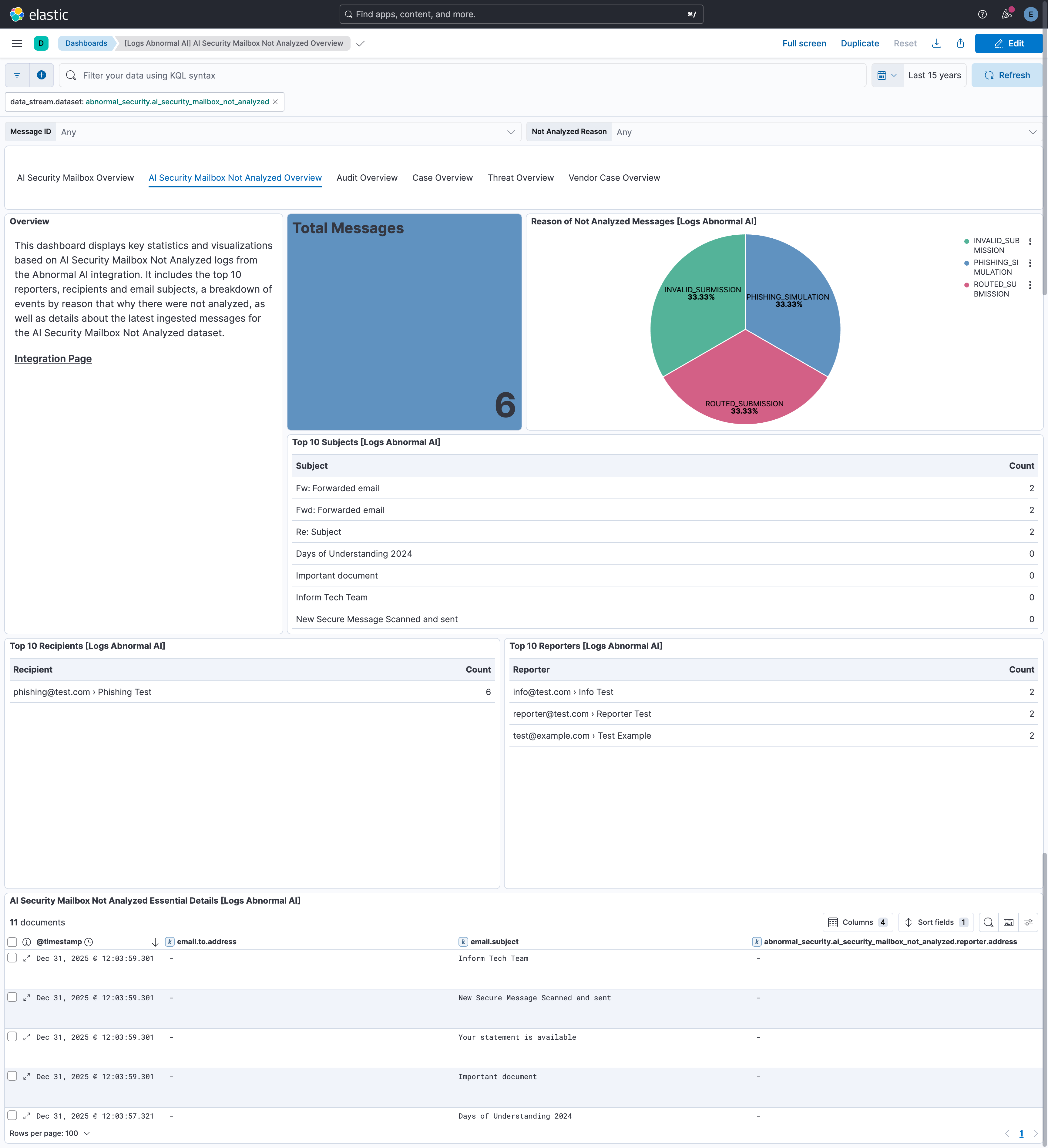

This is the ai_security_mailbox_not_analyzed dataset.

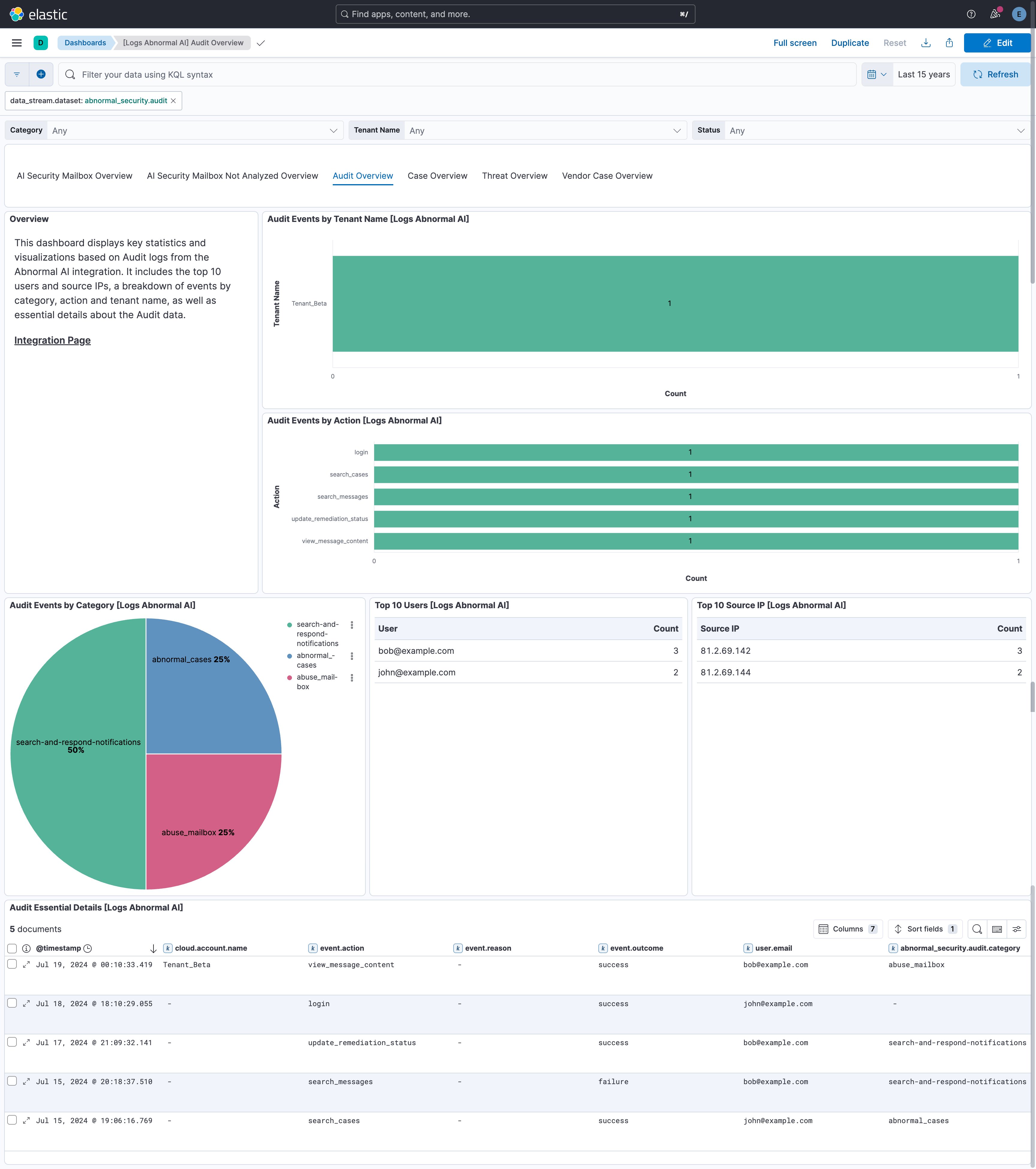

This is the audit dataset.

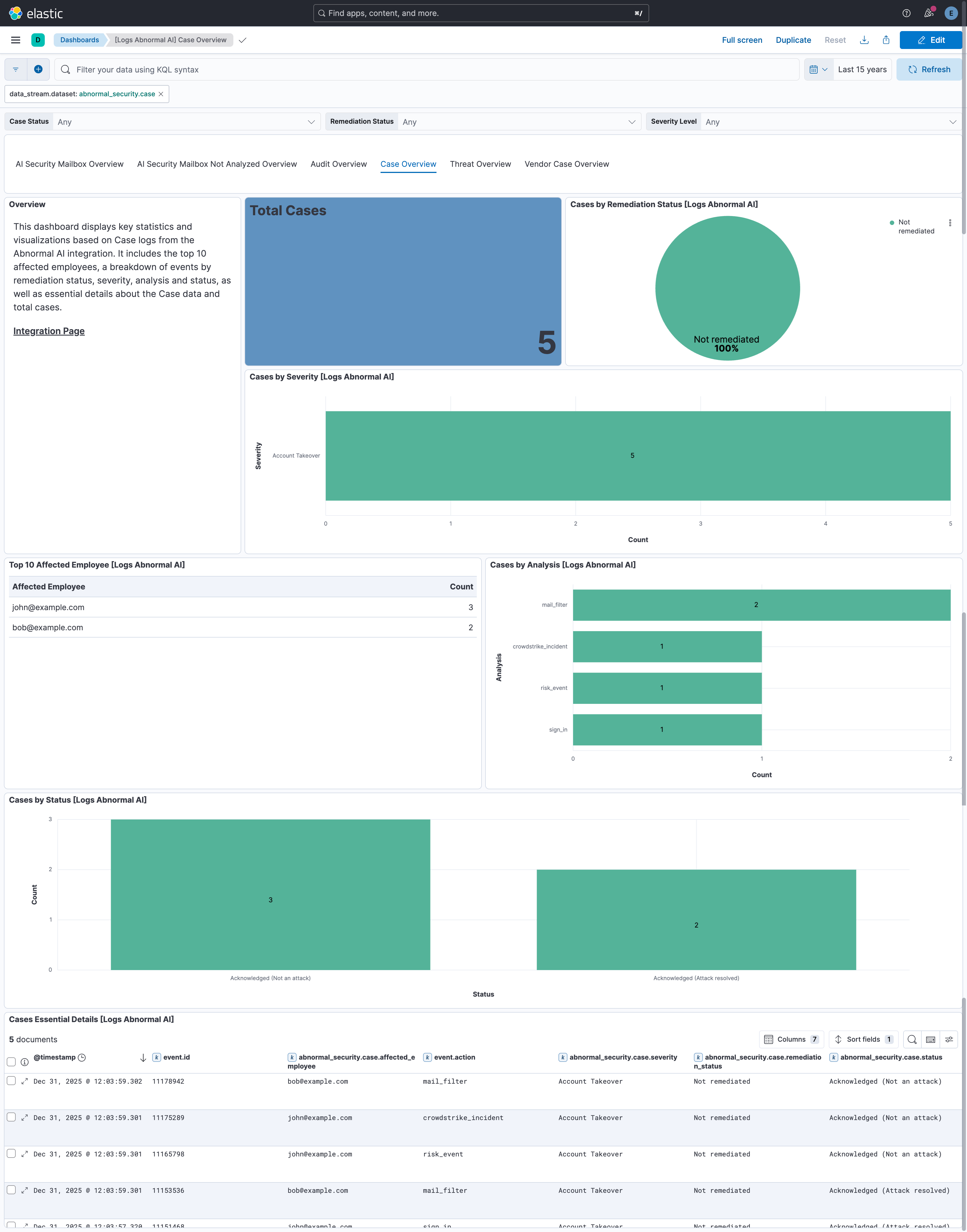

This is the case dataset.
Each time a case is modified, a new document is stored, so one case can have several documents. Use the one with the latest abnormal_security.case.last_modified for its current state.
Example
"@timestamp": "2025-09-16T10:27:11.175Z",
"abnormal_security": {
"case": {
"affected_employee": "john@example.com",
"analysis": "SIGN_IN",
"customer_visible_time": "2024-01-05T12:33:25.000Z",
"first_observed": "2024-01-05T12:33:25.000Z",
"id": "1234",
"remediation_status": "Not remediated",
"severity": "Account Takeover",
"severity_level": "LOW",
"status": "Acknowledged (Attack resolved)"
"agent": {
"ephemeral_id": "4cd31c83-7917-4ede-a402-76e83268a14c",
"id": "d8631705-0197-4ff8-94c6-0bffa12fb522",
"name": "elastic-agent-40476",
"type": "filebeat",
"version": "8.19.0"
"data_stream": {
"dataset": "abnormal_security.case",
"namespace": "92366",
"type": "logs"
"ecs": {
"version": "8.11.0"
"elastic_agent": {
"snapshot": false,
"version": "8.19.0"
"event": {
"action": "sign_in",
"id": "1234",
"ingested": "2025-09-16T10:27:14Z",
"kind": "event",
"original": "{\"affectedEmployee\":\"john@example.com\",\"analysis\":\"SIGN_IN\",\"caseId\":1234,\"case_status\":\"Acknowledged (Attack resolved)\",\"customerVisibleTime\":\"2024-01-05T12:33:25+00:00\",\"firstObserved\":\"2024-01-05T12:33:25+00:00\",\"remediation_status\":\"Not remediated\",\"severity\":\"Account Takeover\",\"severity_level\":\"LOW\",\"threatIds\":[]}",
"severity": 1,
"start": "2024-01-05T12:33:25.000Z",
"type": [
"info"
"input": {
"type": "cel"
"observer": {
"product": "Inbound Email Security",
"vendor": "Abnormal"
"related": {
"user": [
"john@example.com"
"tags": [
"preserve_original_event",
"preserve_duplicate_custom_fields",
"forwarded",
"abnormal_security-case"
"user": {
"email": "john@example.com"
Exported fields
| abnormal_security.case.affected_employee | Which employee this case pertains to. | keyword |
| abnormal_security.case.analysis | keyword | |
| abnormal_security.case.customer_visible_time | date | |
| abnormal_security.case.description | keyword | |
| abnormal_security.case.first_observed | First time suspicious behavior was observed. | date |
| abnormal_security.case.id | A unique identifier for this case. | keyword |
| abnormal_security.case.last_modified | Last time the case was modified. | date |
| abnormal_security.case.remediation_status | keyword | |
| abnormal_security.case.severity | Description of the severity level for this case. | keyword |
| abnormal_security.case.severity_level | keyword | |
| abnormal_security.case.status | keyword | |
| abnormal_security.case.threat_ids | Threats related to Case. | keyword |
| event.dataset | Event dataset. | constant_keyword |
| event.module | Event module. | constant_keyword |
| input.type | Type of filebeat input. | keyword |
| log.offset | Log offset. | long |

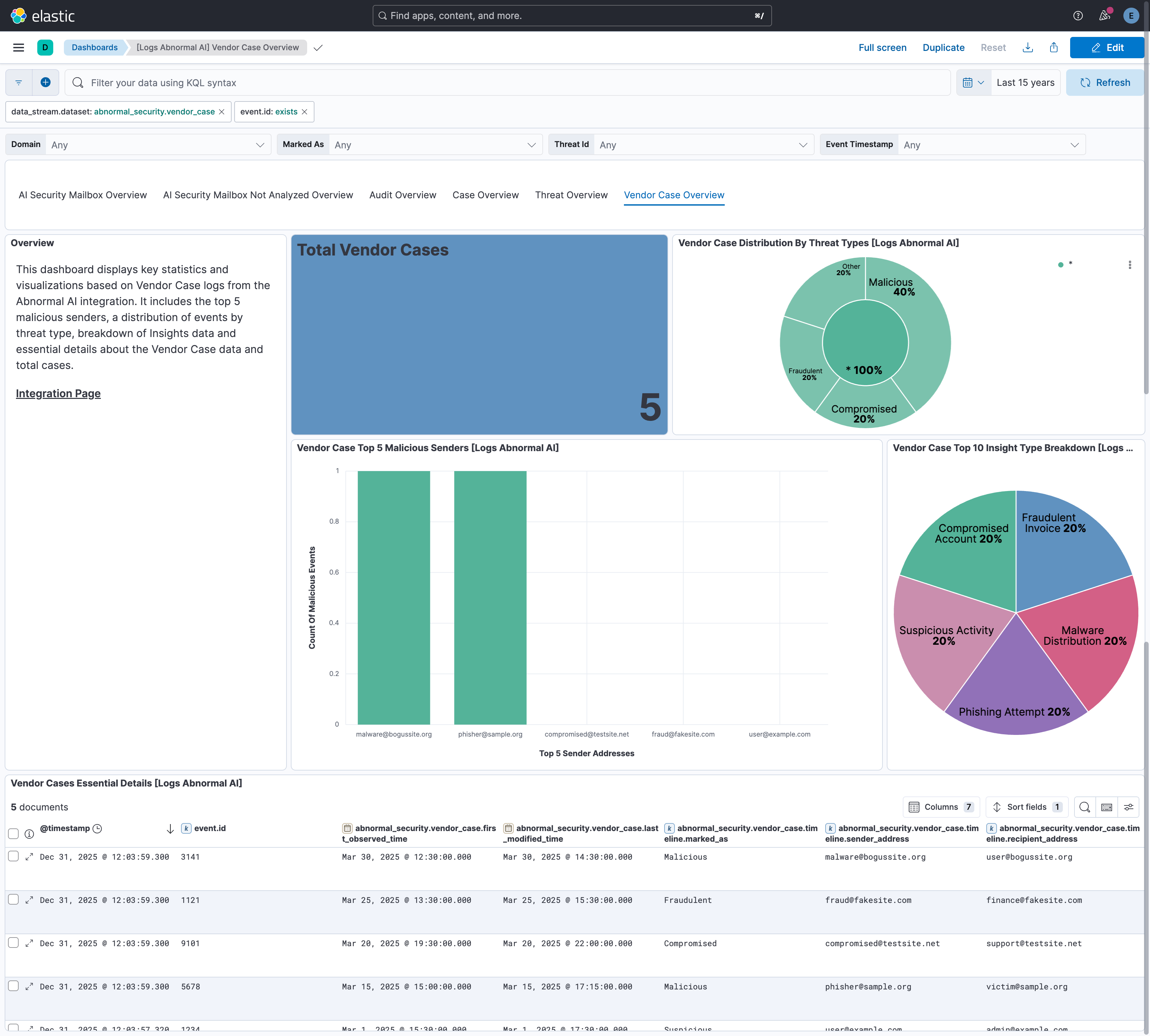

This is the vendor_case dataset.
Example
"@timestamp": "2025-09-16T10:28:43.492Z",
"vendor_case": {
"domain": "domain1.com",
"first_observed_time": "2025-04-18T08:02:21.512Z",
"id": "1234",
"insights": [
"description": "The language contained in the email body is consistent with fraud.",
"highlight": "Fraud Language"
"last_modified_time": "2025-03-15T03:02:21.512Z",
"timeline": [
"event_timestamp": "2025-03-30T08:32:21.512849+05:30",
"marked_as": "Malicious",
"recipient_address": "recipient1@example.com",
"sender_address": "sender1@example.com",
"subject": "Subject",
"threat_id": "threat1"
"agent": {
"ephemeral_id": "275f2eb6-e5af-4d09-9474-a35101db8163",
"id": "c6ffde09-9cb1-49f8-a212-541c027ec880",
"name": "elastic-agent-52145",
"type": "filebeat",
"version": "8.19.0"
"data_stream": {
"dataset": "abnormal_security.vendor_case",
"namespace": "10092",
"type": "logs"
"ecs": {
"version": "8.11.0"
"elastic_agent": {
"snapshot": false,
"version": "8.19.0"
"event": {
"id": "1234",
"ingested": "2025-09-16T10:28:46Z",
"kind": "event",
"original": "{\"firstObservedTime\":\"2025-04-18T13:32:21.512848+05:30\",\"insights\":[{\"description\":\"The language contained in the email body is consistent with fraud.\",\"highlight\":\"Fraud Language\"}],\"lastModifiedTime\":\"2025-03-15T08:32:21.512849+05:30\",\"timeline\":[{\"eventTimestamp\":\"2025-03-30T08:32:21.512849+05:30\",\"markedAs\":\"Malicious\",\"recipientAddress\":\"recipient1@example.com\",\"senderAddress\":\"sender1@example.com\",\"subject\":\"Subject\",\"threatId\":\"threat1\"}],\"vendorCaseId\":1234,\"vendorDomain\":\"domain1.com\"}",
"start": "2025-04-18T08:02:21.512Z",
"type": [
"info"
"input": {
"type": "cel"
"observer": {
"tags": [
"forwarded",
"abnormal_security-vendor_case"
Exported fields
| abnormal_security.vendor_case.domain | Domain associated with the vendor. | keyword |
| abnormal_security.vendor_case.first_observed_time | Timestamp when the case was first observed. | date |
| abnormal_security.vendor_case.id | Unique identifier for the vendor's case. | keyword |
| abnormal_security.vendor_case.insights.description | Detailed description of the insight. | text |
| abnormal_security.vendor_case.insights.highlight | Highlight or category of the insight. | keyword |
| abnormal_security.vendor_case.last_modified_time | Timestamp when the case was last modified. | date |
| abnormal_security.vendor_case.timeline.event_timestamp | Timestamp when the event occurred. | date |
| abnormal_security.vendor_case.timeline.marked_as | Classification of the event (e.g., Malicious). | keyword |
| abnormal_security.vendor_case.timeline.recipient_address | Email address of the recipient. | keyword |
| abnormal_security.vendor_case.timeline.sender_address | Email address of the sender. | keyword |
| abnormal_security.vendor_case.timeline.subject | Email subject line. | text |
| abnormal_security.vendor_case.timeline.threat_id | Identifier for the associated threat. | keyword |

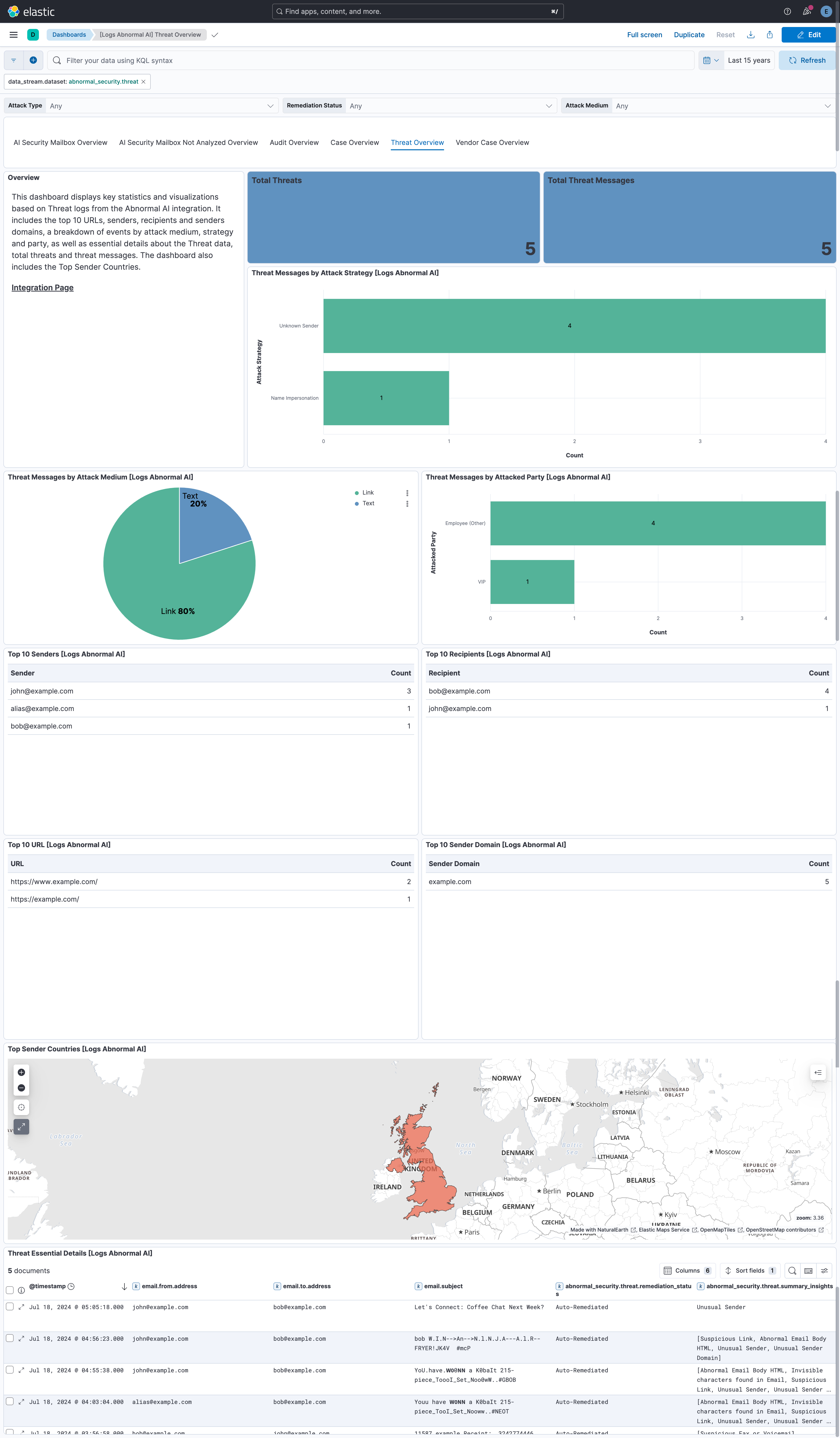

This is the threat dataset.
Each poll collects threats received in the polling window and threats remediated in it. A new document is stored each time a message's remediation status changes, so one message can have several documents. Use the one with the latest abnormal_security.threat.remediation_timestamp for its current status.
Example
"@timestamp": "2024-07-17T23:25:38.000Z",
"threat": {
"abx_message_id": "2260288475997441028",
"abx_portal_url": "https://portal.abnormalsecurity.com/home/threat-center/remediation-history/3456765434567654",
"attachment_count": 0,
"attachment_names": [
"attachment1.txt",
"attachment2.txt"
"attack": {
"strategy": "Unknown Sender",
"type": "Spam",
"vector": "Link"
"attacked_party": "Employee (Other)",
"auto_remediated": true,
"from_address": "john@example.com",
"from_name": "john",
"id": "bf255f2d-a2ad-3f50-5075-fdcc24308bbd",
"impersonated_party": "None / Others",
"internet_message_id": "<AZz8NUMEST-qmuz77_koic@example>",
"is_read": false,
"links": [
"display_text": "This is not a spoof!",
"domain": "lamronba.com",
"source": "body",
"type": "html href",
"url": "http://spoof.lamronba.com"
"domain": "lamronba2.com",
"source": "body",
"url": "http://spoof.lamronba2.com"
"post_remediated": false,
"received_time": "2024-07-17T23:25:38.000Z",
"recipient_address": "bob@example.com",
"remediation_status": "Auto-Remediated",
"remediation_timestamp": "2024-07-17T23:25:45.735Z",
"return_path": "bounce-bob_H181S7GUCF@example.com",
"sender_domain": "example.com",
"sender_ip_address": "81.2.69.142",
"sent_time": "2024-07-17T23:25:29.000Z",
"subject": "YoU.have.𝗪𝟬0𝗡𝗡 a K0baIt 215-piece_ToooI_Set_Noo0wW..#GBOB",
"summary_insights": [
"Abnormal Email Body HTML",
"Invisible characters found in Email",
"Suspicious Link",
"Unusual Sender",
"Unusual Sender Domain"
"to_addresses": [
"bob@example.com"
"url_count": 1,
"urls": [
"https://www.example.com/"
"agent": {
"ephemeral_id": "14644945-ade1-4198-9182-53deae6e4893",
"id": "156b163f-4b7f-4cea-888b-29cad76e027c",
"name": "elastic-agent-73059",
"type": "filebeat",
"version": "8.19.0"
"data_stream": {
"dataset": "abnormal_security.threat",
"namespace": "78643",
"type": "logs"
"ecs": {
"version": "8.11.0"
"elastic_agent": {
"snapshot": false,
"version": "8.19.0"
"email": {
"attachments": [
"file": {
"extension": "txt",
"name": "attachment1.txt"
"file": {
"extension": "txt",
"name": "attachment2.txt"
"delivery_timestamp": "2024-07-17T23:25:38.000Z",
"from": {
"address": [
"john@example.com"
"message_id": "<AZz8NUMEST-qmuz77_koic@example>",
"origination_timestamp": "2024-07-17T23:25:29.000Z",
"to": {
"address": [
"bob@example.com"
"event": {
"category": [
"threat",
"email"
"id": "2260288475997441028",
"ingested": "2025-09-16T10:27:57Z",
"kind": "enrichment",
"original": "{\"abxMessageId\":2260288475997441000,\"abxMessageIdStr\":\"2260288475997441028\",\"abxPortalUrl\":\"https://portal.abnormalsecurity.com/home/threat-center/remediation-history/3456765434567654\",\"attachmentCount\":0,\"attachmentNames\":[],\"attachments\":[\"attachment1.txt\",\"attachment2.txt\"],\"attackStrategy\":\"Unknown Sender\",\"attackType\":\"Spam\",\"attackVector\":\"Link\",\"attackedParty\":\"Employee (Other)\",\"autoRemediated\":true,\"ccEmails\":[],\"fromAddress\":\"john@example.com\",\"fromName\":\"john\",\"impersonatedParty\":\"None / Others\",\"internetMessageId\":\"\\u003cAZz8NUMEST-qmuz77_koic@example\\u003e\",\"isRead\":false,\"links\":[{\"display_text\":\"This is not a spoof!\",\"domain\":\"lamronba.com\",\"source\":\"body\",\"type\":\"html href\",\"url\":\"http://spoof.lamronba.com\"},{\"display_text\":\"This is not a spoof!\",\"domain\":\"lamronba2.com\",\"source\":\"body\",\"type\":\"html href\",\"url\":\"http://spoof.lamronba2.com\"}],\"postRemediated\":false,\"receivedTime\":\"2024-07-17T23:25:38Z\",\"recipientAddress\":\"bob@example.com\",\"remediationStatus\":\"Auto-Remediated\",\"remediationTimestamp\":\"2024-07-17T23:25:45.73564Z\",\"replyToEmails\":[],\"returnPath\":\"bounce-bob_H181S7GUCF@example.com\",\"senderDomain\":\"example.com\",\"senderIpAddress\":\"81.2.69.142\",\"sentTime\":\"2024-07-17T23:25:29Z\",\"subject\":\"YoU.have.𝗪𝟬0𝗡𝗡 a K0baIt 215-piece_ToooI_Set_Noo0wW..#GBOB\",\"summaryInsights\":[\"Abnormal Email Body HTML\",\"Invisible characters found in Email\",\"Suspicious Link\",\"Unusual Sender\",\"Unusual Sender Domain\"],\"threatId\":\"bf255f2d-a2ad-3f50-5075-fdcc24308bbd\",\"toAddresses\":[\"bob@example.com\"],\"urlCount\":1,\"urls\":[\"https://www.example.com/\"]}",
"reference": "https://portal.abnormalsecurity.com/home/threat-center/remediation-history/3456765434567654",
"type": [
"indicator",
"info"
"input": {
"type": "cel"
"observer": {
"related": {
"hosts": [
"example.com"
"ip": [
"81.2.69.142"
"user": [
"john@example.com",
"john",
"bob@example.com",
"source": {
"domain": "example.com",
"geo": {
"city_name": "London",
"continent_name": "Europe",
"country_iso_code": "GB",
"country_name": "United Kingdom",
"location": {
"lat": 51.5142,
"lon": -0.0931
"region_iso_code": "GB-ENG",
"region_name": "England"
"ip": "81.2.69.142"
"tags": [
"forwarded",
"abnormal_security-threat"
"threat": {
"indicator": {
"email": {
"address": "john@example.com"
"name": "john@example.com",
"type": "email-addr"
"tactic": {
"name": [
"Spam"
"technique": {
"name": [
"Unknown Sender"
"user": {
"name": "john"
Exported fields
| abnormal_security.threat.abx_message_id | A unique identifier for an individual message within a threat (i.e email campaign). | keyword |
| abnormal_security.threat.abx_portal_url | The URL at which the specific message details are viewable in Abnormal AI's Portal web interface. | keyword |
| abnormal_security.threat.attachment_count | Number of attachments in email (only available for IESS customers). | long |
| abnormal_security.threat.attachment_names | List of attachment names, if any. Attachments retrieved from the attachments endpoint are appended to this field if enrichment is enabled. | keyword |
| abnormal_security.threat.attack.strategy | keyword | |
| abnormal_security.threat.attack.type | The type of threat the message represents. | keyword |
| abnormal_security.threat.attack.vector | The attack medium. | keyword |
| abnormal_security.threat.attacked_party | The party that was targeted by an attack. | keyword |
| abnormal_security.threat.auto_remediated | Indicates whether Abnormal has automatically detected and remediated the message from the user's Inbox. Note : Abnormal has retained this field and the postRemediated field to support prior integrations, but in newly created integrations, you should capture this information from the remediationStatus field. | boolean |
| abnormal_security.threat.cc_emails | List of email addresses CC'ed. | keyword |
| abnormal_security.threat.from_address | The email address of the sender. | keyword |
| abnormal_security.threat.from_name | The display name of the sender. | keyword |
| abnormal_security.threat.id | An ID which maps to a threat campaign. A threat campaign might be received by multiple users. | keyword |
| abnormal_security.threat.impersonated_party | Impersonated party, if any. | keyword |
| abnormal_security.threat.internet_message_id | The internet message ID, per RFC 822. | keyword |
| abnormal_security.threat.is_read | Whether an email has been read. | boolean |
| abnormal_security.threat.links.display_text | The link's display text. | keyword |
| abnormal_security.threat.links.domain | The domain name of the link. | keyword |
| abnormal_security.threat.links.source | The location in the email where the link may be found. | keyword |
| abnormal_security.threat.links.type | The type of link in the email. | keyword |
| abnormal_security.threat.links.url | The URL of the link. | keyword |
| abnormal_security.threat.post_remediated | Indicates whether Abnormal remediated the campaign at a later time, after landing in the user's Inbox. Note: Abnormal has retained this field and the autoRemediated field to support prior integrations, but in newly created integrations, you should capture this information from the remediationStatus field. |
boolean |
| abnormal_security.threat.received_time | The timestamp at which this message arrived. | date |
| abnormal_security.threat.recipient_address | the email address of the user who actually received the message. | keyword |
| abnormal_security.threat.remediation_status | The remediation status of the email threat. | keyword |
| abnormal_security.threat.remediation_timestamp | The timestamp at which this message was remediated, or empty if it has not been remediated. | date |
| abnormal_security.threat.reply_to_emails | The 'reply-to' list of emails. | keyword |
| abnormal_security.threat.return_path | keyword | |
| abnormal_security.threat.sender_domain | Email domain of sender (only available for IESS customers). | keyword |
| abnormal_security.threat.sender_ip_address | IP address of sender. | ip |
| abnormal_security.threat.sent_time | The timestamp at which this message was sent. | date |
| abnormal_security.threat.subject | The email subject. | keyword |
| abnormal_security.threat.summary_insights | A summary of insights into this attack. | keyword |
| abnormal_security.threat.to_addresses | All the email addresses to which the message was sent, comma-separated & truncated at 255 chars. | keyword |
| abnormal_security.threat.url_count | Number of urls in email (only available for IESS customers). | long |
| abnormal_security.threat.urls | URLs present in the email body, if any. | keyword |
