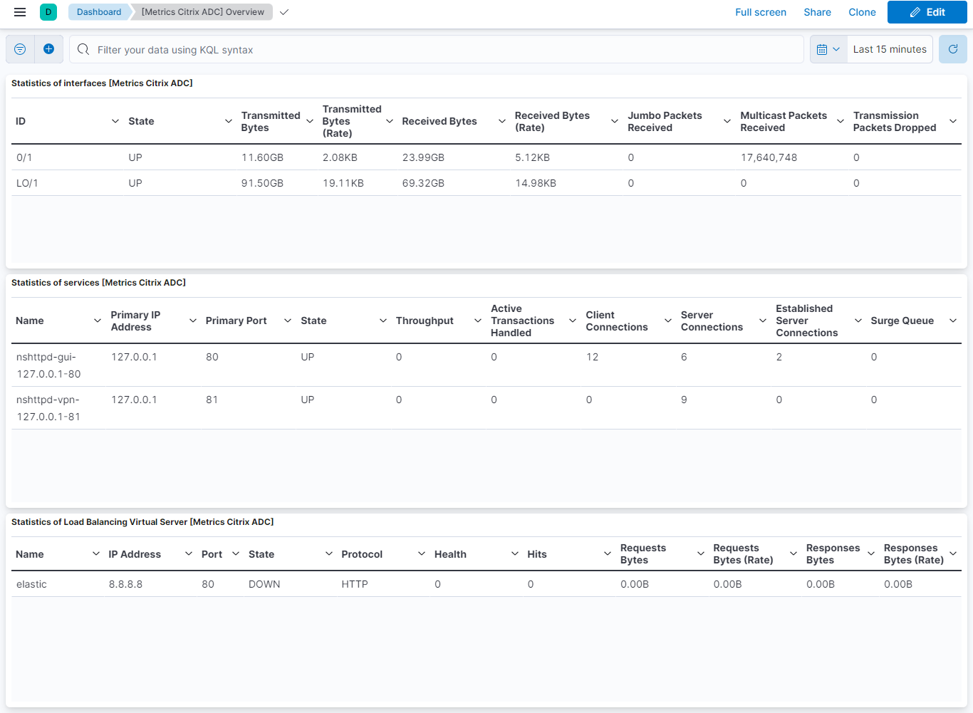

The Citrix ADC integration allows you to monitor your Citrix ADC instance. Citrix ADC is an application delivery controller that performs application-specific traffic analysis to intelligently distribute, optimize, and secure Layer 4 - Layer 7 (L4–L7) network traffic for web applications.
The Citrix Web App Firewall prevents security breaches, data loss, and possible unauthorized modifications to websites that access sensitive business or customer information. It does so by filtering both requests and responses, examining them for evidence of malicious activity, and blocking requests that exhibit such activity. Your site is protected not only from common types of attacks, but also from new, as yet unknown attacks. In addition to protecting web servers and websites from unauthorized access, the Web App Firewall protects against vulnerabilities in legacy CGI code or scripts, web frameworks, web server software, and other underlying operating systems.
Use the Citrix ADC integration to:

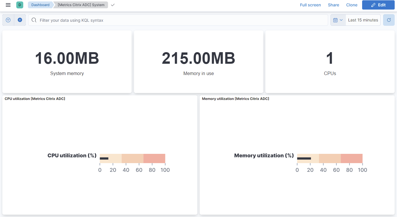

Collect metrics related to the interface, lbvserver, service, system, vpn and logs. Create visualizations to monitor, measure and analyze the usage trend and key data, and derive business insights. Create alerts to reduce the MTTD and also the MTTR by referencing relevant logs when troubleshooting an issue.
As an example, you can use the data from this integration to understand the load of the virtual servers, client-server connections, requests and responses across the Citrix ADC.
The Citrix ADC integration collects metrics data.
Metrics give you insight into the statistics of the Citrix ADC. Metrics data streams collected by the Citrix ADC integration include interface, lbvserver, service, system and vpn, so that the user could monitor and troubleshoot the performance of the Citrix ADC instances.
Log is used to retrieve Citrix Netscaler logs. See more details in the documentation here.
You can monitor metrics and logs inside the ingested documents for Citrix ADC in the logs-* index pattern from Discover.

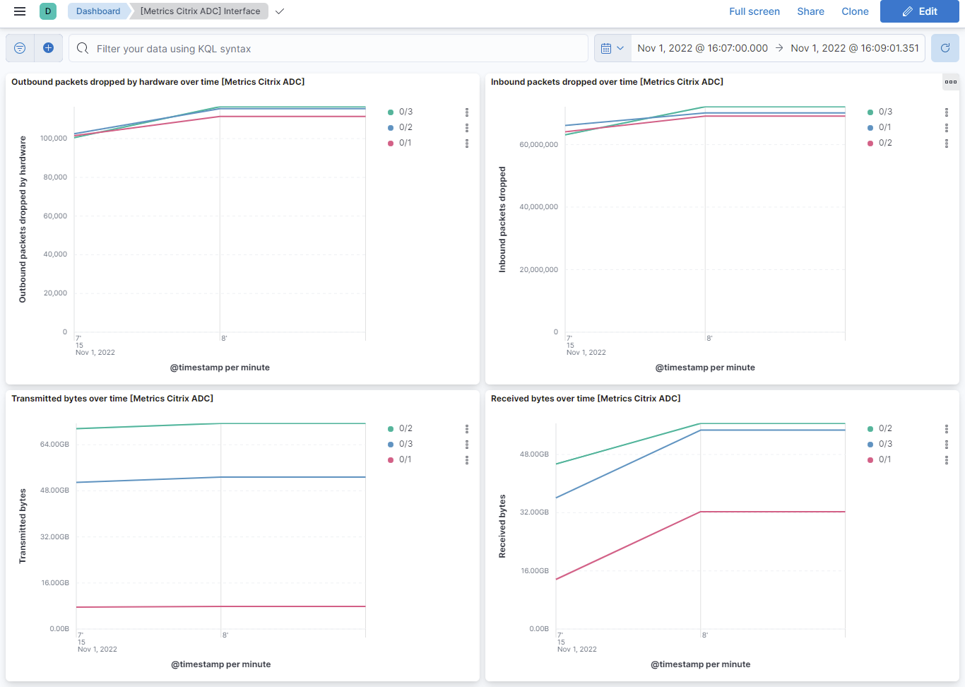

This is the interface data stream. The Citrix ADC interfaces are numbered in slot/port notation. In addition to modifying the characteristics of individual interfaces, you can configure virtual LANs to restrict traffic to specific groups of hosts. interface data stream collects metrics related to id, state, inbound packets, outbound packets and received packets.

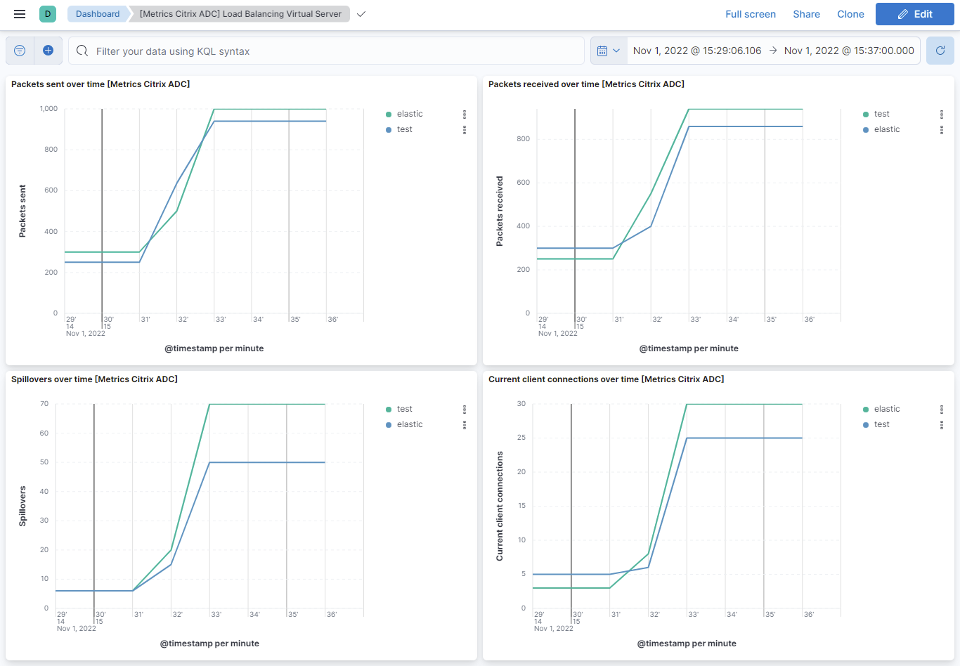

This is the lbvserver data stream. The load balancing server is logically located between the client and the server farm, and manages traffic flow to the servers in the server farm. lbvserver data stream collects metrics related to name, state, client connections, requests and responses.

"version": "8.4.1"
"event": {
"category": [
"web"
"created": "2022-10-07T06:25:28.550Z",
"dataset": "citrix_adc.lbvserver",
"ingested": "2022-10-07T06:25:32Z",
"kind": "event",
"module": "citrix_adc",
"original": "{\"actsvcs\":\"10\",\"avgcltttlb\":\"6\",\"cltresponsetimeapdex\":1,\"cltttlbtransactionsrate\":3,\"cpuusagepm\":\"10\",\"curbackuppersistencesessions\":\"8\",\"curclntconnections\":\"8\",\"curmptcpsessions\":\"13\",\"curpersistencesessions\":\"8\",\"cursrvrconnections\":\"8\",\"cursubflowconn\":\"13\",\"deferredreq\":\"13\",\"deferredreqrate\":13,\"establishedconn\":\"6\",\"frustratingttlbtransactions\":\"1\",\"frustratingttlbtransactionsrate\":1,\"h2requestsrate\":7,\"h2responsesrate\":7,\"hitsrate\":5,\"httpmaxhdrfldlenpkts\":\"3\",\"httpmaxhdrszpkts\":\"3\",\"inactsvcs\":\"6\",\"invalidrequestresponse\":\"13\",\"invalidrequestresponsedropped\":\"13\",\"labelledconn\":\"8\",\"name\":\"elastic\",\"pktsrecvdrate\":8,\"pktssentrate\":8,\"primaryipaddress\":\"8.8.8.8\",\"primaryport\":80,\"pushlabel\":\"8\",\"reqretrycount\":\"3\",\"reqretrycountexceeded\":\"3\",\"requestbytesrate\":7,\"requestsrate\":5,\"responsebytesrate\":7,\"responsesrate\":5,\"sothreshold\":\"8\",\"state\":\"DOWN\",\"surgecount\":\"8\",\"svcsurgecount\":\"8\",\"svrbusyerrrate\":3,\"tcpmaxooopkts\":\"3\",\"toleratingttlbtransactions\":\"3\",\"toleratingttlbtransactionsrate\":1,\"totalconnreassemblyqueue75\":\"13\",\"totalconnreassemblyqueueflush\":\"3\",\"totalh2requests\":\"7\",\"totalh2responses\":\"7\",\"totalpktsrecvd\":\"7\",\"totalpktssent\":\"8\",\"totalrequestbytes\":\"7\",\"totalrequests\":\"5\",\"totalresponsebytes\":\"7\",\"totalresponses\":\"5\",\"totalsvrbusyerr\":\"3\",\"totcltttlbtransactions\":\"3\",\"tothits\":\"10\",\"totspillovers\":\"8\",\"totvserverdownbackuphits\":\"13\",\"type\":\"HTTP\",\"vslbhealth\":\"67\",\"vsvrsurgecount\":\"6\"}",
"type": [
"info"
"input": {
"type": "httpjson"
"related": {
"ip": [
"8.8.8.8"
"server": {
"ip": "8.8.8.8",
"port": 80
"tags": [
"preserve_original_event",
"citrix_adc-lbvserver",
"forwarded"
ECS Field Reference
Please refer to the following document for detailed information on ECS fields.
Exported fields
| Field | Description | Type | Unit | Metric Type |
| @timestamp | Event timestamp. | date | ||
| citrix_adc.lbvserver.client.connections.current.count | Number of current client connections. | double | gauge | |
| citrix_adc.lbvserver.client.connections.established.count | Number of client connections in ESTABLISHED state. | double | gauge | |
| citrix_adc.lbvserver.client.response_time.application_performance_index | Vserver APDEX (Application Performance Index) index based on client response times. | double | ||
| citrix_adc.lbvserver.connections.actual.count | Number of current connections to the actual servers behind the virtual server. | double | gauge | |
| citrix_adc.lbvserver.down.backup.hits | Number of times traffic was diverted to the backup vserver since the primary vserver was DOWN. | double | counter | |
| citrix_adc.lbvserver.health | Health of the vserver. This gives percentage of UP services bound to the vserver. | double | ||
| citrix_adc.lbvserver.hit.count | Total vserver hits. | double | counter | |
| citrix_adc.lbvserver.hit.rate | Rate (/s) counter for tothits. | double | gauge | |
| citrix_adc.lbvserver.name | Name of the virtual server. | keyword | ||
| citrix_adc.lbvserver.packets.received.count | Total number of packets received by the service or virtual server. | double | counter | |
| citrix_adc.lbvserver.packets.sent.count | Total number of packets sent. | double | counter | |
| citrix_adc.lbvserver.packets.sent.rate | Rate (/s) counter for totalpktssent. | double | gauge | |
| citrix_adc.lbvserver.protocol | Protocol associated with the vserver. | keyword | ||
| citrix_adc.lbvserver.request.deferred.count | Number of deferred requests on specific vserver. | double | counter | |
| citrix_adc.lbvserver.request.deferred.rate | Rate (/s) counter for deferredreq. | double | gauge | |
| citrix_adc.lbvserver.request.received.bytes.rate | Rate (/s) counter for totalrequestbytes. | double | gauge | |
| citrix_adc.lbvserver.request.received.bytes.value | Total number of request bytes received on the service or virtual server. | double | byte | counter |
| citrix_adc.lbvserver.request.received.count | Total number of requests received on the service or virtual server. | double | counter | |
| citrix_adc.lbvserver.request.received.rate | Rate (/s) counter for totalrequests. | double | gauge | |
| citrix_adc.lbvserver.request.surge_queue.count | Number of requests in the surge queue. | double | gauge | |
| citrix_adc.lbvserver.request.waiting.count | Number of requests waiting on specific vserver. | double | gauge | |
| citrix_adc.lbvserver.requests_responses.dropped.count | Number invalid requests/responses dropped on the vserver. | double | counter | |
| citrix_adc.lbvserver.requests_responses.invalid.count | Number invalid requests/responses on the vserver. | double | counter | |
| citrix_adc.lbvserver.response.received.bytes.rate | Rate (/s) counter for totalresponsebytes. | double | gauge | |
| citrix_adc.lbvserver.response.received.bytes.value | Number of response bytes received by the service or virtual server. | double | byte | counter |
| citrix_adc.lbvserver.response.received.count | Number of responses received on the service or virtual server. | double | counter | |
| citrix_adc.lbvserver.response.received.rate | Rate (/s) counter for totalresponses. | double | gauge | |
| citrix_adc.lbvserver.service.active.count | Number of ACTIVE services bound to a vserver. | double | gauge | |
| citrix_adc.lbvserver.service.inactive.count | Number of INACTIVE services bound to a vserver. | double | gauge | |
| citrix_adc.lbvserver.spillover.count | Number of times vserver experienced spill over. | double | counter | |
| citrix_adc.lbvserver.state | Current state of the server. | keyword | ||
| citrix_adc.lbvserver.threshold.spillover | Spill Over Threshold set on the vserver. | double | gauge | |
| citrix_adc.lbvserver.time_to_last_byte.avg | Average TTLB (Time To Last Byte) between the client and the server. | double | gauge | |
| citrix_adc.lbvserver.transaction.frustrating.count | Frustrating transactions based on APDEX (Application Performance Index) threshold. | double | gauge | |
| citrix_adc.lbvserver.transaction.tolerable.count | Tolerable transactions based on APDEX (Application Performance Index) threshold. | double | gauge | |
| data_stream.dataset | Data stream dataset. | constant_keyword | ||
| data_stream.namespace | Data stream namespace. | constant_keyword | ||
| data_stream.type | Data stream type. | constant_keyword | ||
| input.type | Type of Filebeat input. | keyword |

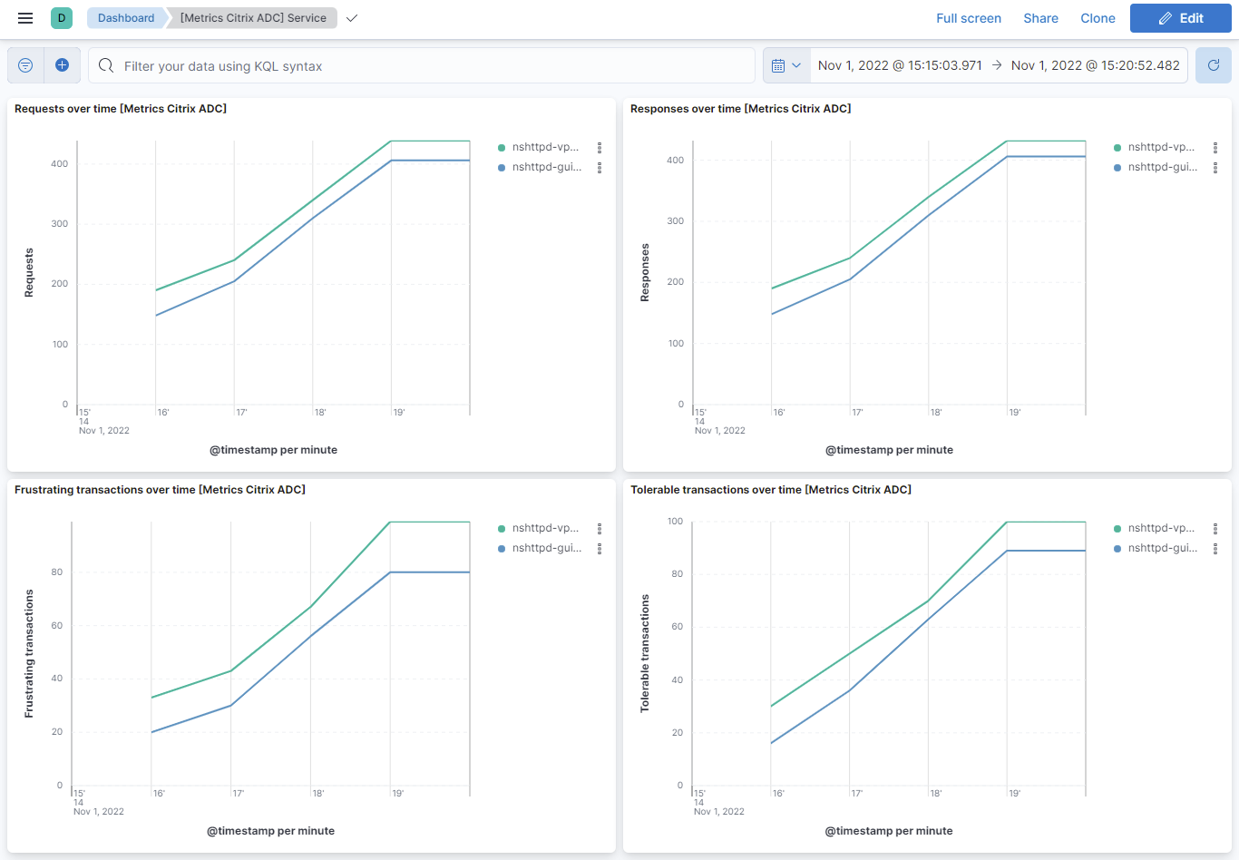

This is the service data stream. With the help of the service endpoint, metrics like throughput, client-server connections, request bytes can be collected along with other statistics for Service resources. service data stream collects metrics related to name, IP address, port, throughput and transactions.
Example
"@timestamp": "2022-10-07T06:26:11.339Z",
"agent": {
"ephemeral_id": "2fa2a685-d35a-40a6-8212-7a9dd581d647",
"id": "6713ae74-2a36-4e79-bc7b-954d6b48d5bd",
"name": "docker-fleet-agent",
"type": "filebeat",
"version": "8.4.1"
"citrix_adc": {
"service": {
"client_connection": {
"count": 8
"primary": {
"ip_address": "127.0.0.1",
"port": 80
"request": {
"bytes": {
"rate": 139,
"value": 8334520
"count": 15133,
"rate": 0
"response": {
"bytes": {
"rate": 316,
"value": 26482988
"count": 15133,
"rate": 0
"reuse_pool": 2,
"server": {
"connection": {
"count": 2,
"established": {
"count": 2
"time_to_first_byte": {
"avg": 34
"surge_queue": {
"count": 0
"throughput": {
"rate": 0,
"value": 0
"transaction": {
"active": {
"count": 0
"frustrating": {
"count": 0
"time_to_last_byte": {
"count": 0
"tolerable": {
"count": 0
"data_stream": {
"dataset": "citrix_adc.service",
"namespace": "ep",
"type": "logs"
"ecs": {
"version": "8.11.0"
"elastic_agent": {
"snapshot": false,
"version": "8.4.1"
"event": {
"category": [
"web"
"created": "2022-10-07T06:26:11.339Z",
"ingested": "2022-10-07T06:26:14Z",
"kind": "event",
"original": "{\"activetransactions\":\"0\",\"avgsvrttfb\":\"34\",\"curclntconnections\":\"8\",\"curload\":\"0\",\"curreusepool\":\"2\",\"cursrvrconnections\":\"2\",\"curtflags\":\"0\",\"frustratingttlbtransactions\":\"0\",\"httpmaxhdrfldlenpkts\":\"0\",\"httpmaxhdrszpkts\":\"0\",\"maxclients\":\"0\",\"name\":\"nshttpd-gui-127.0.0.1-80\",\"primaryipaddress\":\"127.0.0.1\",\"primaryport\":80,\"requestbytesrate\":139,\"requestsrate\":0,\"responsebytesrate\":316,\"responsesrate\":0,\"serviceorder\":\"0\",\"servicetype\":\"HTTP\",\"state\":\"UP\",\"surgecount\":\"0\",\"svrestablishedconn\":\"2\",\"tcpmaxooopkts\":\"0\",\"throughput\":\"0\",\"throughputrate\":0,\"toleratingttlbtransactions\":\"0\",\"totalconnreassemblyqueue75\":\"0\",\"totalconnreassemblyqueueflush\":\"0\",\"totalrequestbytes\":\"8334520\",\"totalrequests\":\"15133\",\"totalresponsebytes\":\"26482988\",\"totalresponses\":\"15133\",\"totsvrttlbtransactions\":\"0\",\"vsvrservicehits\":\"0\",\"vsvrservicehitsrate\":0}",
"type": [
"info"
"input": {
"type": "httpjson"
"related": {
"ip": [
"127.0.0.1"
"service": {
"name": "nshttpd-gui-127.0.0.1-80",
"state": "UP",
"type": "HTTP"
"tags": [
"citrix_adc-service",
"forwarded"
ECS Field Reference
Exported fields
| citrix_adc.service.client_connection.count | Number of current client connections. | double | counter | |
| citrix_adc.service.primary.ip_address | The IP address on which specific service is running. | ip | ||
| citrix_adc.service.primary.port | The port on which the service is running. | long | ||
| citrix_adc.service.request.bytes.rate | Rate (/s) counter for totalrequestbytes. | double | gauge | |
| citrix_adc.service.request.bytes.value | Total number of request bytes received on specific service or virtual server. | double | byte | counter |
| citrix_adc.service.request.count | Total number of requests received on specific service or virtual server. | double | counter | |
| citrix_adc.service.request.rate | Rate (/s) counter for totalrequests. | double | gauge | |
| citrix_adc.service.response.bytes.rate | Rate (/s) counter for totalresponsebytes. | double | gauge | |
| citrix_adc.service.response.bytes.value | Number of response bytes received by specific service or virtual server. | double | byte | counter |
| citrix_adc.service.response.count | Number of responses received on specific service or virtual server. | double | counter | |
| citrix_adc.service.response.rate | Rate (/s) counter for totalresponses. | double | gauge | |
| citrix_adc.service.reuse_pool | Number of requests in the idle queue/reuse pool. | double | ||
| citrix_adc.service.server.connection.count | Number of current connections to the actual servers behind the virtual server. | double | counter | |
| citrix_adc.service.server.connection.established.count | Number of server connections in ESTABLISHED state. | double | counter | |
| citrix_adc.service.server.time_to_first_byte.avg | Average TTFB (Time To First Byte) between the NetScaler appliance and the server. | double | gauge | |
| citrix_adc.service.surge_queue.count | Number of requests in the surge queue. | double | counter | |
| citrix_adc.service.throughput.rate | Rate (/s) counter for throughput. | double | gauge | |
| citrix_adc.service.throughput.value | Number of bytes received or sent by specific service (Mbps). | double | counter | |
| citrix_adc.service.transaction.active.count | Number of active transactions handled by specific service. | double | counter | |
| citrix_adc.service.transaction.frustrating.count | Frustrating transactions based on APDEX (Application Performance Index) threshold (>4T). | double | gauge | |
| citrix_adc.service.transaction.time_to_last_byte.count | Total transactions where server TTLB (Time To Last Byte) is calculated. | double | counter | |
| citrix_adc.service.transaction.tolerable.count | Tolerable transactions based on APDEX (Application Performance Index) threshold (>T ;; <4T). | double | counter | |
This is the system data stream. With the help of the system endpoint, metrics like memory in use, total system memory, CPU count can be collected along with other statistics for system resources.
Example
"@timestamp": "2022-11-03T11:58:48.678Z",
"agent": {
"ephemeral_id": "17888c67-ea5e-4c24-ad2d-6e1572930f9d",
"id": "f1fb7954-85ee-4fe3-971d-546763d1571b",
"type": "filebeat",
"version": "8.4.1"
"citrix_adc": {
"system": {
"cpu": {
"count": 1,
"utilization": {
"additional_management": {
"pct": 0
"avg": {
"pct": 4294967300
"management": {
"pct": 0.8
"master": {
"pct": 4294967300
"packets": {
"pct": 1.1
"pct": 1.1,
"slave": {
"pct": 4294967300
"disk": {
"usage": {
"flash_partition": {
"pct": 12
"var_partition": {
"pct": 12
"memory": {
"size": {
"value": 0
"usage": {
"value": 226492416
"utilization": {
"pct": 21.114572
"start": {
"time": "2022-09-22T03:50:13.000Z"
"data_stream": {
"dataset": "citrix_adc.system",
"namespace": "ep",
"type": "logs"
"ecs": {
"version": "8.11.0"
"elastic_agent": {
"snapshot": false,
"version": "8.4.1"
"event": {
"category": [
"web"
"created": "2022-11-03T11:58:48.678Z",
"ingested": "2022-11-03T11:58:52Z",
"kind": "event",
"original": "{\"errorcode\":0,\"message\":\"Done\",\"severity\":\"NONE\",\"system\":{\"addimgmtcpuusagepcnt\":0,\"auxtemp0\":0,\"auxtemp1\":0,\"auxtemp2\":0,\"auxtemp3\":0,\"auxvolt0\":0,\"auxvolt1\":0,\"auxvolt2\":0,\"auxvolt3\":0,\"auxvolt4\":0,\"auxvolt5\":0,\"auxvolt6\":0,\"auxvolt7\":0,\"cpu0temp\":0,\"cpu1temp\":0,\"cpufan0speed\":0,\"cpufan1speed\":0,\"cpuusage\":\"1\",\"cpuusagepcnt\":1.1,\"disk0avail\":1278,\"disk0perusage\":12,\"disk0size\":1585,\"disk0used\":180,\"disk1avail\":11441,\"disk1perusage\":12,\"disk1size\":14179,\"disk1used\":1603,\"fan0speed\":0,\"fan2speed\":0,\"fan3speed\":0,\"fan4speed\":0,\"fan5speed\":0,\"fanspeed\":0,\"internaltemp\":0,\"mastercpuusage\":\"4294967295\",\"memsizemb\":\"0\",\"memusagepcnt\":21.114572,\"memuseinmb\":\"216\",\"mgmtcpu0usagepcnt\":0.8,\"mgmtcpuusagepcnt\":0.8,\"numcpus\":\"1\",\"pktcpuusagepcnt\":1.1,\"powersupply1status\":\"NOT SUPPORTED\",\"powersupply2status\":\"NOT SUPPORTED\",\"powersupply3status\":\"NOT SUPPORTED\",\"powersupply4status\":\"NOT SUPPORTED\",\"rescpuusage\":\"4294967295\",\"rescpuusagepcnt\":4294967295,\"slavecpuusage\":\"4294967295\",\"starttime\":\"Thu Sep 22 03:50:13 2022\",\"starttimelocal\":\"Thu Sep 22 09:20:13 2022\",\"systemfanspeed\":0,\"timesincestart\":\"00:00:00\",\"voltagev12n\":0,\"voltagev12p\":0,\"voltagev33main\":0,\"voltagev33stby\":0,\"voltagev5n\":0,\"voltagev5p\":0,\"voltagev5sb\":0,\"voltagevbat\":0,\"voltagevcc0\":0,\"voltagevcc1\":0,\"voltagevsen2\":0,\"voltagevtt\":0}}",
"type": [
"info"
"input": {
"type": "httpjson"
"tags": [
"citrix_adc-system",
"forwarded"
ECS Field Reference
Exported fields
| citrix_adc.system.cpu.count | The number of CPUs on the NetScaler appliance. | double | gauge | |
| citrix_adc.system.cpu.utilization.additional_management.pct | Additional Management CPU utilization percentage. | double | percent | gauge |
| citrix_adc.system.cpu.utilization.avg.pct | Shows average CPU utilization percentage if more than 1 CPU is present. | double | percent | gauge |
| citrix_adc.system.cpu.utilization.management.pct | Average Management CPU utilization percentage. | double | percent | gauge |
| citrix_adc.system.cpu.utilization.master.pct | CPU 0 (currently the master CPU) utilization, as percentage of capacity. | double | percent | gauge |
| citrix_adc.system.cpu.utilization.packets.pct | Average CPU utilization percentage for all packet engines excluding management PE. | double | percent | gauge |
| citrix_adc.system.cpu.utilization.pct | CPU utilization percentage. | double | percent | gauge |
| citrix_adc.system.cpu.utilization.slave.pct | CPU 1 (currently the slave CPU) utilization, as percentage of capacity. | double | percent | gauge |
| citrix_adc.system.disk.usage.flash_partition.pct | Used space in /flash partition of the disk, as a percentage. | double | percent | gauge |
| citrix_adc.system.disk.usage.var_partition.pct | Used space in /var partition of the disk, as a percentage. | double | percent | gauge |
| citrix_adc.system.memory.size.value | Total amount of system memory, in bytes. | double | byte | gauge |
| citrix_adc.system.memory.usage.value | Main memory currently in use, in bytes. | double | byte | gauge |
| citrix_adc.system.memory.utilization.pct | Percentage of memory utilization on NetScaler. | double | percent | gauge |
| citrix_adc.system.start.time | Time when the NetScaler appliance was last started. | date | ||

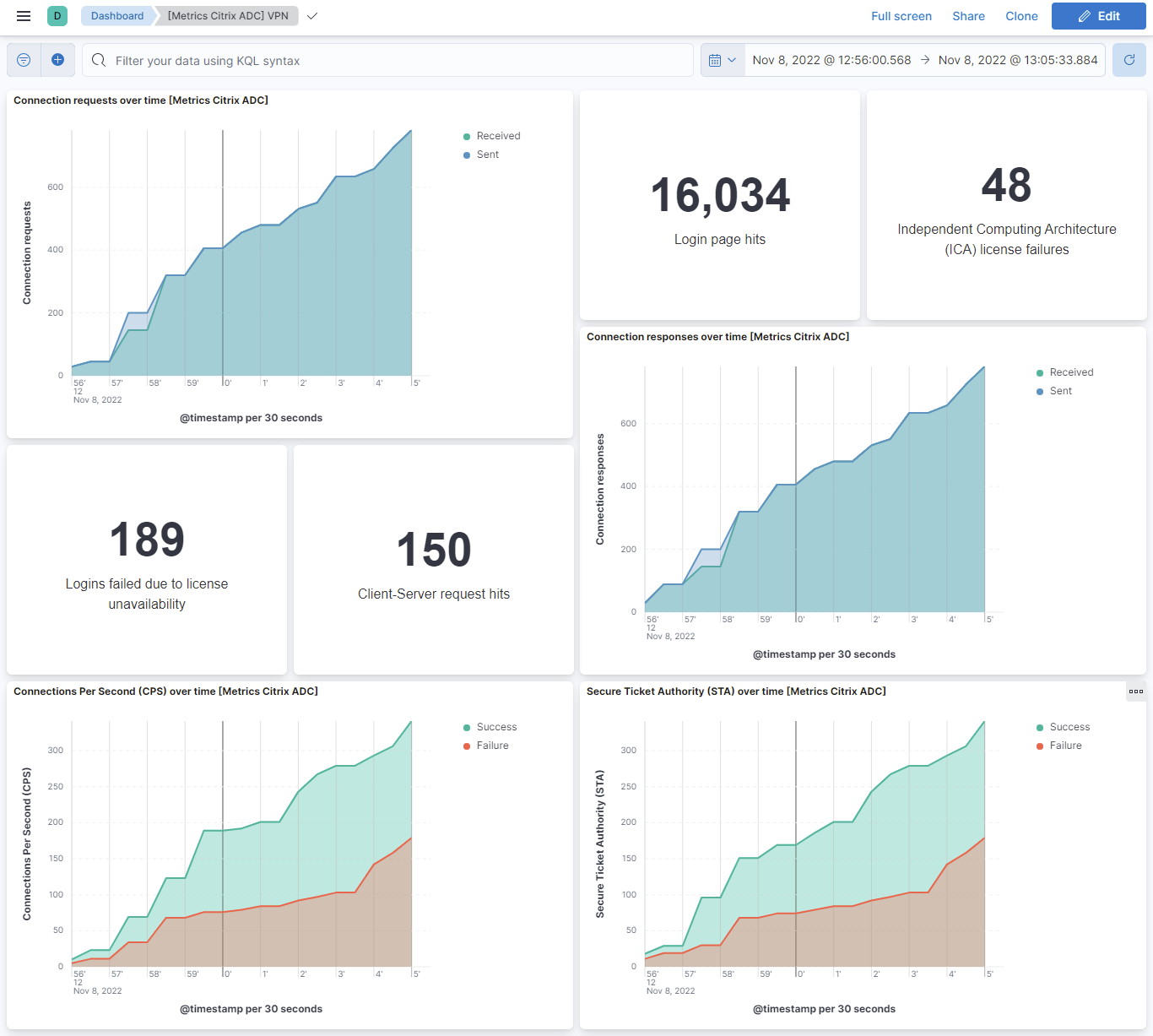

This is the vpn data stream. Citrix VPN is the add-on that provides full Secure Sockets Layer (SSL) virtual private network (VPN) capabilities to Citrix Gateway, allowing users to access remote applications on internal networks securely. vpn data stream collects metrics like CPS, ICA license, client-server requests, file system and sockets.
Example
"@timestamp": "2022-10-10T11:42:13.787Z",
"agent": {
"ephemeral_id": "8fd05f47-0933-4b28-8412-6d4b6f365dff",
"id": "98ae8a23-ea52-4679-b111-33a6d6e8db77",
"type": "filebeat",
"version": "8.4.1"
"citrix_adc": {
"vpn": {
"client_server": {
"request": {
"hit": {
"count": 16,
"rate": 16
"configuration_request_served": {
"count": 8,
"rate": 8
"cps": {
"failure": {
"count": 11,
"rate": 11
"success": {
"count": 4,
"rate": 11
"file_system": {
"request": {
"received": {
"count": 16,
"rate": 16
"ica": {
"license_failure": {
"count": 7,
"rate": 7
"login_failed": {
"license_unavailable": {
"count": 16
"login_page": {
"hits": 8
"socks": {
"client_error": {
"count": 8,
"rate": 8
"connection": {
"request": {
"received": {
"count": 3,
"rate": 2
"sent": {
"count": 2,
"rate": 2
"response": {
"received": {
"count": 2,
"rate": 2
"sent": {
"count": 8,
"rate": 8
"method": {
"request": {
"received": {
"count": 17,
"rate": 17
"sent": {
"count": 17,
"rate": 17
"response": {
"received": {
"count": 3,
"rate": 3
"sent": {
"count": 3,
"rate": 3
"server_error": {
"count": 8,
"rate": 8
"sta": {
"connection": {
"failure": {
"count": 4,
"rate": 4
"success": {
"count": 4,
"rate": 4
"request": {
"sent": {
"count": 11,
"rate": 11
"response": {
"received": {
"count": 7,
"rate": 7
"data_stream": {
"dataset": "citrix_adc.vpn",
"namespace": "ep",
"type": "logs"
"ecs": {
"version": "8.11.0"
"elastic_agent": {
"snapshot": false,
"version": "8.4.1"
"event": {
"category": [
"web"
"created": "2022-10-10T11:42:13.787Z",
"ingested": "2022-10-10T11:42:17Z",
"kind": "event",
"original": "{\"errorcode\":0,\"message\":\"Done\",\"severity\":\"NONE\",\"vpn\":{\"cfghtmlserved\":\"8\",\"cfghtmlservedrate\":8,\"cpsconnfailure\":\"11\",\"cpsconnfailurerate\":11,\"cpsconnsuccess\":\"4\",\"cpsconnsuccessrate\":11,\"csconnsuccrate\":16,\"csgconnectedusersrate\":17,\"csgptktvalidatenotstarted\":\"5\",\"csgptktvalidatenotstartedrate\":5,\"csgrtktvalidatenotstarted\":\"9\",\"csgrtktvalidatenotstartedrate\":9,\"csgtotalconnectedusers\":\"9\",\"cshttpprobehit\":\"16\",\"cshttpprobehitrate\":16,\"csnonhttpprobehit\":\"16\",\"csnonhttpprobehitrate\":16,\"csrequesthit\":\"16\",\"csrequesthitrate\":16,\"dnsreqhit\":\"8\",\"dnsreqhitrate\":8,\"fsrequestrate\":16,\"icalicensefailure\":\"7\",\"icalicensefailurerate\":7,\"iipdisabledmipdisabled\":\"9\",\"iipdisabledmipdisabledrate\":9,\"iipdisabledmipused\":\"16\",\"iipdisabledmipusedrate\":12,\"iipfailedmipdisabled\":\"9\",\"iipfailedmipdisabledrate\":9,\"iipfailedmipused\":\"12\",\"iipfailedmipusedrate\":12,\"iipspillovermipused\":\"12\",\"iipspillovermipusedrate\":12,\"indexhtmlhit\":\"8\",\"indexhtmlnoserved\":\"8\",\"socksclienterror\":\"8\",\"socksclienterrorrate\":8,\"socksconnreqrcvd\":\"3\",\"socksconnreqrcvdrate\":2,\"socksconnreqsent\":\"2\",\"socksconnreqsentrate\":2,\"socksconnresprcvd\":\"2\",\"socksconnresprcvdrate\":2,\"socksconnrespsent\":\"8\",\"socksconnrespsentrate\":8,\"socksmethreqrcvd\":\"17\",\"socksmethreqrcvdrate\":17,\"socksmethreqsent\":\"17\",\"socksmethreqsentrate\":17,\"socksmethresprcvd\":\"3\",\"socksmethresprcvdrate\":3,\"socksmethrespsent\":\"3\",\"socksmethrespsentrate\":3,\"socksservererror\":\"8\",\"socksservererrorrate\":8,\"staconnfailure\":\"4\",\"staconnfailurerate\":4,\"staconnsuccess\":\"4\",\"staconnsuccessrate\":4,\"stamonfail\":\"5\",\"stamonfailrate\":5,\"stamonrcvd\":\"7\",\"stamonrcvdrate\":5,\"stamonsent\":\"7\",\"stamonsentrate\":7,\"stamonsucc\":\"5\",\"stamonsuccrate\":5,\"starequestsent\":\"11\",\"starequestsentrate\":11,\"staresponserecvd\":\"7\",\"staresponserecvdrate\":7,\"totalcsconnsucc\":\"16\",\"totalfsrequest\":\"16\",\"vpnlicensefail\":\"16\",\"winsrequesthit\":\"16\",\"winsrequesthitrate\":16}}",
"type": [
"info"
"input": {
"type": "httpjson"
"tags": [
"citrix_adc-vpn",
"forwarded"
ECS Field Reference
Check this reference document for more information on ECS fields.
Exported fields
| Field | Description | Type | Metric Type |
| citrix_adc.vpn.client_server.request.hit.count | Number of SSL VPN tunnels formed between VPN server and client. | double | gauge |
| citrix_adc.vpn.client_server.request.hit.rate | Rate (/s) counter for cpsconnsuccess. | double | gauge |
| citrix_adc.vpn.configuration_request_served.count | Number of client configuration requests received by VPN server. | double | gauge |
| citrix_adc.vpn.configuration_request_served.rate | Rate (/s) counter for cfghtmlserved. | double | gauge |
| citrix_adc.vpn.cps.failure.count | Number of CPS connection failures. | double | counter |
| citrix_adc.vpn.cps.failure.rate | Rate (/s) counter for cpsconnfailure. | double | gauge |
| citrix_adc.vpn.cps.success.count | Number of CPS connection success. | double | counter |
| citrix_adc.vpn.cps.success.rate | Rate (/s) counter for cpsconnsuccess. | double | gauge |
| citrix_adc.vpn.file_system.request.received.count | Number of file system requests received by VPN server. | double | counter |
| citrix_adc.vpn.file_system.request.received.rate | Rate (/s) counter for totalfsrequest. | double | gauge |
| citrix_adc.vpn.ica.license_failure.count | Number of ICA (Independent Computing Architecture) license failures. | double | counter |
| citrix_adc.vpn.ica.license_failure.rate | Rate (/s) counter for icalicensefailure. | double | gauge |
| citrix_adc.vpn.login_failed.license_unavailable.count | Number of users not able to login because of license unavailability. | double | counter |
| citrix_adc.vpn.login_page.hits | Number of requests for VPN login page. | double | counter |
| citrix_adc.vpn.socks.client_error.count | Number of SOCKS client errors. | double | counter |
| citrix_adc.vpn.socks.client_error.rate | Rate (/s) counter for socksclienterror. | double | gauge |
| citrix_adc.vpn.socks.connection.request.received.count | Number of received SOCKS connect requests. | double | counter |
| citrix_adc.vpn.socks.connection.request.received.rate | Rate (/s) counter for socksconnreqrcvd. | double | gauge |
| citrix_adc.vpn.socks.connection.request.sent.count | Number of sent SOCKS connect requests. | double | counter |
| citrix_adc.vpn.socks.connection.request.sent.rate | Rate (/s) counter for socksconnreqsent. | double | gauge |
| citrix_adc.vpn.socks.connection.response.received.count | Number of received SOCKS connect responses. | double | counter |
| citrix_adc.vpn.socks.connection.response.received.rate | Rate (/s) counter for socksconnresprcvd. | double | gauge |
| citrix_adc.vpn.socks.connection.response.sent.count | Number of sent SOCKS connect responses. | double | counter |
| citrix_adc.vpn.socks.connection.response.sent.rate | Rate (/s) counter for socksconnrespsent. | double | gauge |
| citrix_adc.vpn.socks.method.request.received.count | Number of received SOCKS method requests. | double | counter |
| citrix_adc.vpn.socks.method.request.received.rate | Rate (/s) counter for socksmethreqrcvd. | double | gauge |
| citrix_adc.vpn.socks.method.request.sent.count | Number of sent SOCKS method requests. | double | counter |
| citrix_adc.vpn.socks.method.request.sent.rate | Rate (/s) counter for socksmethreqsent. | double | gauge |
| citrix_adc.vpn.socks.method.response.received.count | Number of received SOCKS method responses. | double | counter |
| citrix_adc.vpn.socks.method.response.received.rate | Rate (/s) counter for socksmethresprcvd. | double | gauge |
| citrix_adc.vpn.socks.method.response.sent.count | Number of sent SOCKS method responses. | double | counter |
| citrix_adc.vpn.socks.method.response.sent.rate | Rate (/s) counter for socksmethrespsent. | double | gauge |
| citrix_adc.vpn.socks.server_error.count | Number of SOCKS server errors. | double | counter |
| citrix_adc.vpn.socks.server_error.rate | Rate (/s) counter for socksservererror. | double | gauge |
| citrix_adc.vpn.sta.connection.failure.count | Number of STA (Secure Ticket Authority) connection failures. | double | counter |
| citrix_adc.vpn.sta.connection.failure.rate | Rate (/s) counter for staconnfailure. | double | gauge |
| citrix_adc.vpn.sta.connection.success.count | Number of STA (Secure Ticket Authority) connection success. | double | counter |
| citrix_adc.vpn.sta.connection.success.rate | Rate (/s) counter for staconnsuccess. | double | gauge |
| citrix_adc.vpn.sta.request.sent.count | Number of STA (Secure Ticket Authority) requests sent. | double | counter |
| citrix_adc.vpn.sta.request.sent.rate | Rate (/s) counter for starequestsent. | double | gauge |
| citrix_adc.vpn.sta.response.received.count | Number of STA (Secure Ticket Authority) responses received. | double | counter |
| citrix_adc.vpn.sta.response.received.rate | Rate (/s) counter for staresponserecvd. | double | gauge |
