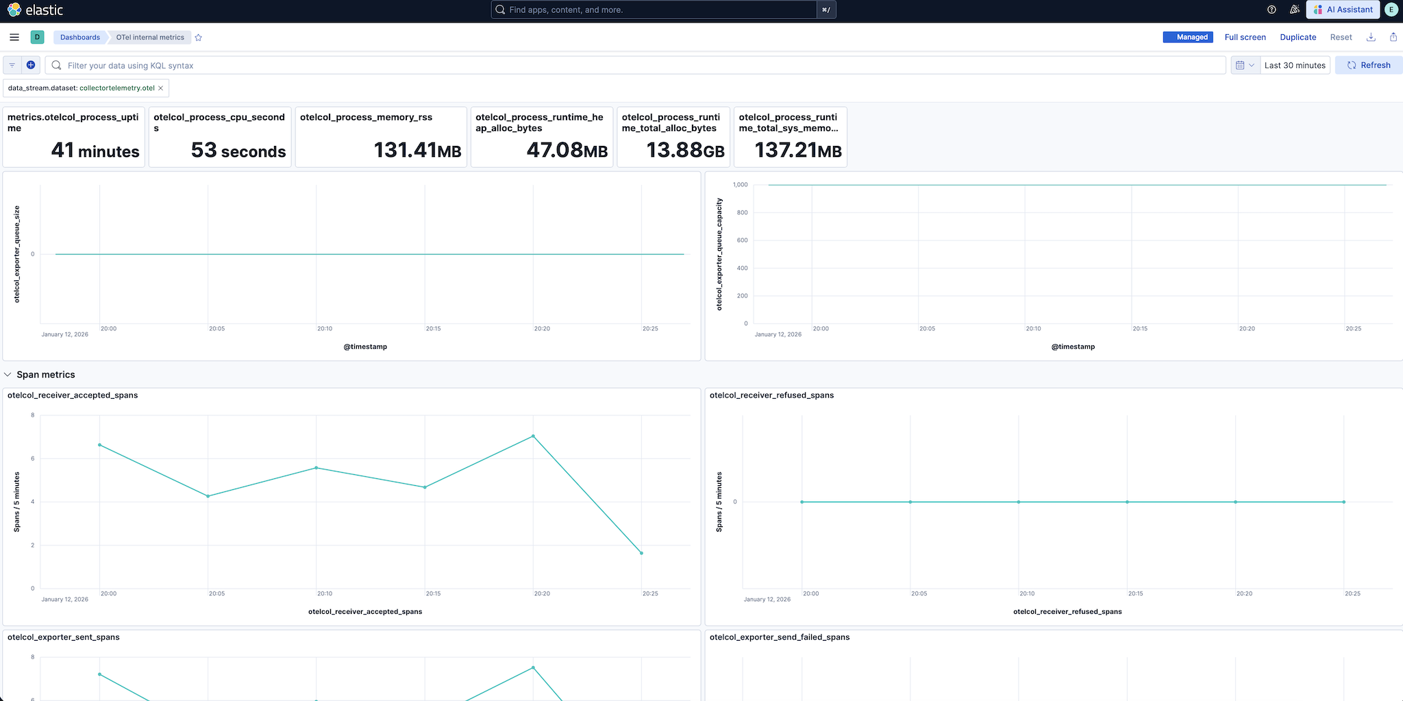

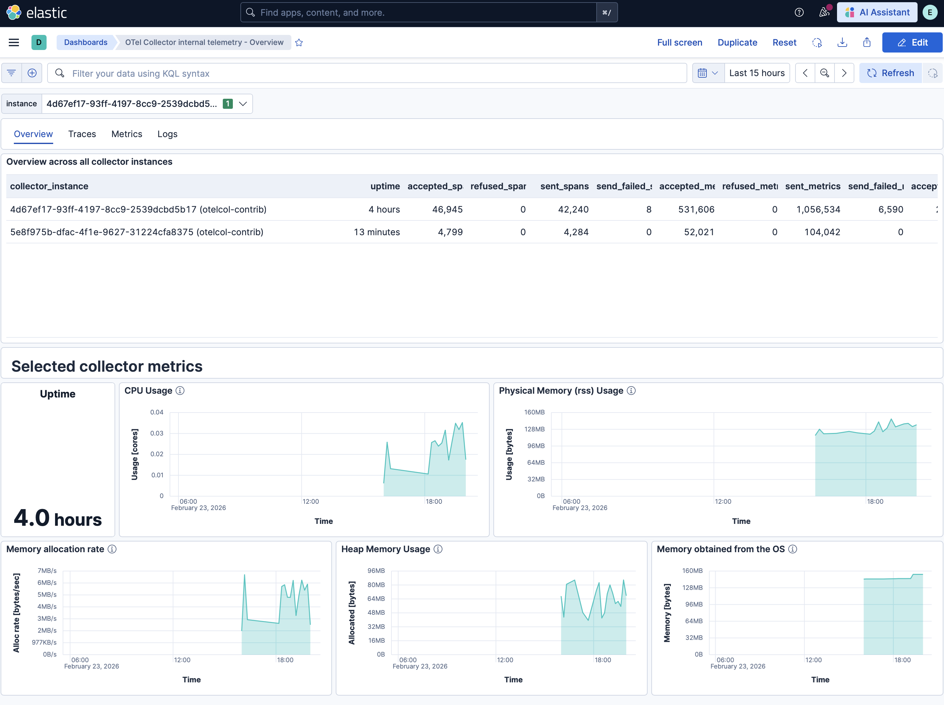

This package contains dashboards that visualize the internal metrics from OpenTelemetry components.
The OTel collector dashboards are compatible with the metrics defined here in the OpenTelemetry collector documentation. The oldest tested version of the OpenTelemetry Collector in combination with this package is v1.44.0.
Furthermore, the package also contains dashboards to visualize metrics from the tailsamplingprocessor. Those metrics are documented here.
The dashboards query metrics from the collectortelemetry dataset. Set the resource attribute data_stream.dataset to collectortelemetry on the collector that emits internal telemetry (see below).
The dashboards expect metrics without postfixes. In particular, Prometheus-format metrics—which apply unit suffixes by default—are not supported. The dashboards are designed for metrics exported via OTLP. If you use the Prometheus exporter, set without_type_suffix and without_units to true. For more information, see the upstream documentation.
The dashboards rely on field names defined in above documentations.
You need to follow the documentation of the OpenTelemetry collector to setup and send internal telemetry to your cluster.
The most important prerequisite is to define the telemetry section under service and to set data_stream.dataset to collectortelemetry.
