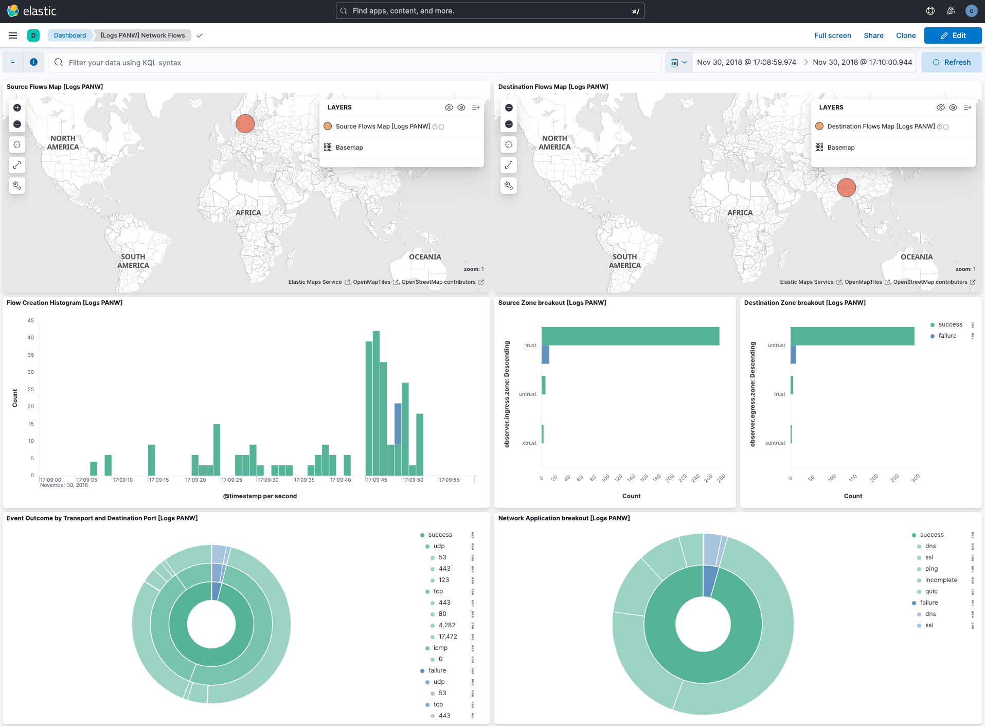

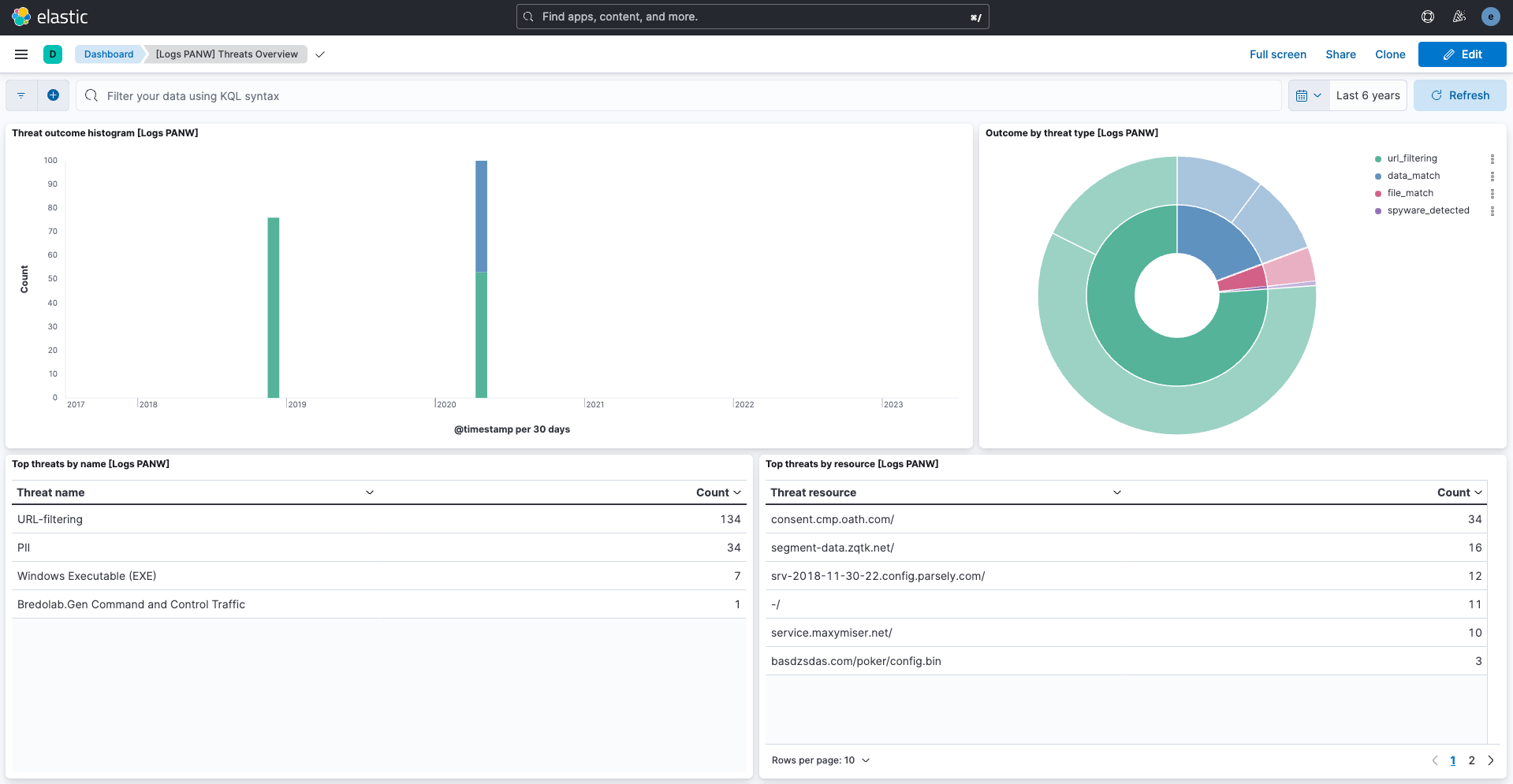

- In Kibana, navigate to Dashboards.
- In the search bar, type Logs PANW.
- Select a dashboard overview for the data type you are collecting, and verify the dashboard information is populated.
