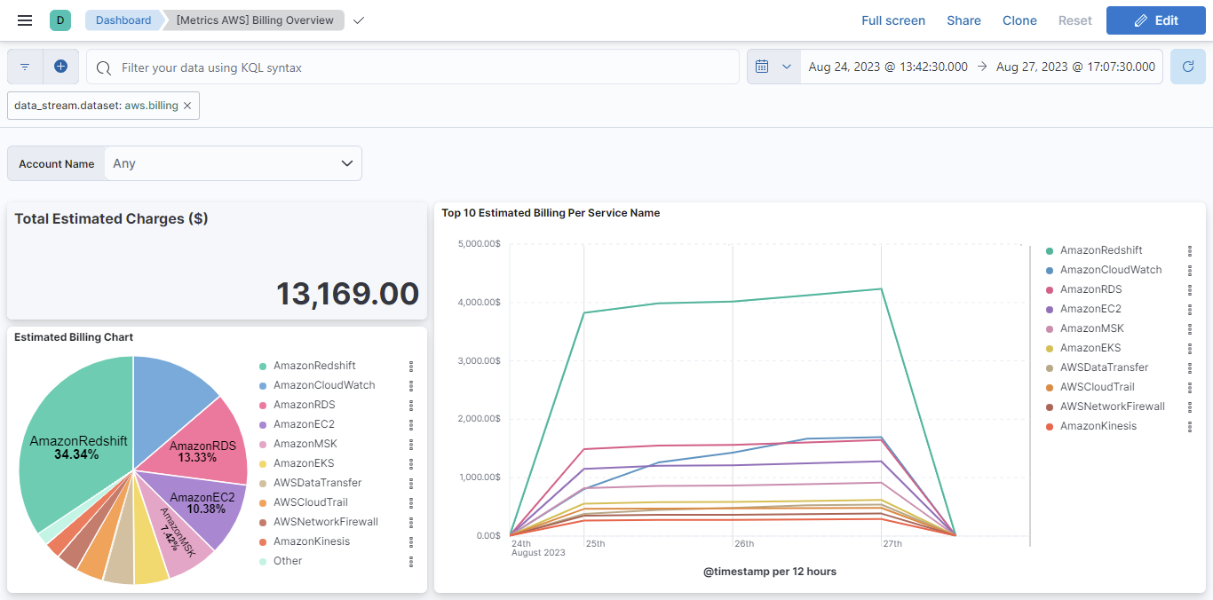

The AWS Billing integration allows you to monitor your AWS spending.
Use the AWS Billing integration to collect metrics related to your monthly AWS bills. Then visualize that data in Kibana, create alerts to notify you if something goes wrong, and reference metrics when troubleshooting an issue.
For example, you could use this data to easily view your total estimated charges or billing by service. Then you can alert the relevant budget holder about those costs by email.
