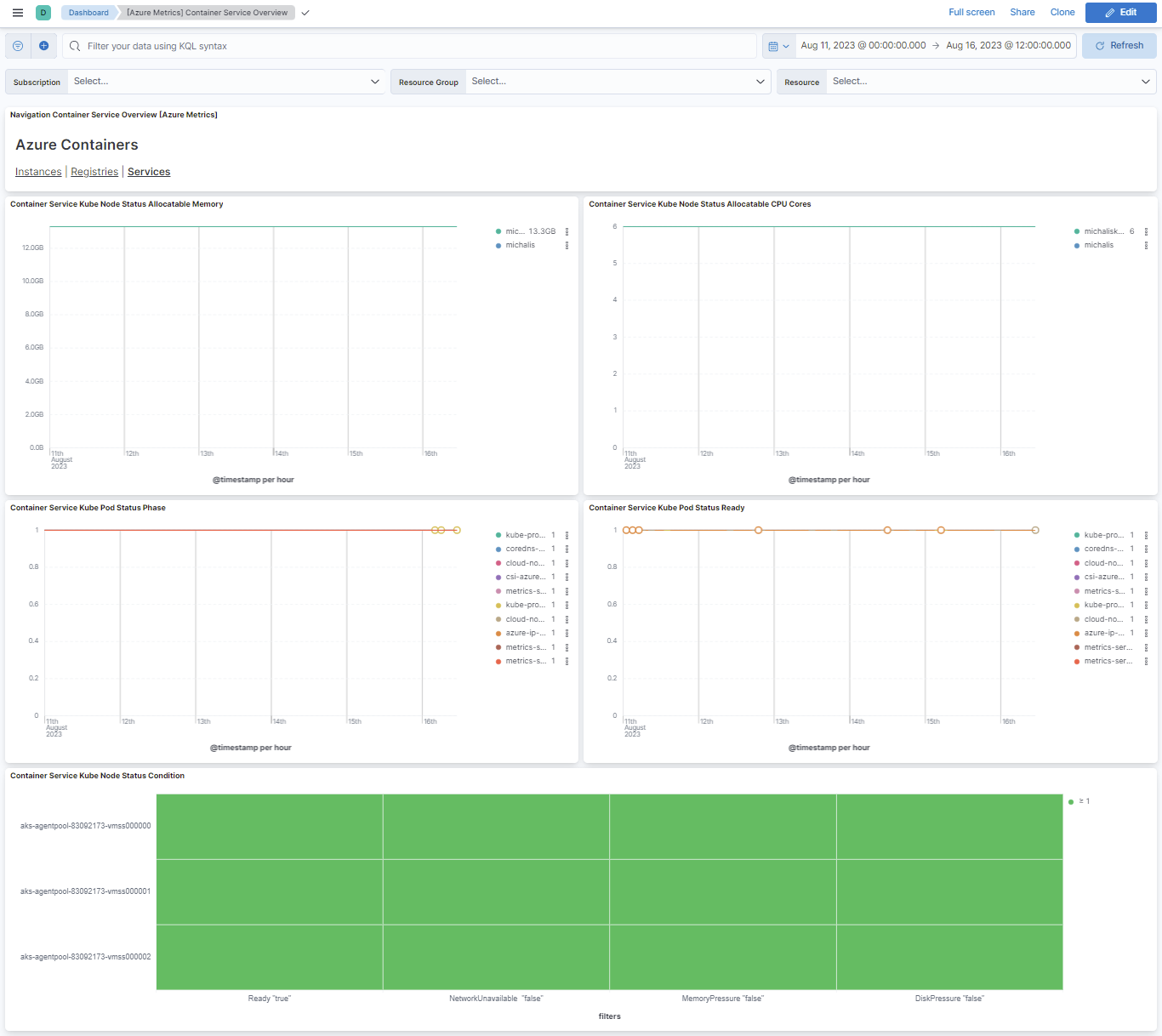

The Azure Container Service data stream collects and aggregates container service related metrics from Azure Container Service type resources where it can be used for analysis, visualization, and alerting. The Azure Container Service will periodically retrieve the Azure Monitor metrics using the Azure REST APIs as MetricList. Additional Azure API calls will be executed to retrieve information regarding the resources targeted by the user.
Before you start, check the Authentication and costs section.
Follow these step-by-step instructions on how to set up an Azure metrics integration.
Period:: (string) Reporting interval. Metrics will have a timegrain of 5 minutes, so the Period configuration option for container_service should have a value of 300s or multiple of 300sfor relevant results.
Resource IDs:: ([]string) The fully qualified ID's of the resource, including the resource name and resource type. Has the format /subscriptions/{guid}/resourceGroups/{resource-group-name}/providers/{resource-provider-namespace}/{resource-type}/{resource-name}.
Should return a list of resources.
Resource Groups:: ([]string) This option will return all container services inside the resource group.
If no resource filter is specified, then all container services inside the entire subscription will be considered.
The primary aggregation value will be retrieved for all the metrics contained in the namespaces. The aggregation options are avg, sum, min, max, total, count.

| azure.container_service.kube_node_status_allocatable_cpu_cores.avg | Total number of available cpu cores in a managed cluster | float | gauge |
| azure.container_service.kube_node_status_allocatable_memory_bytes.avg | Total amount of available memory in a managed cluster | float | gauge |
| azure.container_service.kube_node_status_condition.avg | Statuses for various node conditions | float | gauge |
| azure.container_service.kube_pod_status_phase.avg | Number of pods by phase | float | gauge |
| azure.container_service.kube_pod_status_ready.avg | Number of pods in Ready state | float | gauge |
