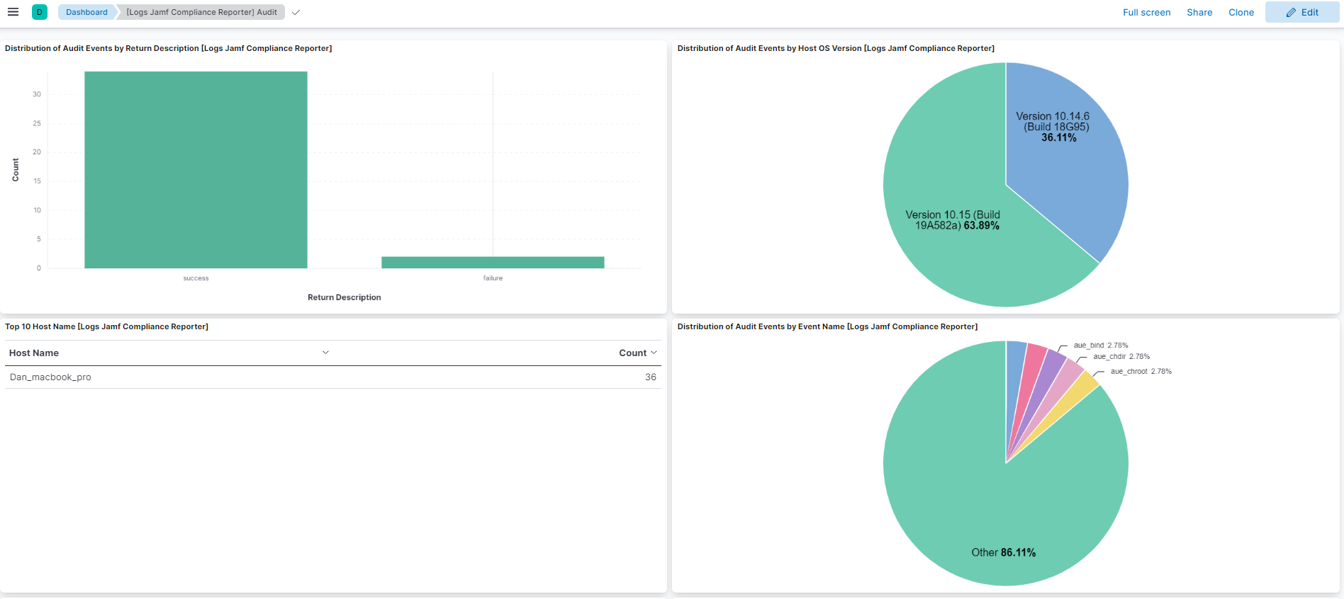

The Jamf Compliance Reporter integration collects and parses data received from Jamf Compliance Reporter using a TLS or HTTP endpoint.
Use the Jamf Compliance Reporter integration to collect logs from your machines. Then visualize that data in Kibana, create alerts to notify you if something goes wrong, and reference data when troubleshooting an issue.
For example, if you wanted to monitor shell script commands performed by the root user, you could configure Jamf to monitor those events and then send them to Elastic for further investigation.
The Jamf Compliance Reporter integration collects one type of data stream: logs.
Logs help you keep a record of events happening on computers using Jamf. The log data stream collected by the Jamf Compliance Reporter integration includes events that are related to security compliance requirements. See more details in the Logs.
