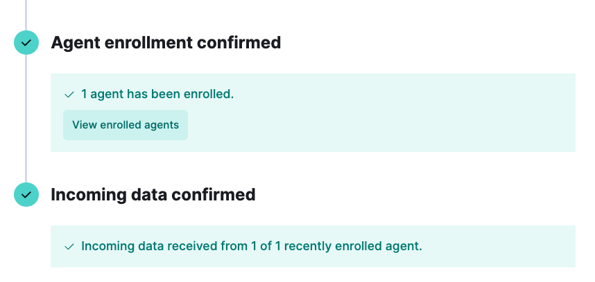

  10. In the Add agent flyout, wait a minute or so for confirmation that Elastic Agent has successfully enrolled with Fleet and that data is flowing:

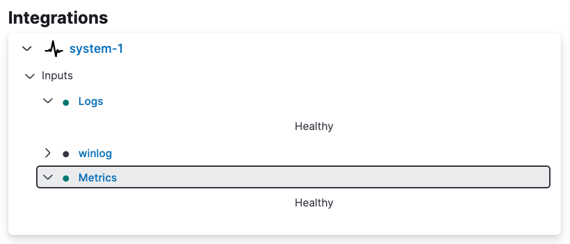

  12. Select the agent to view its details.
  13. On the Agent details tab, on the Integrations pane, expand system-1 to confirm that logs and metrics are incoming. You can click either the Logs or Metrics link to view details.
    Screen capture of the Logs and Metrics view on the Integrations pane

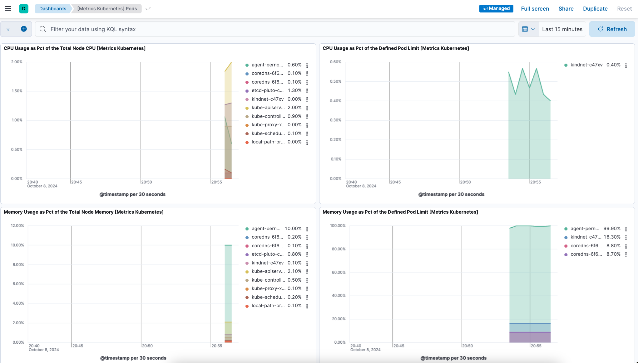

  6. On the Kubernetes integration page, open the Assets tab and select the [Metrics Kubernetes] Pods dashboard.
    On the dashboard, you can view the status of your Kubernetes pods, including metrics on memory usage, CPU usage, and network throughput.
    Screen capture of the Metrics Kubernetes pods dashboard
