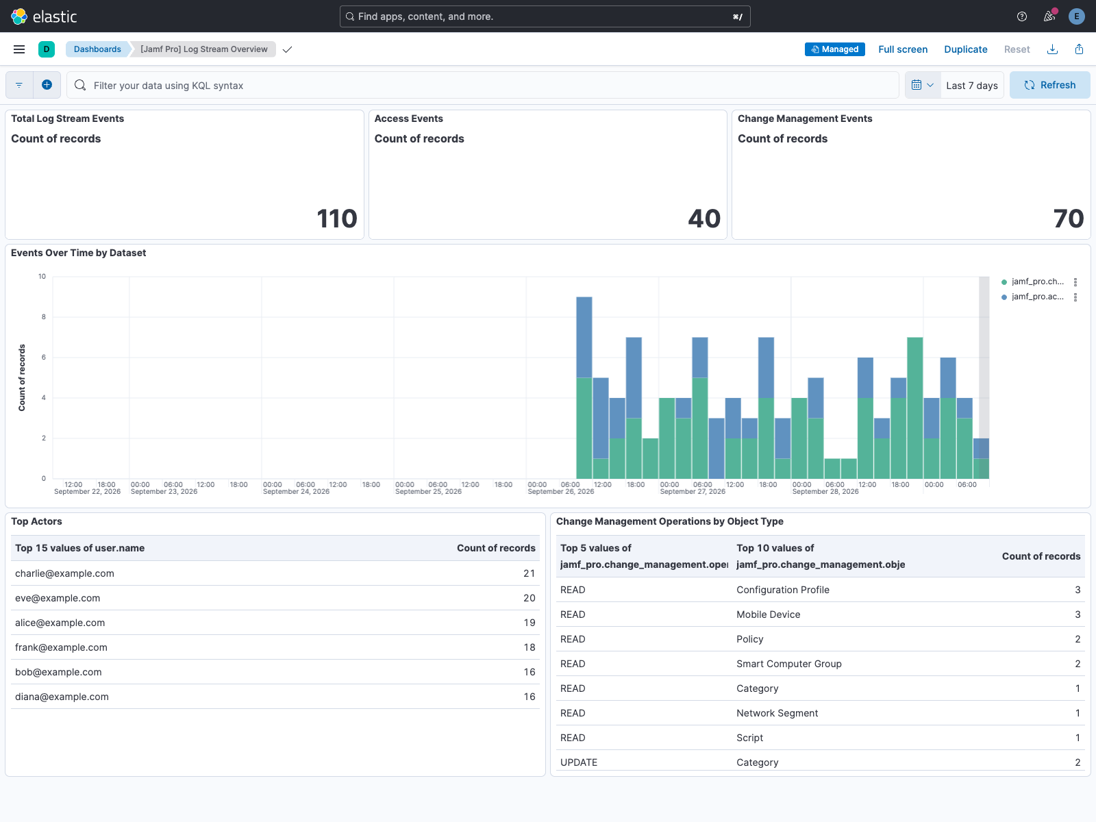

The integration ships a Log Stream Overview dashboard that summarizes access and change management events — event volume over time, top actors, and a breakdown of change management operations by object type. It is tagged Security Solution, so it also appears in the Security app, and can be found in Kibana under Dashboards after installing the integration.
