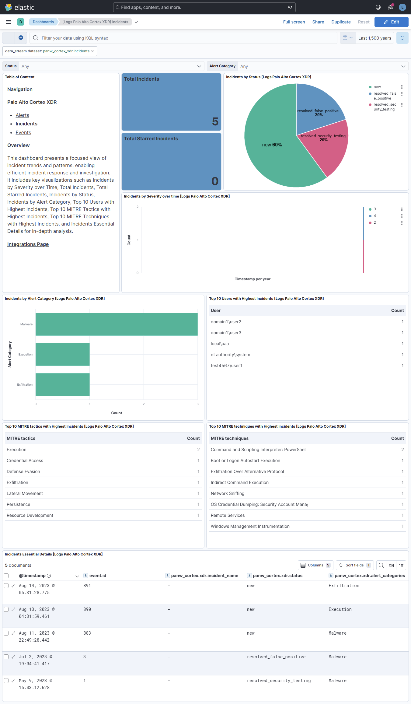

Incidents – Retrieves incidents generated by Cortex XDR. Each incident may include one or more endpoint events, each stored as a separate document in Elasticsearch. When an incident is modified in the Cortex XDR UI (e.g., severity or status changes, alerts linked), a new document reflecting the updated values is indexed. Requires both an API Key and API Key ID.

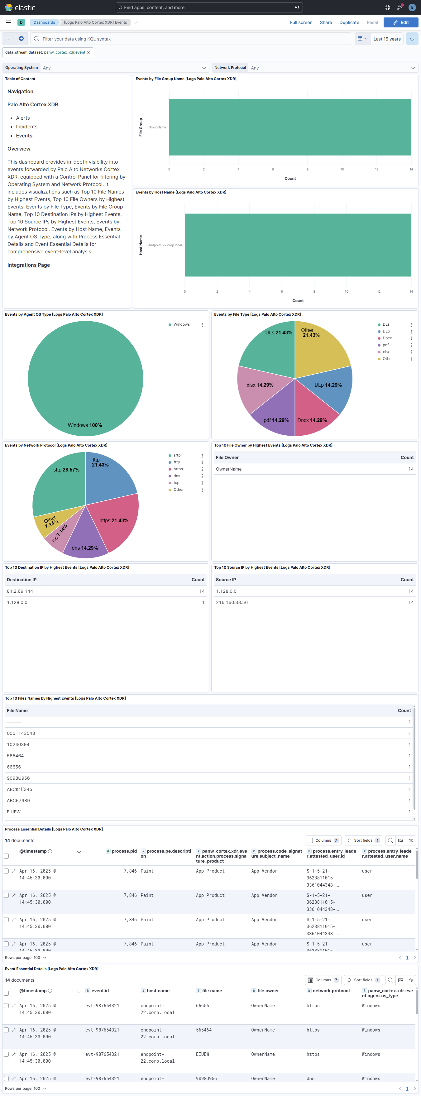

Event - Retrieves events forwarded by Cortex XDR to Google Cloud Storage (GCS).

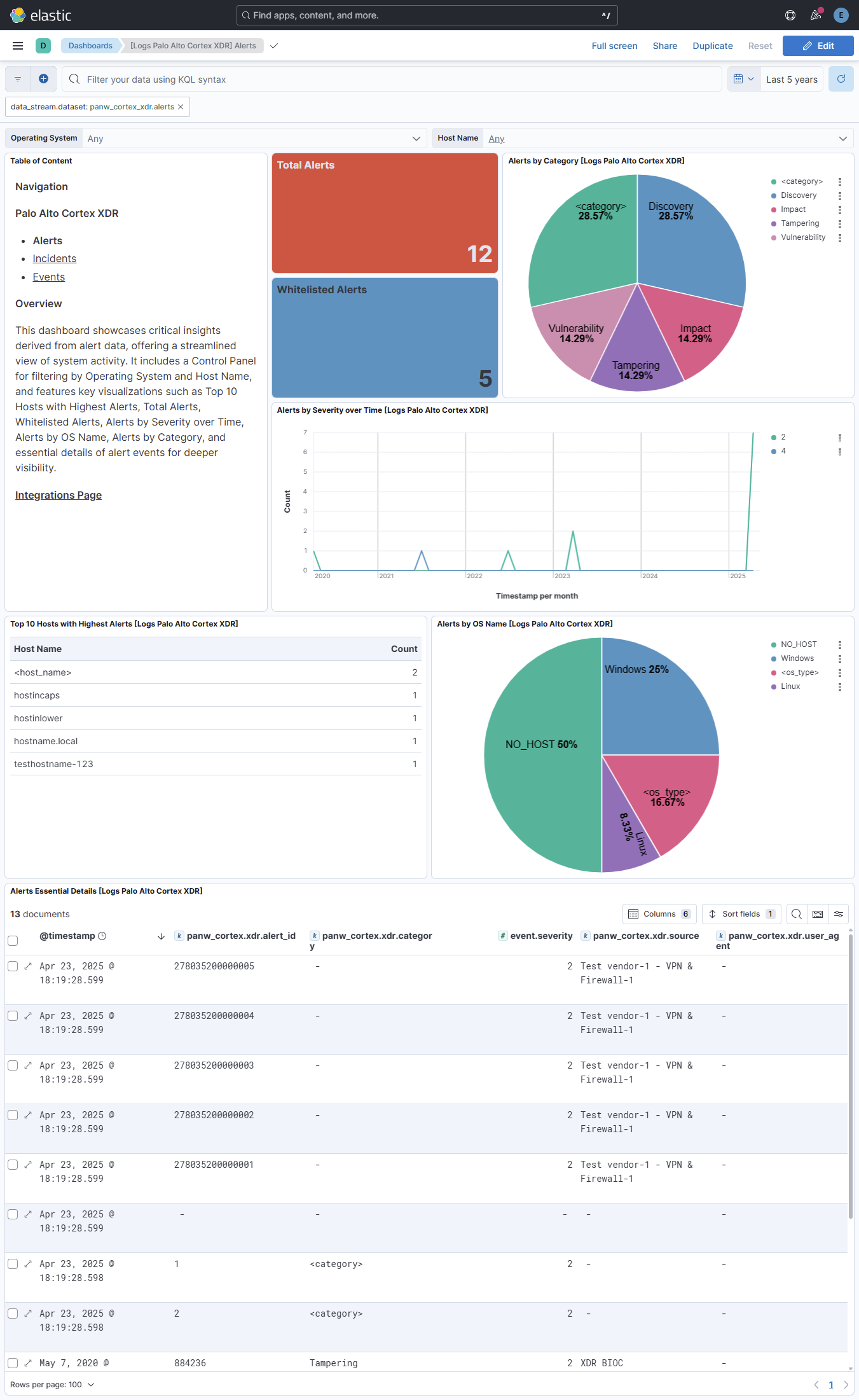

This is the Alerts dataset.
