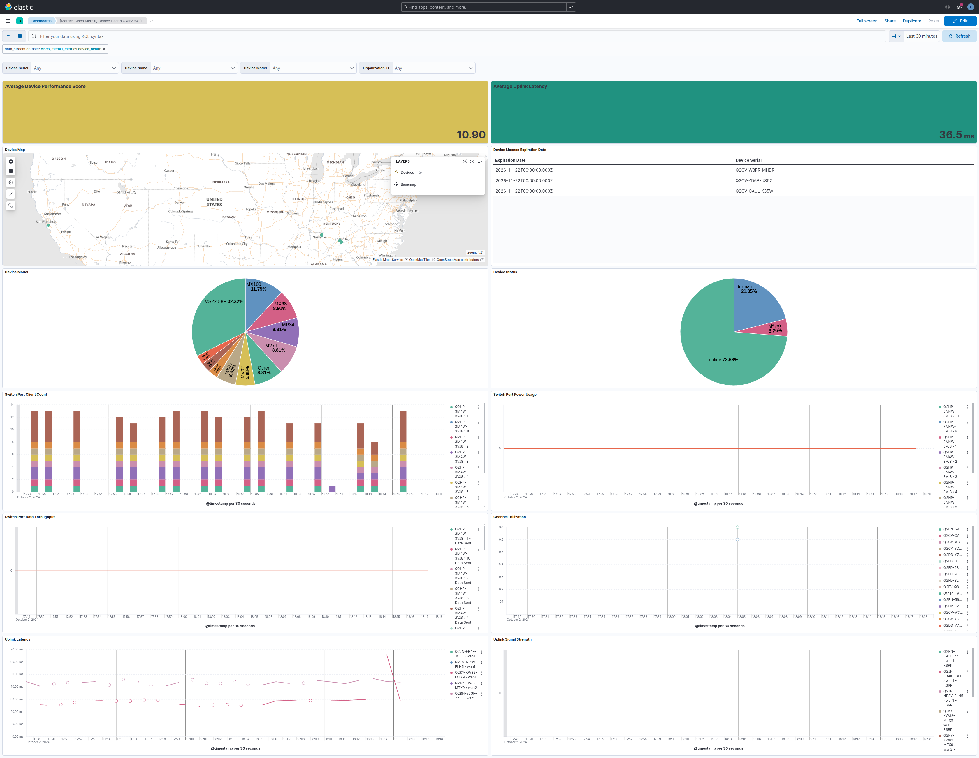

This integration periodically fetches metrics from Cisco Meraki networks. It collects a wide range of metrics including device details and status, network performance measurements, switch port information, wireless channel utilization, and uplink performance.
These metrics help you understand how well your Meraki network is working and make it easier to monitor and manage your network setup.
The integration uses the Meraki Dashboard RESTFul APIs library to collect metrics from Cisco Meraki networks.
You need Elasticsearch for storing and searching your data and Kibana for visualizing and managing it. You can use our hosted Elasticsearch Service on Elastic Cloud, which is recommended, or self-manage the Elastic Stack on your own hardware.
To configure this integration in Elastic, you need the following information from Cisco Meraki:
- API Key
- Organization IDs
- API Base URL (optional)
For more details on these settings, refer to the Meraki Dashboard API documentation.
