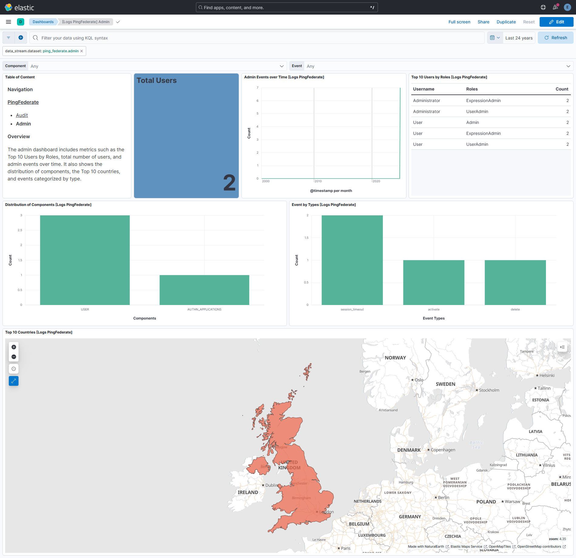

  1. In the Admin datastream, only logs from the admin.log file are supported via filestream in the pipe format. The log pattern is as follows:
<pattern>%d | %X{user} | %X{roles} | %X{ip} | %X{component} | %X{event} | %X{eventdetailid} | %m%n</pattern>
Sample Log:
2024-11-28 5:58:55,832 | Administrator | UserAdmin,Admin,CryptoAdmin,ExpressionAdmin | 81.2.69.142 | A-rBnNPcJffxBiizBWDOWxq_Ek8cYxg3nxxxxyn6H4 | LICENSE | ROTATE | - Login was successful

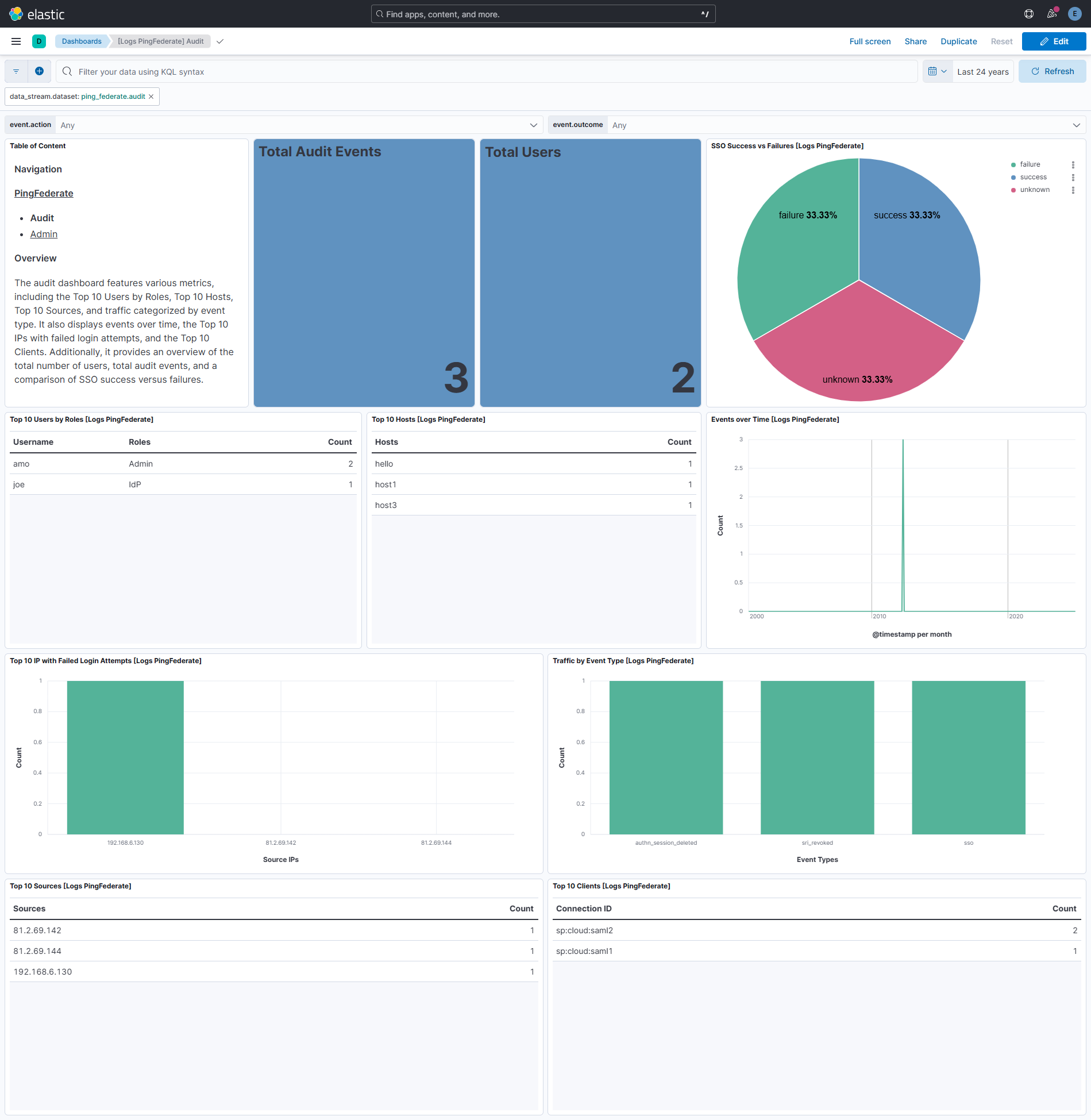

  1. Audit logs are supported through filestream, TCP, and UDP in the CEF format. The log pattern is as follows:
<pattern>%escape{CEF}{CEF:0|Ping Identity|PingFederate|%X{pfversion}|%X{event}|%X{event}|0|rt=%d{MMM dd yyyy HH:mm:ss.SSS} duid=%X{subject} src=%X{ip} msg=%X{status} cs1Label=Target Application URL cs1=%X{app} cs2Label=Connection ID cs2=%X{connectionid} cs3Label=Protocol cs3=%X{protocol} dvchost=%X{host} cs4Label=Role cs4=%X{role} externalId=%X{trackingid} cs5Label=SP Local User ID cs5=%X{localuserid} cs6Label=Attributes cs6=%X{attributes} %n}</pattern>
Sample Log:
CEF:0|Ping Identity|PingFederate|6.4|AUTHN_SESSION_DELETED|AUTHN_SESSION_DELETED|0|rt=May 18 2012 11:41:48.452 duid=joe src=89.160.20.112 msg=failure cs1Label=Target Application URL cs1=http://www.google.ca&landingpage\=pageA cs2Label=Connection ID cs2=sp:cloud:saml2 cs3Label=Protocol cs3=SAML20 dvchost=hello cs4Label=Role cs4=IdP externalId=tid:ae14b5ce8 cs5Label=SP Local User ID cs5=idlocal cs6Label=Attributes cs6={SAML_SUBJECT\=joe, ognl\=tom}
