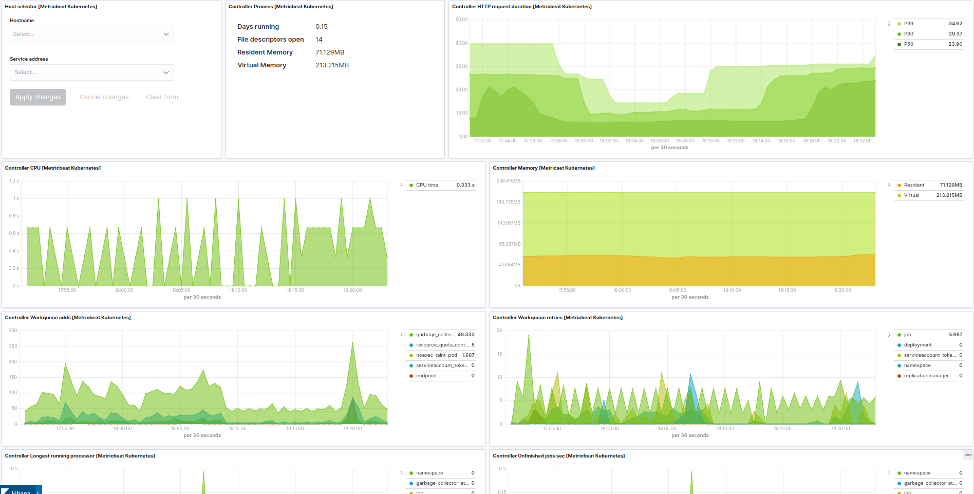

This is the controllermanager dataset for the Kubernetes package. It collects from
Kubernetes controller component metrics endpoint.
