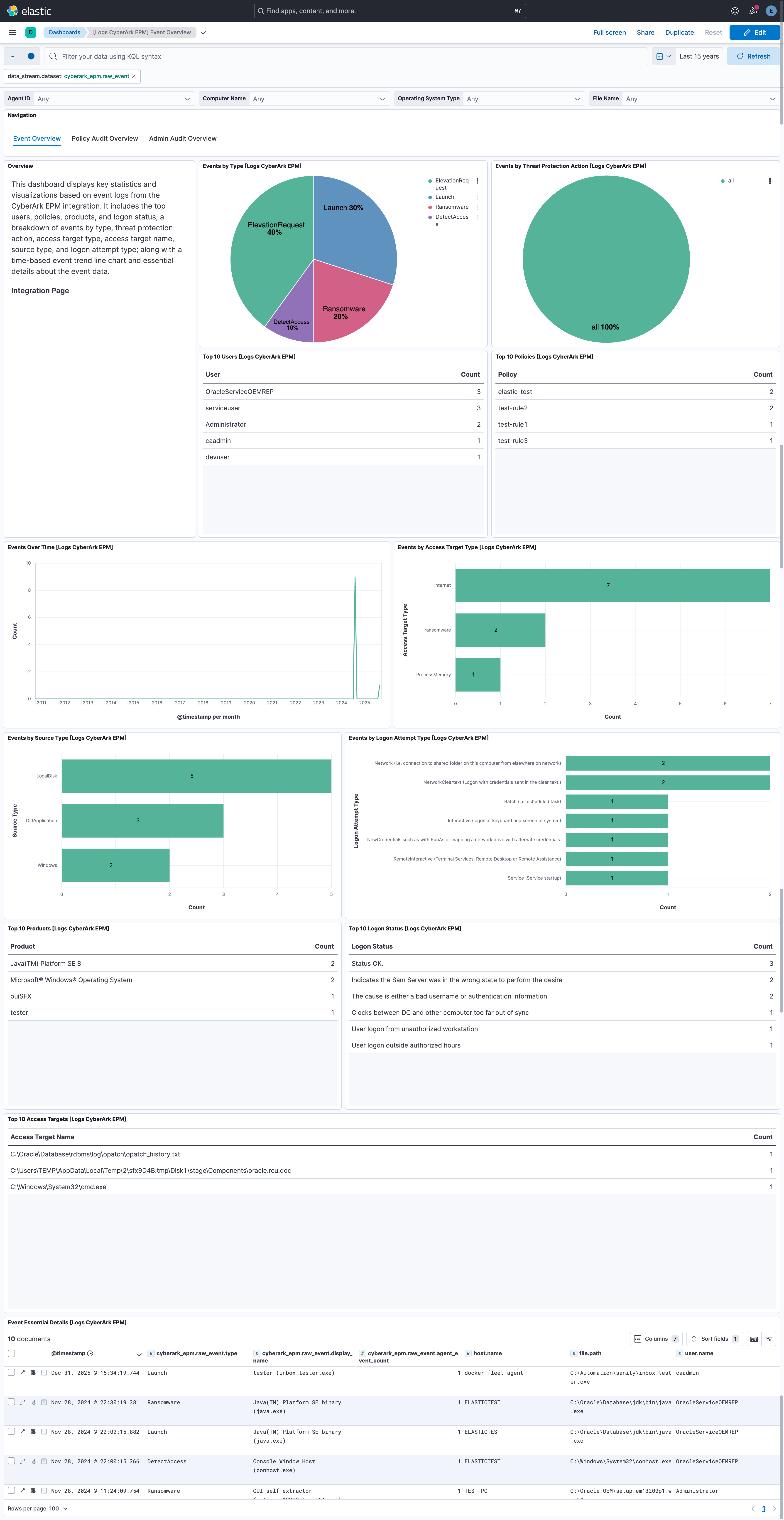

- Raw Event - This method enables users to retrieve raw events from EPM.

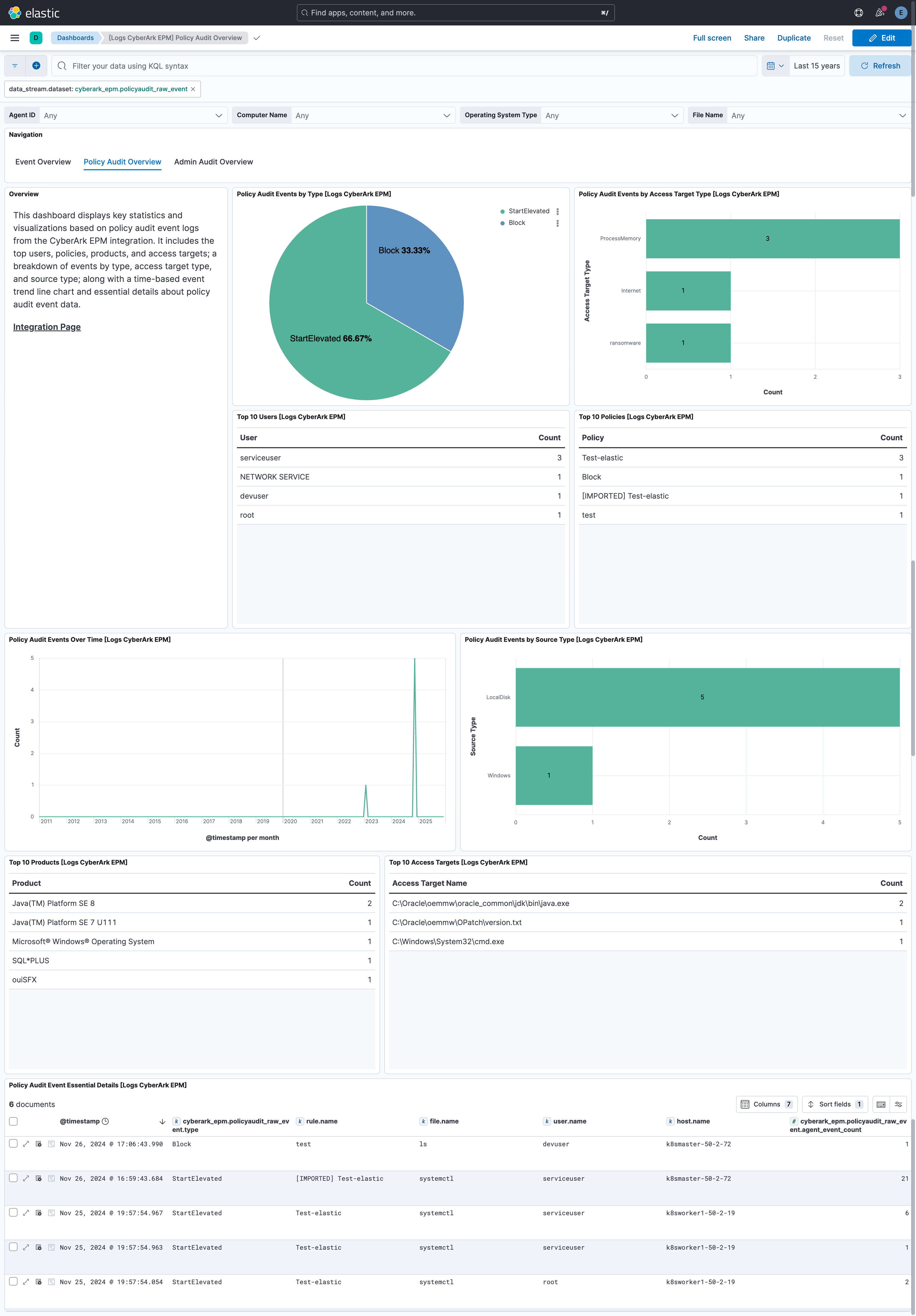

- Policy Audit Raw Event - This method enables users to retrieve policy audit raw events from EPM.
- Aggregated Event - This method enables users to retrieve aggregated events from EPM.
- Policy Audit Aggregated Event - This method enables users to retrieve aggregated policy audit events from EPM.

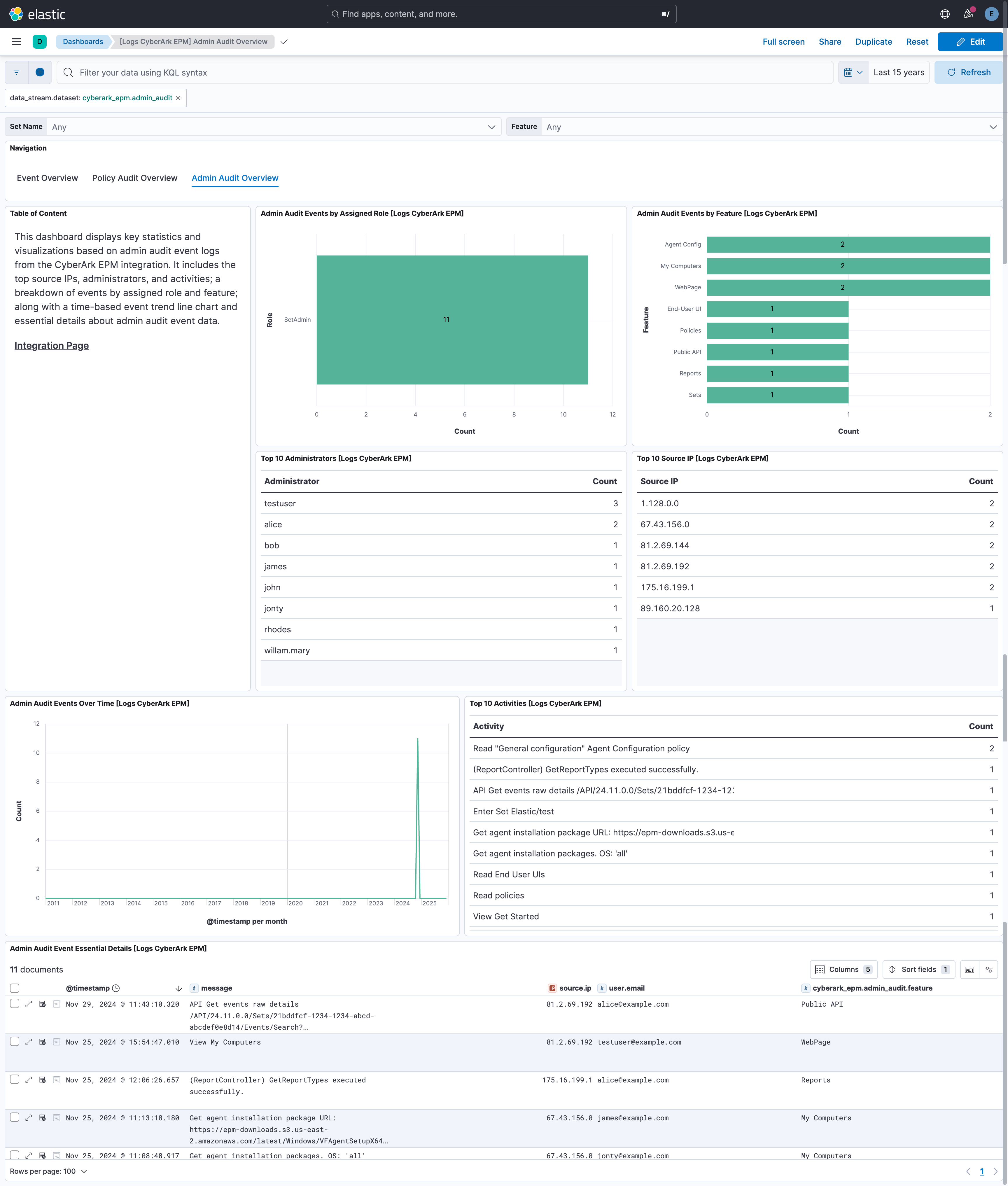

- Admin Audit - This method enables users to retrieve the full list of actions carried out by EPM administrators in a specific set.
