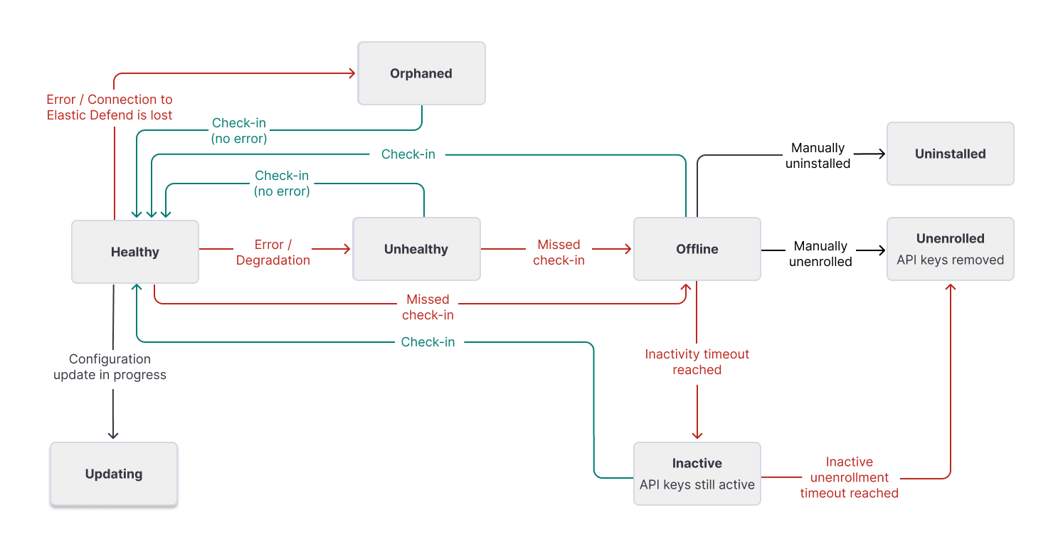

The following diagram shows the flow of Elastic Agent statuses:
Diagram showing the flow of Fleet Agent statuses

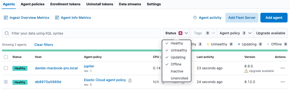

To filter the list of agents by status, click the Status dropdown and select one or more statuses.
Agent Status dropdown with multiple statuses selected

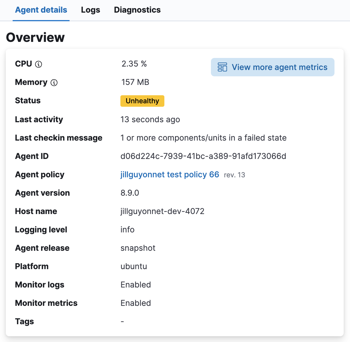

In Fleet, you can access the detailed status of an individual agent and the integrations that are associated with it through the agent policy.
  1. In Fleet, open the Agents tab.
  2. In the Host column, click the agent’s name.
On the Agent details tab, the Overview pane shows details about the agent and its performance, including its memory and CPU usage, last activity time, and last checkin message. To access metrics visualizations, you can also View the Elastic Agent metrics dashboard.
Agent details overview pane with various metrics

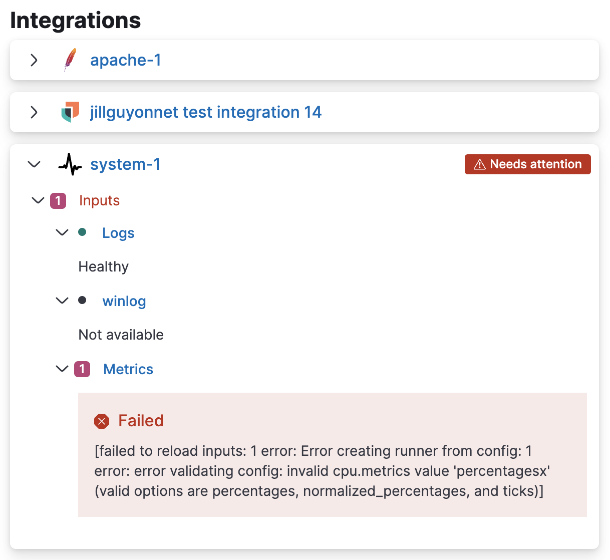

The Integrations pane shows the status of the integrations that have been added to the agent policy. Expand any integration to view its health status. Any errors or warnings are displayed as alerts.
Agent details integrations pane with health status
To gather more detail about a particular error or warning, from the Actions menu select View agent JSON. The JSON contains all of the raw agent data tracked by Fleet.
Note
Currently, the Integrations pane shows the health status only for agent inputs. Health status is not yet available for agent outputs.

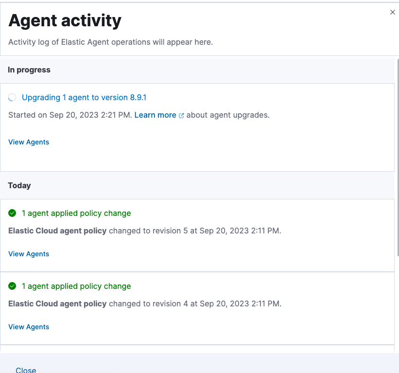

You can view a chronological list of all operations performed by your Elastic Agents.
On the Agents tab, click Agent activity. All agent operations are shown, beginning from the most recent, including any in progress operations.

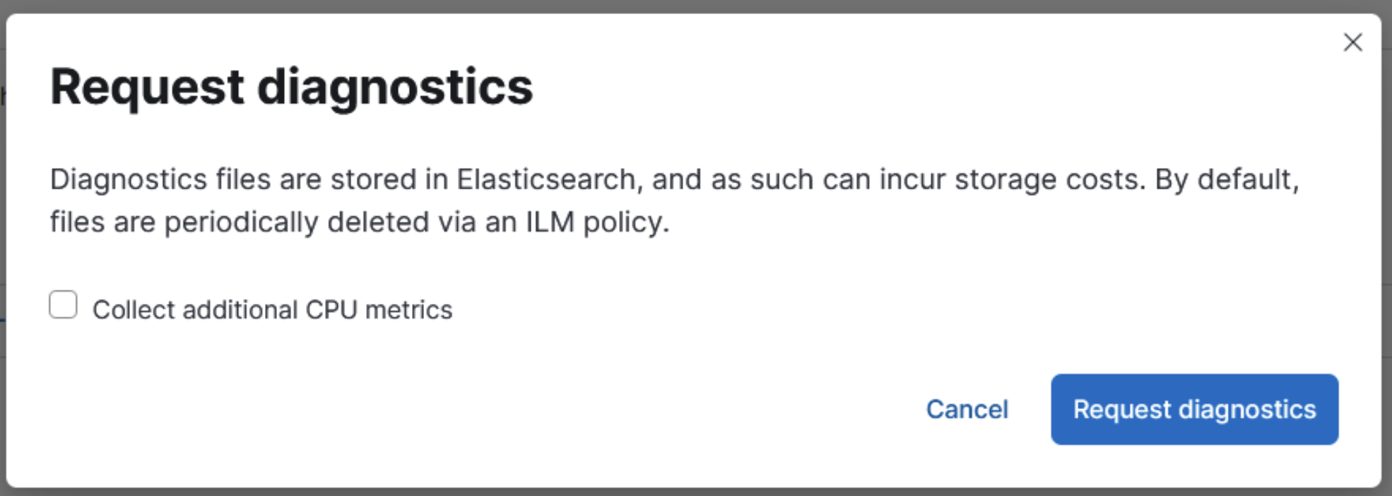

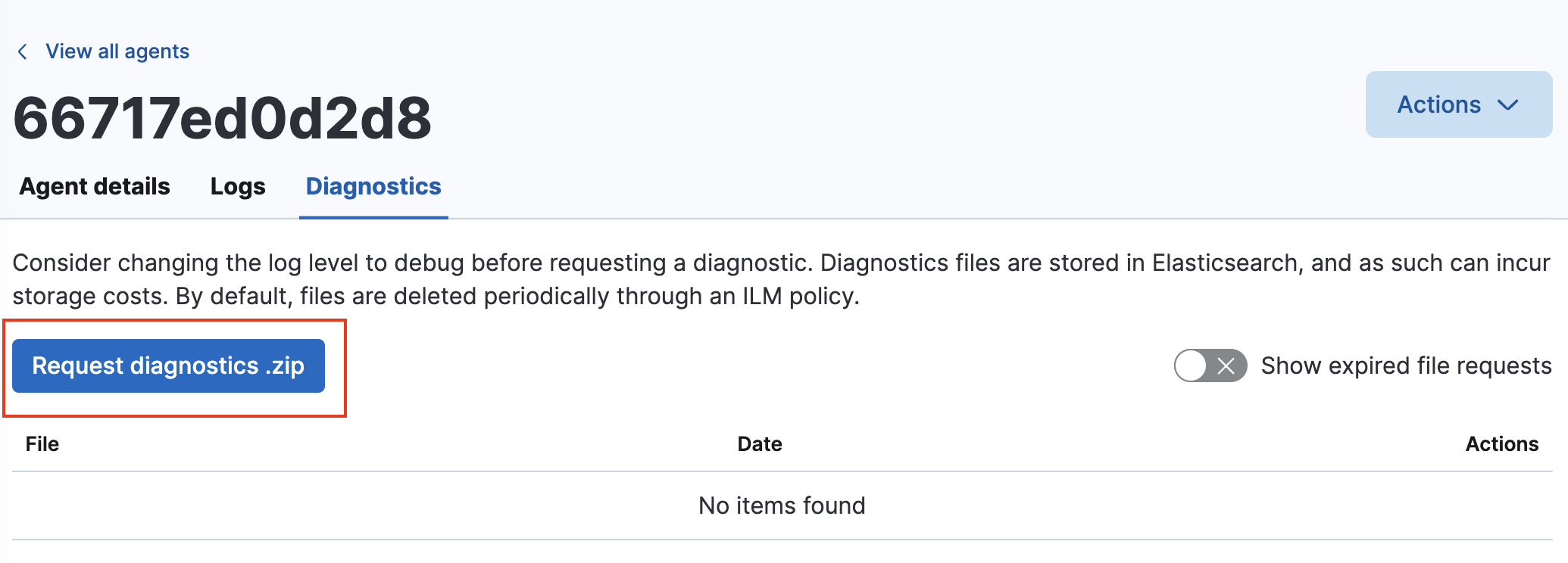

Fleet provides the ability to remotely generate and gather an Elastic Agent's diagnostics bundle. An agent can gather and upload diagnostics if it is online in a Healthy or Unhealthy state. To download the diagnostics bundle for local viewing:
  3. Select the Diagnostics tab and click the Request diagnostics .zip button.
    Collect agent diagnostics under agent details
  4. In the Request Diagnostics pop-up, select Collect additional CPU metrics if you’d like detailed CPU data.
    Collect agent diagnostics confirmation pop-up
  5. Click the Request diagnostics button.
When available, the new diagnostic bundle will be listed on this page, as well as any in-progress or previously collected bundles for the Elastic Agent.
Note that the bundles are stored in Elasticsearch and are removed automatically after 7 days. You can also delete any previously created bundle by clicking the trash can icon.

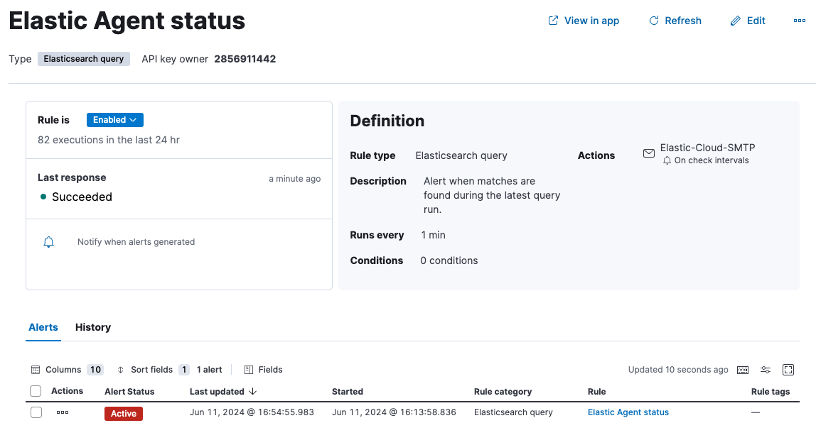

You can set up an alert to notify you when one or more Elastic Agents goes offline:
  1. In Kibana, navigate to Management > Stack Management > Rules.
  2. Click Create rule.
  3. Select Elasticsearch query as the rule type.
  4. Choose a name for the rule, for example Elastic Agent status.
  5. Select KQL or Lucene as the query type.
  6. Select DATA VIEW metrics-* as the data view.
  7. Define your query, for example: fleet.agents.offline >= 1.
  8. Set the alert group, threshold, and time window. For example:
    • WHEN: count()
    • OVER: all documents
    • IS ABOVE: 0
    • FOR THE LAST 5 minutes
      This will generate an alert when one or more agents are reported by the fleet.agents.offline field over the last five minutes to be offline.
  9. Set the number of documents to send, for example:
    • SIZE: 100
  10. Set Check every to the frequency at which the rule condition should be evaluated. The default setting is one minute.
  11. Select an action to occur when the rule conditions are met. For example, to set the alert to send an email when an alert occurs, select the Email connector type and specify:
    • Email connector: Elastic-Cloud-SMTP
    • Action frequency: For each alert and On check intervals
    • Run when: Query matched
    • To: <the recipient email address>
    • Subject: <the email subject line>
  12. Click Save.
The new rule will be enabled and an email will be sent to the specified recipient when the alert conditions are met.
From the Rules page you can select the rule you created to enable or disable it, and to view the rule details including a list of active alerts and an alert history.
A screen capture showing the details for the new Elastic Agent status rule
