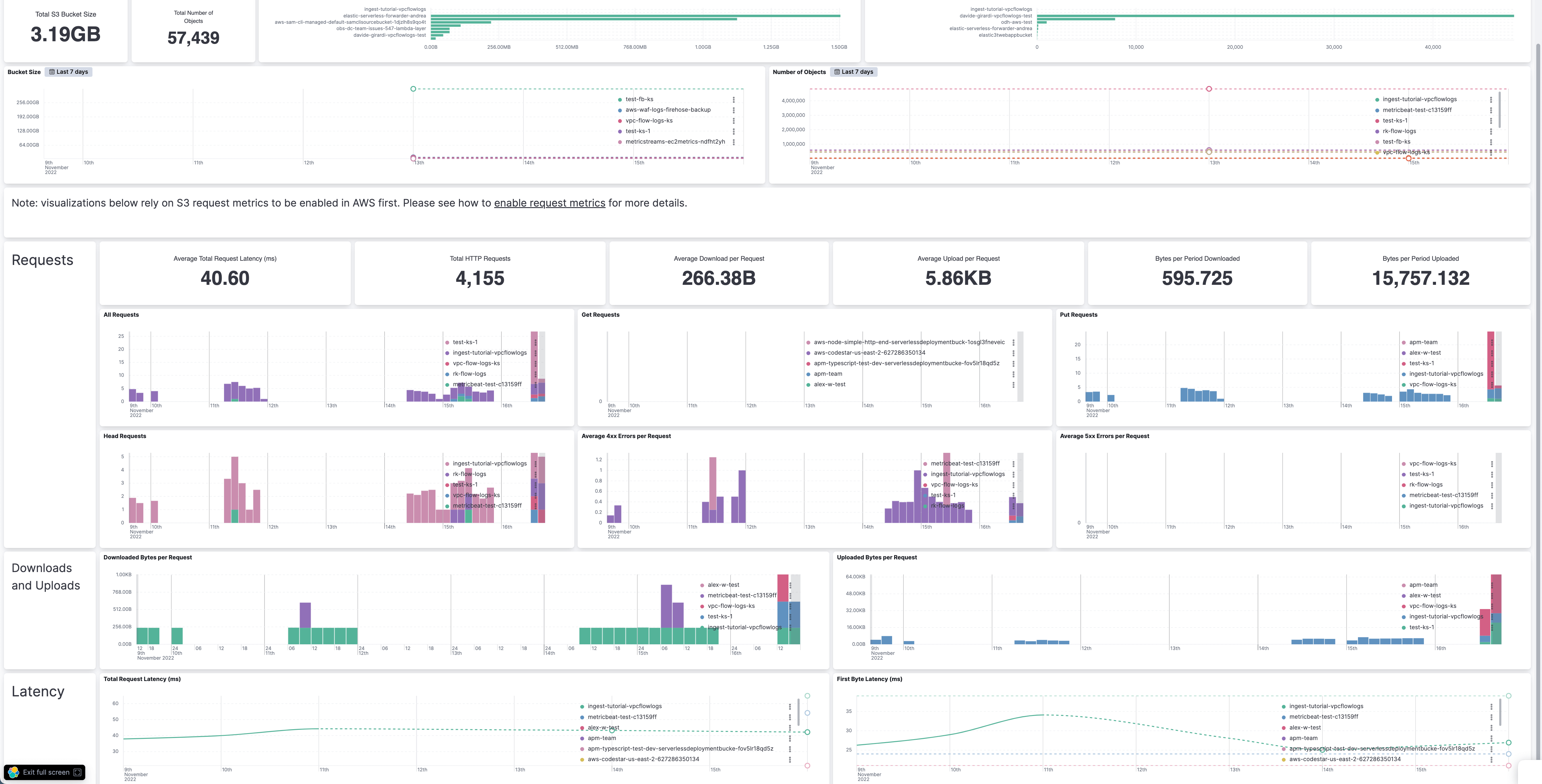

The S3 integration collects two types of data: logs and metrics.
Logs help you keep a record of events happening in your Amazon services. Logs collected by the S3 integration include the apparent internet address of the requester, the name of the bucket that the request was processed, and more. See more details in the Logs reference.
Metrics give you insight into the state of different Amazon services. Metrics collected by the S3 integration include S3 daily storage, S3 requests, the latency (elapsed per-request time from the first byte received to the last byte sent to an Amazon S3 bucket), the number of HTTP 4xx client error status code requests made to an Amazon S3 bucket, and more. See more details in the Metrics reference.

To enable S3 request metrics, see Create a CloudWatch metrics configuration.
To send server access logs to an S3 bucket, see How to enable server access logging.

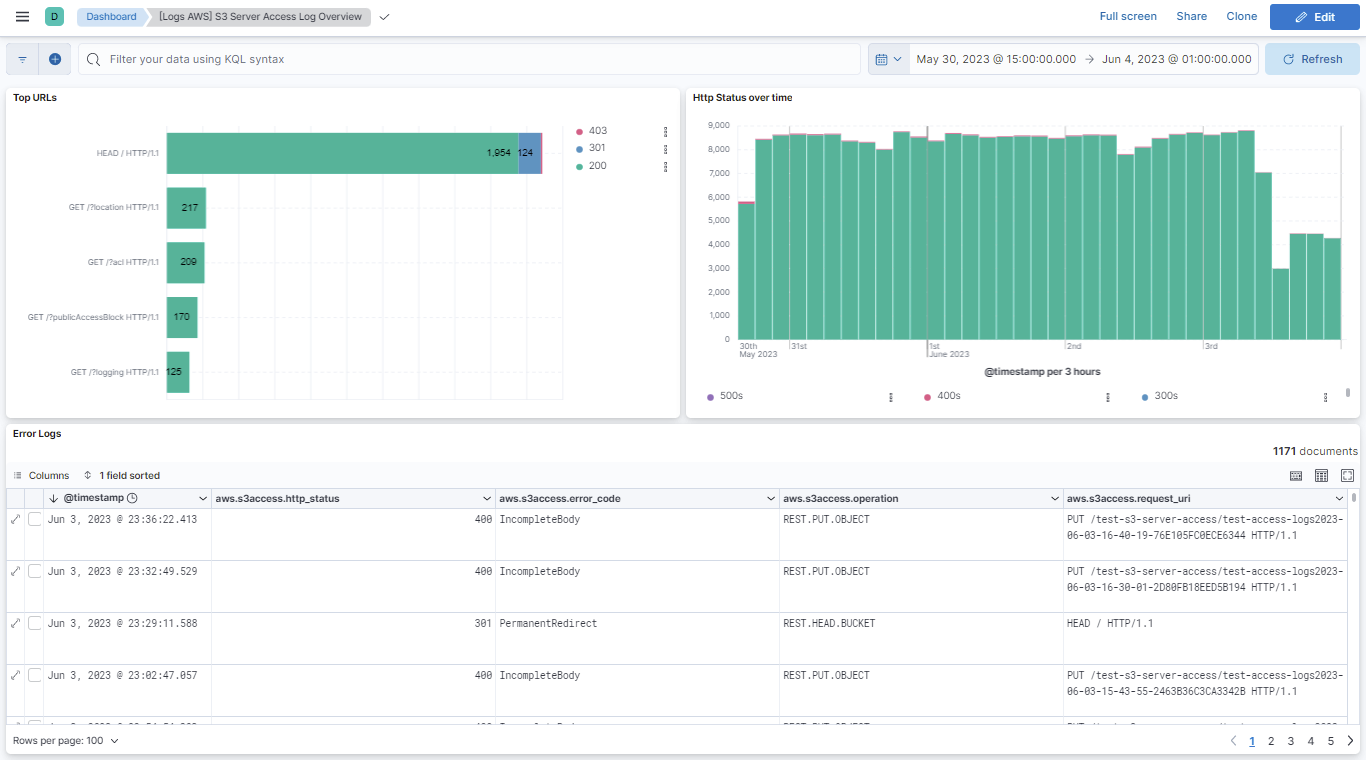

The s3access dataset collects server access logs from Amazon S3. Server access
logging provides detailed records for the requests that are made to a bucket.
Server access logs are useful for many applications. For example, access log
information can be useful in security and access audits. It can also help users
to learn about customer base and understand Amazon S3 bill.
