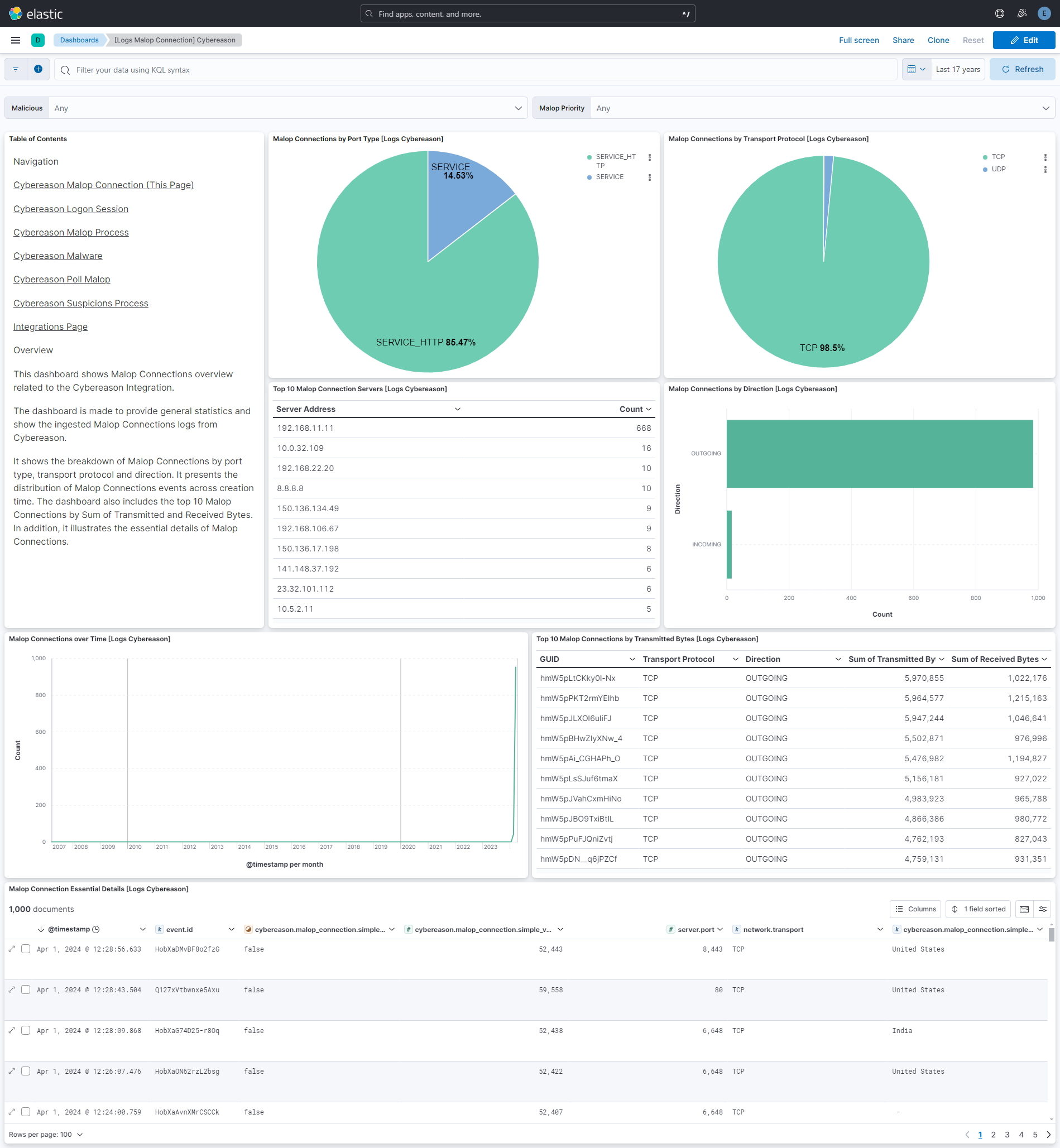

Malop Connection - This data stream provides detailed insights into network connections observed by the endpoint detection and response (EDR) system.

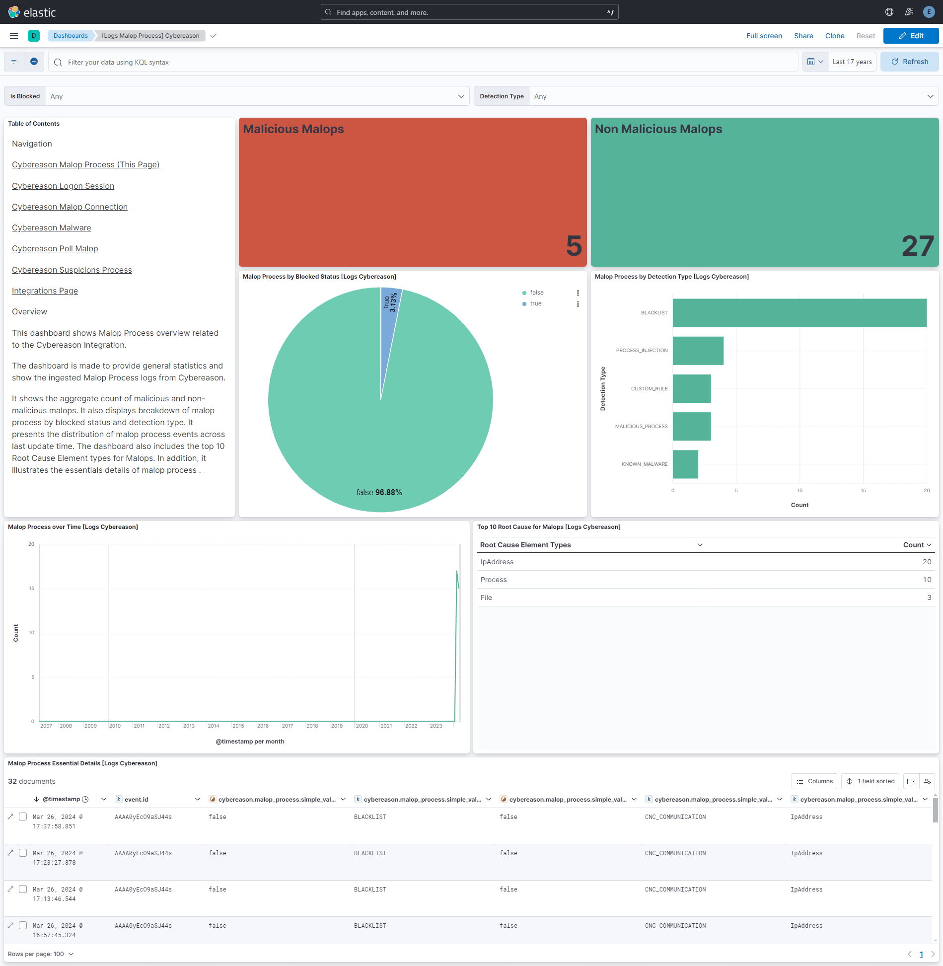

Malop Process - This data stream provides details about malicious processes detected within their environment, aiding in the detection and mitigation of security threats.

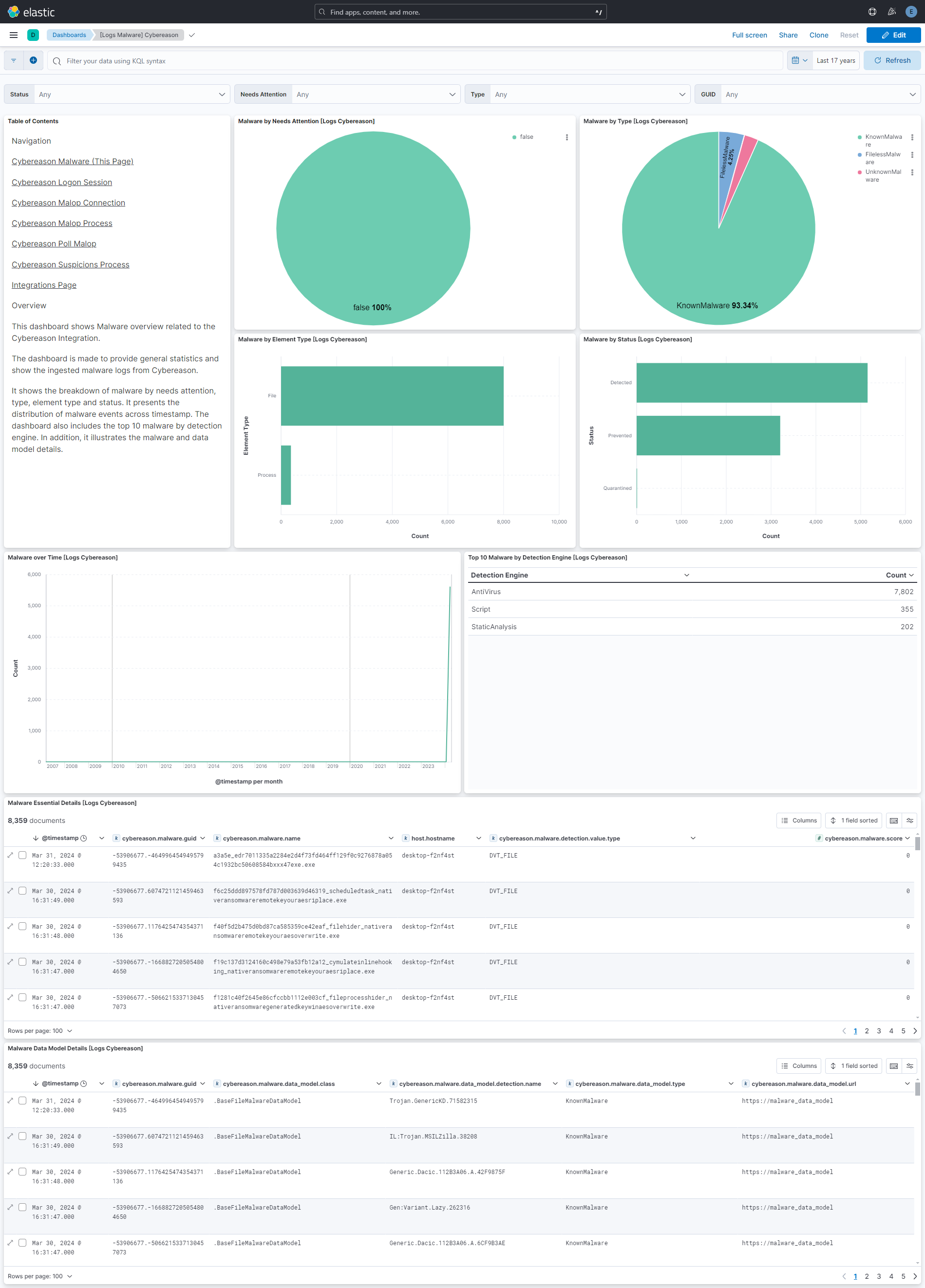

Malware - This data stream provides detailed information about a malware detection event, including the detected file, its type, detection method, and additional metadata for analysis and response.

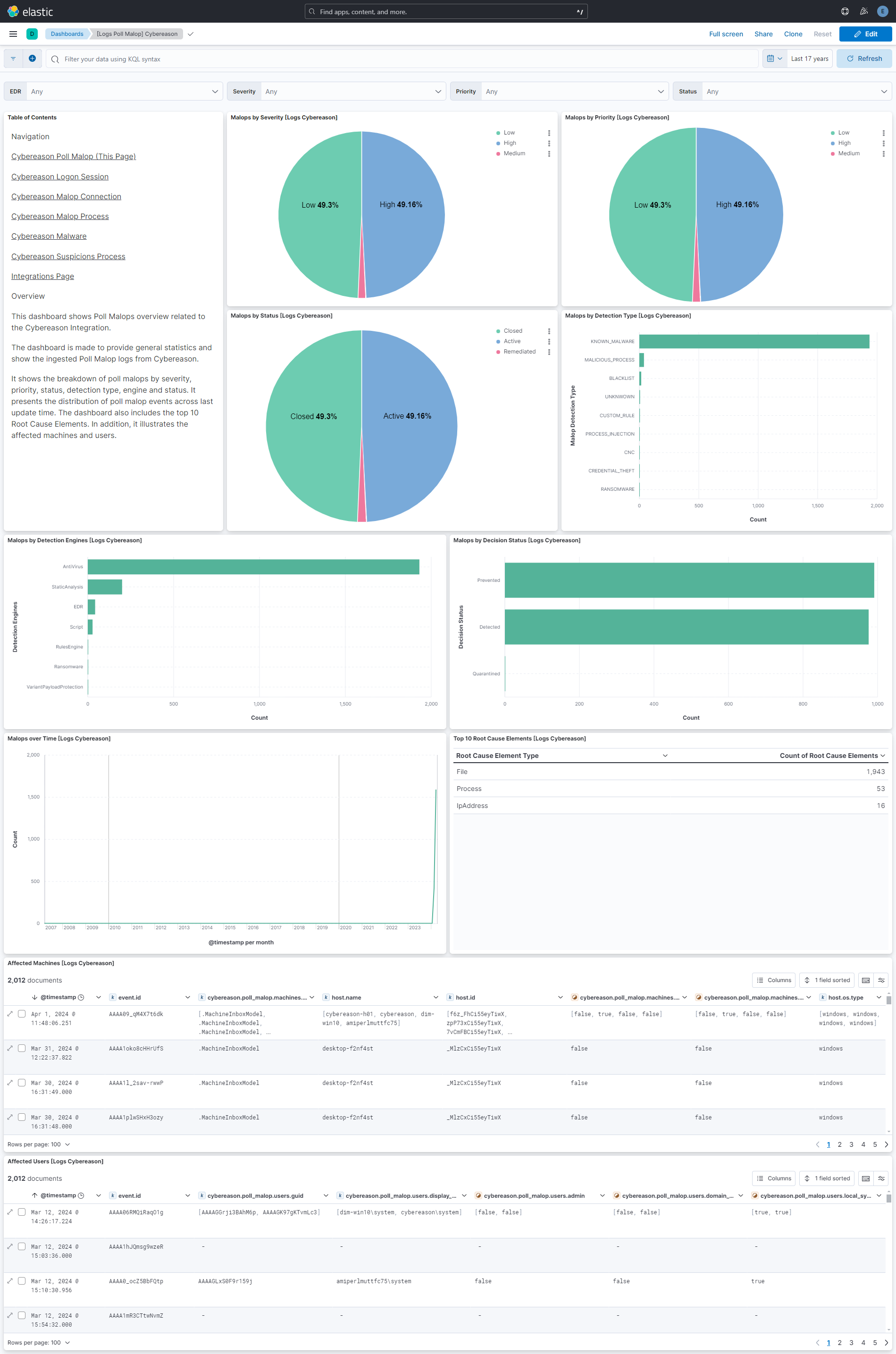

Poll Malop - This data stream provides comprehensive information about Malops detected by Cybereason's EDR system, enabling security teams to analyze and respond to potential threats effectively.

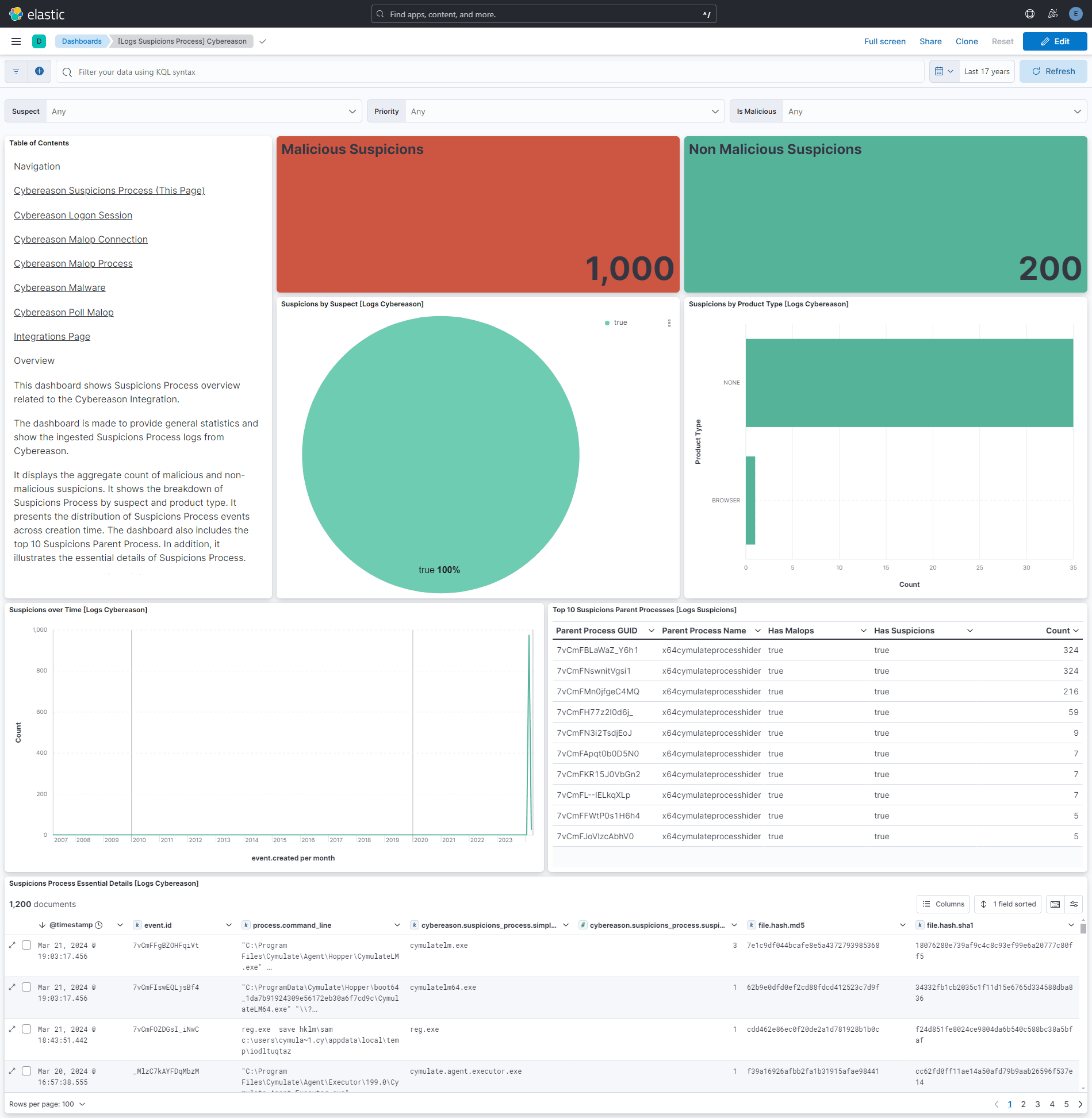

Suspicions Process - This data stream provides detailed information about processes that are suspected or deemed malicious within the endpoint detection and response (EDR) system.
Suspicions Process has the same endpoint as the first three data streams, we have added a filter - hasSuspicions : true and some custom fields to get the logs related to suspicions.

| cybereason.poll_malop.class | keyword | |
| cybereason.poll_malop.closed | boolean | |
| cybereason.poll_malop.closer_name | keyword | |
| cybereason.poll_malop.containers | keyword | |
| cybereason.poll_malop.creation_time | The time (in epoch) when the Malop was generated. | date |
| cybereason.poll_malop.data.close_time | date | |
| cybereason.poll_malop.data.detection_type | The type of detection for the root cause. . | keyword |
| cybereason.poll_malop.data.priority | keyword | |
| cybereason.poll_malop.data.severity | keyword | |
| cybereason.poll_malop.data.status | keyword | |
| cybereason.poll_malop.data.type | keyword | |
| cybereason.poll_malop.decision_statuses | The prevention action that the Cybereason platform used for this Malop. | keyword |
| cybereason.poll_malop.detection.engines | The method of detecting the Malop. | keyword |
| cybereason.poll_malop.detection.types | The type of detection for the root cause. | keyword |
| cybereason.poll_malop.display_name | The display name for the item. | keyword |
| cybereason.poll_malop.edr | Indicates whether the Malop is an Auto Hunt Malop or an Endpoint Protection Malop. | boolean |
| cybereason.poll_malop.empty | boolean | |
| cybereason.poll_malop.escalated | Indicates whether someone has marked the Malop as escalated. | boolean |
| cybereason.poll_malop.files | An object containing details on files associated with the MalOp. | flattened |
| cybereason.poll_malop.group | The Group ID of the affected sensors. | keyword |
| cybereason.poll_malop.guid | The unique GUID the Cybereason platform uses for the MalOp. | keyword |
| cybereason.poll_malop.icon_base64 | The base64 value for the item that is the root cause of the Malop. | keyword |
| cybereason.poll_malop.labels | An object that contains details on the labels, such as the label name and the time the label was added. | keyword |
| cybereason.poll_malop.last_update_time | The time (in epoch) when the Malop was last updated. | date |
| cybereason.poll_malop.machines.class | keyword | |
| cybereason.poll_malop.machines.connected | Indicates whether the machine is currently connected to the Cybereason server. | boolean |
| cybereason.poll_malop.machines.display_name | keyword | |
| cybereason.poll_malop.machines.empty | boolean | |
| cybereason.poll_malop.machines.guid | keyword | |
| cybereason.poll_malop.machines.isolated | Indicates whether the machine is currently isolated. | boolean |
| cybereason.poll_malop.machines.last_connected | The time (in epoch) when the machine was last connected to a Cybereason server. | date |
| cybereason.poll_malop.machines.os_type | The operating system type of the affected machine. . | keyword |
| cybereason.poll_malop.primary_root_cause_name | keyword | |
| cybereason.poll_malop.priority | The priority assigned to the MalOp. | keyword |
| cybereason.poll_malop.processes | An object containing details on processes associated with the MalOp. | flattened |
| cybereason.poll_malop.root_cause_element.hashes | keyword | |
| cybereason.poll_malop.root_cause_element.names_count | A count of the items that are the root cause or causes of the Malop. | long |
| cybereason.poll_malop.root_cause_element.type | The Element that is the root cause of the Malop. | keyword |
| cybereason.poll_malop.severity | The Malop severity level. | keyword |
| cybereason.poll_malop.status | The status of the Malop. | keyword |
| cybereason.poll_malop.users.admin | Indicates whether the specified user has administrator privileges on the machine. | boolean |
| cybereason.poll_malop.users.display_name | keyword | |
| cybereason.poll_malop.users.domain_user | Indicates whether the specified user is a domain user. | boolean |
| cybereason.poll_malop.users.guid | keyword | |
| cybereason.poll_malop.users.local_system | Indicates whether the specified user has local system privileges on the machine. | boolean |
| event.dataset | Event dataset. | constant_keyword |
| event.module | Event module. | constant_keyword |
| input.type | Type of filebeat input. | keyword |
| log.offset | Log offset. | long |
This is the Suspicions Process dataset.
Example
"@timestamp": "2024-03-12T15:13:27.872Z",
"agent": {
"ephemeral_id": "e51371e9-5904-4398-bbc8-1e624f59287c",
"id": "02c714ca-5c57-484f-885f-ab3a7c633af8",
"name": "elastic-agent-98770",
"type": "filebeat",
"version": "8.13.0"
"cybereason": {
"suspicions_process": {
"element_values": {
"calculated_user": {
"element_values": [
"element_type": "User",
"guid": "AAAAGGZ3xLXVm27e",
"has_malops": false,
"has_suspicions": false,
"name": "cy\\cymulator"
"guessed_total": 0,
"total_malicious": 0,
"total_suspicious": 0,
"total_values": 1
"children": {
"guessed_total": 0,
"total_values": 0
"image_file": {
"element_values": [
"element_type": "File",
"object": {
"fileHash": {
"elementValues": [
"elementType": "FileHash",
"guid": "AAAAHuaPtU7zGEJc",
"hasMalops": false,
"hasSuspicions": false,
"name": "a3c06b947549921d60d59917575df5ee5dfc472a",
"simpleValues": {
"iconBase64": {
"totalValues": 1,
"values": [
"iVBORw0KGgoAAAANSUhEUgAAACAAAAAgCAYAAABzenr0AAAAAXNSR0IArs4c6QAAAARnQU1BAACxjwv8YQUAAAAJcEhZcwAADsMAAA7DAcdvqGQAAAh4SURBVFhHpdd7UFNnGgbwWBURCAQVtu0/OzudcXVFVEBATdWKLVvkIuEmWAoUtOttqsICIiqKiEQBoV4xut1O1d11lW4RvFTSQ0ggECABkhAIIF4QpXZTt1Pcdbt59j050QoBq+07804YhuT5fe/58p0D70XLi3kQM69mgJlb02+aU9OHObIeeMqMmCM3YI5Ci3n1Gmr1kE+jsptaskhd/WvrW39Z+TDfSnwY05BXzQNQOPVtsIDZsm7qLnjWdsBTrsWculYCNMOnQQn/phoINdfNS9oudy/TVgitH/Vy5cs8Evoy35t8mIfwrvkGXjWDFH6Hwm/Cs+YGZtewgA54yPSYLW+Dp6IVc+ub4KVUYUEzC7iGpW0VWK67iKCuM+qwXsmLT8SPeZTvywyZLeHMP+HFDGJezT0C3OVWT+EelnAO4FHbRgg1AVTwbqiHb5MMC1qqLYDAjnN413AGK3tPDMX158dYI8YuP+Y/Elo55jPfgQXQ+C2rn0fh7AQsq6fRz2KDLa2jn1lAK02hGfOUjfBVsRO4agWcRVh3GQsAAcyr+/PGRvgzj/MJAFo99fcU/i1N4AEB7lsAnjLu2nvIDJbVs8GzZO34nawVs2pZQAvtBRXtAxmE6itY1n4RgfrPCHAC0TcLQeFIGNhhTh5Mt90X/sx/hRRu9mP+bQHMZ/5F/ZCC2Wt/l177afUsoJNCtU+DR/ZseTMhGmgjfonFmgoEaM8juOsEIm4UIe52LpLuZ2HN16lD1tgfy495bKKm8EdWwHfwkpow84tbmFnRS92DGZe6CGCkcP2o4Wx7yFtoLyixsPkKAf6BgHYWUIaIXjFib+UhaSAVawY3YaMpRWKNtqxewoY/Wf30c31w230NLqnlEGRWwjXrCqZkVVFfwtSMcryaX4U3/t48BoD9KjLwbZRiUUsllmvPIMhQhugbuYi9mY3E/i1IubceGx7Em63xFsAQXX94fP4NBFnXwM+4BudsBi67FBDk1sM1rwFT8pSYmleHabkyTNstxbSdl/FqbhWmV2qGAWbLVZhbJ4e/6hIWt/wNAa2fYEVHCUI7xVjVtw0JdzYh+e5a/OF+PDY9iJRQ+A8xBMD0M/1wSL0Kp+214Oc0wnmvBi772yEQ6+B6UIcp1FMLdXArbIPbgRa47a+HW64UbtkVeOMCNw2P2hY6lBQEUGB+fRUWNV/EMs0pBHcUQ2TMQUxvBuJubMYH/Wvx4b14rB+MHuAtqn6kmXn+a0xOk8IhWwnH3Wrw83RwLjDARdwJQWEXXIuMmHLIiKnU00qoDxngXqyD+4EmuOfJ4LajEr+tUtKpKMdcuRReisvwbziPN5s+xTL1MQTr8hBu2I5o4xa835eCpNuJSOmPxYd3ReB5Vzz8H39nI+yzVXDY3QbHvA445XeCX2CE8wEjXA52Q1DUDdfiHkL0YGpJDyE68XppR/evSg0F7kXqdPd9CuVrBdfhwbCA6wSoxALlZ3hTdQpvNR9BiC4XIkMWAbZide9aJN5MRPKtKA4w4y+DmLS9Gfa72jA5Vw+HvE447qPe3zUcUcghBNl1+M2Wz0us2+dpuefVJk4vr4a3/AJ8FefgX/dnLFaVIaBJjOC2TIRqMxFp2Ij3ehKR0LfaAlhzJxw8t+Iu2GW3YlKOHva5Bkzea7AgHKwIpwKCiDmESzoDxyCx0pppUzM+ufrYW3aWAGexsP4kFisPYplKjCBNBkLb0yDSb0CsIQ7x3VFIuiFCys1Q8FwPGjFxpw52u/SYtNsA+z0cYvJIRKaCwgvgFFaabs2zKZ+/Xm33ln0Kv9ojWKQoxJIGMd5pzECgKg0hmnUIb09GlC4e7xkj8b4xBCl9gWbehGwtJhBg4q4O2OV0EKLDgrB/FrFXD8fQIgovAV90PNWaZ1PejCTfR3aKAIcJcABL6vYgoD6NABsQ0pIIUXsCYvTRNAUR4jt/j0RjQDdv/HYC7NATQm+LYC8Ji9hQBccQAoiOgR95ssCaZ1M+X5UMzK85goW1+6n34S1FKpYrUxHYuA4rGhMQpo6HSBOFWH0IYnXvIt4QIOS9sl2H8dm6URGTrAiHiKNwWnmYDQc/+nS3NW9YeUk/FnpLi+k0FcOfyYWwdieWyrciQLEegfUJHKBJBFFLKCI1QYjTBzKWN76SpTONhbBjJ5HVDIeQQlr9cfCjTrEAMz/qtM3DhXe1uNxbWghf6R4sZHZCyGzF0tqNCJAn4526BAQ1rEKoKhwidQgL4MLZGrdNxxACTxDjR04inQ6n0ENwiihjw6n/RJDTA9a3Dyvf6hy1nzTHvECaToBUAqwjwAd4Wx6HoPpwBDeEm8JUoZutf87VuG3aGELABkE9kb4Z9usq4RhWah0/hXMAdhrl1o+wKaF002Yh85FkCZPMBMhWM2/XrpIEyiPGfjYkxBCLGPcsIptD2KXVw3Hlx6MB4Bx5ctT98PKVqc0nBCw9AjExXUUTKIHT6AA4R5QNOYtODB/rc8p1RWGMa9DBUR5QM7Um3ggEB6EzIPww7YETFP50DzwLAAGojw+5hB8rd1l51OaZTxByKEYQXCwRBBeZCAACjDK5TK2Q2jwaYlLKF3AKP0qhEg4xOgAEAAGoj8Al7DAEoaXUJSAACEBdBAKYCTDGfqBLQY2RiPEZLXCMOEaXgb4J7FfxlwHyrWljVKZWYoOgtlt3jaZwhNuMkSziZwF+fA58bnGTMLOQZxH2SRe4S8GeCZESAlD4iwHMBPiJlY8sbk+YRiIsk6AAuilROBvMhTvTfWIMgIkAP+//Q0tx06BzgoVwiPHpLZicdBF8uj8400ScKZR95YKp6fcEGCLAS676eZXJnphahhCmJ6fmhKw22P2xge6WX8Lxo6/gmsr88Fpa9cPXU86PecseXjze/wGADjhbeB2rcwAAAABJRU5ErkJggg=="
"guessedTotal": 0,
"totalMalicious": 0,
"totalSuspicious": 0,
"totalValues": 1
"simple_values": {
"companyName": {
"totalValues": 1,
"values": [
"Microsoft Corporation"
"maliciousClassificationType": {
"totalValues": 1,
"values": [
"indifferent"
"md5String": {
"totalValues": 1,
"values": [
"5ac5ddc4c27ecc203b2ed62bbe8fb8b9"
"productName": {
"totalValues": 1,
"values": [
"Microsoft Edge"
"sha1String": {
"totalValues": 1,
"values": [
"guessed_total": 0,
"total_values": 1
"owner_machine": {
"element_values": [
"element_type": "Machine",
"guessed_total": 0,
"total_values": 1
"parent_process": {
"element_values": [
"element_type": "Process",
"guessed_total": 0,
"total_values": 1
"evidence_map": {
"evidence": "map"
"filter_data": {
"group_by_value": "msedge.exe"
"is_malicious": true,
"malicious": true,
"simple_values": {
"command_line": {
"total_values": 1
"creation_time": {
"total_values": 1
"element_display_name": {
"total_values": 1,
"values": [
"msedge.exe"
"end_time": {
"total_values": 1
"execution_prevented": {
"total_values": 1,
"values": [
false
"group": {
"total_values": 1,
"values": [
"72a61eac-6f79-4670-8607-a1334ddd2ff0"
"icon_base64": {
"total_values": 1,
"values": [
"image_file_company_name": {
"total_values": 1,
"values": [
"image_file_hash_icon_base64": {
"total_values": 1,
"values": [
"image_file_malicious_classification_type": {
"total_values": 1,
"values": [
"indifferent"
"image_file_md5_string": {
"total_values": 1
"image_file_product_name": {
"total_values": 1,
"values": [
"Microsoft Edge"
"image_file_sha1_string": {
"total_values": 1
"is_image_file_signed_and_verified": {
"total_values": 1,
"values": [
true
"is_white_list_classification": {
"total_values": 1,
"values": [
false
"product_type": {
"total_values": 1,
"values": [
"BROWSER"
"ransomware_auto_remediation_suspended": {
"total_values": 1,
"values": [
false
"suspect": true,
"suspicion_count": 1,
"suspicions": {
"connectingToBlackListAddressSuspicion": 1710232863248
"suspicions_map": {
"connectingToBlackListAddressSuspicion": {
"firstTimestamp": 1710232863248,
"potentialEvidence": [
"hasBlackListConnectionEvidence"
"totalSuspicions": 4
"data_stream": {
"dataset": "cybereason.suspicions_process",
"namespace": "36786",
"type": "logs"
"ecs": {
"version": "8.11.0"
"elastic_agent": {
"snapshot": false,
"version": "8.13.0"
"event": {
"category": [
"malware"
"created": [
"2024-03-12T08:40:35.122Z"
"id": "7vCmFCPB0XpbELrD",
"ingested": "2026-01-20T05:56:29Z",
"kind": "alert",
"type": [
"info"
"file": {
"hash": {
"md5": [
"sha1": [
"name": [
"msedge.exe"
"uid": [
"7vCmFKxNAQXpBIkL"
"input": {
"type": "cel"
"process": {
"command_line": [
"\"C:\\Program Files (x86)\\Microsoft\\Edge\\Application\\msedge.exe\" --type=utility --utility-sub-type=network.mojom.NetworkService --lang=en-US --service-sandbox-type=none --no-appcompat-clear --mojo-platform-channel-handle=2744 --field-trial-handle=2328,i,5521555393418764293,4286640738456912470,262144 --variations-seed-version /prefetch:3"
"parent": {
"entity_id": [
"7vCmFMsvYy739EW5"
"name": [
"msedge.exe"
"real_user": {
"id": [
"7vCmFBCi55eyTiwX"
"name": [
"dim-win10"
"related": {
"hash": [
"5ac5ddc4c27ecc203b2ed62bbe8fb8b9",
"user": [
"7vCmFBCi55eyTiwX",
"dim-win10"
"tags": [
"forwarded",
"cybereason-suspicions_process"
Exported fields
| cybereason.suspicions_process.element_values.calculated_user.element_values.element_type | keyword | |
| cybereason.suspicions_process.element_values.calculated_user.element_values.guid | keyword | |
| cybereason.suspicions_process.element_values.calculated_user.element_values.has_malops | boolean | |
| cybereason.suspicions_process.element_values.calculated_user.element_values.has_suspicions | boolean | |
| cybereason.suspicions_process.element_values.calculated_user.element_values.name | keyword | |
| cybereason.suspicions_process.element_values.calculated_user.element_values.object | flattened | |
| cybereason.suspicions_process.element_values.calculated_user.element_values.simple_values | flattened | |
| cybereason.suspicions_process.element_values.calculated_user.guessed_total | long | |
| cybereason.suspicions_process.element_values.calculated_user.total_malicious | long | |
| cybereason.suspicions_process.element_values.calculated_user.total_suspicious | long | |
| cybereason.suspicions_process.element_values.calculated_user.total_values | long | |
| cybereason.suspicions_process.element_values.children.element_values.element_type | keyword | |
| cybereason.suspicions_process.element_values.children.element_values.guid | keyword | |
| cybereason.suspicions_process.element_values.children.element_values.has_malops | boolean | |
| cybereason.suspicions_process.element_values.children.element_values.has_suspicions | boolean | |
| cybereason.suspicions_process.element_values.children.element_values.name | keyword | |
| cybereason.suspicions_process.element_values.children.element_values.object | flattened | |
| cybereason.suspicions_process.element_values.children.element_values.simple_values | flattened | |
| cybereason.suspicions_process.element_values.children.guessed_total | long | |
| cybereason.suspicions_process.element_values.children.total_malicious | long | |
| cybereason.suspicions_process.element_values.children.total_suspicious | long | |
| cybereason.suspicions_process.element_values.children.total_values | long | |
| cybereason.suspicions_process.element_values.image_file.element_values.element_type | keyword | |
| cybereason.suspicions_process.element_values.image_file.element_values.guid | keyword | |
| cybereason.suspicions_process.element_values.image_file.element_values.has_malops | boolean | |
| cybereason.suspicions_process.element_values.image_file.element_values.has_suspicions | boolean | |
| cybereason.suspicions_process.element_values.image_file.element_values.name | keyword | |
| cybereason.suspicions_process.element_values.image_file.element_values.object | flattened | |
| cybereason.suspicions_process.element_values.image_file.element_values.simple_values | flattened | |
| cybereason.suspicions_process.element_values.image_file.guessed_total | long | |
| cybereason.suspicions_process.element_values.image_file.total_malicious | long | |
| cybereason.suspicions_process.element_values.image_file.total_suspicious | long | |
| cybereason.suspicions_process.element_values.image_file.total_values | long | |
| cybereason.suspicions_process.element_values.owner_machine.element_values.element_type | keyword | |
| cybereason.suspicions_process.element_values.owner_machine.element_values.guid | keyword | |
| cybereason.suspicions_process.element_values.owner_machine.element_values.has_malops | boolean | |
| cybereason.suspicions_process.element_values.owner_machine.element_values.has_suspicions | boolean | |
