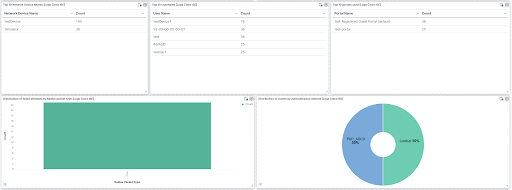

After you have completed the configuration, follow these steps to verify that data is flowing correctly:
- Navigate to Management > Fleet > Agents and verify that the Elastic Agent status is Healthy and Online.
- Trigger data flow on Cisco ISE by performing a test authentication or an administrative action, such as logging into the ISE portal or updating a configuration setting.
- In Kibana, navigate to Analytics > Discover.
- Select the
logs-*data view and enter the following KQL filter:data_stream.dataset : "cisco_ise.log" - Verify that logs appear with populated fields such as
event.dataset,source.ip,event.action, anduser.name. - Navigate to Analytics > Dashboards and search for "Cisco ISE" to view the pre-built visualizations and confirm they are being populated with data.
