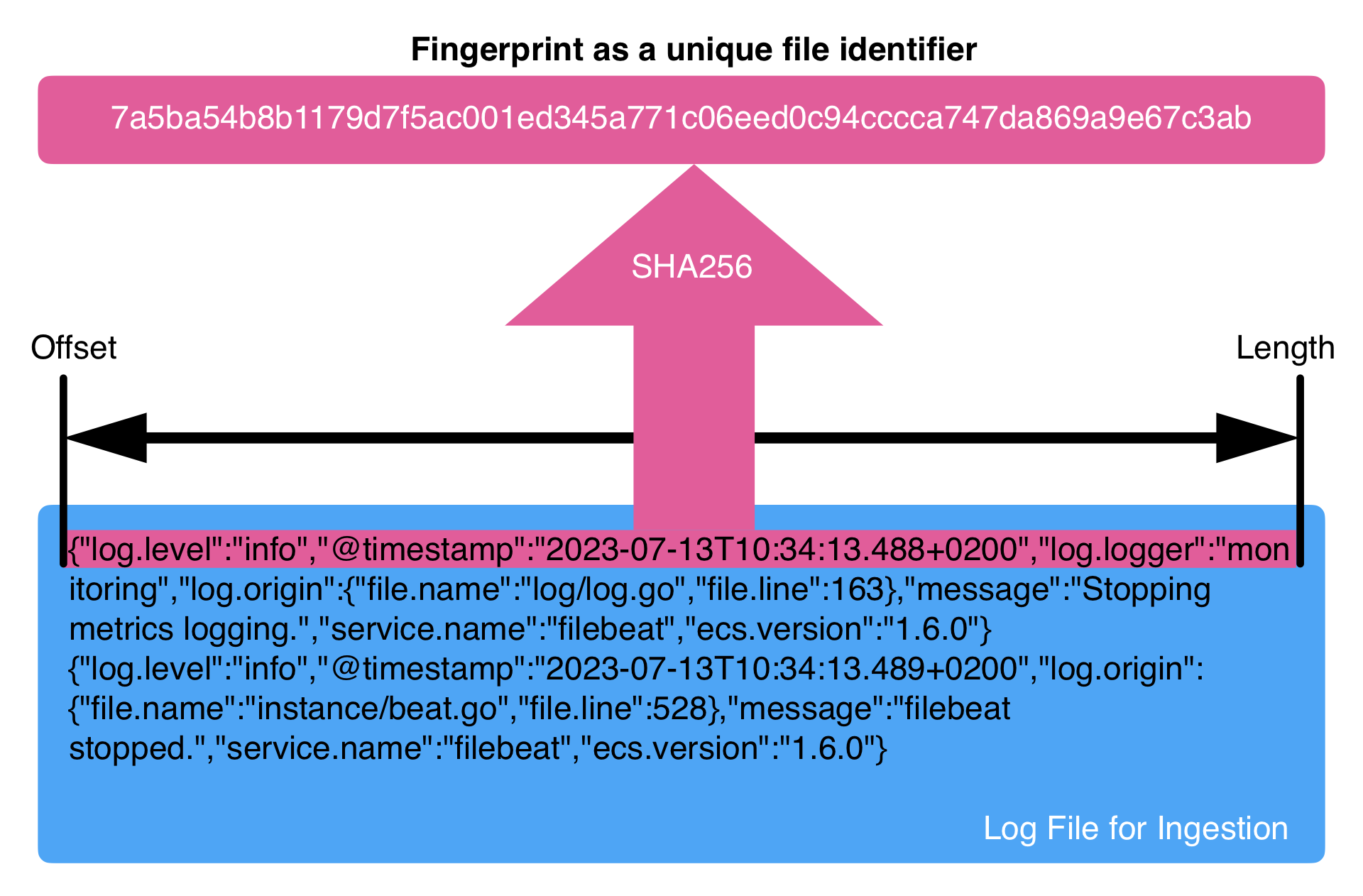

This file identity is using file fingerprints produced by the scanner component of the filestream input. Therefore, in order to activate this file identity, it's required to first activate fingerprint in the scanner by setting prospector.scanner.fingerprint.enabled: true.
In the context of the filestream input, fingerprint is a hash string computed from a part of the file content.
Fingerprint File Identity
By default, the hashed part of the file is the first 1024 bytes (offset: 0, length: 1024). Most of the log files have timestamps and other unique segments on each line that make sure that the first 1024 bytes combined together constitute a unique set of characters. This makes sure that a produced fingerprint is a stable unique identifier for each file.
If necessary, it's possible to move this hashed byte range farther into the file by adjusting the prospector.scanner.fingerprint.offset setting. It's also possible to change the number of bytes used for hashing by adjusting prospector.scanner.fingerprint.length (minimum value is 64 bytes). Keep in mind that the smaller the range, the more likely it is to hit a collision, so the fingerprint (ID) is not unique anymore. If this happens, only the first file with a collided ID will be ingested.
This file identity covers most of the common use cases, it's OS-agnostic, it supports any file system including network shares, and it ensures that data duplication or data loss are avoided.
